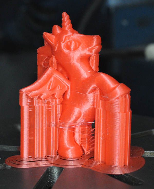

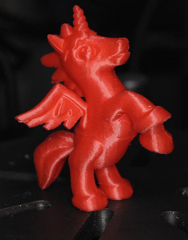

                            Some more playing with my Factory 3D:
                            Now using Cura 3.0.4.
                            First go with support, 0.2 prints:
                            The supports break away easily with a pair of dog nosed pliers

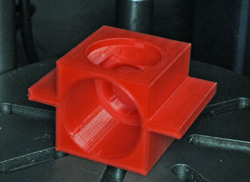

                            A more engineeringy trial with something I drew in Fusion 360.
                            All seems to work well smiley

                                          Posted by Roderick Jenkins on 13/11/2017 20:40:40:
                                          Rod
                                          Rod, I think you may have had a belt slip on the My Little Pony print. Look at the step, particularly noticable in the supports, just below the wing. I suffered with this on my build and the advice from F3D was that the belts should be tight and if necessary up the current to the motor. Motor should run warm and the belt should twang a good note. If you were watching it print you would have heard the bang when the belt jumped a tooth. Belts do stretch a little bit so need re-tensioning after the first few runs.

                                            Roderick Jenkins
                                              @roderickjenkins93242
                                              Posted by Journeyman on 15/11/2017 08:08:02:
                                              Thanks for that, John. I've already re-tensioned my X belt once – looks like I need to do it again, it certainly isn't "twang" tight. Other prints have been OK but I guess it happens if there is a large non-printing move with higher velocity.
                                              Cheers,
                                              Rod
