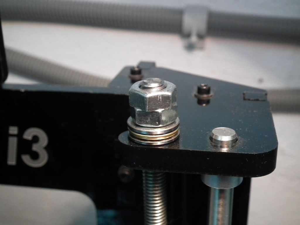

                                Russell Eberhardt
                                  @russelleberhardt48058
                                  Posted by Colin LLoyd on 26/10/2017 12:21:05:
                                  I found that a simple fine emery paper sanding with the rods rotating in the lathe cured the problem. The threaded transport rods maintain the position that any slightly lower contact in the bearings might have compromised. And I see no problems in the resultant prints.
                                  I did the same. The "smooth rods" supplied were between 7.959 and 8.012 mm. I had to put the biggest one in the lathe and polish it down a bit with very fine abrasive paper to get the bearing to slide smoothly. I had intended to replace them with proper hardened and ground shafting but that was a year ago and the bearings are still running well.
                                  I also fitted ball thrust bearings (ArcEuro ref B8) to the top of the threaded rods to take the weight of the print head off the stepper motors and to allow the flexible couplings to work properly.

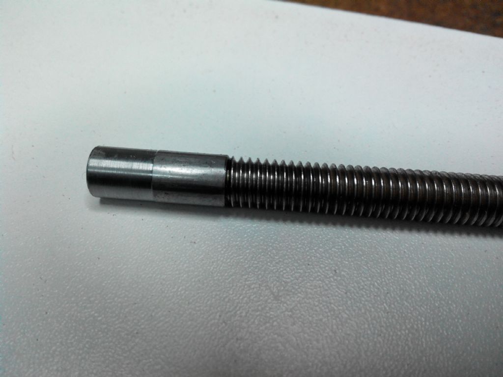

                                      Russell Eberhardt
                                        Posted by Colin LLoyd on 26/10/2017 14:46:20:
                                        Posted by Russell Eberhardt on 26/10/2017 14:26:15:
                                        Russell
                                        I noticed that Neil also added these thrust bearings but didn't notice much difference – and he has removed the picture showing them – so if I wanted to add these – how do you do it?
                                        First I extended the threaded rod by turning off the thread for a short length and loctiting a short extension piece in place. That was then skimmed to make sure it was true where it fits into the flexible coupler:
                                        The extended threaded rod was then a good fit in the coupler so it remained co-axial, unlike fitting the threaded rod directly into the coupler when it was off centre.
                                        The bearings were then fitted at the top:
                                        Russell
