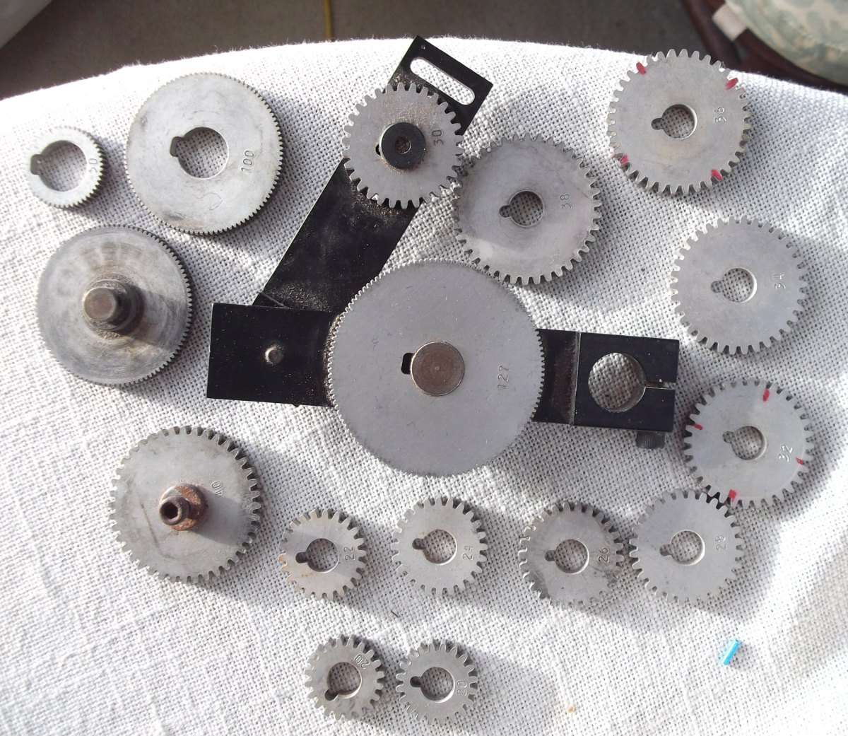

      found at local men in shed could be useful bin
      2x 20 22,24,26,28 30,34,36,38 40 + 50 2x 100, 127
      gears

        Sherline
        Parts shown in the picture is incomplete –  missing the spindle handwheel that was part of the screwcutting kit. Screwcutting ing on a Sherline was only done by hand turning the spindle, not under power.

          If those were all change-wheels the four at top left are clearly from a different source as the others.
          That’s a rum combination on that banjo, too, with one much coarser than the other. Their largest is of that magic 127, inch-metric conversion; but all these wheels seem to have been for a small lathe indeed, likely under 3″ centre-height.
          The banjo looks user-made, perhaps to add a further stage to a lathe whose standard trim allowed only a two-stage compounding.
          Perhaps they were all used on one lathe whose owner managed to create an extra stage using the finer-pitch gears to give an extra fine-pitch and metric-pitch ability on a physically small headstock. Though he’d have had to solve the problem of the different keyways: a special, dual-profile key perhaps.
          The source might not be a lathes or lathes, either.  The alternative machines could have been dividing-heads or coil-winders, for example.
          They’d be more identifiable if you could quote the bores and DPs (or modules if they are of metric dimensions).

            The four to the upper left are from a different set to the others, and that’s a rum combination on that banjo, with one much coarser than the other. Their largest is of that magic 127, inch-metric conversion;
            That is how Sherline made them, Nigel. The Sherline instruction leaflet for the screwcuttintg kit is available online as a .pdf (as are all Sherline instruction leaftlets) which explains all. The banjo arrangement is “proper” Sherline.

              They are the only lathe manufacturer that has the sense to realise that the whole set doesn’t have to be the same DP so avoiding a huge 127. It does occasionally get suggested on here but why the OEMs never think of it is a sad reflection on their designers.

                I use a compound change wheel set up on my Admiralty Drummond for fine feed. The different DP of the first two wheels allows a smaller 16t on the spindle instead of the Drummond 20t. Crossfeed through the rack for parting off is a breeze because the cutting load is constant.
