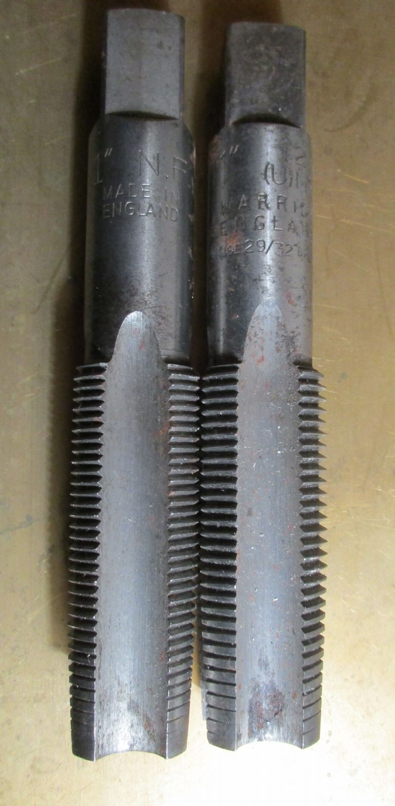

                      Nicholas Farr
                        @nicholasfarr14254
                        Posted by old mart on 22/10/2019 16:54:07:
                        Also threads marked NF are now UNF.
                        Hi, but with the exception of 1"
                        The one on the left is 1" x 14 NF and the one on the right is 1" x 12 UNF.
                        Regards Nick.
                        #434375
                        old mart
                          @oldmart
                          Thee were some changes made when UNF was ratified, that 12/14 tpi was exactly where the change took place. UNF threads from 1" upwards are now fixed at 12tpi, unless they are UNS, which could be anything.
