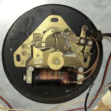

      Hello all
      Can anyone tell me anything about this clock mechanism? Is it useable? I think it will look great in my workshop.
      Simon.

          That looks like a repeater clock of the type that was fitted in factories and offices. This receives a signal from a master clock in some central location that operates the solenoid to flick the ratchet to the next minute.
          Unfortunately, you need a master clock to operate it!
          Personally, I would remove the mechanism and replace it with a quartz movement but retaining the case, dial and hands.
          Brian

            It looks like a slave clock made by IBM for master/slave clock system. Similar in function from those made by Gents. You may get more asking over on the Synchronome clock forum.

                  Please don't destroy this artefact by putting a normal movement in it. They are fairly simple to drive and if you don't want to DIY, have a look at this
                  **LINK**
                  Off the shelf module available, but low cost is relative. For DIY you could hide a quartz clock with a disk with holes in place of a hand and a slotted optocoupler detecting the holes and driving the coil. just adjust the holes for the pulse rate needed. (for mains use a synchronous motor and gearbox with a microswitch or if you are that way inclined a PIC Arduino or RPi

                    Hi Simon, I used to run one of these using a GPO clock No 36. To drive the clock mechanism will require quite a bit of current for the oomph needed at 48 Volt. I used a system of a slave relay to protect the master clock movement contacts to drive a nicad on float charge to give the neccessary oomph. Very simple and worked for years. So just saying I would advise as Simon mentions above use the relay. Be aware they are quite noisy aith a noticable clunk every 30 seconds. I presume if you operate the mech yours moves on half a minute?
                    I sold my clock 36 Mechanism and converted the clock to a quiet german quartz mech. Finding one with the right hands was a fiddle. Alan
                    P.S just so I don't drive Robert into apoplexy with such heresy, I kept the old drive so it can be restored should anyone wish.yes

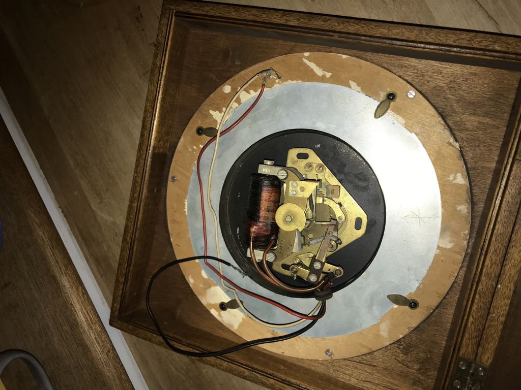

                      $89 plus shipping and possibly import duty is a bit steep, I do like the idea of a quartz mechanism driving a slotted disc with an optocoupler, i may even do this for the heath-robinson value. It seems to have some sort of hour synchronisation mechanism. It has 3 wires, and it looks like the black-red drive it normally with a 1 minute pulse, but as the hour ticks over, a snail cam moves a switch such that it can only be driven by the white-black pair. I am guessing that this pair are active (with 1-minute pulses) from teh hour, for say 10 minutes. So any clock that is out of time will tick normally out of time until the hour is passed, then will stay still until this white-black pair start up on the hour, and this has to carry on long enough for the snail-cam switch to move back to the red-black contacts.
                      Thinking as I type – i don't need this, I just set the time and leave it.
                      Does anyone know the volts used? It looks like low voltage, maybe 12? I will start out with a box of AA cells and a switch and see how I get on.

                        A few years back I converted a very similar clock for an acquaintance. I seem to remember that the solenoid needed 24 volt pulses. I build a driver based on a watch crystal, divided down to give 1 pulse/sec. If I was doing it again I would simply divide 50 Hz mains. Be aware that these mechanisms are quite noisey. OK in the workshop, but the clunk every minute might be irritating in a quiet domestic situation.

                                  Bear in mind that there are going to be a million pulses a year so quite a strain on a microswitch. I looked at this some 30 years ago for a church hall and concluded it would be hard to make a mechanism that had the long term reliability and servicing opportunity of a master clock. It is all very well relieving the switch contacts with a transistor but who would repair a specialist one off circuit. A master clock had a support infrastructure of trained clock repairers, now rather less common.
                                  Also wrt slotted discs you need a circuit that limits the pulse length to about half a second. It might be that a trickle charged capacitor would provide the punch.
                                  There was a construction series for a master clock and slave in one of the mags many years ago but I think it was EIM. College Engineering may have done a backplate casting.

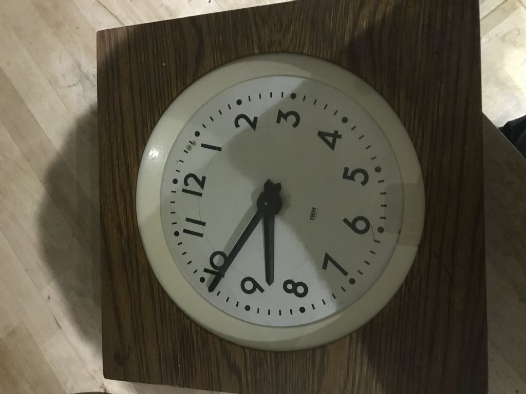

                                    I found a description of the IBM system here on the National Association of Watch and Clock Collector forum in a post by tom11443. He says:
                                    IBM/Simplex Synchronous Correction cycle.
                                    IBM developed this system in the late 1940s to replace the older ‘minute impulse’ systems. They sold their time equipment division to Simplex in 1958. Therefore, any clocks with the IBM logo were manufactured prior to 1958. The same basic protocol & mechanisms remain unchanged to the present. Several other manufacturers, including Latham, Cincinnati, Dukane, Standard Electric Time, use the exact same protocols.

                                          This is not a "IBM/Simplex Synchronous Correction cycle" clock as suggested by SOD, it's a minute impulse with sync. Normally 1 ppm on red back pair but if out of sync a (normally manually initiated) series of rapid pulses on the white / black fast forwards until the cam switch opens. A capacitor discharge as suggested by Bazyle is a good idea. charged to between 12 and 24 V by a series resistor and discharged by a transistor through the coil.
                                          Note that the IBM system is different in detail to the British ones.
                                          I could be persuaded to do a circuit for you if you wanted. For a little extra I could put an rubidium standard in it so you would have your own atomic clock with 1 minute resolution

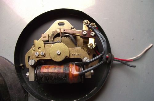

                                            EDIT : Sorry, I quoted the wrong source … [now corrected]
                                            Perhaps the hidden gem in the link that Peak4 provided is this picture of a Gent's movement
                                            Which bears an uncanny resemblance to Simon's "IBM"

                                              Posted by Michael Gilligan on 07/02/2019 12:27:15:
                                              Edited By Michael Gilligan on 07/02/2019 12:42:35
                                              Now that's interesting. Presumably someone fitted an IBM clock face to a Gent movement as a repair. I bet there's a story behind that!
                                              It's true the movement doesn't look like a synchronous motor – I assumed, oh dear – that the drum was hidden under the big central cam.  Wrong again.
                                              Good news really – easier to fake a Master electronically for an impulse type clock I think.
