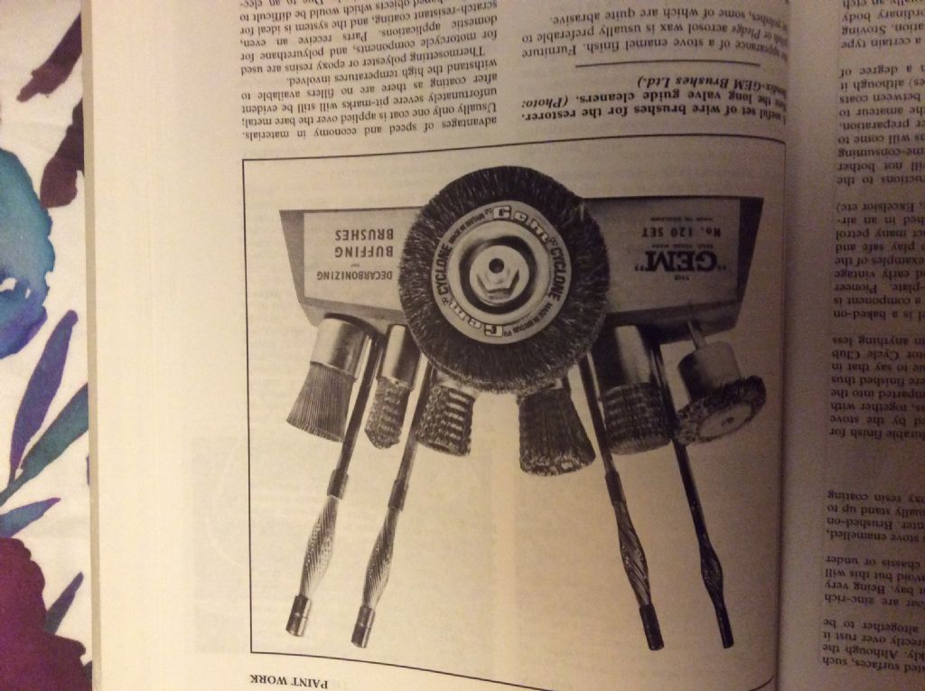

                                  IanH
                                    @ianh
                                    I found it illustrated in the Vintage Motorcyclists Workshop – it would appear to be for cleaning valve guides and could be had as part of a set of wire brushes.

                                    Mick Bailey
                                      @mickbailey28509
                                      I also maintain it's a valve guide tool for removing carbon without damaging the bore. No abrasives are used.
                                      If you used this as a pilot whilst cutting a seat, the cutter would follow the seat and not be rigidly and accurately centred to the guide bore.

                                      noel shelley
                                        @noelshelley55608
                                        Kiwi Bloke gets the money ! There valve guide cleaners, often to be found in the B&D valve grinding kit ! Noel.

                                          Tim Stevens
                                            @timstevens64731
                                            What it was intended for, what it was sold for, and what it was used for may be three different things entirely. But these tools are very handy for use on an oily, smoky engine, which has sticking valves because of burnt-on oil in the guides. As I'm sure Kiwi-bloke remembered.
