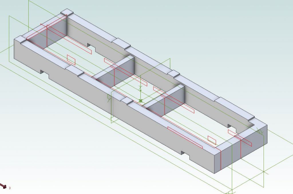

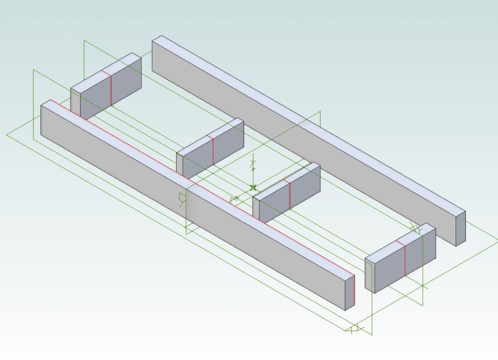

            I had a bit of a doodle of teh Victoria base casting and my thoughts on costings were about right. To buy two base castings will set you back £122 plus postage from Stuarts. They could be made in the sa,e way as the vertical I pictured above for 1/4 of that, aluminium would be £20 and say £10 for some M3 cap heads and a tube of JB Weld, less if you used steel flat.
            Make the basic frame parts
            Drill and tap the cross pieces and drill & counterbore the sides then screw together with a smear of JB Weld. Then a bit of milling to form the pads for various parts
            Finally add some feet, round the edges over and a bit of filler to add fillets to internal corners. I have also shown a bit more shape and taper to the base which is easily done by milling round the outer edges. Also omitted the unused bearing mounting pad.

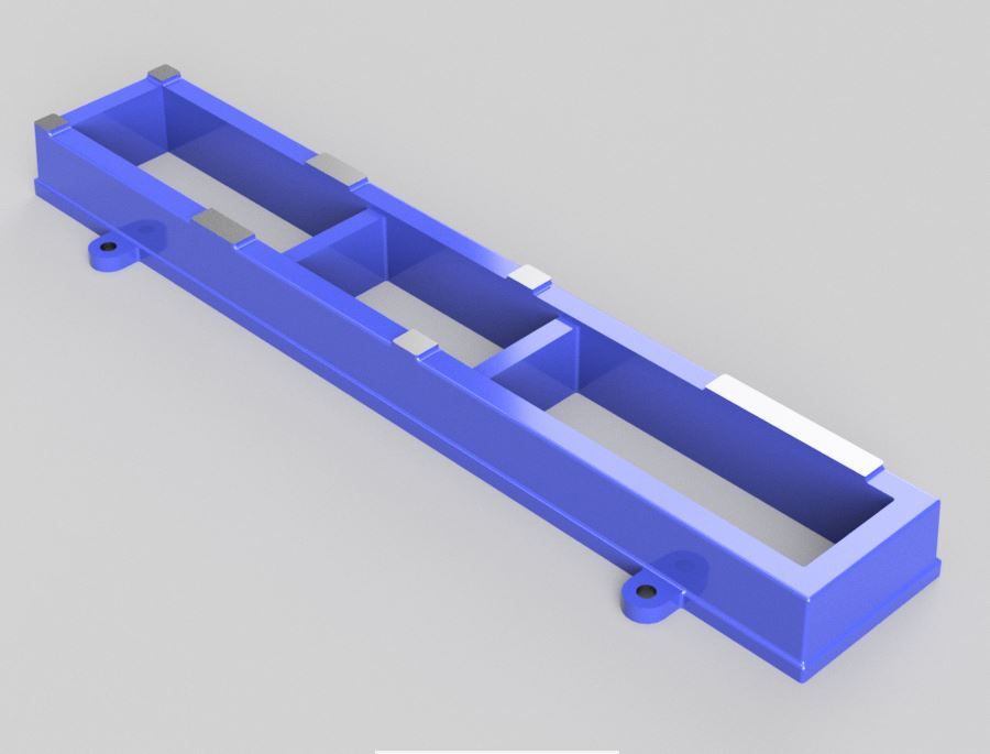

            If it were mine I'd probably go a bit further adding an integral "cast" mounting for the governor. Changing the way the cylinder mounts as the angled brackets onto the cylinder covers would never be seen on full size but just allow the same casting to be used on several engines. Would also do away with the feet as they are not really scale and show it is a model going for some round bosses on the top edge of the base for studs right through.

                    Plans show the machined features but easy enough to get overall sizes and thicknesses.
                    For this one I would make up the basic frame and then the ends can have the draft and moulded detail added by holding at an angle in the vice, the sides would need the underside of the vice packing so that work is therefore at an angle. A flycutter could be used as could a corner radius milling cutter or just use a flat ended milling cutter and add an internal fillet with filler. Have a look at the base of this engine being built.
                    Yes a smear of JB Weld on the mating faces. Use car body filler to add fillets to internal corners and fill the screw holes as it's quicker to sand than JB Weld.

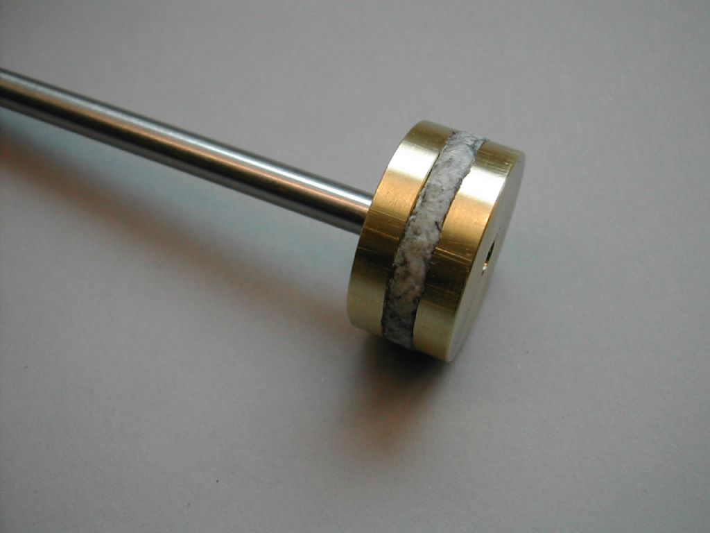

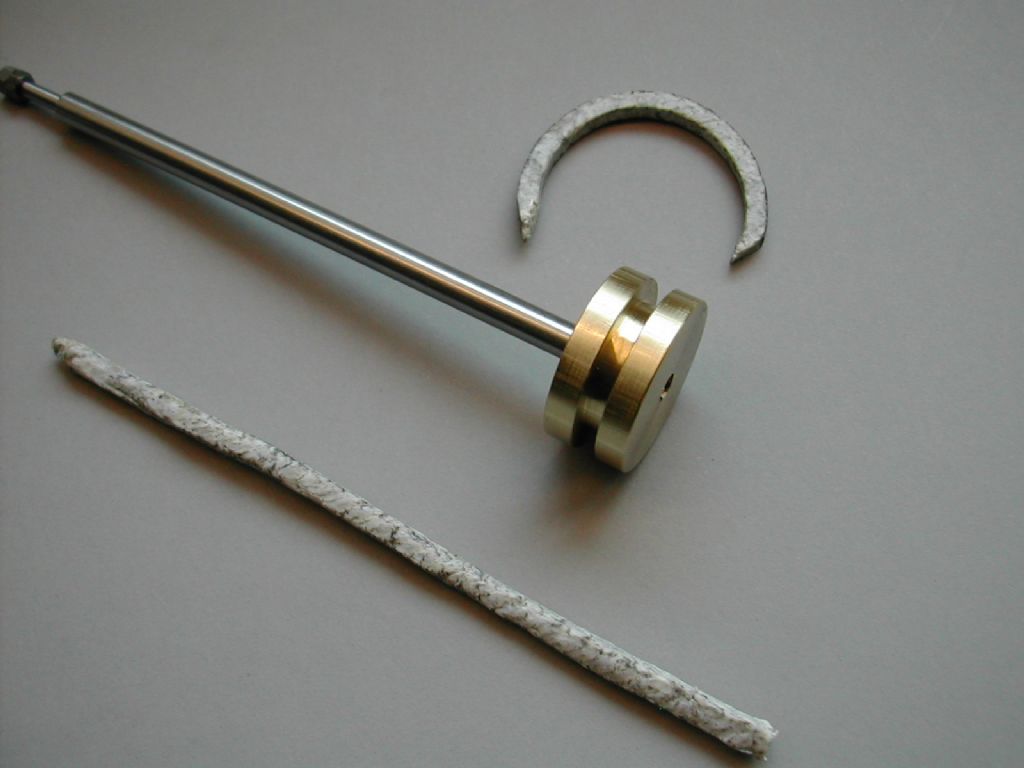

                              En1a freecutting steel will be fine for all parts on the Twin Vic. Continuous cast bar available from all the usual sources will be perfect.
                              Personally I wouldn't use cast iron for the piston but bronze instead and fit it with a PTFE filled yarn packing about 1/8 – 3/16 square in section. With a piston about 2 thou down on diameter this will give a virtually friction free fit but with an excellent seal and compression. I fitted cast iron pistons to my Twin Vic only to find the moisture left from running had rusted and seized solid over the long period before running again. Stripped it down, done as above, never had that problem since. To give some idea of the compression achieved, if I close the stop valve on the double diagonal engine and wind the flywheel backwards the compression builds up suffiicient to turn itself over about 3-4 revs. With valve open it doesnt feel as if there are any pistons fitted. Done this on all engines ever since but they do only run on air.
                              This is the sort of packing I mean – piston is out of the Waller engine
                              As fitted
                              I usually make the groove 2/3 thou shallower than the nominla thickness and the groove 2/3 thou wider, and as you can see the packing is fitted with a scarf joint.
                              I would stress this is only for running on air though I did run the Twin Vic on steam at shows for several years after fitting this method for several years without any problems
                              Hope that's of use
                              Regards – Ramon

                                    Just a point to watch for Dr G – be sure you get the PTFE impregnated yarn as opposed to PTFE pure yarn. The latter does look superb, is very square and uniform but frays as you look at it. I thought it would be perfect when I first bought some but its a nightmare to fit at these small sizes.
                                    The impregnated yarn is a fibre based product filled, as the name suggests with PTFE and silicone. It's soft and waxy to the touch whereas the other is very firm with little give.
