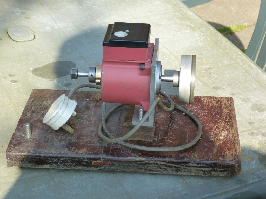

      p1030089.jpgThis pump was noisy and Mrs R complained, the pump was slung in the back of the shed awaiting sentence.
      A few bits from the junkbox and a silver steel shaft to replace the 10mm ceramic shaft and some ball races (ex junkbox). The inner stainless shield and ceramic bearings were discarded although the new shaft did run fairly ok in the ceramic bearings. A very handy little grinder, just needs a simple grinding rest now.
      A warning though, the rotor is jacketed in stainless steel and has sharp edges – be careful, I found out the hard way.

                Nice conversion. .ceramic bearings eh…..
                Does it have the speed/torque..seem to remember these things are stallable..might even be an advantage….

                          I am amazed at the mirth generated by this post. The OP had just modified a central heating pump to make a motor for driving a diamond abrasive wheel. It was not a finished project just a report on the conversion of a clapped out pump into a potentially useful grinding set up. For me the OP should be applauded for his original thinking.
                          If I put my negative H&S hat on then the big danger I see is actually the rather long, thin unsupported shaft carrying the diamond abrasive wheel. This could bend and buckle if there was the slightest imbalance in the grinding wheel!!!!
                          Calm down, have another glass of wine (but don't go into the workshop afterwards!!!!), relax. Enjoy the ingenuity in re-purposing a redundant pump into a motor.

                                                      Well thank you all, I had not intended to stir things up so much. The motor runs about 1500rpm and rated about 100Watts and is OK for sharpening small drills, gravers etc – so you work from the front and likely to be out of line of fire in the unlikely event of a lump flying off. I can fit a small aloxite wheel but it is more trouble than it's worth – I use a conventional guarded grinder – with proper guides etc. Nevertheless something could go wrong and risk is always worth pointing out, I am certainly not pissed off with advice.
                                                      I have been tinkering for well over 60 years and worked in industry long before H&S was a big deal, people got hurt and little or no compo for it – you learned to look out for yourself and your mates. Most of my work now is on a 6mm watchmaker lathe or an ML10 (with looseish belts) and a 1940s sensitive drill and the worst I get (so far) is a (rare) whack on the knuckles from a chuck jaw or what is left of my hair caught in the drill belt and I do wear eyeshields when I feel nervous or the swarf flies about. So to all, stay safe, think 'what could go wrong', some of you use much bigger kit, a visit to A&E is very boring. Finally, the grinder in my first job was an old series motor and open wheel loosely screwed to the wall at face height – that was a bit scary.
