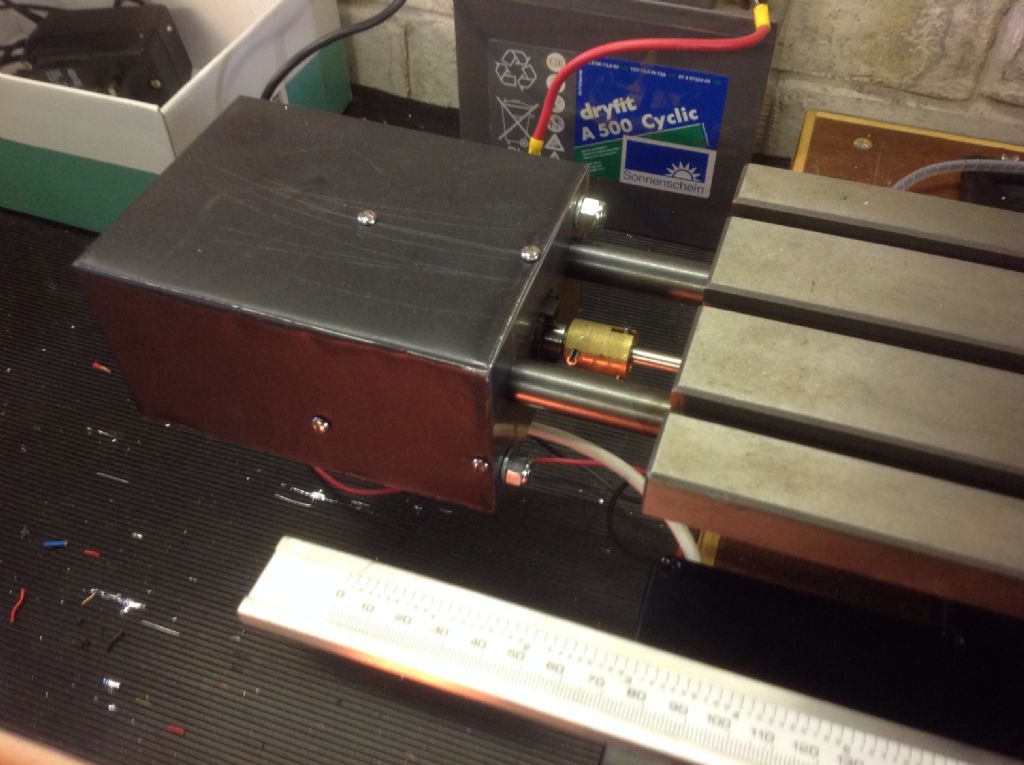

            The cover for my power feed was made from the top of an old CD player I picked up whilst I was at the recycling centre. My wile is worried that I'm going to start to bring back more than I take!
