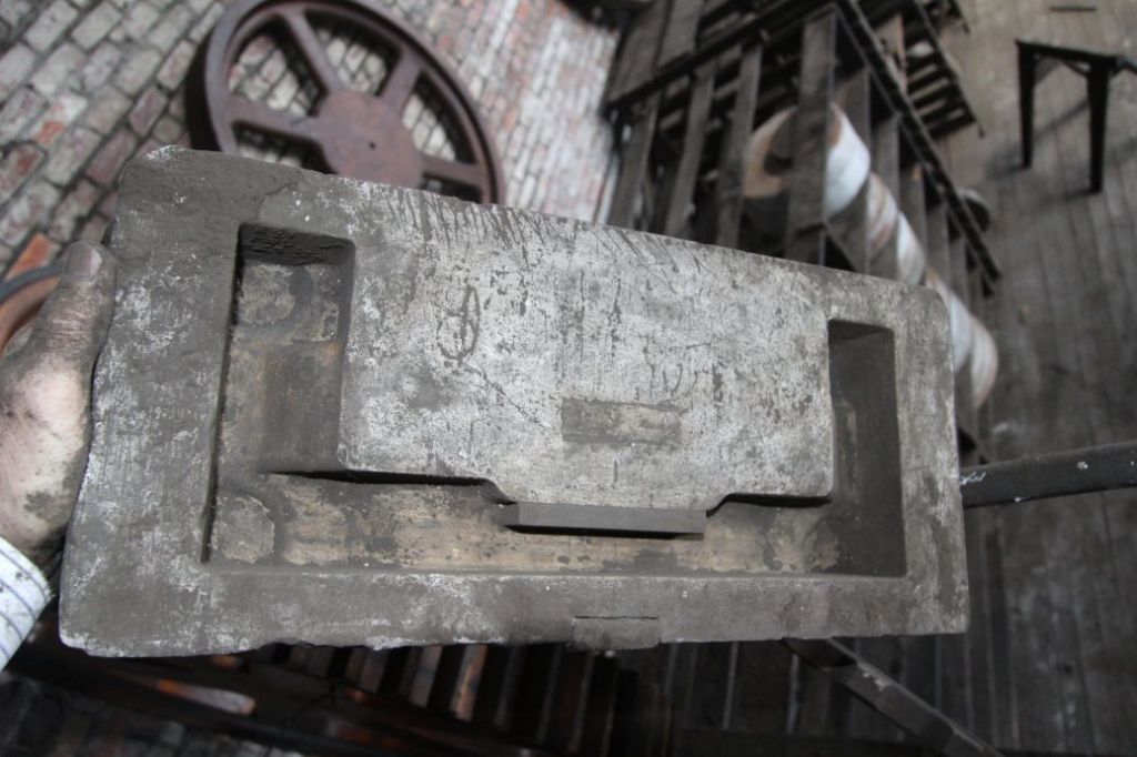

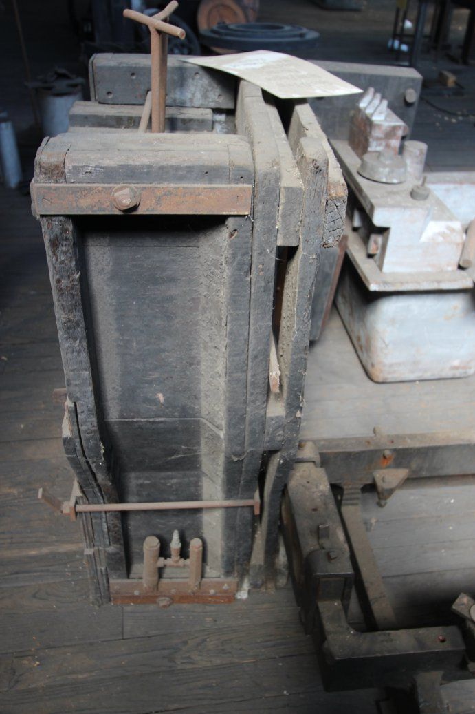

                  Just when you think you have seen it all. I thought the Play-Doo extruder was a modern creation.
                  I found a lot of the matchplates for the Speedy Twin steam engine at the Soule Museum, but nobody knew anything about the coreboxes for the complex passages that are at the top of the engine.
                  The allowed me to search through the multitude of patterns in the pattern room, and I finally found one of the passage core boxes.

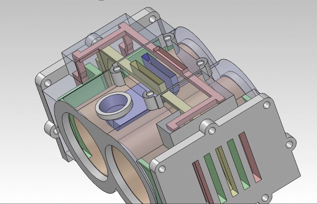

                  The corebox below would be for the beige passage shown in my 3D model.
                  Edited By PatJ on 05/07/2022 22:08:04

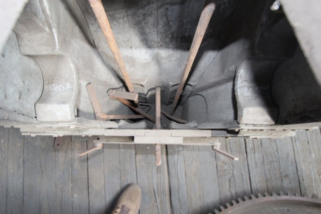

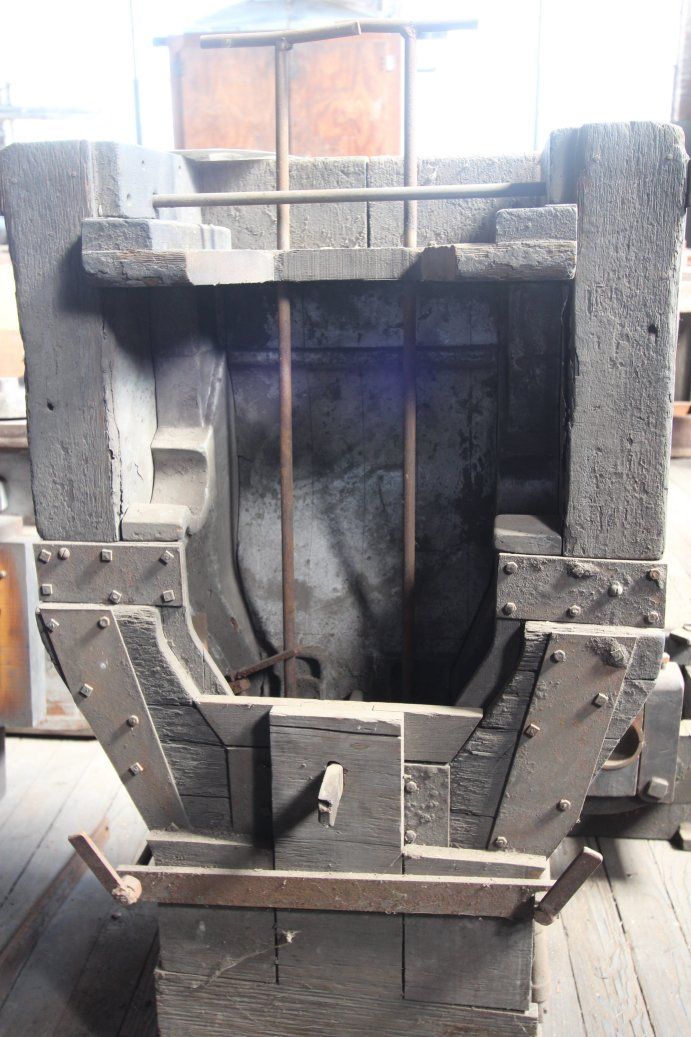

                    This is the horizontal part of the red passage in my 3D model above, and as you can see, it is quite a bit larger than I modeled it.
                    Its fascinating to find the actual patterns and core boxes for an old steam engine.
                    Edited By PatJ on 05/07/2022 22:16:25

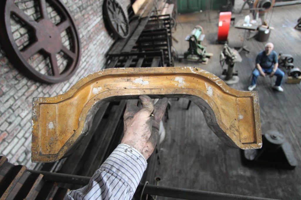

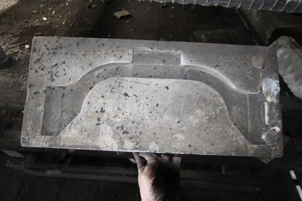

                      This is the original Speedy Twin frame corebox.

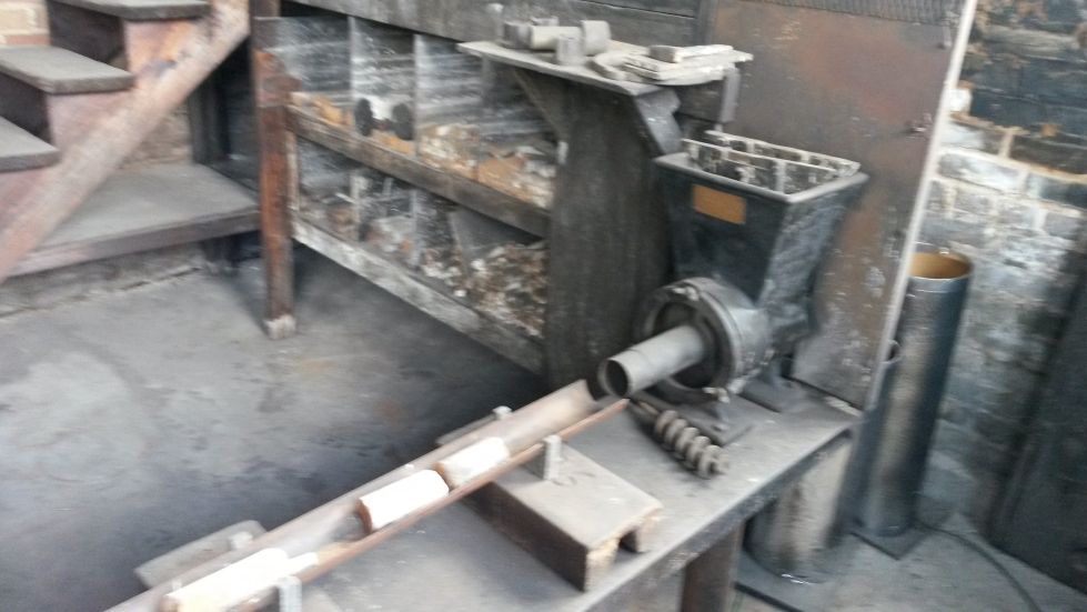

                        And low and behold, here is an extruder at the Soule factory.
                        I don't think I ever noticed it in the photos or in person, but now that Jason pointed one out, there it is !
                        Edited By PatJ on 05/07/2022 22:31:47

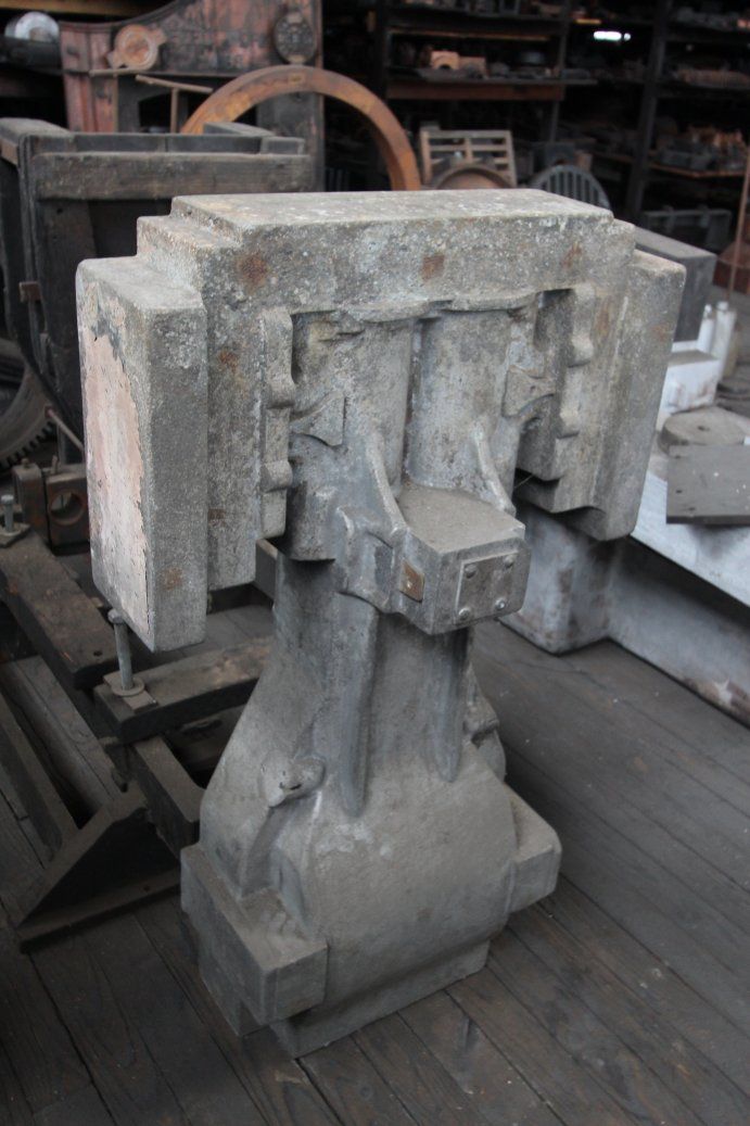

                          Here is the Speedy Twin frame pattern, with multiple coreprints.
