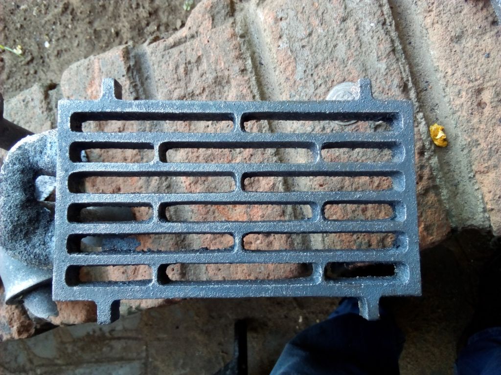

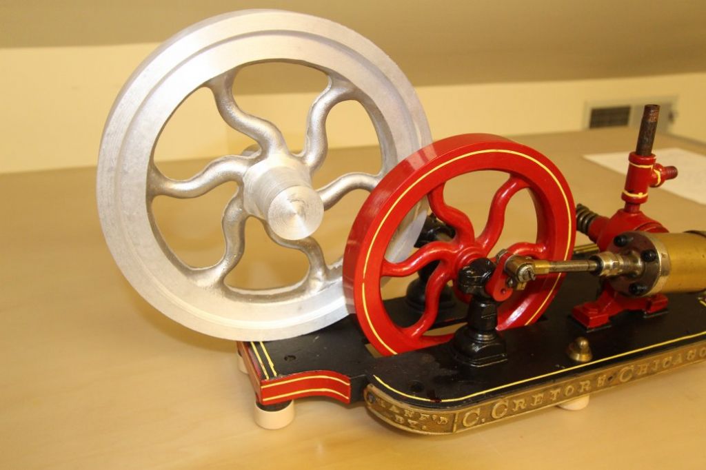

      I've been enjoying the discussions on casting recently, and started this thread to compare the various methods and what has been cast. The idea is to match setup with results. I'm curious to see how my 'DIY everything' compares to other setups.
      Furnace: Crucible (bought A4, furnace designed around this), blower (from a vacuum), atomisation tube, lining monolithic castable.
      Fuel: Waste oil, gravity feed, (sometimes thin with diesel depending on what I'm casting)
      Sand: Green sand, (sand from river) and bentonite. (Additives: flour, coal dust, and wood dust depending on what I'm casting)
      Mould coat: none, but do sometimes dust with flour or graphite.
      Patterns: Initially wood, currently 3D printed

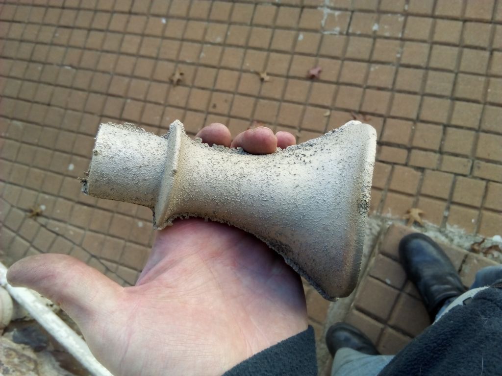

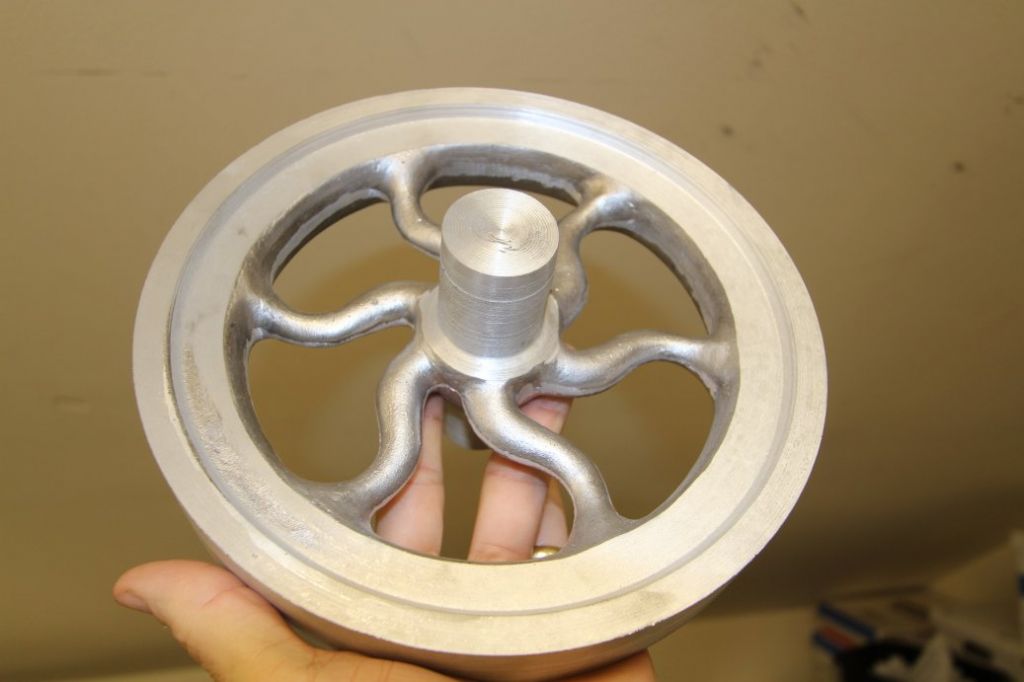

      Materials cast: Aluminium (various), a number of bronzes and some development alloys, cast iron of various grades, copper, different brasses. All cast from base metals scrap.
      Aluminium:
      Cast iron and bearing bronze:

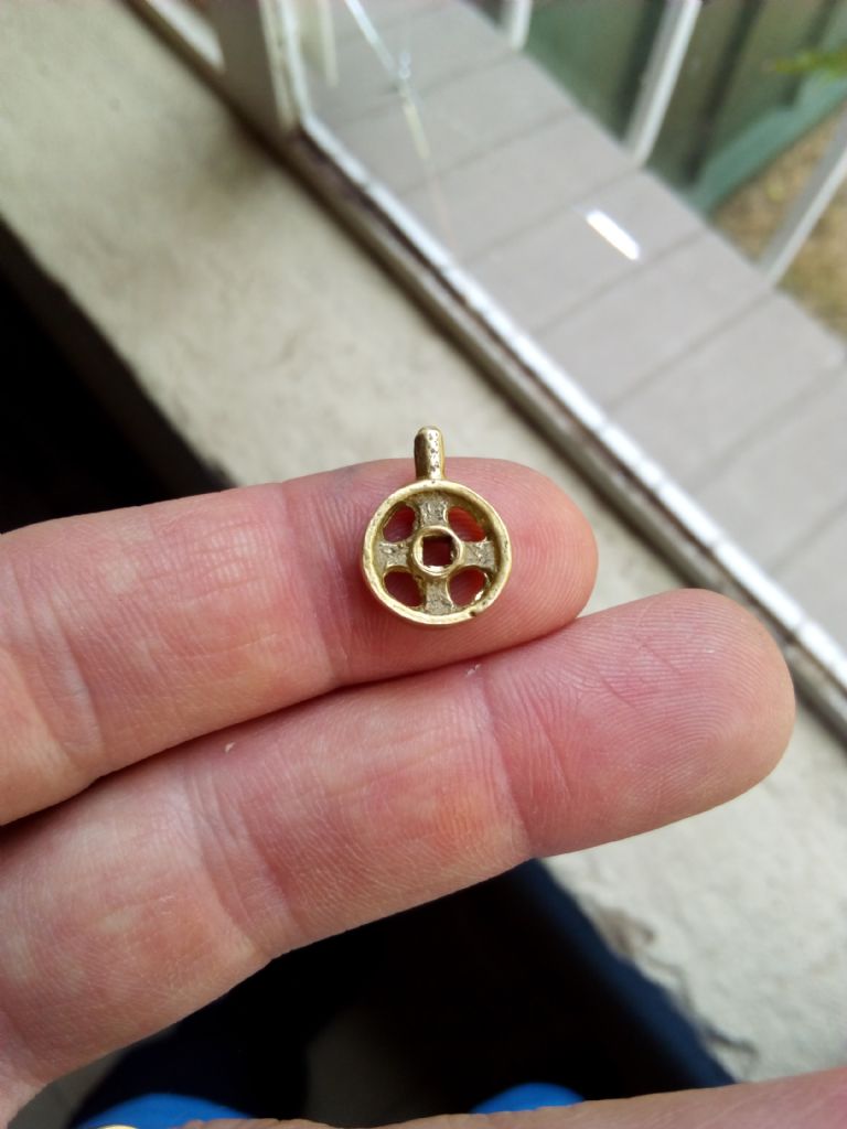

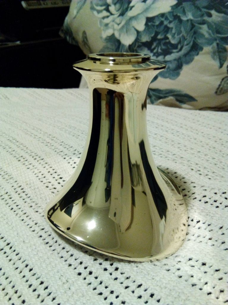

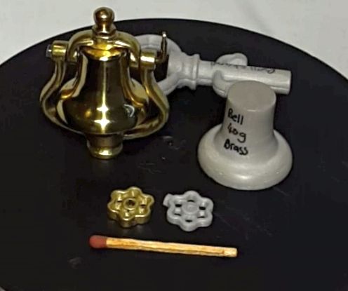

      Ornamental brass

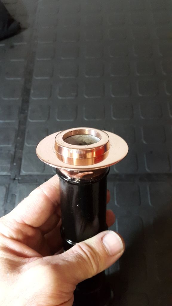

      Copper (one of the more difficult things to cast)
      High heat cast iron

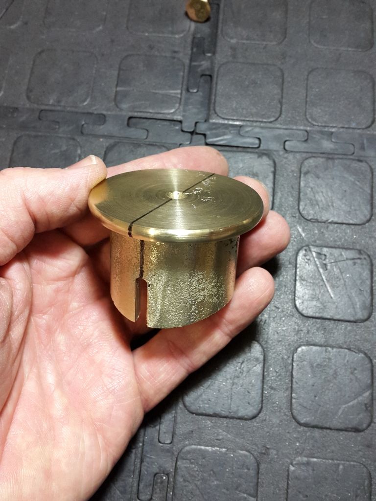

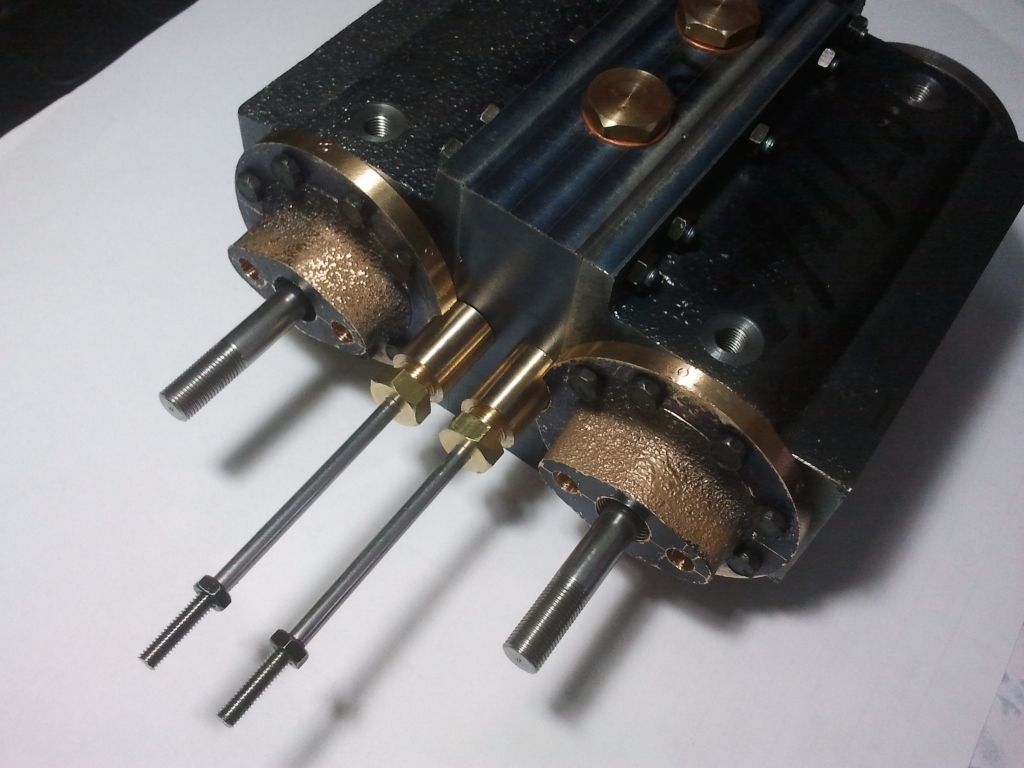

      A replacement alloy for gunmetal (cylinders)

        Comparison of casting setup and results

          I know less than nothing about casting metal, apart from what I read here but those results are mind blowing. You must be very proud of your achievements. Phil

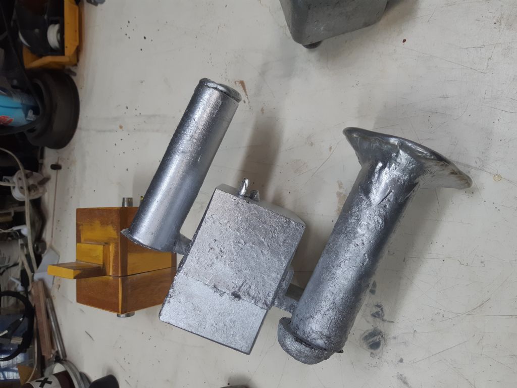

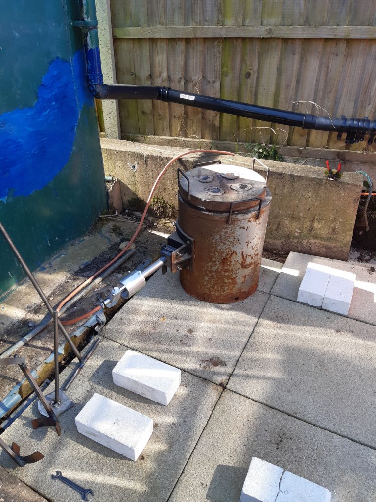

            I'm very much a beginner, but have a number of things in the to-do list if I ever get around to them. Only poured aluminium thus far and have more learning to do before I advance on to other alloys:-

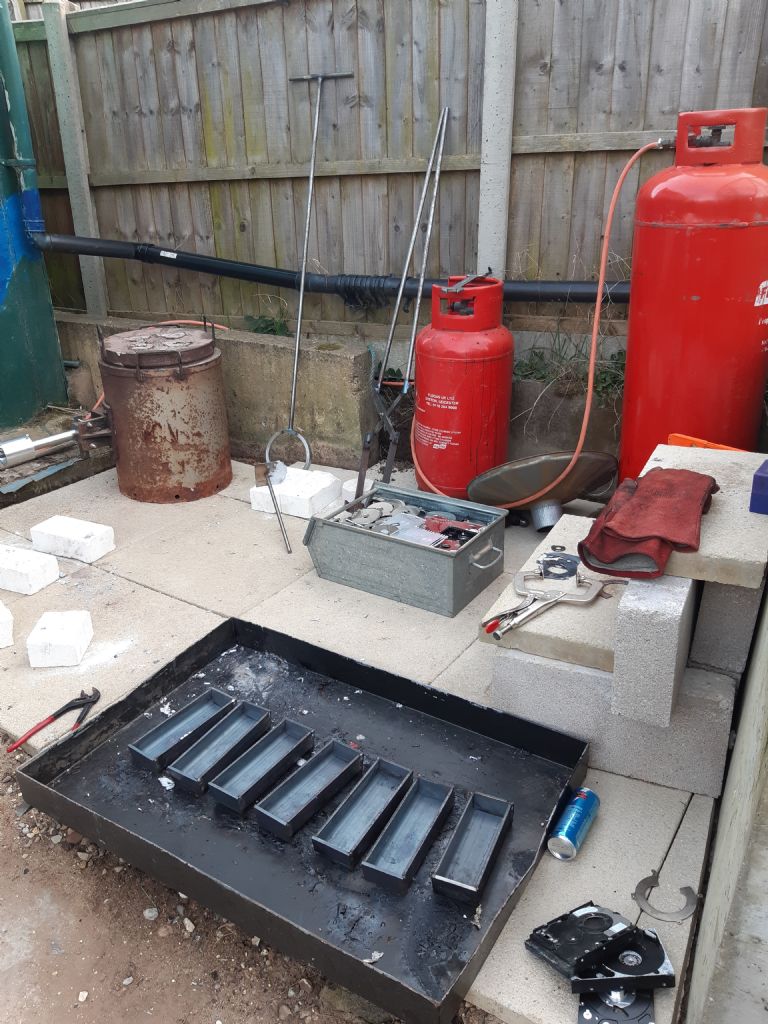

            The furnace is an EBay Amal find that had seen some use but has more life in it. The burner is a home made naturally aspirated venturi propane burner with the mixture controlled by sliding the gas injector in or out of the venturi's throat.
            The first operation was to turn a large collection of hard disks, plus a couple of scrap castings into ingots. The ingot moulds are welded up from steel channel with the natural draft of the channel, plus sloped ends. Ingots can be knocked out almost as soon s they've solidified..

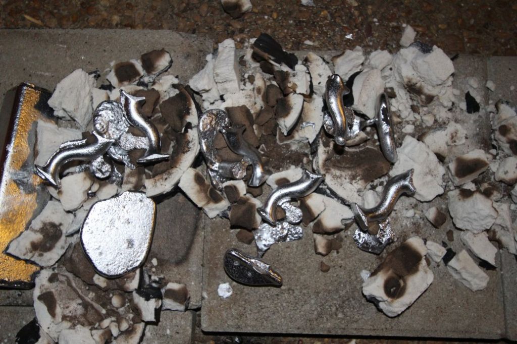

            This was the result of the first day's operation. 35kg of ingots and a lot of dross. For subsequent pours, I used a drossing flux and the dross was just dross and not mostly aluminium. The ingots are stamped up as to what they came from to allow me a choice of alloys.

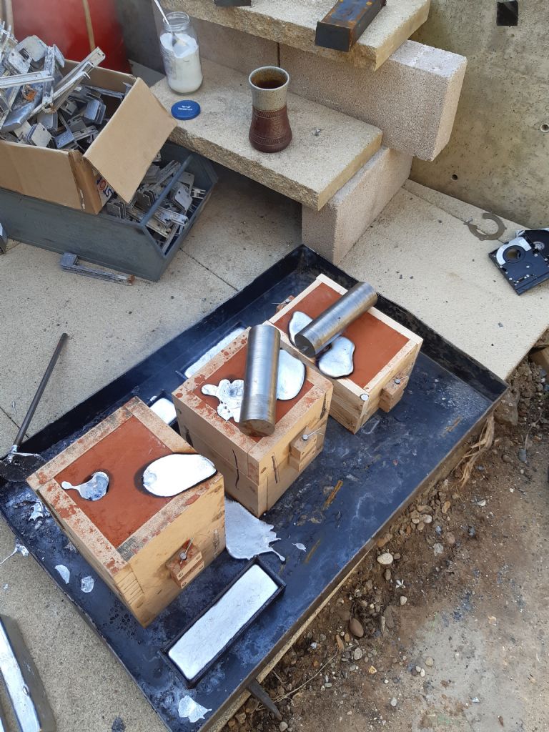

            The flasks, so far have been made from wood and were about the right size for the desired castings. Sand is EBay Mansbond oil bonded sand.
            The first pour. I had a few problems initially but did better with later attempts (that disn't get photographed).
            One if my first successful casting, from a small number in total. It's a switch box for my Beaver milling machine, since the replacement switch was much deeper than the original. A building sand and sodium silicate core was used.

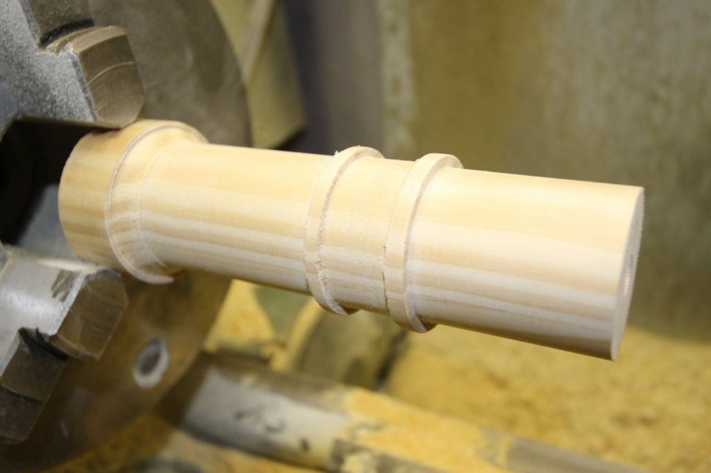

                    Just one tip to offer – do not chuck casting sand straight onto pattern. Use a fine seive and seive sand onto pattern until it is covered. Then use the sand to pack the box. This will give a much better finish to the casting. T. Oliver.

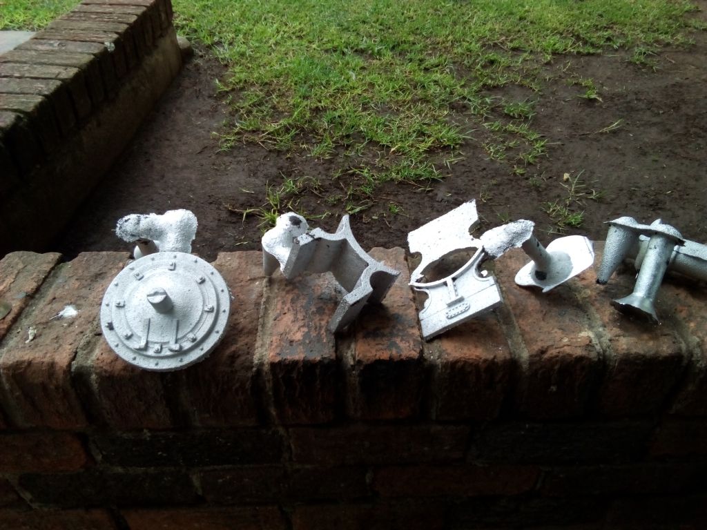

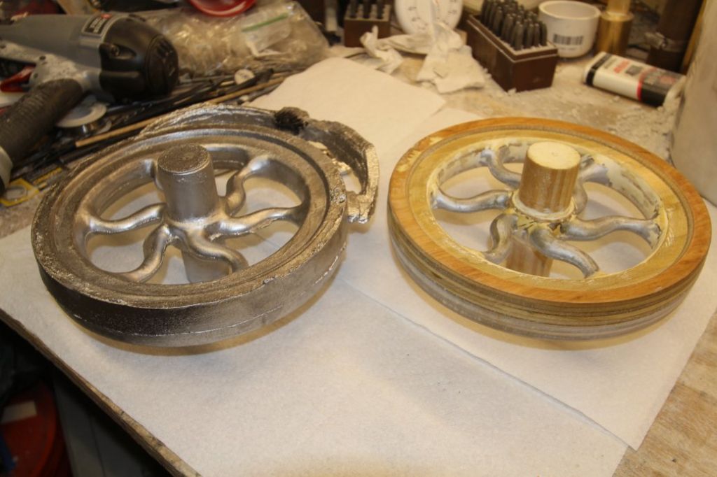

                        Pat you may like these, some slightly more technical castings:

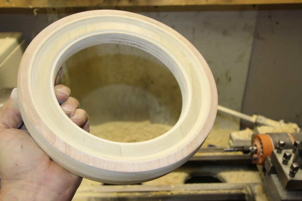

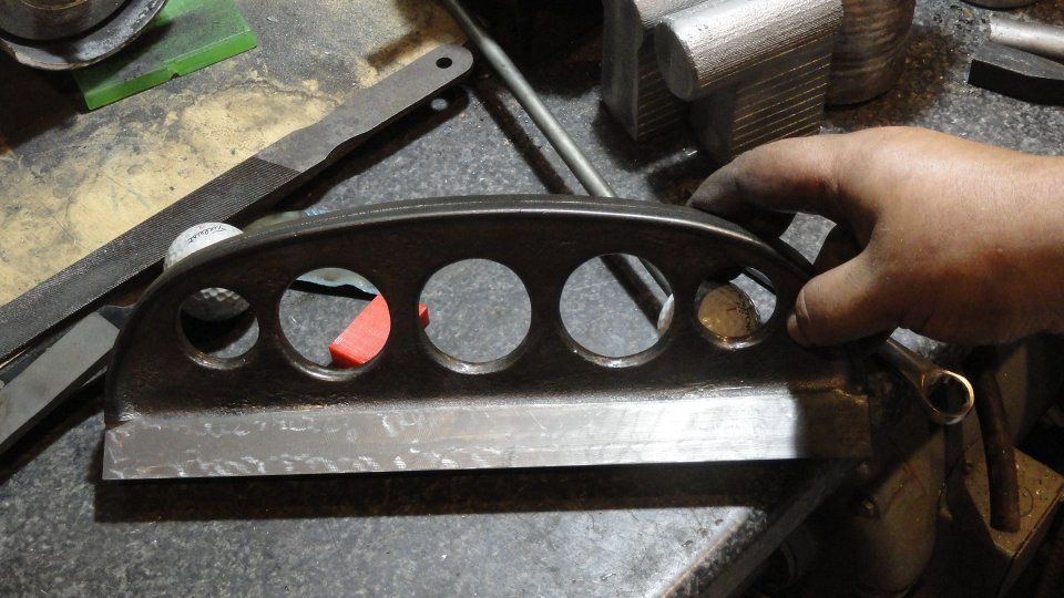

                        The compensating lever (as cast) on the Wahya, the thickness is 4mm with the ears and middle opened to a 2.5mm wall thickness for the upright levers to go through. Its a ductile iron (mixed from pig iron to get the chemistry correct). This lever is on the suspension and sees a lot of vibration from the track:

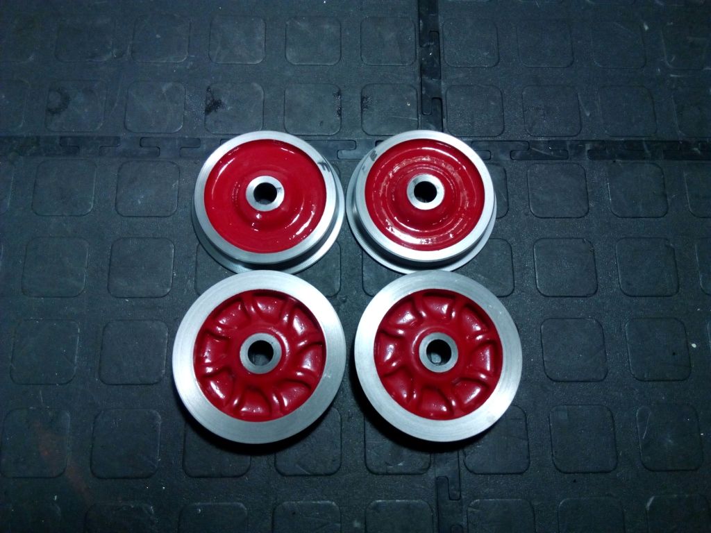

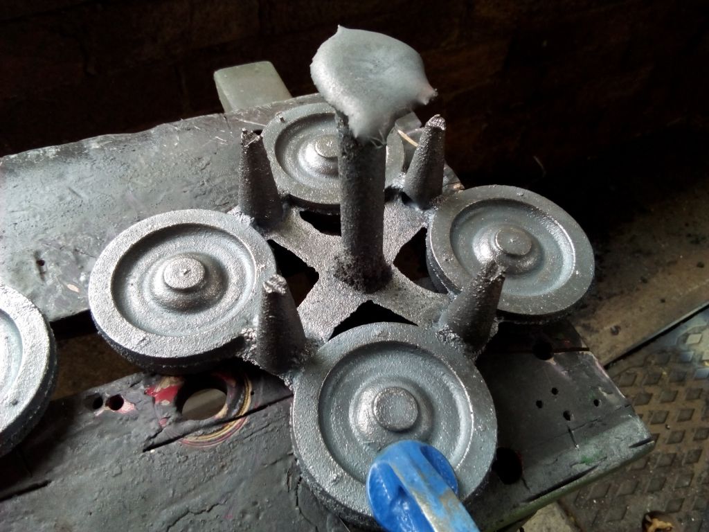

                        The bogie wheels cast for chill on the running surface, by changing the FeSi and (outer) sand composition. The axel boss needed to be softer for a press fit. The outer surface was machined with a tip tool and was much harder than the rest of the casting.
                        I cast a lot of smaller components for my locos. These get polished in a DIY tumbler.

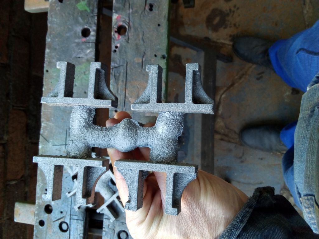

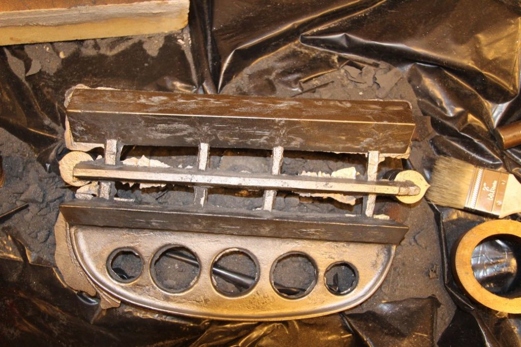

                        Here's an interesting component with a zero deg draft on the outside and a 5 deg rammed green sand core all the way to the lip. This was rammed normally (with nails) to keep the core in place when removing the pattern.
                        Bogie pedistals with a rather thin wall thickness (to scale) that has managed to survive our rough track

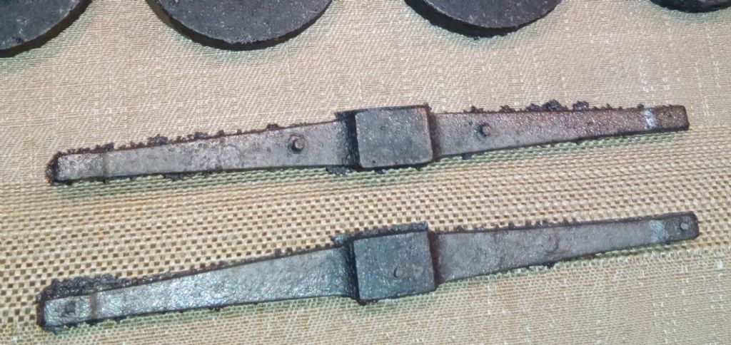

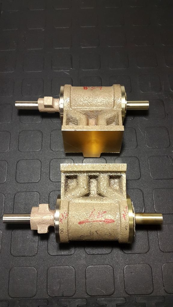

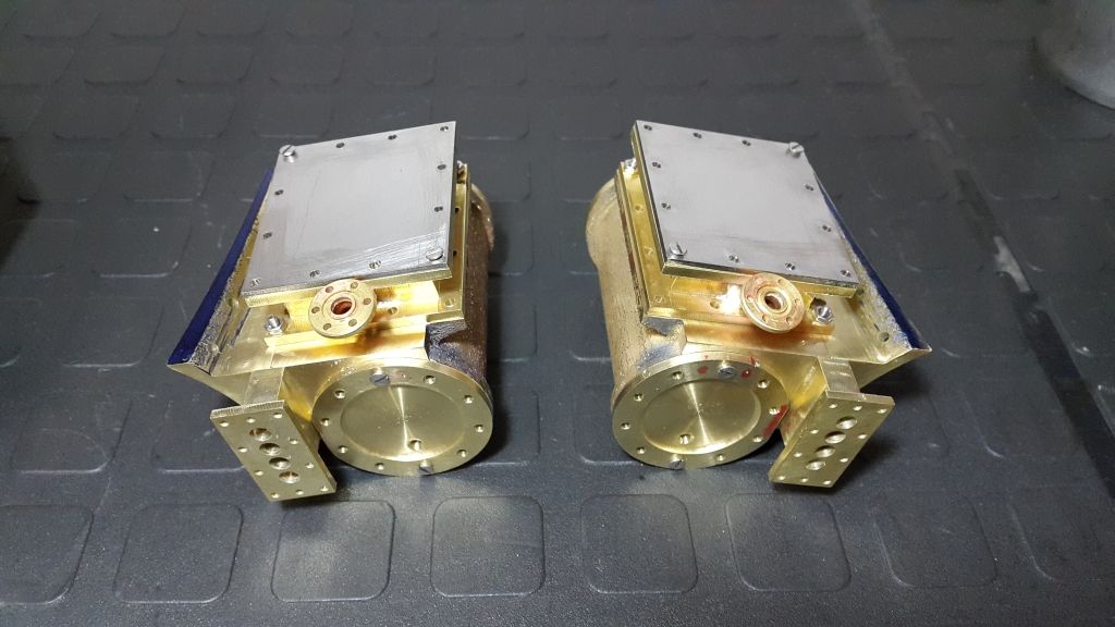

                          Cylinders for the Ballaarat:
                          Cast iron straps and cast iron eccentrics for the Wahya, these worked incredibly well:

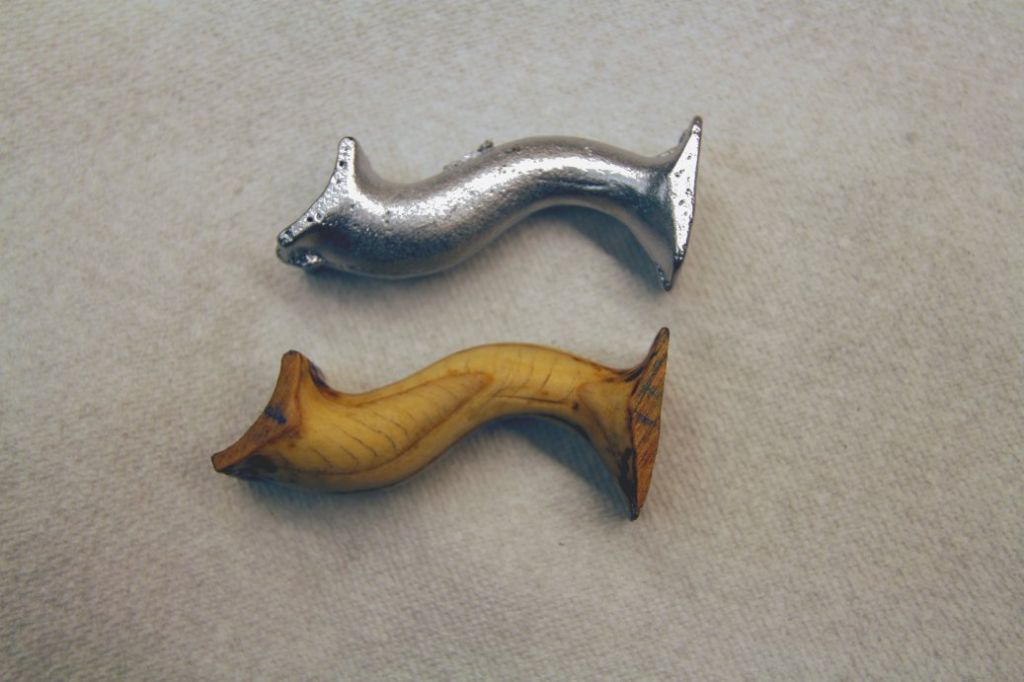

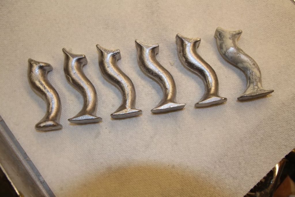

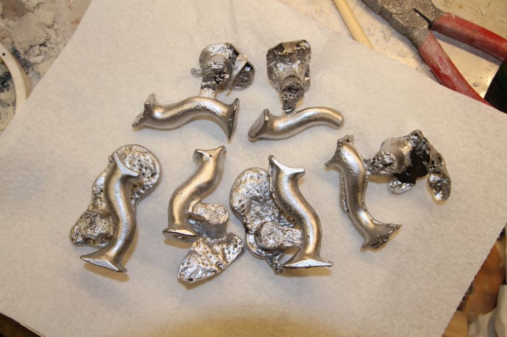

                          And then there's all the special handles for the various builds: These were tricky because they are double sided with a split pattern:

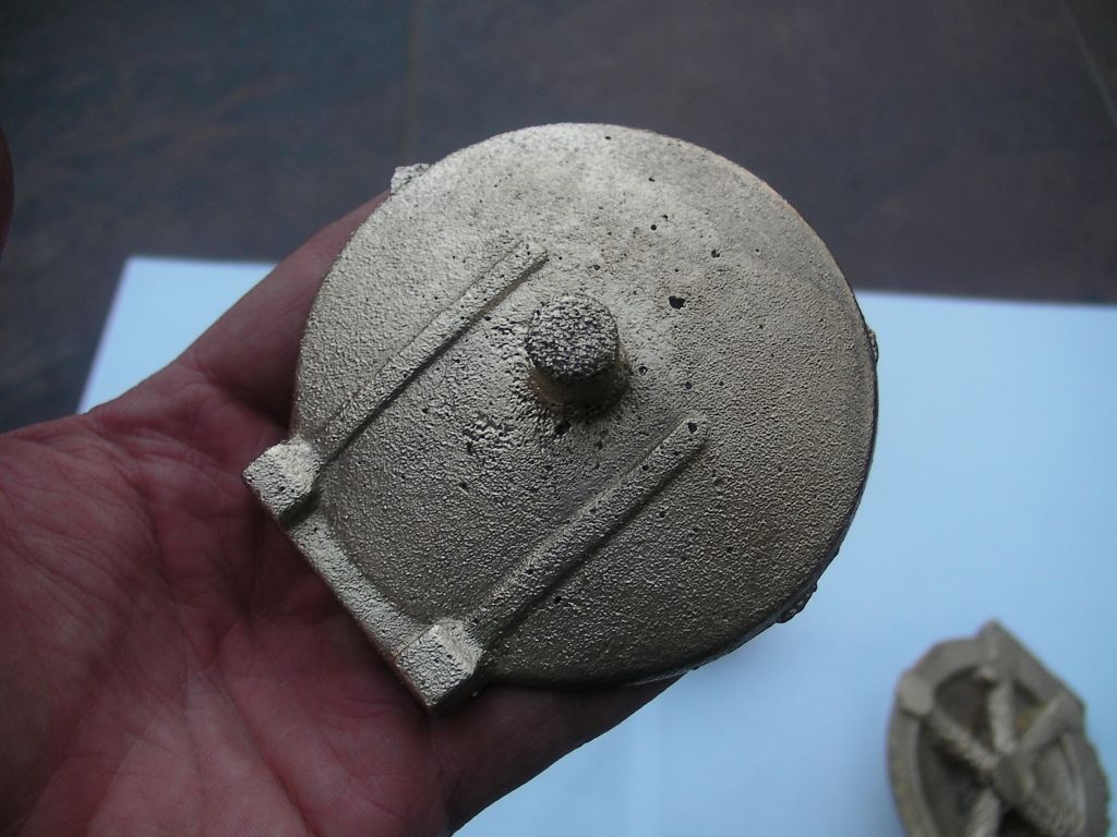

                                I took up casting out of necessity, because I couldn't afford castings. I designed and built my furnace from first principles, so that was up and running relatively quickly. Other than the lid mechanism the furnace hasn’t changed much over the years. I’ve only relined once (a few years back). When I started casting I visited a foundry and got some advice and phenolics from the foundry manager. My very first attempt at casting was a failure and I quickly realised the advice was rubbish but the phenolics worked well.
                                I read a few engineering books on casting and modified the maths and assumptions for the methoding of my smaller moulds. The next time I cast was a success and other than the odd short pour or burnon I don’t have many failures. The initial calculations were all hand calcs but I later wrote an algorithm to calculate the ingate, risers etc.

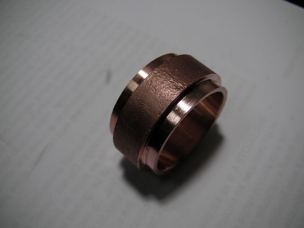

                                Incredibly I even managed to cast the firebox hole for the boiler in copper (one of my first pours), a little luck involved here. That boiler is still going strong.

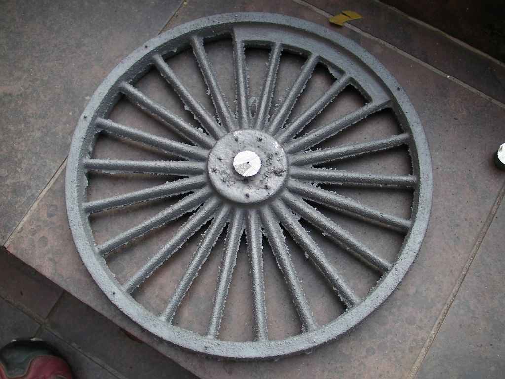

                                My first cast iron casting was the large wheels for my Stirling 71/4g. Phenolics were not available and I decided to go for green sand, which makes more practical sense if you casting larger moulds more often. I couldn’t include risers and the sprue needed to be smaller due to the size of my cruicible. This was difficult to cast and I had to pull a few tricks to prevent draw. Ironically a rigid mould using phenolics would have worked fine because the expansion phase feeds the mould without the need for a riser.

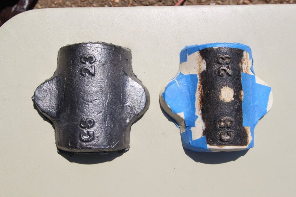

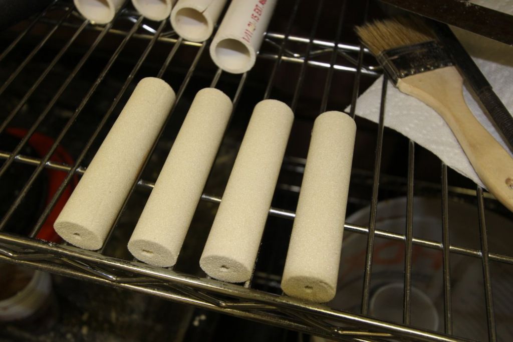

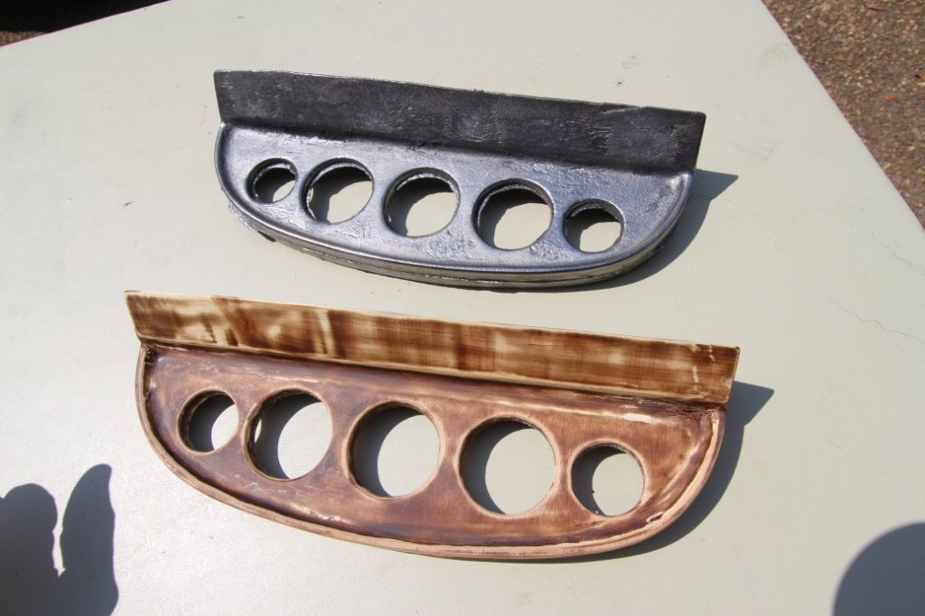

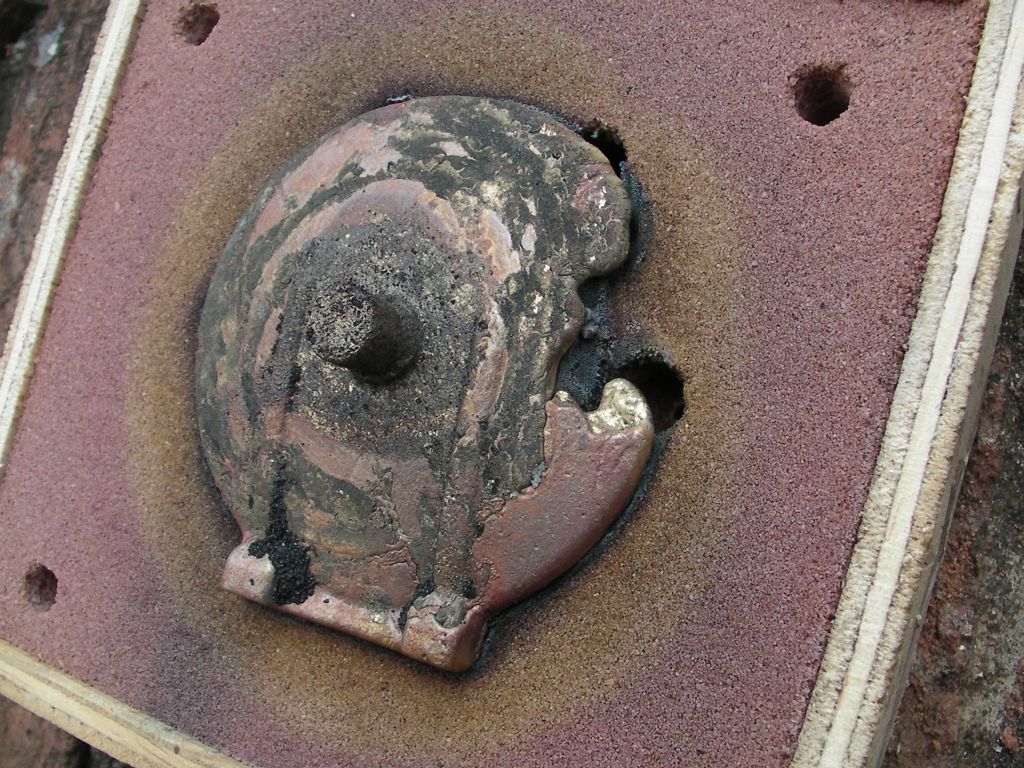

                                            I discovered alcohol-based ceramic mold coat (I use it with resin-bound sand), and it totally stops any burn-on of the sand.
                                            The castings can be lightly wiped with a dry paintbrush, and that is all that is required to get a clean bright surface.
                                            Example of some plaques I cast in iron below, where ceramic mold coat was used.
                                            I literally turned the castings over, wiped then with a dry paintbrush, and the result is what you see below.
                                            No wire brushing, no buffing, nothing.
                                            Edited By PatJ on 05/07/2022 14:54:20

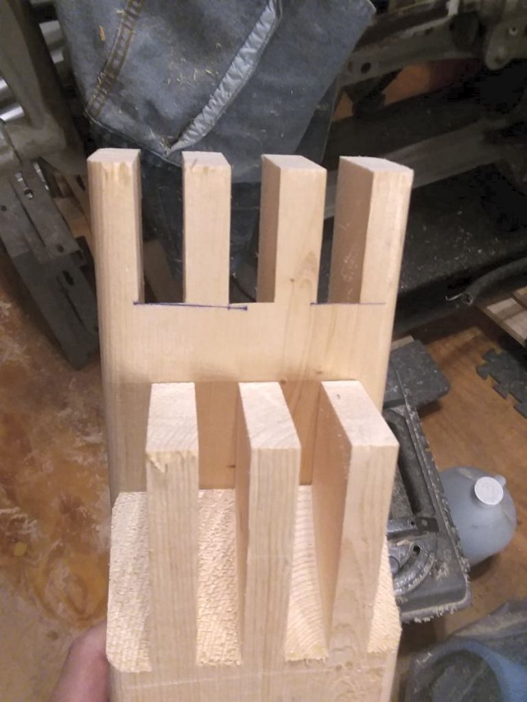

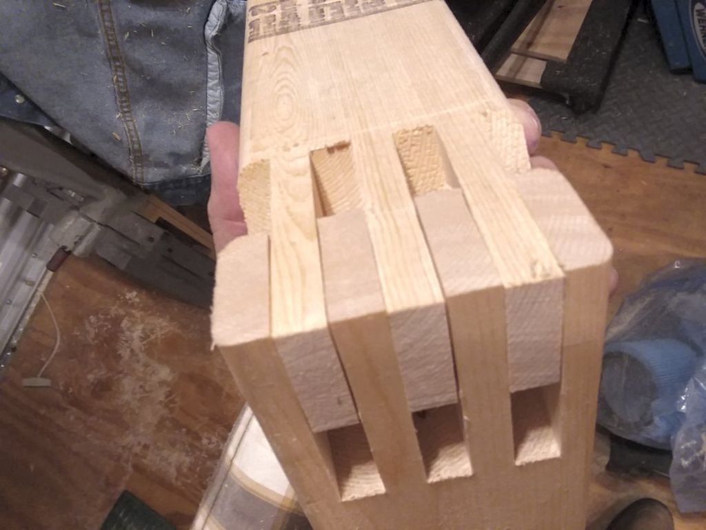

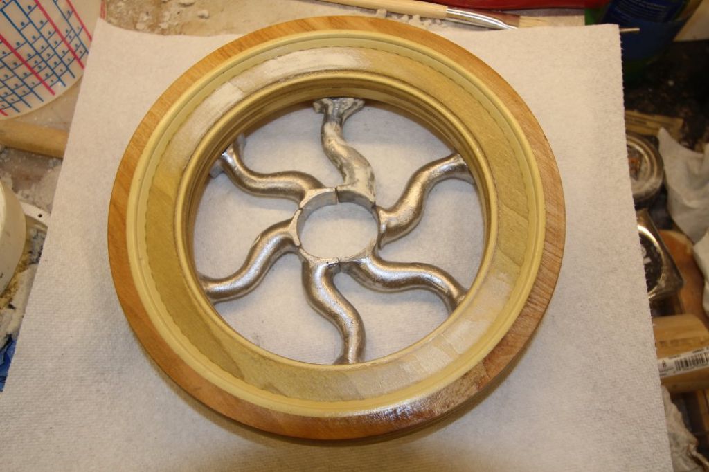

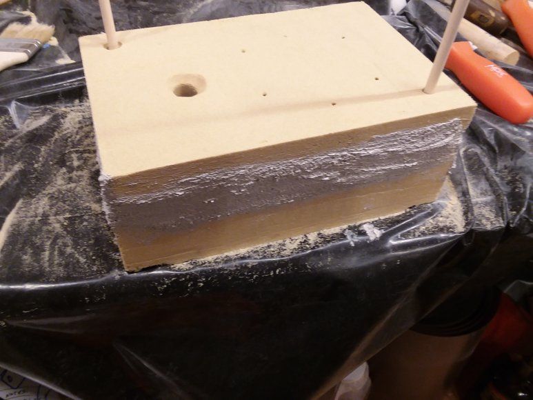

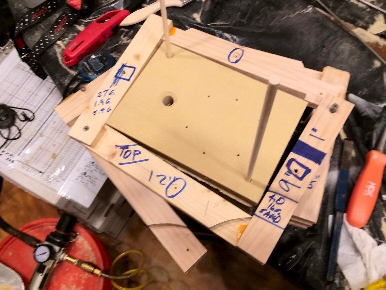

                                              I use custom snap flasks, with finger joints, and these work well.
                                              I never pour a mold when the flask around the sand.
                                              I adhere the two resin-bound mold halves together with foundry adhesive.
                                              I have some new adhesive that goes between the mold faces, not around the edges as shown in my photos.
                                              For cope/drag alignment, I drill a hole on either side through the wood.
                                              Contrary to what I have been told, the alignment holes do not have to be drilled accurately, and do not even have to be vertical.
                                              Alignment pins are 1/4" and 3/8" steel rods, often with a dog leg bent on the end to assist in pulling them.
                                              I don't use any hardware on the sides of my flasks, and side hardware is totally unnecessary.

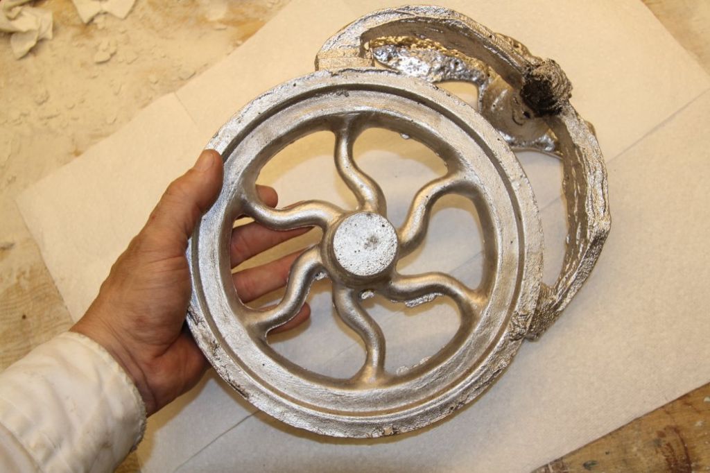

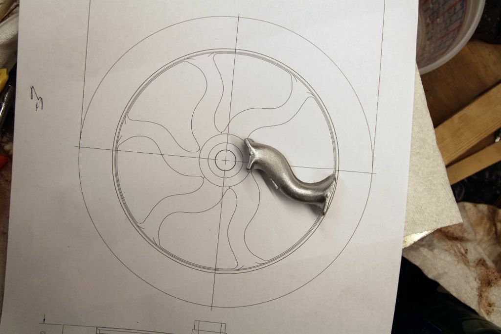

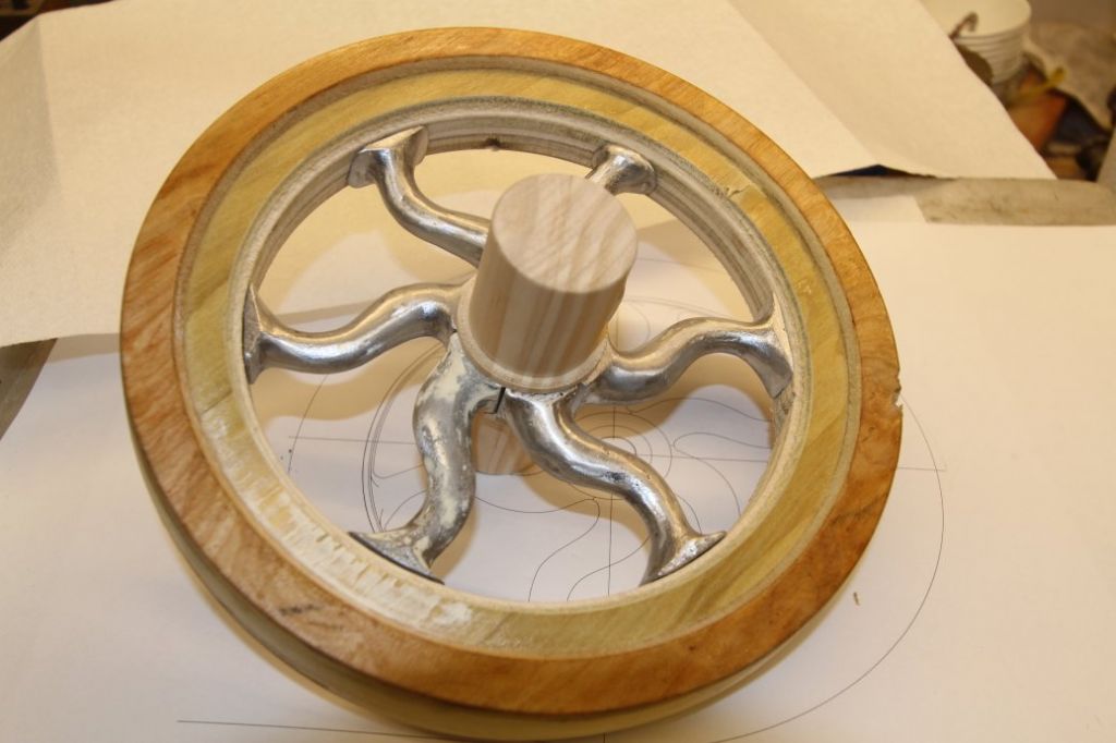

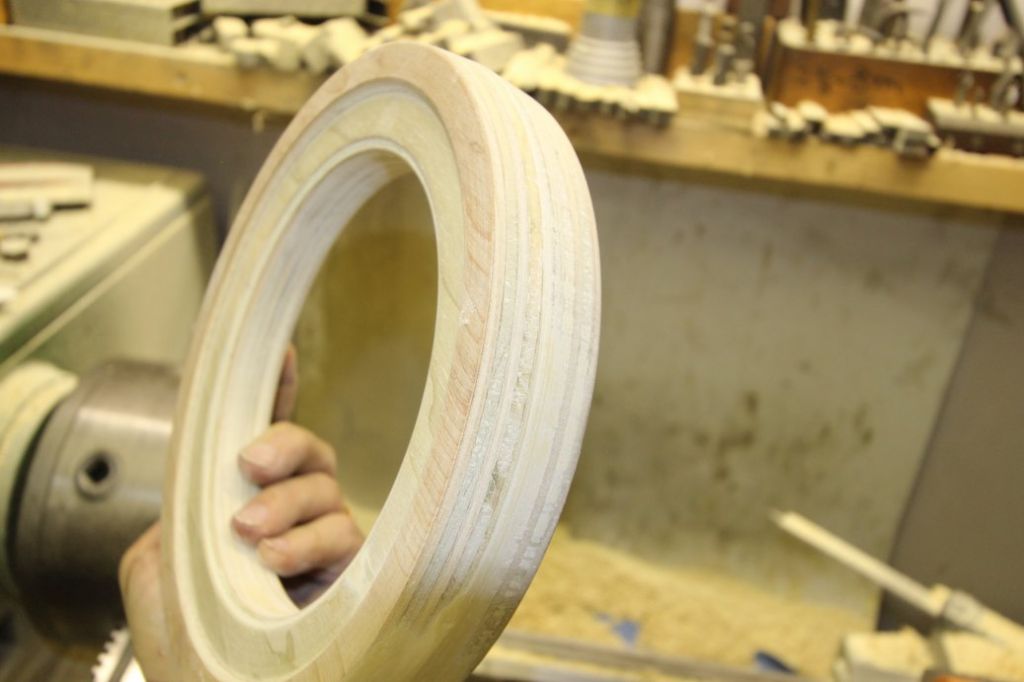

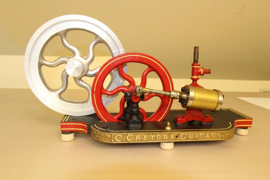

                                                I have studied the Cretors designs for years, and decided to try and cast an enlarged Cretors No.02 flywheel.
                                                I carved a spoke in wood, cast six of them, turned a rim and hub in wood, glued it all together, and made a casting.
                                                It was just a proof-of-concept thing, and while I had a bit of shrinkage in the rim, I totally proved this method as valid, but was not really expecting this to succeed, and fully expected this to be a spectacular fail.

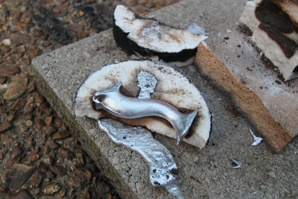

                                                  A buddy of mine sent me a camelback pattern, and I was able to get a pretty decent casting from it.

                                                    @patj87806

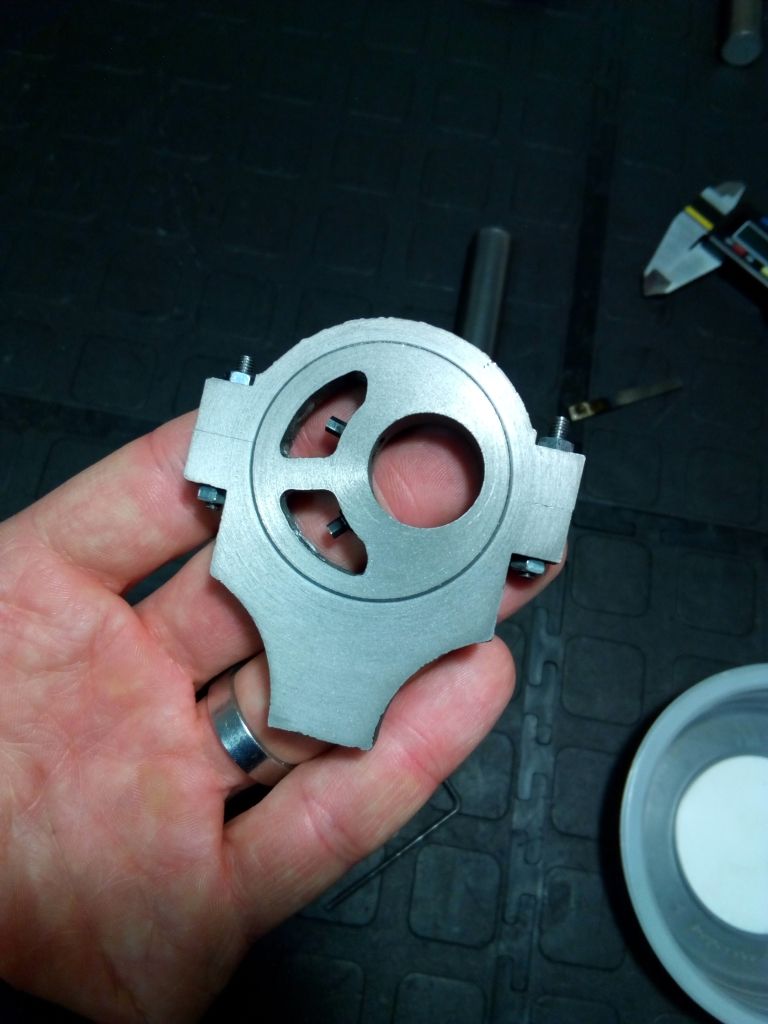

                                                    Another buddy broke the bearing housing on his large buffer, and so I cast him another one in iron.
                                                    Sort of a quick sloppy repair job on the original casting, which was used for a pattern, but this was a freebie, and it turned out pretty well.

                                                      Here is another trick I came up with.
                                                      Everyone uses two-piece coreboxes for making bore cores, and so did I for a while.
                                                      Then I slit a piece of PVC pipe down one side with a very thin dremel slitting saw, and cut a screwdriver blade tip-sized slot at the center of the length of pipe.
                                                      Makes a perfect core very time, and you don't have to keep up with two corebox pieces, or try and lock the two corebox pieces into an accurate position.
                                                      I have only seen one person adopt this method.
                                                      Most use two piece coreboxes, because that is the way it is always done.
                                                      In retrospect, I think it is good that I had no foundry experience when I began trying to cast things in 2012, since I had no preconceived notion about how things MUST be.
                                                      I have met some old Navy foundry folks, and they always say "I was in the Navy doing foundry work for 400 years (like measuring fish I think), and everything has to be done exactly by the NAVAL FOUNDRY MANUAL, or it is WRONG !".
                                                      Almost all of the old foundry methods can be greatly improved upon with a little thought.
                                                      I have a wide range of PVC pipes, and just cut off a length of PVC, and use a diameter that is slightly smaller than the final bore diameter that I need.
                                                      I use a piece of wood dowl through the center of the core, and vent that up and out the top of the cope, to prevent core blows.
                                                      I also lightly flame all of my cores and even my resin-bound molds with a gentle propane flame, to drive off any residual moisture or tiny amounts of uncured resin.
