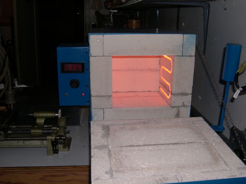

        I was hardening/tempering some small items last night.
        With a small "mapp" gas torch.
        I'm thinking about a small mini kiln, around £360, as these would have plenty room for the things I make and the temp can be set, which should make hitting correct temperature easier!
        Has anyone used one of these for HT?
        Thank you, Jim

                              I have one of these small kilns – kiln. it has a stepped temperature controller and works well. The internal dimensions are 7" x 4" x 4", it is quite compact externally and sits out of the way on a top shelf when not in use. Cost about £300 at the time, Not quite as nice as a Paragon SC2 though.
                              I have used Brownell's ATP-641 anti-scale coating in the kiln with success, but it ain't cheap.
                              The kiln takes about 40 mins to reach hardening temperature for silver steel/gauge plate, with only a few degrees overshoot and maintains the temperature within 1 deg C for as long as necessary.
                              It is also useful for stress relief (of materials) and for dissolving the hard carbide inclusions often found in iron castings. The cooling rate can be controlled over many hours.
                              Often, however, I just use a propane torch for hardening and I can be done in a few minutes with good enough results.

                                    I have a small home built kiln/oven that I use for heat treatment and silver soldering items too large for my torch. Works very well. It is controlled by a home built controller which keeps the temp within about 10 deg which is OK more most uses (I have a PID controller which will keep it to much closer tolerances if I ever get around to installing it). Its rated at 660 watts @ 240 volts. Further pics in my album, including cutting diagrams for the insulating fire brick linings.

                                            In one of his videos Dan Gelbart describes using a methanol drip into his furnace to maintain an ideal atmosphere for hardening.
                                                  That could be quite dangerous especially if the single droplet wasn't injected, even then it would surely cause an explosion, perhaps the combustion gases are helpful in preventing scale ?

                                                    Dan explains it here at 22:30-
                                                    No mention of leak hazards but you get a nice flame shooting out of it when you open the door. Mind your eyebrows.
