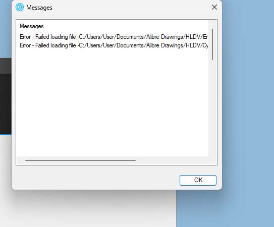

      When opening this growing (with many growing pains) assmebly, firstly a small window appears with a list of files comp[lete with their directory paths. Accept it, then this opens:
      .Screenshot 2025-02-06 100209
      It does not seem to affect anything, so is it referring to earlier files or editions of them I have replaced but Alibre is still trying to find them? I have made a lot of changes to the assembly not only for design purposes but to simplify some sub-assemblies to single parts easier to control.

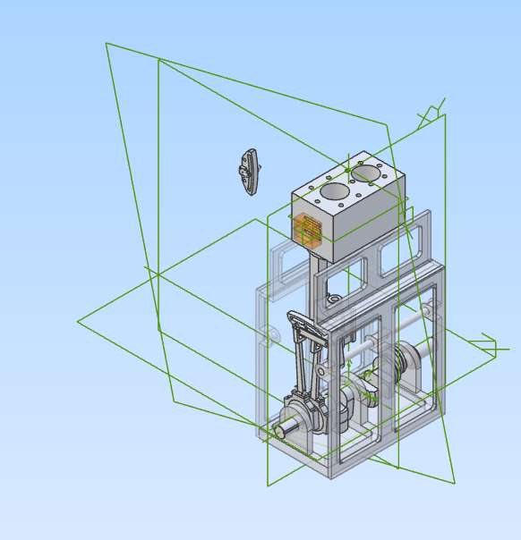

      Then, this peculiarly tilted plane started to appear. The plane was intended and it is in the correct position and orientation, by why tipped over? It does not seem to matter. It was originally for placing a bearing as a bolted-on part, but I subsequently simplifed the Parts to a more diagrammatic base-plate with three integral, solid journals as one Part. This was because I kept having parts wandering about despite supposedly constrained. I just make the tilted plane invisible, but could such antics create real problems?
      Screenshot 2025-02-06 100104

        First one is probable files that have been deleted but are still listed down the left side, renamed or copied but not using “save as”
        The plane will only be tilted if you inadvertantly picked geometry that was at an angle when you created it. Right click the plane towards the top of teh left hand list and you can edit it.
        It won’t snap if you have turned snap off or set it at a very short distance. I have no roblem. Orange-Red to Black are all related to how constrained a sketch is. the more you tie it down by giving lines a length or radius or set their position the closer you will be to a completely black sketch though I often work with quite a bit of a sketch still red.

          As Jason said – if you get a list of files/paths when you try to open an assembly or a drawing – this is an indication of missing files.  There will be some files in the list which have a red spot next to them.  You should select one of these, then use the ‘replace’ button at the bottom of the dialogue to re-link the file (assuming you have it somewhere).  Repeat until all missing items have been re-linked.
          This happens if you have moved or deleted files that the assembly requires.

          I’m sure we’ve covered ‘snaps’ before – you can enable a grid and snaps in sketch mode (if you really want to), perhaps more usefully there is ‘snapping threshold’ setting which controls how close you have to get the cursor to an existing item for the new figure to ‘snap’ to it.  The allowed setting varies from 0 thru 5mm.  At zero, it is almost impossible to snap to existing figures, at 5mm it may be difficult to select the correct item to snap too in congested sketch.  The ideal figure for you will depend upon display settings and what you are modelling.  My system is set to 3mm.
          The setting can be found in System Options -> Parts/Assemblies -> Sketching :  Snapping  (it’s right at the bottom of the dialogue).  There is an equivalent setting in the Drawings-> Sketching area.

            Fortunately the wonky plane had tilted on its own plane so it didn’t actually do any harm there, but I was worried about similar happening somewhere else and causing damage.
