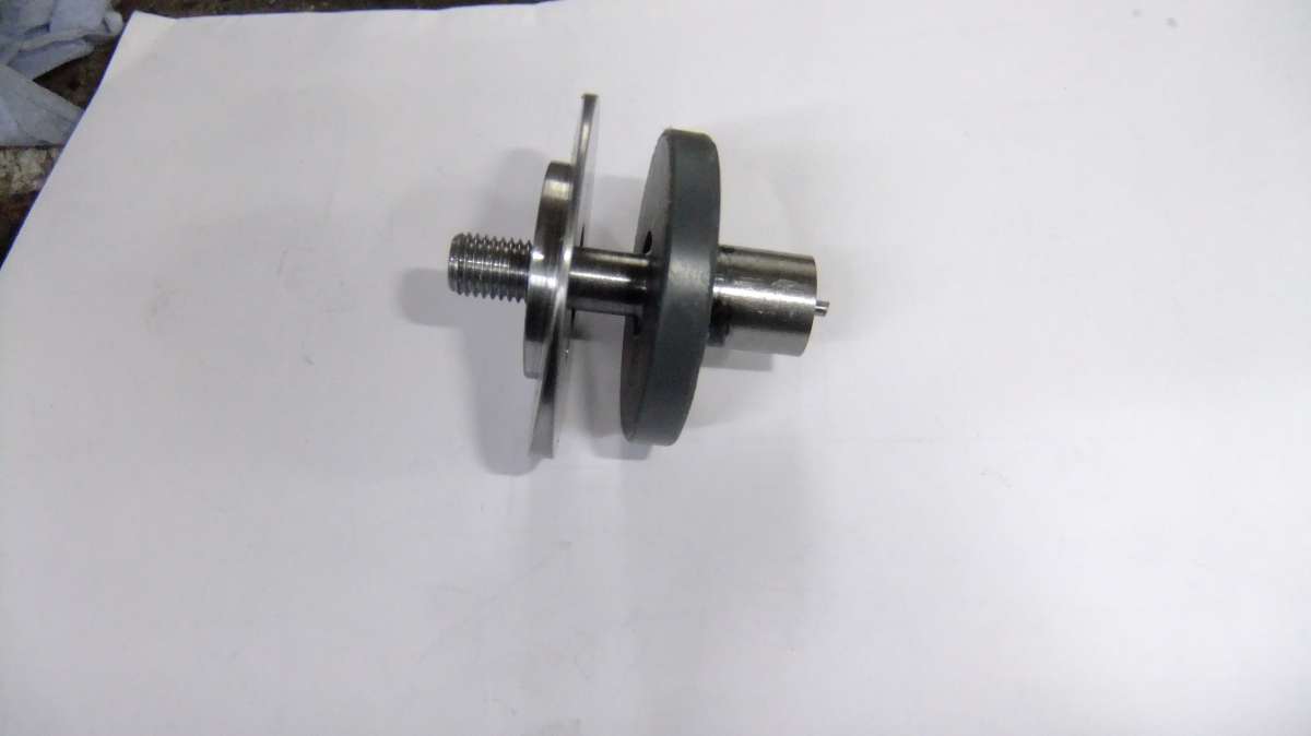

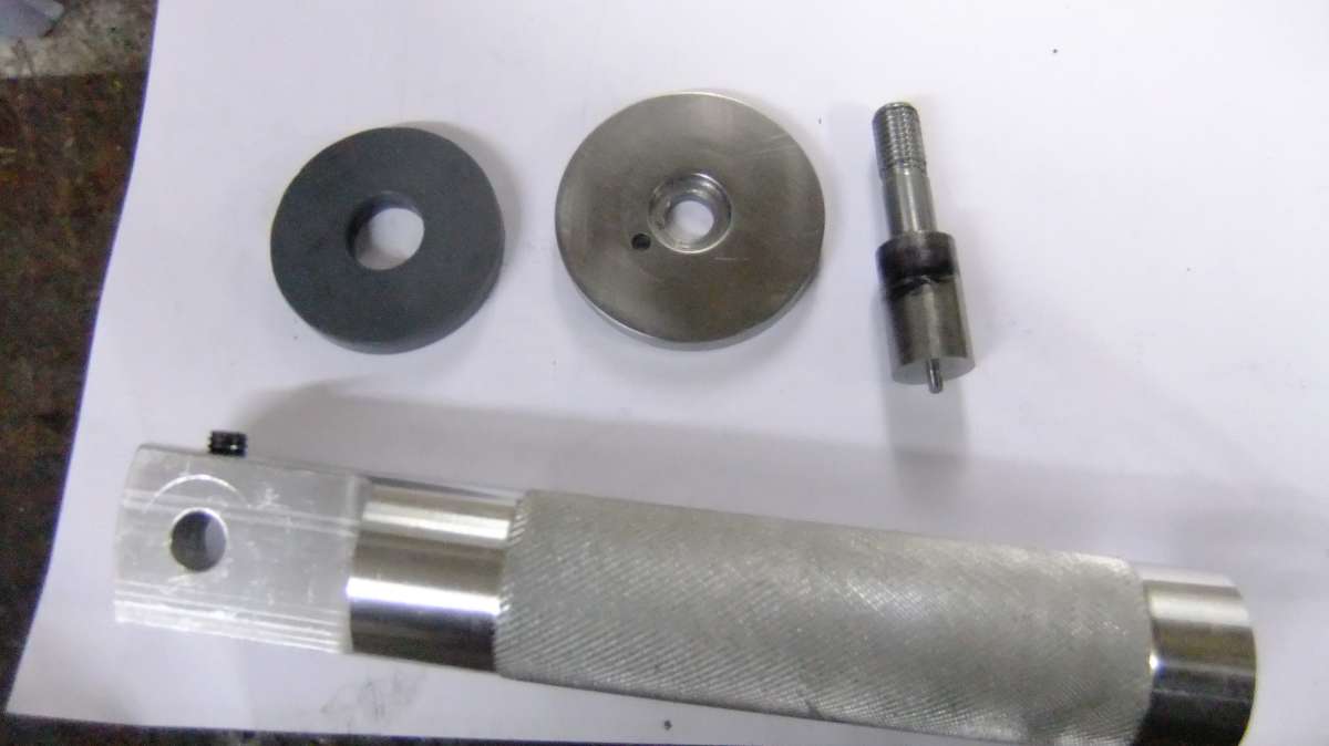

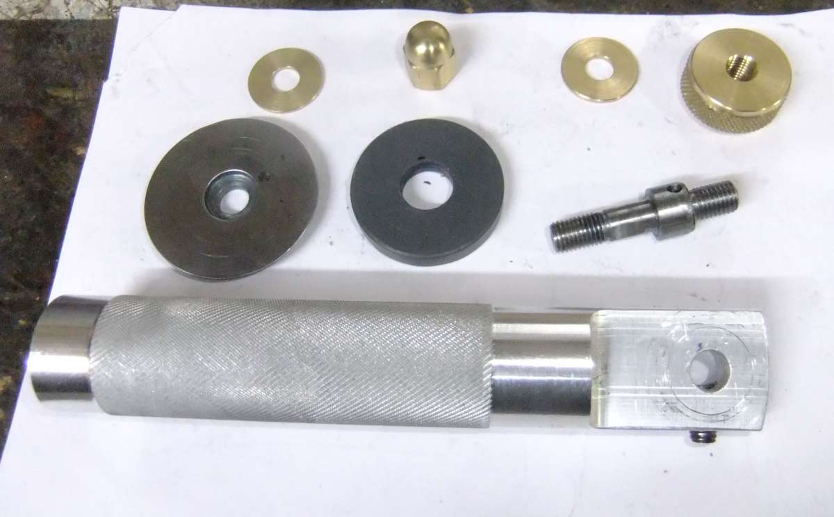

            The last couple of days managed to get some more done to the spring winder. Still need to complete the shaft and make the nuts to hold it all together.

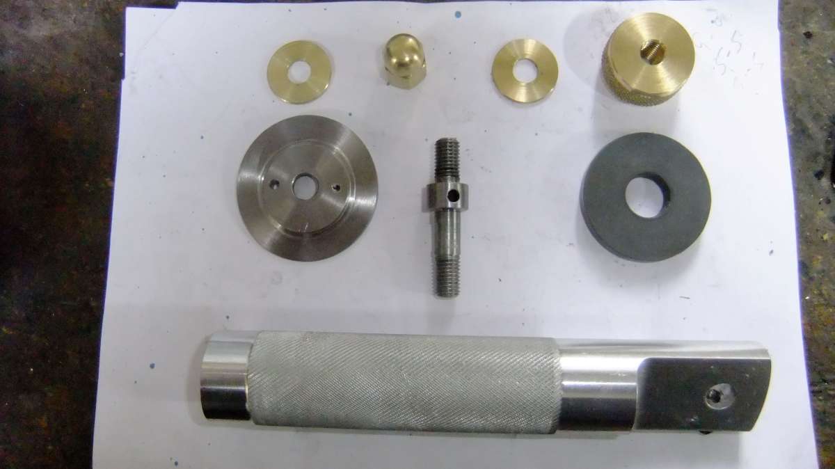

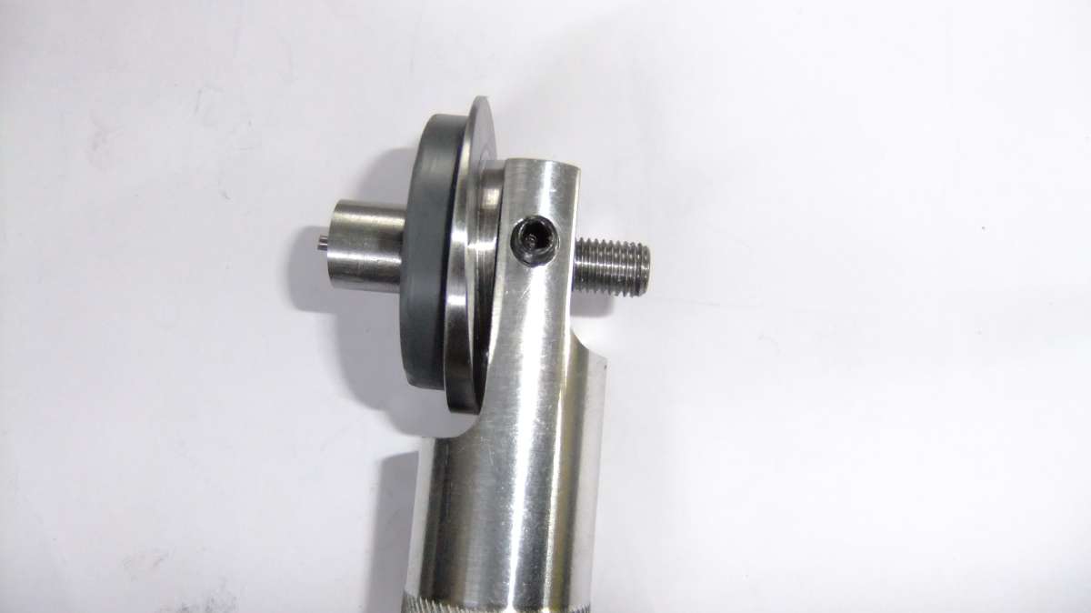

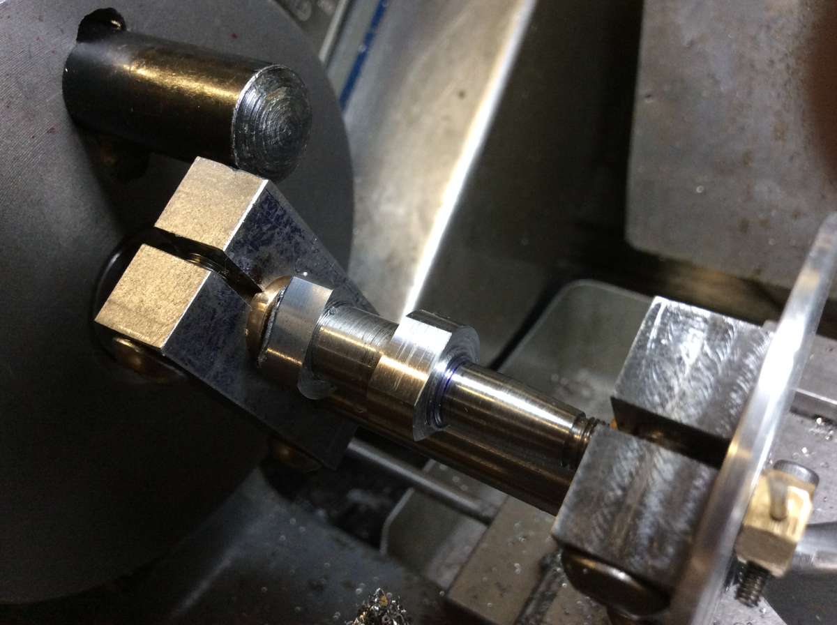

                    Finished the spring winder today after making a mess of the shaft by drilling the hole in the wrong place.
                    First photo with hole in the wrong place
                    DSCF4225

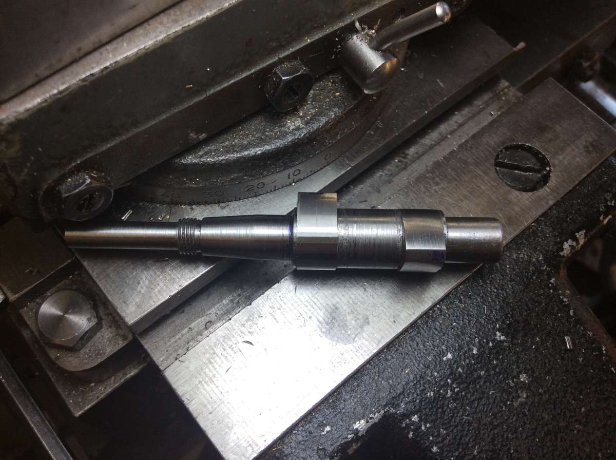

                    After the remade shaft
                    DSCF4233

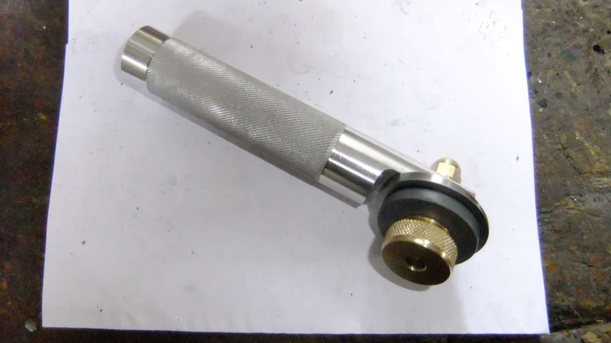

                    Completed and ready for a test. Well it looks the part, but will it work.
                    DSCF4229

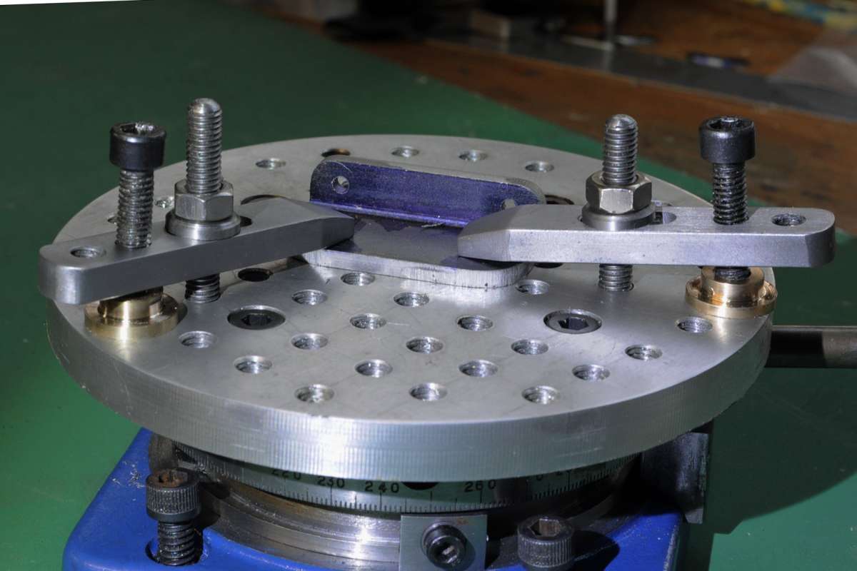

                      one of those ‘tuit jobs just got done, clamps for the GHT rotary table:

                        Nice to see your brass presure pads not everybody does that!

                          Hi,
                          I made mine a few years ago from the Hemingway kit.
                          It works very well! But be careful to have the lathe running very slowly, try using small diameter spring material first and practice a few times.
                          I made mine primarily as it looked an interesting gadget to make, I like making useful and unusual tools but its mine purpose was to make a large spring for my Quorn grinder.

                            Rod,
                            That is a great modification to GHT rotary table!
                            I made the small rotary table to GHT’s design, but to be honest the table dia of (I think 4 inches), is somewhat too small on occasions.
                            I assume your sub table is 6 inch dia mild steel? Were the holes drilled in any pattern or pitch circle? or where necessary according to the job? Final question!….what threads are you using for your clamps? I currently use a mixture of 1/4 bsf and M6 for my small clamp system but I would prefer to standardise!!

                              Hi Derek,
                              The table is actually 6″ diameter aluminium alloy, originally made for my 4″ Sharp rotary table.  I made the holes in a square pattern on one half and radially on the other half, all M6 coarse.  Not sure if this provides more versatility or not.  As you say the problem with 4″ tables is that there is hardly any room for holding clamps and even the ones I made may be too big- I’ll have to see.
                              The brass pads have a 6mm diameter spherical recess put in with a ball ended mill and I have filed a sort of hemisphere on the end of the socket screws.  I really put the pads there to bridge any holes as well as protect the table surface.

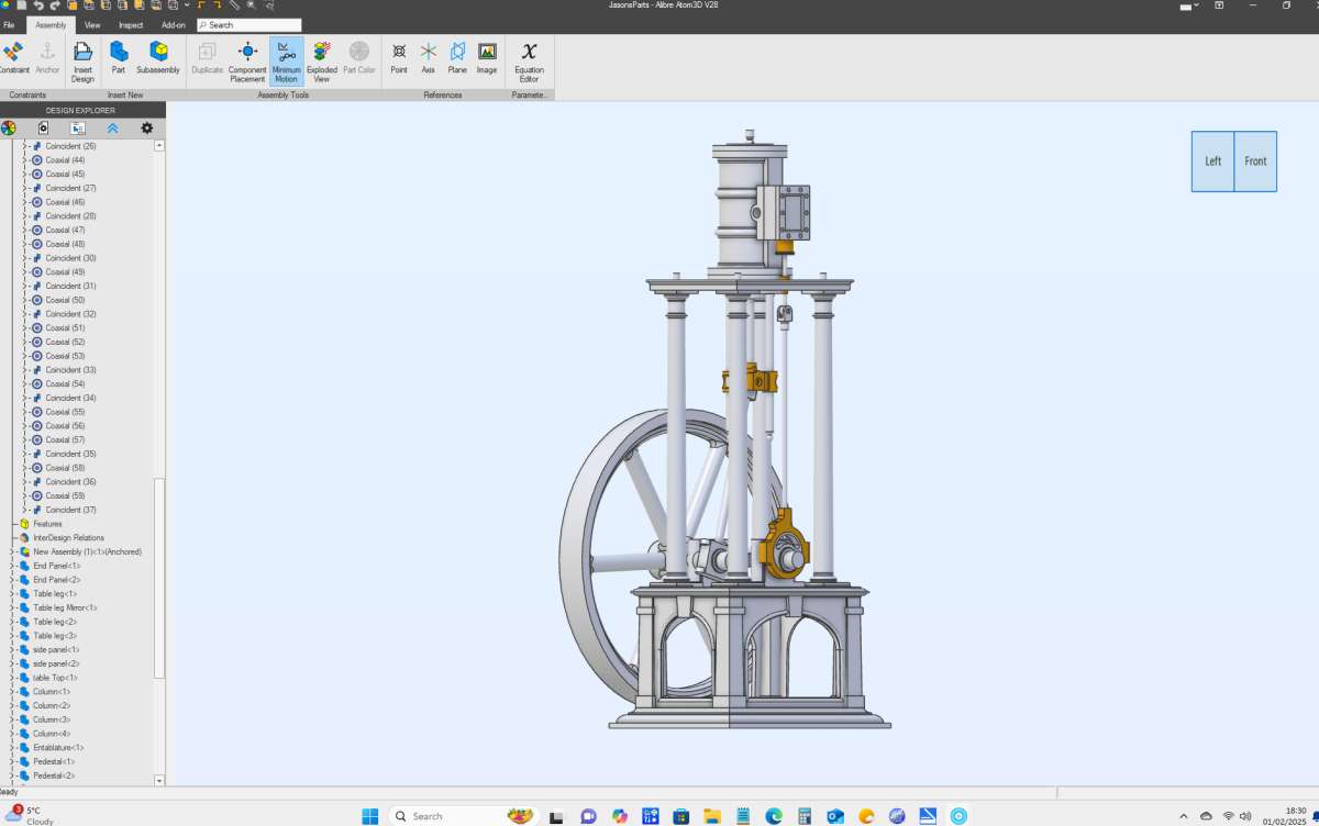

                                I know it’ll be nothing to some of you, but feeling pleased with myself for managing to assemble the individual ‘Vickers’ engine parts that Jason kindly sent me into a complete engine – that doesn’t fly apart if you rotate the crank!
                                I never imagined at the beginning of this year that I’d be posting this now, thanks so much for all your encouragement.
                                Screenshot 2025-02-01 183014

                                  You are picking it up quickly and I think it is quite useful to have some “ready made” parts to look at how they were drawn as well as to assemble.
                                  #781513
                                  Diogenes
                                    @diogenes
                                    Yes, it’s really interesting to see how ‘economical’ an experienced worker can be – your CAD creations are just as direct as your machining methods, I’m beginning to see that there might be benefits to be had in my own ‘chip-making’ too – you start to see the operations in a much more direct way..

                                      I confess to not having any plans, I did look on their site to see if they sold plans separate rather than buying the kit. I think they would benefit by doing so.
                                      I havw made a couple of springs and it certainly works well
