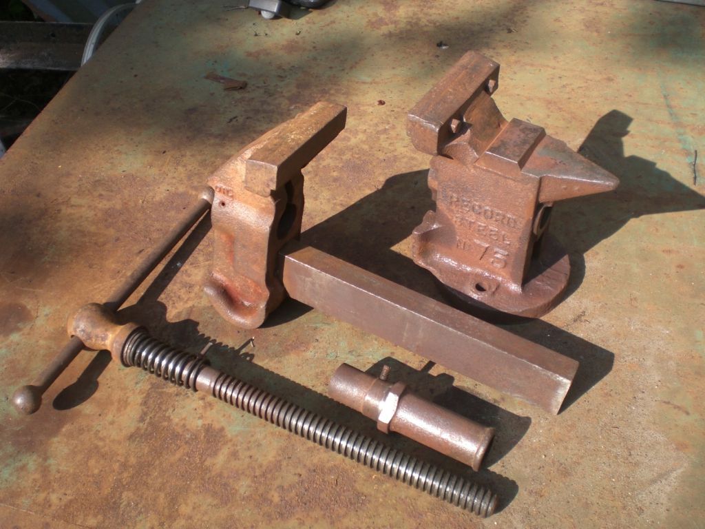

          Hi, today after three days of trying to un-seize my Record No. 75 vice by using penetrating oil and a bit of bashing with a hammer and letting it soak in penetrating oil overnight. Mine you, it had been sitting in the footwell of an Austin car derived van for a few years, and as I've not been able to open the front doors for quite some time as the locks on them have been seized for quite a while, and I hadn't realised that the footwell filled with water every time it rained. So today was a Monty Carlo or bust kind of day, as I showed it how hot it could get with my big burner on my propane torch, with a couple of heating sessions and some hammering, it finally yielded, but it still needed a bit of toing and froing with penetrating oil and hammering before it finally gave up altogether.

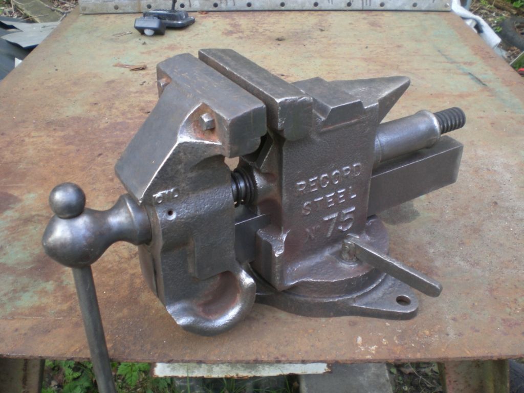

          After a bit of wire brushing using my 4-1/2" angle grinder, it looks a lot tidier, and maybe next week I might get a new coat of paint on it.
          I'll probably ditch those lever operated swivel base bolts and use socket head ones instead, as I can see those levers are going to bug me, as they are bound to get in the way of something.

              Does the curved lug on the bottom of the moving jaw serve a purpose? ..Is it for bending / cold-forming?
              Nice.

                It was indeed intended to be used as a pipe bender

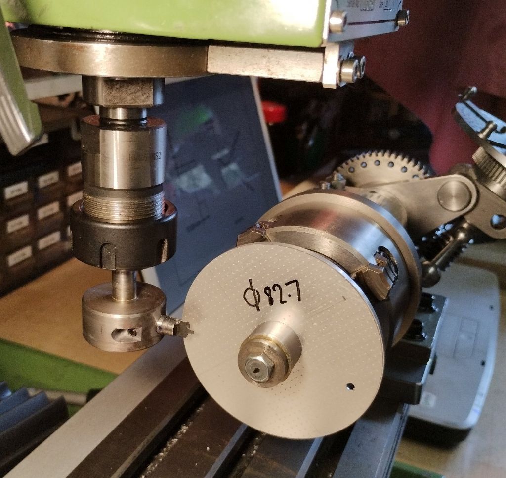

                  After carefully re-jigging a universal dividing head to fit my small Mill (WM14), making a tiny Mod 1 gear cutter, arbor, gear blank etc all together many hours of work – set it up ready to cut my first clock gear (test using aluminium blank). Ages spent setting the cutter height spot on – Oh the anticipation!
                  Rookie mistake – realised there simply wasn't enough travel on the table. Decided to give up model engineering totally and take up flower arranging.
                  OK, had to dismantle the cutter assy, re drill and set the bit further in so should be OK now – but is it just me or sometimes why is it you just can't see / check the bleeding obvious?
                  (Table Fully forward)

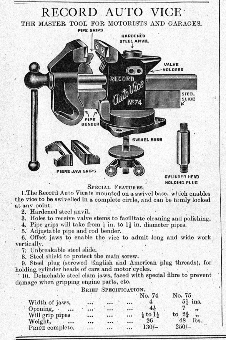

                      Hi DiogenesII, as Craig has said, it's for pipe bending. I don't have an illustration of the No. 75, which is a garage vice, but the scan below shows the similar No. 74, which is an auto vice, and is smaller.

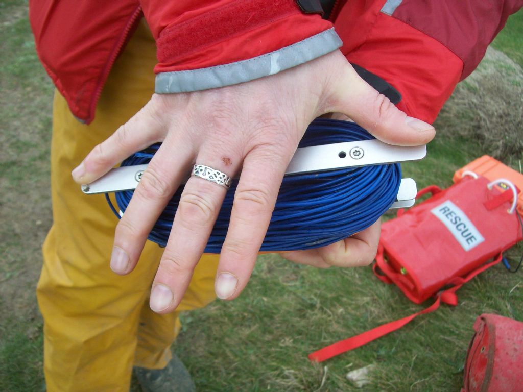

                              The photo below is my "drawing" and Estelle says her hand-span there is 7 inches, so for the racehorse breeders among you, 1-3/4 Hand long. I took the picture at the end of a cave-rescue practice I'd attended, on the surface only, as ex-officio observer and photographer.
                              The 'Heyphone' is somewhere between Ultra Low Frequency radio and induction-telephone, capable of two-way communication through a significant depth of rock between two ariels that are just long wire dipoles laid along the ground or cave floor between earth-plates, with the instrument connected at mid-point. The electronics live in a dedicated "Pelicase" – a rugged, waterproof plastic carrying-box. The ariels on their reels fit in a small kit-bag.
                              #642836
                              Nigel Graham 2
                                @nigelgraham2
                                re above: cited a photo but didn't attach it!

                                  Otherwise, completed the first-off of the ariel reels as in the photo above. It is for "Inspection Department" approval prior to making the rest of the 16 they need, and partly to assess my workshop arrangements and methods for the task.
                                  Examining the photograph closely reveals the reel has two sections, the lower much narrower than the upper, but I'm assured that's not necessary.
