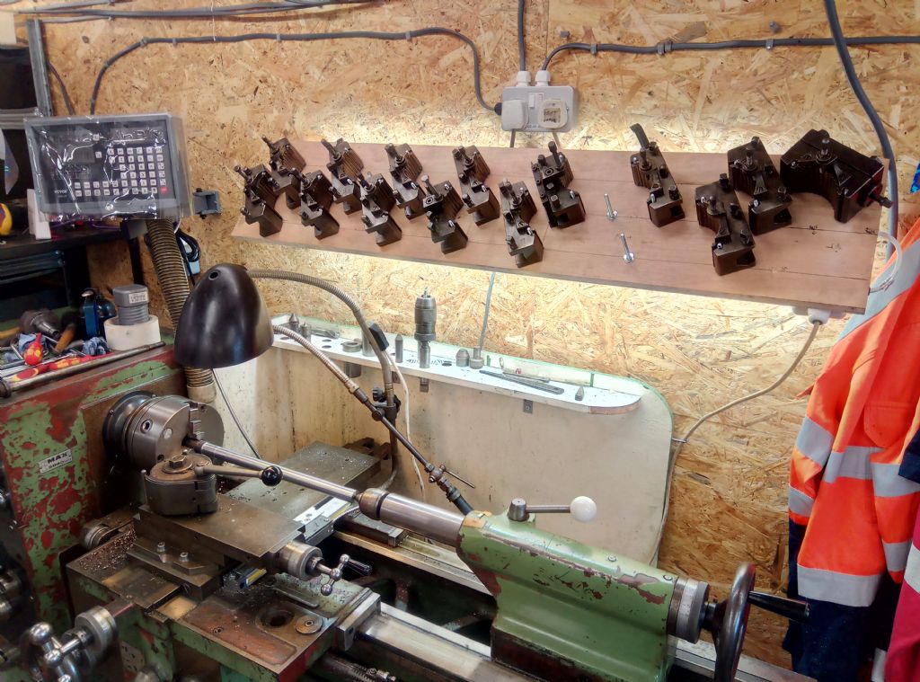

      Jelly
        @jelly
        [Kind of] finished fitting the Tool Library for the Lathe in my lunch hour, switching to using 80mm M6 bolts with penny washers and T-Nuts (the spiky woodworking type) has mostly solved my misalignment problems
        Although I could only get 30 of the required 32 T-Nuts today, and one hole needs to be widened slightly and the bolt refitted.
        20-03-23 Tool Library
        To say it was a nightmare to put up would be an understatement, but now it's done it's clearly an improvement.
        Whilst the three brackets holding it are up to the job, definitely thinking some additional bracing wouldn't go amiss, 16 Multifix C holders is not an insubstantial amount of weight so it bounces a little currently.
        Edited By Jelly on 20/03/2023 15:00:17

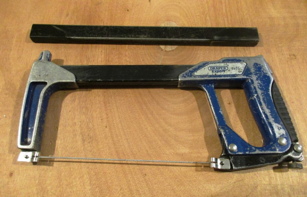

          Nicholas Farr
            @nicholasfarr14254
            Hi, I made a couple of Abrafile links to fit the only hacksaw frame I could shorten, which could be reverted back to take a standard blade. I had to make the links, because the clip-on links that I've had for years, won't fit this frame.
            The hacksaw frame was easy enough to shorten, by replacing the RHS that goes between the handle and the front section, and I just happened to have a piece the same size which was long enough to be cut to the length required, so that I could use the 8" Abrafiles I recently acquired. This piece of RHS was retrieved from a busted office chair many years ago, and is just swopped out when needed.
            Regards Nick.
            Edited By Nicholas Farr on 22/03/2023 19:27:42

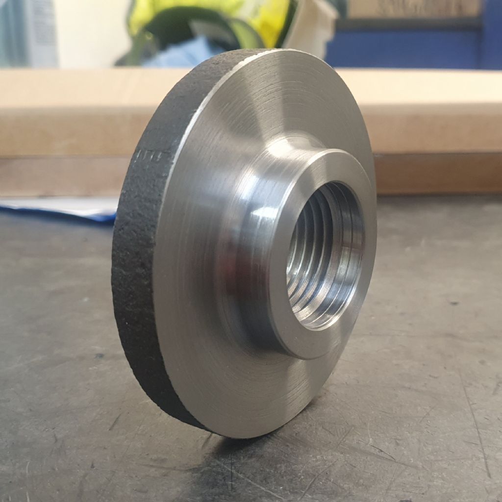

                Finished the backplate to fit a Sanou 100mm 3 jaw chuck to my Super 7.
                The backplate was an RDG pre-machined cast iron item that is a nice fit on the lathe spindle nose. At the time I bought it, the least expenesive option was a "seconds" 5" backplate that had 24 "indexing" holes drilled incorrectly. around the outer edge Turning this down to 100mm got rid of the offending holes, at the expense of the generation of a suprisingly large amount of swarf.
                Drilling the 3 mounting holes had to wait until I got the second of 3 scales for the DRO mounted on the mill, which happened yesterday. With the hole pitching function on the DRO, pilot drilling, size drilling & lightly countesinking the 3 holes was very straight forward & the chuck fit on as would be expected.
                The backplate spigot to chuck fit was not as tight as I was aiming for i.e. not a "snug" fit, but no obvious play. On the lathe the chuck body was running around 0.05 TIR, but that could be "tapped in" to 0.02 before fully tightening the bolts. The remaining error appears to be that the chuck body OD is not exactly round. A piece of 12mm silver steel clamped in the chuck shows 0.05 TIR runout close to the jaws, increasing to 0.08 around 100 mm out – not in Griptru territory, but not too bad for a £40 chuck & it feels noticably tighter than the OE Myford chuck.
                The Jingce DRO works OK, though it would work even better if the top horizontal segment on the X axis "10s" display hadn't first gone dim then subsequently failed altogether after about an hours running out of the box. And given that my glacial work rate in the workshop means that it was sat in its box for 3 or 4 years before I got around to fitting it, no hope of any warranty (even assuming that an Ebay purchase DRO actually came with a meaningful warranty in the first place ! ). Hopefully a dry joint, but if it is a faulty component & I can't identify a suitable replacement green 7 segement display I'll swap out the duff one for one of the higher count displays – I only have 370-ish mm travel & won't use the 1000s upwards display capability.
                Nigel B

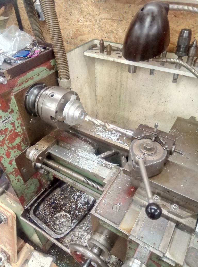

                            Jelly
                              @jelly
                              Almost 6months since I acquired the toolholders to do it, I finally got round to trying drilling with the carriage power feed on the lathe…
                              24-03-23 Carriage Feed Drilling.
                              Don't know why I waited so long… It's revolutionary!
                              That was only aluminium, but the action is so fast and smooth, and the hole quality is clearly superior too compared to drilling with the tailstock.
                              I blindly trusted the feeds and speeds from Machinery's Handbook, and pilot drilled 6mm @ 3200rpm, 0.12mm/rev, then straight to 19mm @ 1200 rpm and 0.3mm/rev, both of which would have been unthinkable for me using the tailstock.
                              The chip evacuation was also a lot better for the drill maintaining proper chip thickness.
                              I now just need to get some MT2 and MT3 40mm drill sleeves to fit my holders, so as to maximise rigidity, rather than using MT4 adapters.
                              #639051
                              Sonic Escape
                                @sonicescape38234
                                Why the hole quality is better comparing with drilling using the tailstock? Is it because of power feed?
                                #639085
                                Jelly
                                  @jelly
                                  Posted by Sonic Escape on 25/03/2023 10:15:38:
                                  The honest answer is that I don't know why exactly, it's just a practical observation.
                                  The reasons I think it gives better results are a combination of things:
                                  The big one is the comparative rigidity of the setup, my tailstock has to extend out a long way to reach over the cross-slide, which allows for a lot more flex when starting the cut.
                                  The feeding is better all round, drilling works best with a high chip-load and this needs comparatively fast feed rates… It can be hard to turn the tailstock handwheel fast enough to achieve that (especially with nonferrous metal like Alu) but my carriage handwheel will happily move that fast even by hand.
                                  Power feed is then the icing on the cake, because it makes everything very consistent.
                                  Edited By Jelly on 25/03/2023 14:34:50

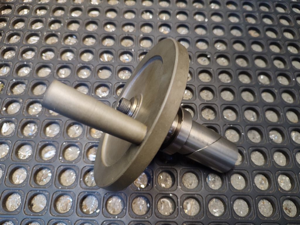

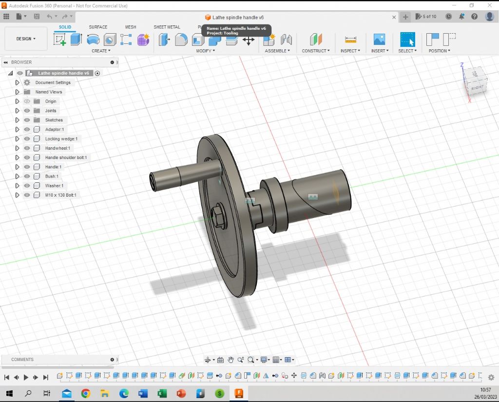

                                  #639166
                                  Phil Lingham
                                    @phillingham79132
                                    Finished my first project modelled in Fusion 360 and then manufactured. Bottom speed of my lathe is 70 RPM and I know I'm not the first to do so but sometimes when I'm cutting a fine thread or working up to a shoulder I turn the chuck by hand. Every time I do so I tell myself I could do with a handle to make life easier, so I thought I could borrow a handwheel from my milling machine as they are held on with a single bolt hence very simple and quick to swap.
                                    Designing it in Fusion 360 wasn't strictly necessary but was a useful exercise.

                                    Phil Lingham
                                      @phillingham79132
                                      Posted by Jelly on 24/03/2023 23:38:00:
                                      Interesting idea Jelly – I'm curious to understand how you make certain the drill bit is perfectly centred?

                                      Nigel Graham 2
                                        @nigelgraham2
                                        Good question Phil – I was wondering that too. There are various ways but the best is not only accurate but also quick and repeatable.
                                        I like that spindle handwheel, neatly sharing the handle itself with its home machine.
                                        As you say that is by no means a new idea and Myford will even sell you one for their lathes. That though, like most of the published designs, uses an expanding, split sleeve rather like those used on the screw-fixings for securing heavy items to masonry.
                                        Yours differs significantly: Is the diagonal line actually the sliding surface between two wedges?
                                        #639179
                                        Phil Lingham
                                          @phillingham79132
                                          Posted by Nigel Graham 2 on 26/03/2023 12:46:40:
                                          Exactly that Nigel – just like an old fashioned bicycle handlebar stem!
                                          #639208
                                          Jelly
                                            @jelly
                                            Posted by Phil Lingham on 26/03/2023 11:55:46:
                                            Used a DTI in the chuck to indicate the MT4 taper of the toolholder in concentric to the spindle's axis of rotation, setting the toolholder height adjuster and the tool X offset on the DRO; massive faff but it only needs to be done once and that's it set for good.
                                            So with that one off awkward setup in place I can now:
                                            • drop the holder onto my toolpost with a drill seated in the taper,
                                            • lock the clamping lever,
                                            • move to X 0.000,
                                            • lock the cross feed and
                                            • start drilling,
                                            all in a matter of seconds.
                                            Edited By Jelly on 26/03/2023 18:20:14

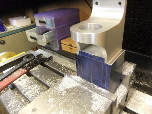

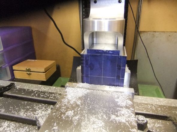

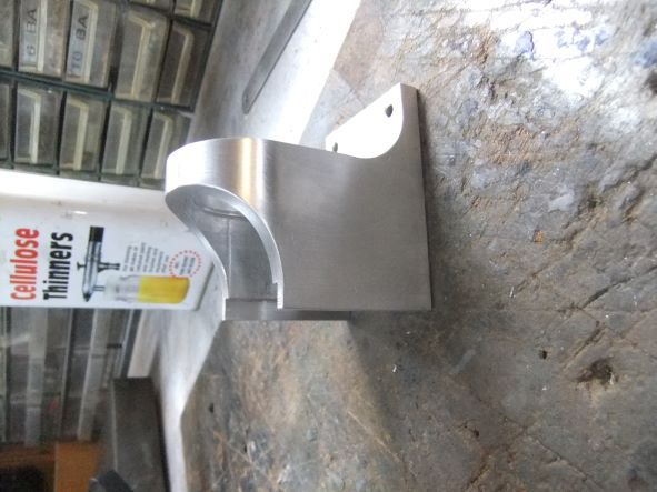

                                                    Dalboy
                                                      @dalboy
                                                      Only had a little amount of time in the workshop but did manage to get the joint done.
                                                      With the cutter I used I needed to machine 1" from the centre line but when I offered up the front section as I was machining it slipped on at 1.0021 which I am happy with.
                                                      Screws which need to join them together will be done once the two parts are complete they are also aided with some JB Weld
                                                      Test fitted
                                                      Now to start machining the outsides down to size which have two protrusions on one side and one on the other.
                                                      Edited By Dalboy on 27/03/2023 18:48:54
