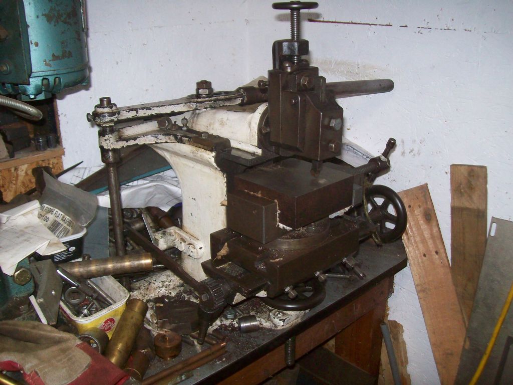

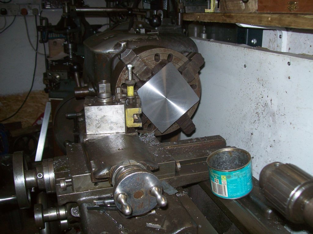

      Continued another task for him – refacing his bench-block. This is chunk of 4.5 inch square mild-steel about an inch and a half thick; that had been sawn and heavily stamped "18" – possibly a batch number, but someone had faced the opposite face for use.
      This was all now very rusty.
      Refaced the original working face on the Harrison lathe, but I was unable to obtain a really good finish: no tearing or chatter but rings as if the tool had dug in very slightly in places.
      I put it on the Drummond manual shaper – it just fits the vice with the moving jaw replaced by a piece of plastic bar – put the radio on and commenced wearing my arm out flattening the sawn side. So he'll have a choice of which face to use!
      The first attempt produced a vavy surface I credited to slack in the table and knee gibs, and slightly poor tool-grinding. I've now reground the tool, nipped the gibs up a bit and lock them for the cutting. I've still another layer to scrape off to remove the worst of the "18 " but now seem to be obtaining a decent, flat surface with a reasonable finish.
      Why not mill it?
      A couple of weekends ago my friend had artlessly asked me, "Do you have a milling-machine"
      I replied, "Y- yes" , very guardedly, his wife and our companions grinning as they twigged immediately he wanted something doing (this block).
      I collected the block, examined it, was not confident I'd obtain any better results by milling, and a manual shaper doesn't use electricity… except that necessary for the operator's fuel (tea).
      The exercise, using the shaper to almost full capacity, is proving useful in showing where it needs some fettling. Adjusting the ram gibs to remove slight twisting and possibly up-lift make the ram stick on its outer travel, showing the upper surfaces of its slideways have worn slightly concave or wedge-shaped along their lengths. I will have to measure it to establish what needs facing down where.
      I've already replaced some of the plain, very short grub-screws for the gibs with new square-head ones fitted with lock-nuts (the photos on lathes. co do show some samples so fitted), so it will appreciate the remaining ones treating similarly.
      Here it is:
      The centre mark on the turned surface is a shallow centre-drilling to prevent creating a pip, and to give a starting edge for outwards feed. Spindle speed about 70rpm with the motor at nearly 1000rpm, fine feed change-wheel train. HSS tool. The worst ring is faintly visible just within the outline square, but the spandrels are all to a very good finish despite the interrupted cut! Odd.
      On the shaper, the steel looks still rusty but that's a lighting effect. It's actually posed: I'd already shaped the worst roughness off but had gained a torn surface, before turning it. The tissue to protect the turned face is visible. Note though hard to see, the near-proper shaper-tool form (it's probably a lathe spring-tool, in high carbon steel). Also the bread-bag tie on the vice handle, to stop it dangling in the way of the advancing table hand-wheel. Leather glove (to the left), to avoid blisters.
      Reputedly there is a bench under all that clutter!

        Nigel , have you tried a skiving tool on the shaper I find it gives a good finish on steel.

            Bernard –
            Sorry – I'm not familiar with the term "skiving tool". It rings a vague bell but I forget in what context, and I don't know its form.
            I have looked in my copy of Ian Bradley's book (a MAP publication) on lathe and shaper tools, and he doesn't mention it there. He does though give advice on tool-setting on the shaper, and the drawings for an adjustable tool-holder designed to fit the Drummond manual shaper, taking small bits ground from HSS bar stock. (Or indeed from such sources as broken centre-drills etc!)
            Today –
            I delivered the machined plate (the "customer" and his wife are among my Saturday caving pals), plus the plywood box I'd made for the silver-smith's anvil I'd given him from among my umpteen years'-worth of accumulated, assorted tools I'll never use. As a finishing touch I had cleaned the plate's sides and given them a couple of coats of light-grey spray primer.
            He's delighted! Said the surfaces were better than it had been when new to him. It had had only one surface machined and the other was rough-sawn; but I cleaned both faces.
            Paid me in honey from their hives.
            I've promised him a box for that plate, which I think he uses as a sort of surface-plate-cum-anvil.

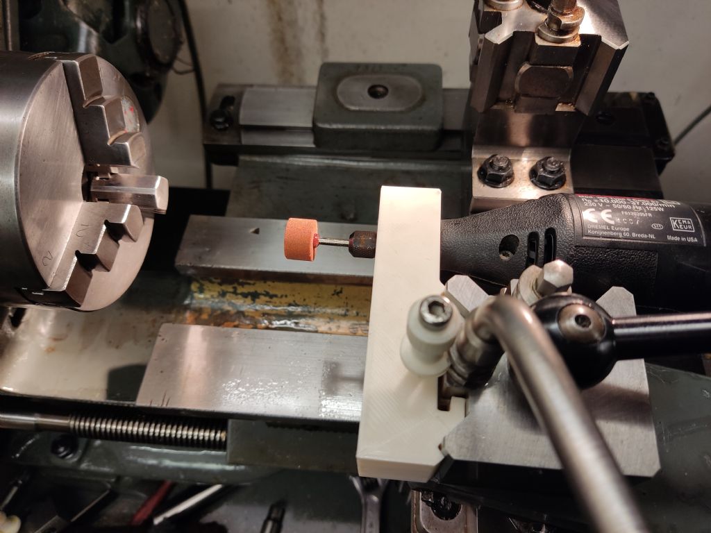

              I managed to get my 3D printed Dremel holder on to the lathe & succesfully reground the 3 jaw SC chuck jaws.
              My initial design of Dremel holder fit the Dickson toolpost securely, but I hadn't got to grips with the "Thread design workbench" in Freecad to accurately model the thread for the Dremel nose – variously described as M19x2 or 3/4"-12. M19x2 taps are rare and expensive & the only standard 3/4"-12 thread seems to be 3/4" BSF. Zoro put up a new 3/4" BSF tap for less than most used ones were being listed at on Ebay & the M18x2 hole I had modelled opened out easily with the new tap held in the chuck & the holder mounted on the toolpost. The Dremel screwed into the resultant hole nicely. Turns out I should have allowed a couple of millimetres more for the Dremel body to clear the toolpost as it interferes slightly, but it does just fit.
              I didn't make up a grinding jig a-la-Hopper, but chose the "centrifugal force" method of running the lathe spindle at maximum speed (2200 rpm on the Super 7 IIRC) to hold the jaws against the scroll. Top slide set at round 10 degrees to give fine outfeed capability & I proceeded slowly to lightly touch the clamping face of the jaws, which had been marked up with a marker pen to judge progress. I had treated the chuck to a strip down & clean last week before starting the regrind.
              It was apparent straight away that only 2 jaws were being ground initially, but after several light passes all were cleaned up. The small marks visible in the "light" jaw show the remains of the original surface.
              This has made an improvement to runout. Checks carried out on a length of 25mm silver steel using a 0.1mm resolution dial gauge showed 0.08mm TIR close to the jaws and 0.13mm around 100 mm out before the grind improved to 0.03 mm TIR and 0.08mm respectively afterwards – a worthwhile improvement, I think & not bad for a 60-ish year old chuck.
              I'll have another try at the 3D printed mount, both to give a bit more clearance to the Dremel & get to grips with the thread before moving on to the main reason I wanted a toolpost grinder in the first place – sorting out a Soba brand (short for "SO BAd" ? ) direct spindle nose mounting ER25 collet chuck that I made the mistake of buying at an ME Ex. It was sometime after the purchase that I found it wouldn't screw onto the spindle nose, which took at lot of lapping using a 2MT Myford nose adapter to get it to fit the spindle only to find that the ER taper runout was so far out as to make the item useless. A regrind of the collet seating taper with the chuck mounted on the spindle should (hopefully) make the thing useful.

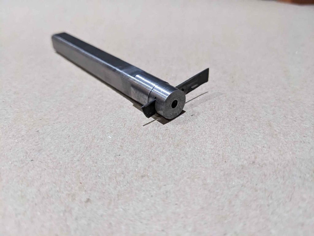

                Inspired by Mike Cox's article on using a hacksaw blade to make a grooving tool, I've made this to do internal grooving…
                the slot through was made by putting a grove in the end of the bar and then soldering the cap on (with the M3 threaded hole already in place.
                Iain

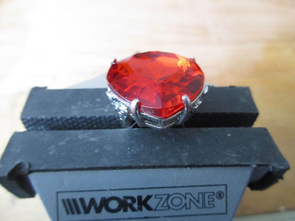

                      Hi, yesterday I had a fiddly little job, a couple of weeks ago, one of younger granddaughters who is almost six, bought herself a ring from a car boot stall, which is adjustable to fit ones finger.
                      Apparently my granddaughter keep fiddling about with the adjustment and one half broke off, and so I was given the challenge to mean it. While silver soldering was out of the question, my only option was soft solder, so I used some lead free solder, which wasn't the easiest stuff to use with a soldering iron, but the hardest thing was holding the ring and the broken off piece together in the right place, but after much adjustment to my helping hands, I managed to get in the right place.
                      The finished result was successful, although I don't now if it will be strong enough to last.

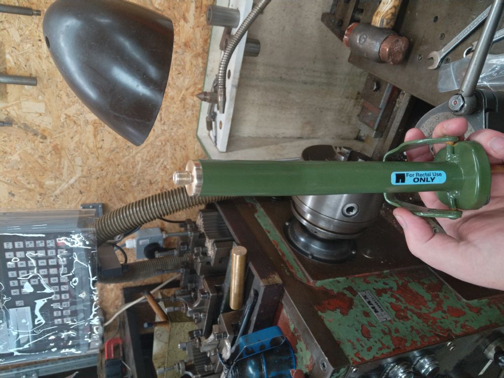

                              And the bits arrived to finish the Jerry-Can Adapter.
                              08-03-23 Jerrycan Adapter
                              Seated quite easily with a couple of firm blows with the big Thor hammer, at which point I noticed a joke from the friend who gave me the spare nozzle…
                              08-03-23 Jerrycan Adapter Joke
                              Oh Dear, I won't be following that instruction.

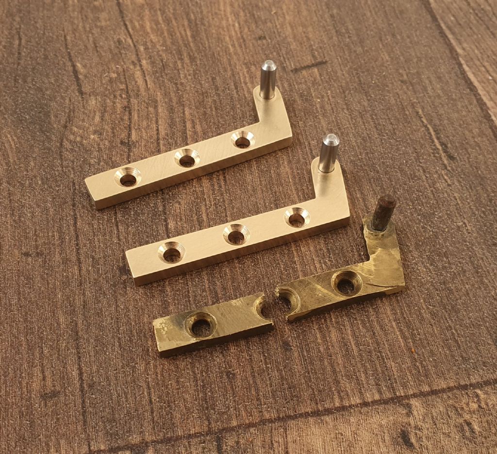

                                    Made a couple of new hinges, for an antique wardrobe, to replace a well worn and broken one

                                      Craig,I had a mate who used to do that it must be very satisfying to bring things like back to life.

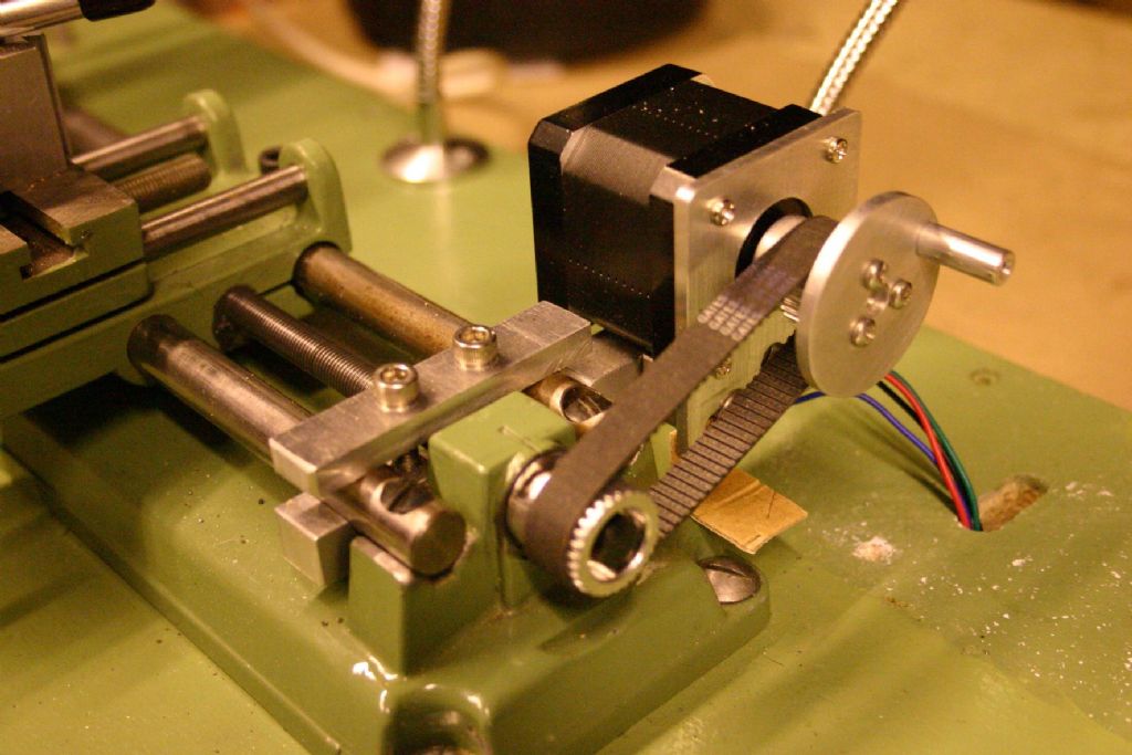

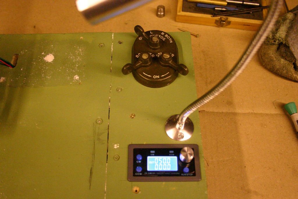

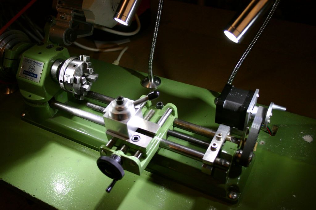

                                        Finally got round to commissioning the stepper motor long travel on my Unimat SL.
                                        The controller I fitted has several useful functions beyond just backwards and forwards but I am struggling with the auto-translated instructions.
                                        Also tidied up and finished the 4-way lighting system.

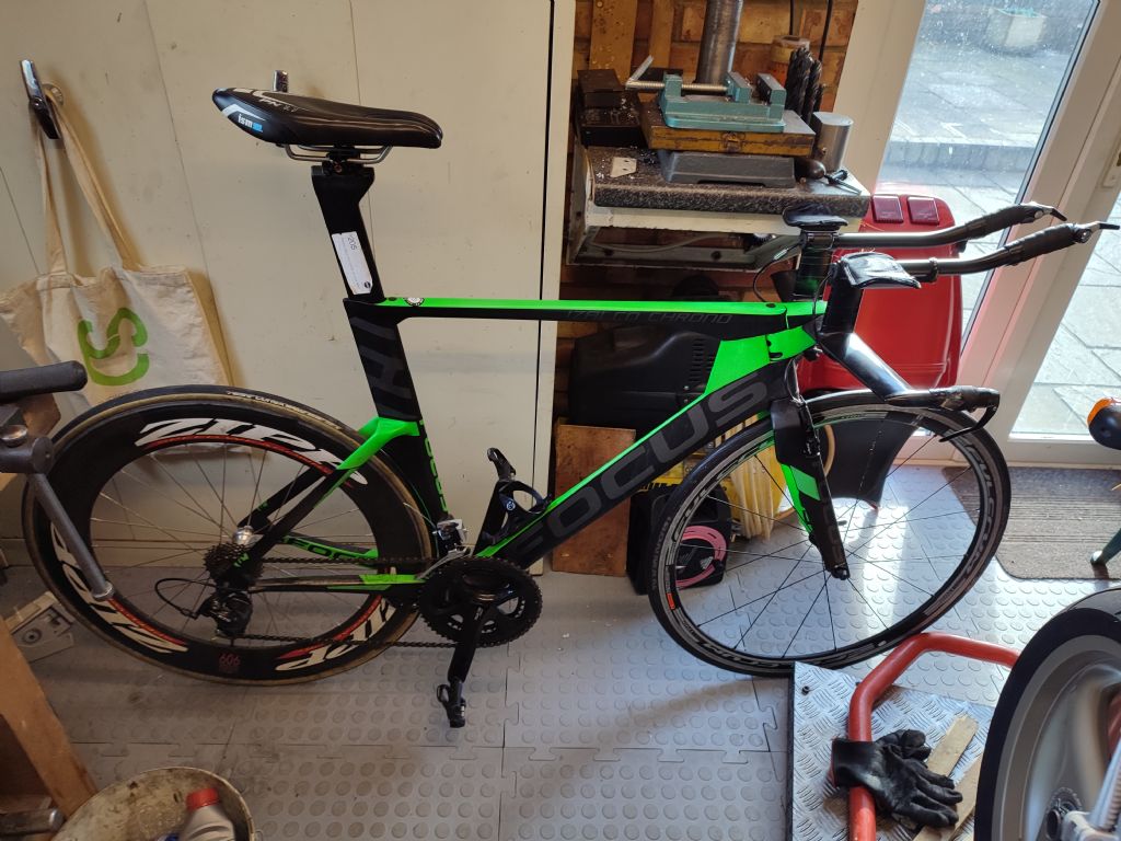

                                              Interesting job for my nephew who is competing in a bicycle race in Italy this weekend. The bracket that holds the front derailleur on to his super light carbon framed bicycle has broken for the 2nd or 3rd time at twenty odd pounds a go. (At the top in the first picture). Everywhere is out of stock and he was in a panic that he wouldn't be able to take part so asked if I could help.
                                              I tried bending one up out of some aluminium sheet of the same thickness but it was quite difficult because of the opposing bends and everything angled by 5 degrees. When we tried it out it was obviously too flexible so I machined one from solid increasing the thickness to make it stronger and more rigid.
                                              He messaged me earlier to say that the gear shift has never been as positive! I'm not surprised because obviously with the original flimsy bracket most of the effort was wasted by flexing the bracket. Might have cost him a couple of extra grammes but I told him he'll just have to pedal a bit harder!
