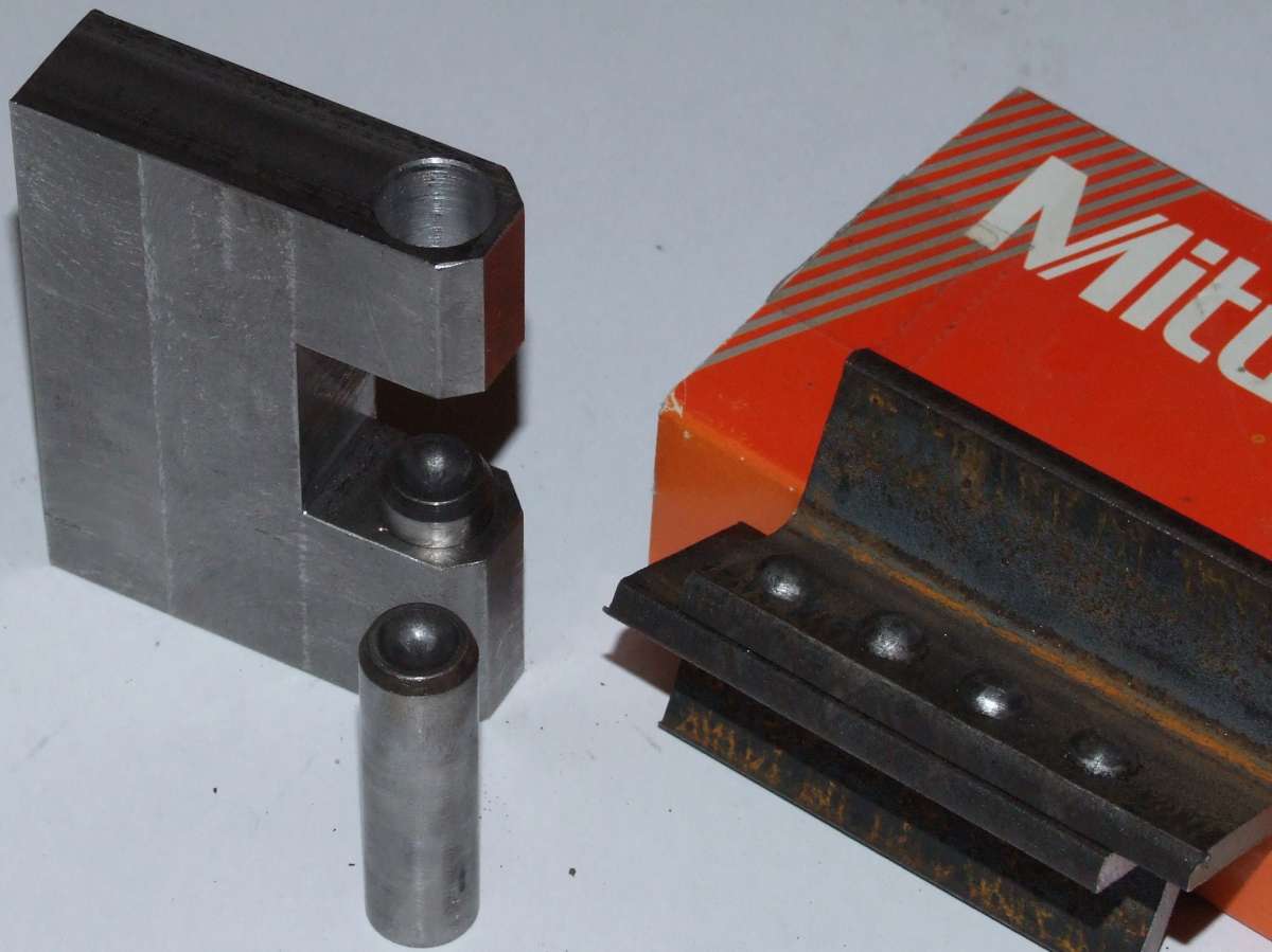

        The wire rope guides on the Burrell SCC engines seem to be different on every engine. I have gone with a modified version of one with four rollers, two vertical and two horizontal. The two horizontal supports are fixed to the tender via bolts. These have been made and fitted, M6 thread and 10mm AF hex, as this seemed more to scale than the 1/4″ BSF and 11mm AF elsewhere on the engine.
        From pictures of the full size engines it is not clear how the two horizontal and two vertical support angles are fixed to each other, so I have decided to use 3/16″ steel rivets. Sadly the riveting jig for the wheels didn’t fit, so I had to make a new one, plus new rivet sets.
        Last night I did some experiments using two scrap lengths of angle. I started with an excess length of 0.25″, ending up with 0.28″, which is slightly more than the recommended value of 1.429D. Here is a picture of the riveting jig and the formed heads, rivets were placed in order from the centre to the right:
        2023_10310069
        I used the flypress to close the rivets. Turned out to be very easy; just pull the flypress through followed by one good swing to finally form the head. It’s a lot of faff for eight rivets in total, but I like things just so, and am prepared to put the effort in to achieve it!
        Andrew

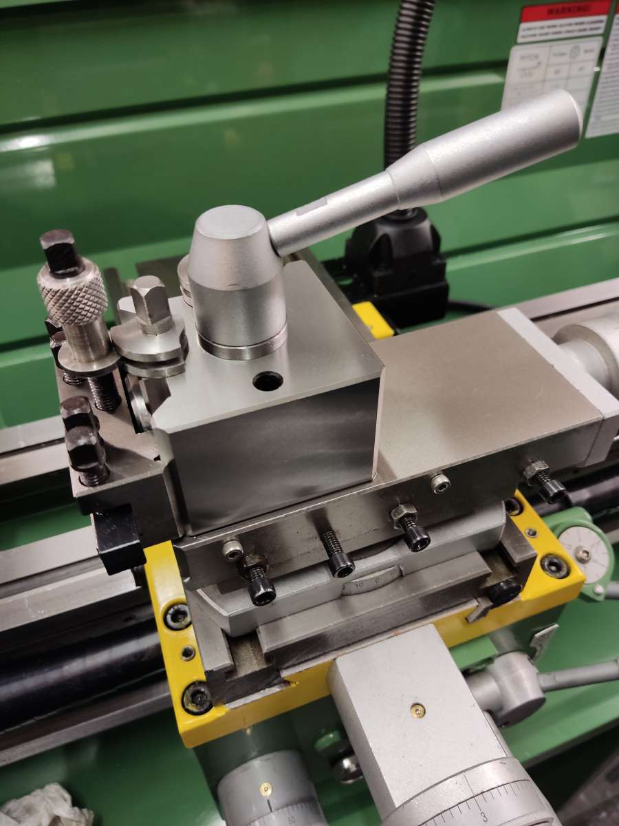

                Finished fitting a Dickson style toolpost to my Warco GH600.
                I went for the Dickson for a couple of reasons, mainly familiarity plus fitting was easier than a wedge style one.
                The toolpost stud on my GH600 seems a bit different to some I have seen, in so much as the 22mm boss at the bootom is part of the stud, not a raised part of the topslide casting. This has an M18 thread that screws into the casting & an M10 thread for the locking handle.
                IMG_20231031_134222
                Boring out the base of the Ebay purchase Indian made T51 toolpost was “interesting” due it being hardened (above 50 HRC but below 55HRC according to test files). A Chinese CBN insert on a minimally stuck out boring bar did the job but didn’t survive the experience – the areas near the clamp boss recesses were harder than the rest of the bore giving an interupted cut when under the skin I was aiming for a running fit on the boss, but ended up a bit oversize – may revist that later to bore oversize & bush down to suit, but a close fit on the top bush is working OK at the moment.
                At the other end of the block was a pressed in bush bored to suit a 16mm stud. This was drifted out & a replacement made to suit the 10mm stud & recessed for a needle thrust bearing and thrust washer.
                IMG_20231031_134414
                The original clamp handle had a recess machined for the other thrust bearing washer, with the depth of recess calculated to put the handle out of the way when clamped.
                IMG_20231031_134514
                There is a 0.15mm gap between handle & clamp bush when locked up, so hopefully the grease will keep swarf out of the bearing.
                Happy to be “QC” again, as I had forgotton how much of a pain setting tools up in a 4 way toolpost is. The T51 toolpost on this machine will allow use of 12mm section tools, though the tool fitted is 10mm.

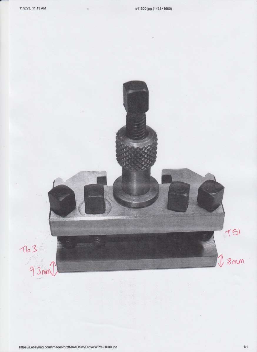

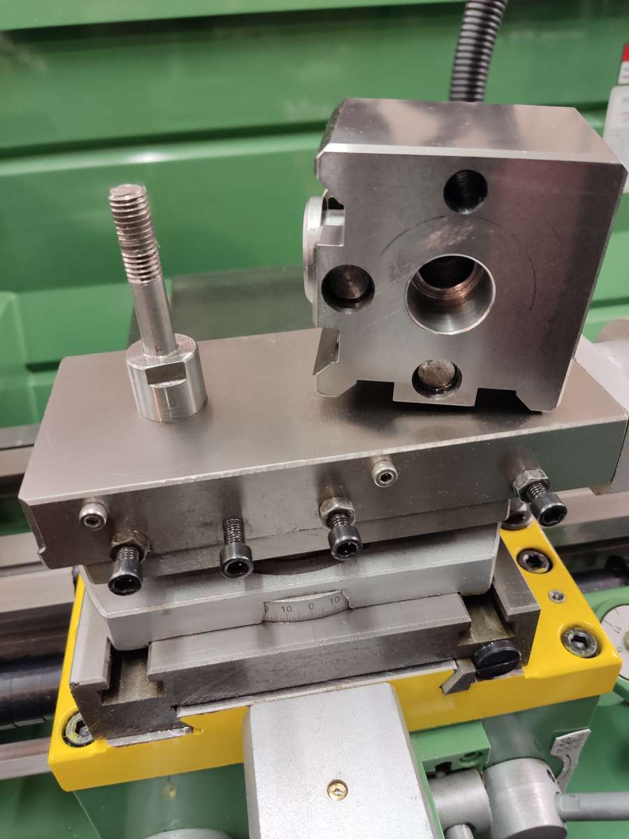

                          Danni Burns
                            @danniburns84841

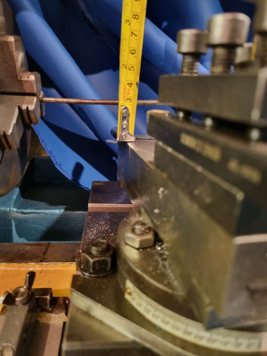

                            Hi Nigel, Robert (et al.)
                            Bare with me for a moment.
                            My magic number is 28mm (top of top-slide to centre-line). See pic1 below
                            20231101_155328

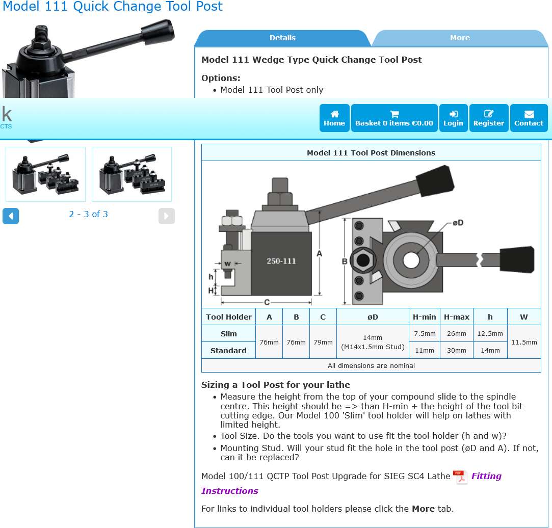

                            The main problem/restriction with these standard/crap tool-posts is the 15mm min base tool height. See pic2
                            20231101_155302
                            In pic3 below the QCTP tool holder is sitting on the cross-slide. The dimension H is (‘Standard’ type) 11mm. If my measurement from the top of the cross-slide to centre-line is 28mm, I could potentially use a tool of 17mm with that toolpost. BUT the holder only holds 14mm. If it actually does sit/lower to the Top-Slide*.
                            Screenshot 2023-11-03 at 12-05-24 Model 111 Quick Change Tool Post - Arc Euro Trade
                            The T51 QUICKCHANGE TOOLPOST (same H dimension) is 8mm (as advised by RDG), meaning that I could use a max tool height of 20mm. As long as it does actually sit/lower to the level of the Top-slide*.
                            T51-T63 2
                            The T51 has a 16mm max tooling (and for completeness the T63 has a 20mm max tooling).
                            Looks to me that there are options available and the wider choice of tool sizes means better tools should be available.
                            Now here’s the question – have I made any stupid mistakes in my above logic/assessment?
                            Cheers
                            Danni

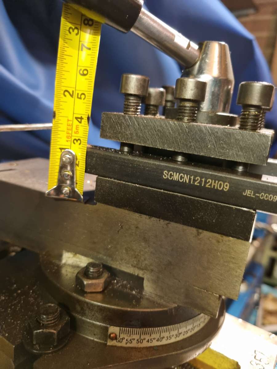

                              Update
                              I hadnt noticed this before but the 15mm min base tool height is partly due (3mm) to the top-slide. Essentially it gives me a magic number of 25mm (not 28mm reported earlier).
                              See pic below.
                              20231103_132257
                              But this still should make the T51 4mm lower, now with max tool height of 17mm (shank of 16mm) and
                              and 14mm (for height and shank) with the Model 111.
                              Regards

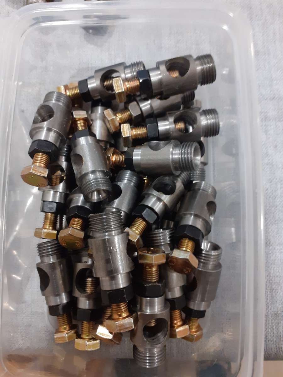

                                    Well … Friday, delivered 32-off locomotive lubricator valve adjusters to the railway.
                                    Originals had round adjustment setscrews and locknuts that had been knurled at some time in the remote past, but have since been played with by a steel dog…;-)
                                    So I used hexagon screws and locknuts in M8 x 1,0 to allow spanner rather than Mole wrench adjustment. Was gonna make these in the garage at home until the family complained about the buzz from the interrupted cut on the long M8 shank and when parting. I prevailed on the powers that be to buy bolts and nuts in the thread required. Originals had a crosshole with a split pin a couple of mils from the tip – presumably to prevent withdrawal and loss during adjustment – but that didn’t seem worth delaying delivery to do.
                                    The bodies screw into a massive casting with tight M16 x 1,5 – carbon steel dies in this thread proved easily available, so I didn’t have a really awkward and time-consuming screwcutting job to do. However the die turned out to have quite a lead-in taper both sides so I had to put in a 3-4mm undercut to allow the body to screw in tight to the shoulder.

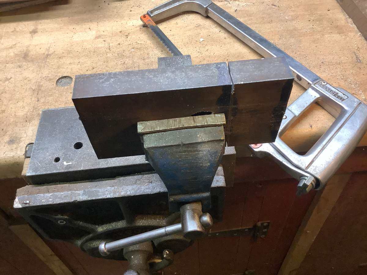

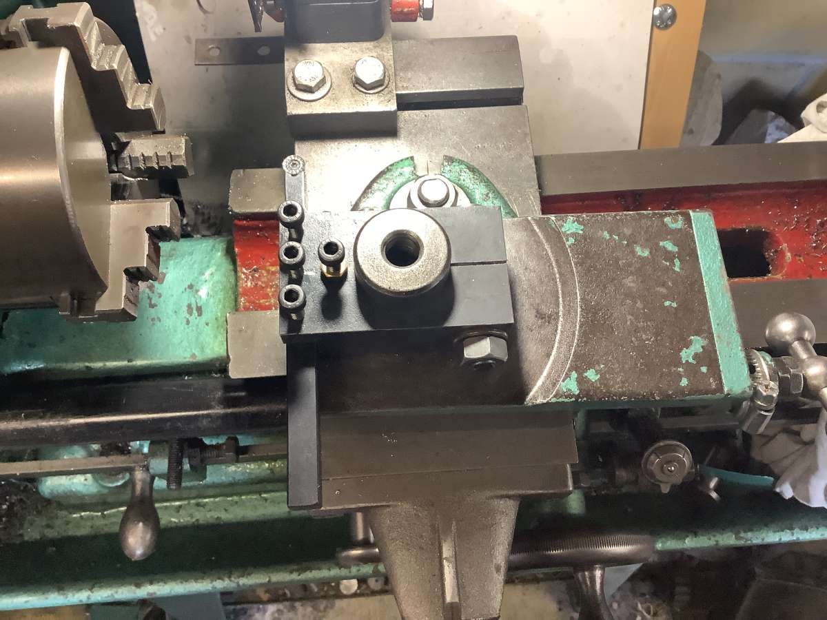

                                      Well, over the weekend really. Made these two tool holders for my Myford M type. The black finish was something of an accident. They are made from BMS bar of unknown origin, I think it came with some other lengths of round bar at an auction. I wondered if cutting the slot for the tool would cause it to open out due to internal stresses, especially with additional forces of the clamping screws. Maybe I was being a little pessimistic, but I’ve been caught out before. So they’ve been cooked in the wife’s jewellery kiln to dull red. That’s when the black finish appeared. Still not sure why.
                                      I’ve still got enough 25mm x 75mm bar left to make another 3, but lopping bits off with the hacksaw is hard work.
                                      I still struggle after posting pictures as with the old site. The curser seems to have a mind of its own. Can’t get to post text after the images.

                                      bernard towers
                                        @bernardtowers37738
                                        I think Id Have to find  a friend with a hack/band saw with a 13 amp plug on the end 9 (not Duraplug though)😁

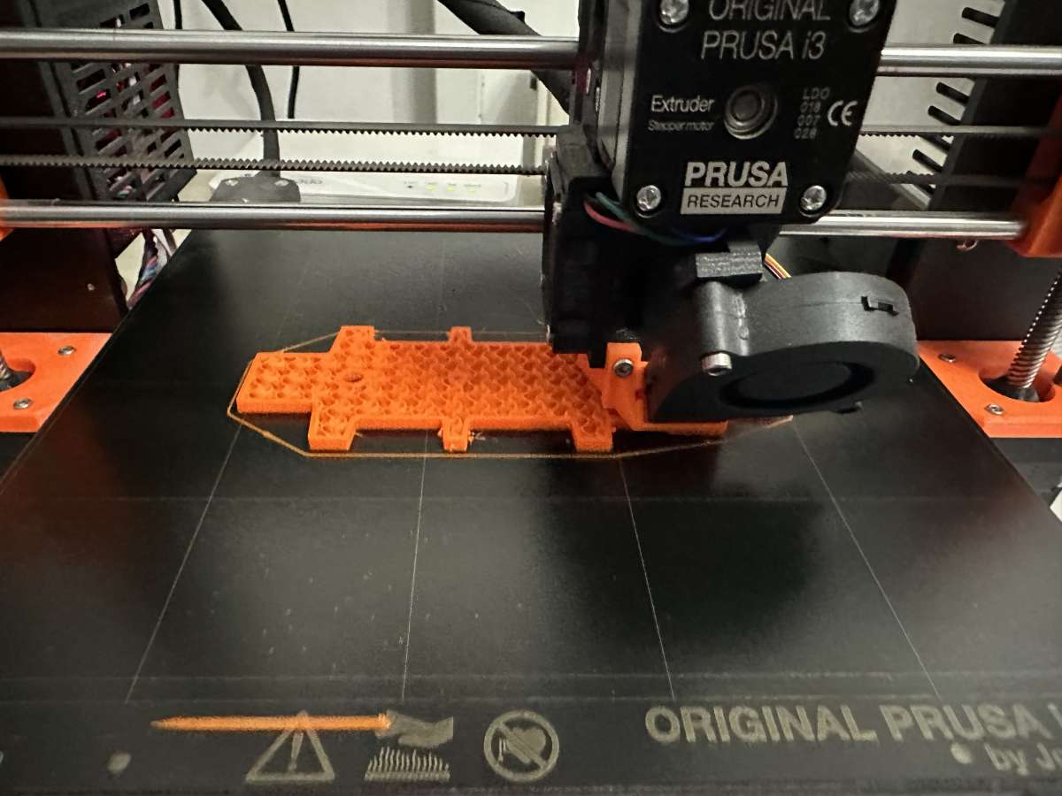

                                          Colin Heseltine
                                            @colinheseltine48622

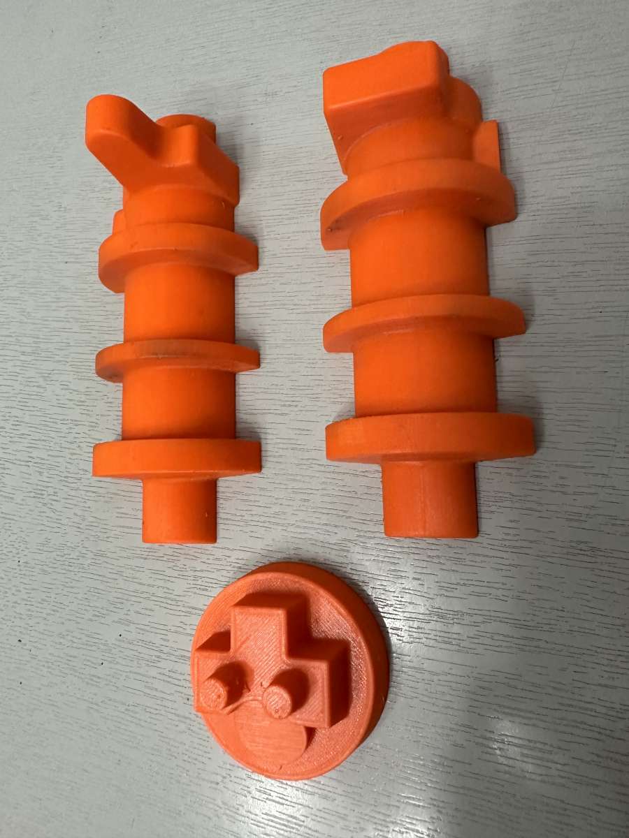

                                            Started a 3D print of first half of cylinder pattern for Alyn Foundry RLE engine. This is a 21hr print. Then have the other half to do and then the cylinder head. These have been drawn up by JasonB. When complete will go to Graham Corry IMG_9578IMG_9575IMG_9577for casting.

                                                Finished the 3D prints of the Alyn Foundry RLE cylinder and head patterns.
