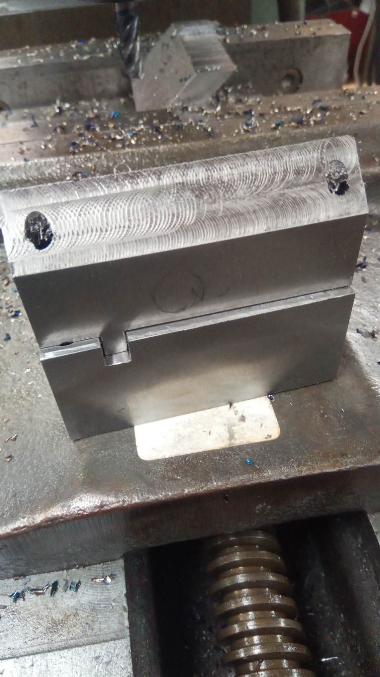

        A filing jig for jewellery work (I seem to be beset by jewlers).
        There's a 45° and 90° jaw, the tongues are to align rectilinear wire, and the v notches hold hex, D and round wire, along with tubes.
        The jaws are hardened so a file skates off them, so you can work right down to it without damaging it (although ideally will avoid doing so deliberately to preserve the file).

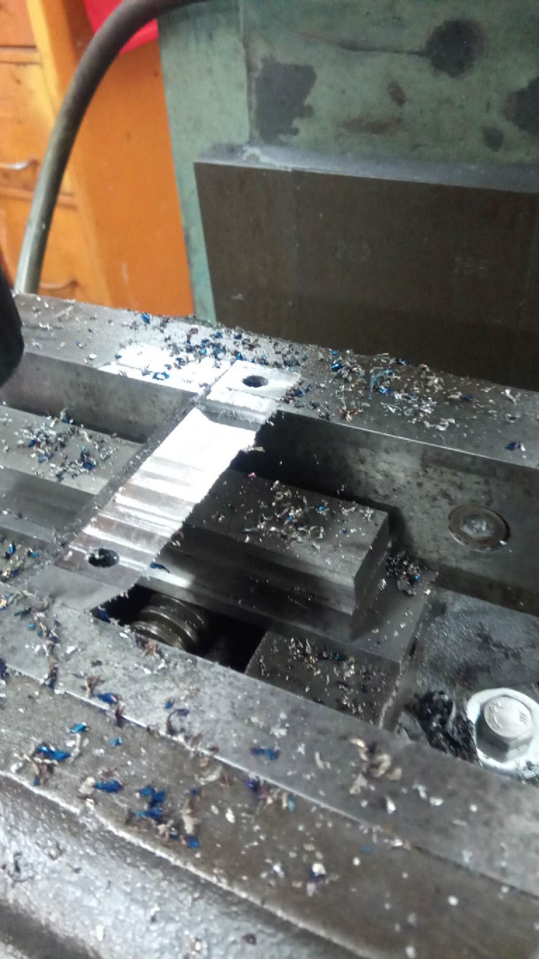

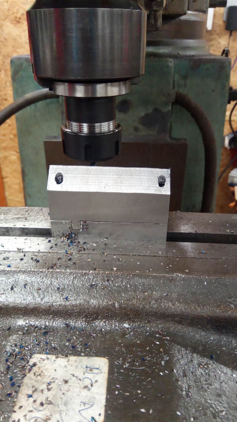

        Got a tiny bit more done on it Friday evening:
        If you look closely at the left hand side you can see where I slipped with the file whilst deburring the edges, which is aesthetically rather upsetting, but otherwise the fit is exactly as desired with about 0.01mm clearance between the tongue and the corresponding slot.
        If you look closely at the angled face above you will see that I cocked up my measurements when band-sawing the blank apart, so the 6mm reamed hole doesn't quite reach through that part, which I will need to fix before I'm done.
        Also got started with the 45° faces, using an angle block for setup and generous helpings of force to secure it, followed by lighter cuts than normal.
        Set up like that I could only take about a 0.75mm DOC, whereas with the 90° face I was able to take a 5mm DOC roughing pass, with 1mm to clean up, all done with a 10mm Carbide 4-flute End-mill running @ 1440rpm (45m/min surface speed).
        The 6mm slot was done in a 3 passes with 2mm DOC and a 6mm HSS-CO endmill @ 800 rpm (15m/min), and came out around 0.05mm oversized (which I had already tested and was accounting for to help give me the 0.01mm clearance for the fit). I am going to have to be *much* more gentle making its angled counterpart.
        Either way, very happy with the mill's performance… Great MRR in a tough material with acceptable surface finish (what you can see, can't actually be felt, so should lap out quickly once the parts are hardened), ideal for my impatient temperament!

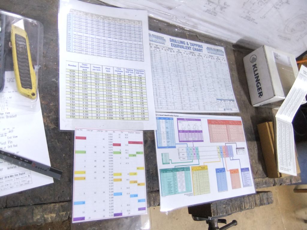

                  I spent an evening printing off some useful charts and then laminating them to hang in the workshop, as I was fed up of having to go to the computer for some of them to find out certain measurements, as well as having them handy. I do own other reference material like a zeus book and the like.
                  At least this should help keep them clean from finger prints
                  So having them attached to a wall will make life easier, when I find a good location not hidden behind machines.

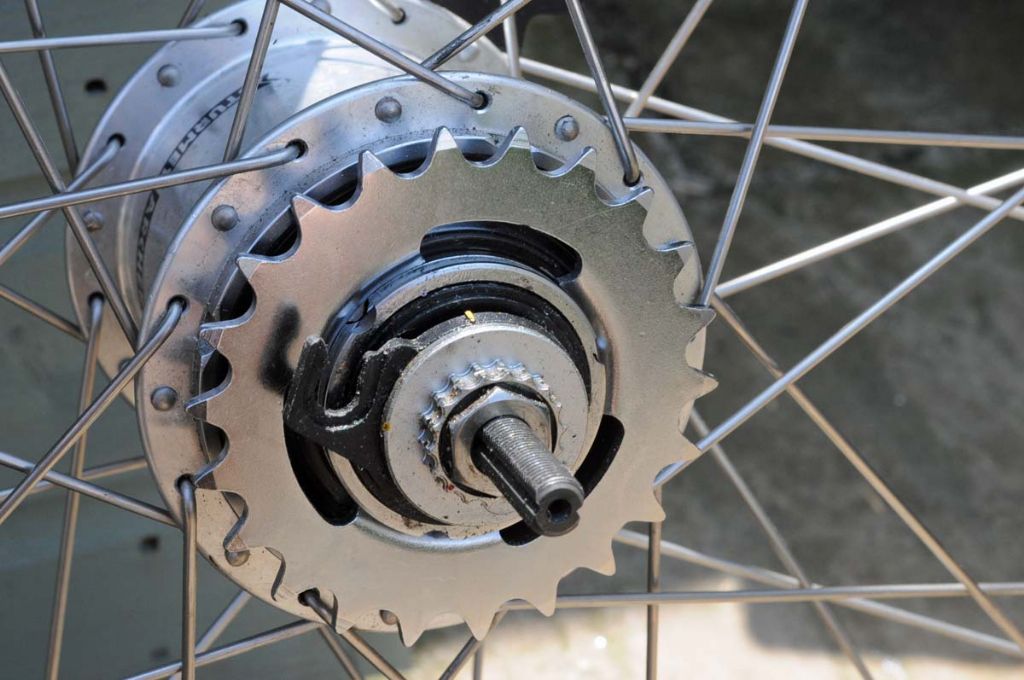

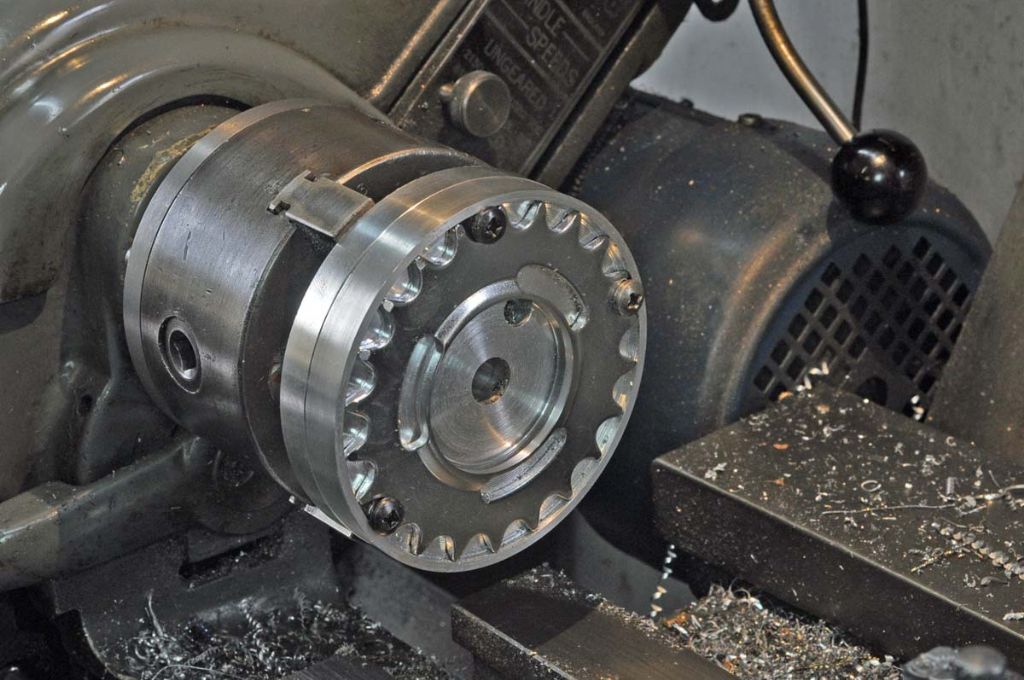

                                  I have a new (to me) push bike with a 5 speed Sturmey Archer hub gear (RX RD5). The lowest gear is a little too high for my poor old knees so I decided to change the rear sprocket from 20T to 22. The RX RD5 hub takes a gear with a 50mm centre hole and, guess what, you can't get that size in 50mm, just 35mm. So, to the workshop.

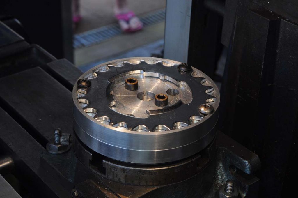

                                  First I made a nest for a 22T gear with a 35 mm hole and turned out the middle until it was the diameter over the driving dogs:

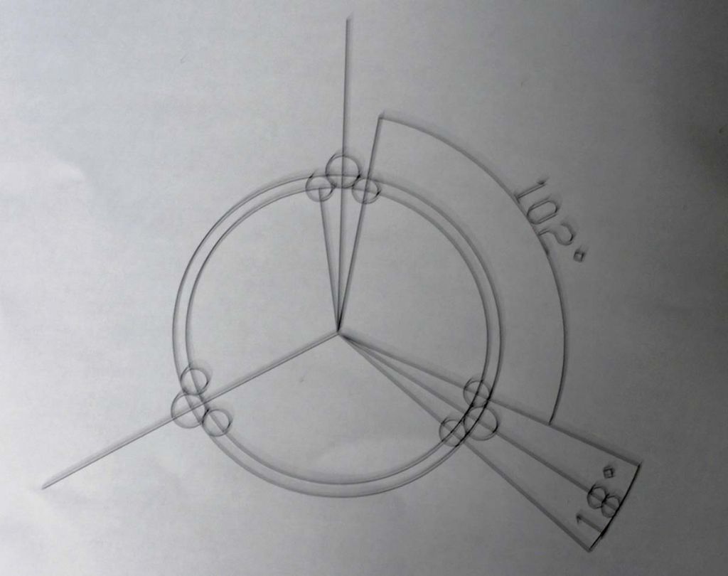

                                  Then transferred to the rotary table. A quick sketch in CAD showed that with a 4mm end mill I needed to cut for 102 degrees then jump over 18 degrees before cutting the next 102 degrees etc.

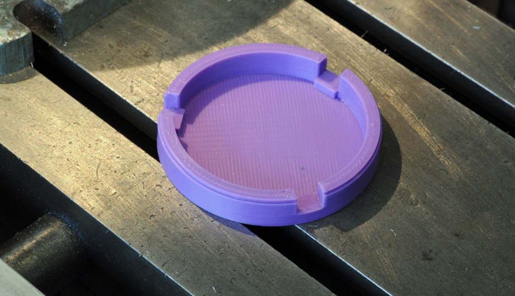

                                  I printed a go/no go gauge because measuring the diameter was somewhat tricky
                                  A bit of work with a file to bring the dogs to the correct profile and it worked
                                  I can now climb the dual use bridge over the dual carriageway and get to a pub in the forest smiley

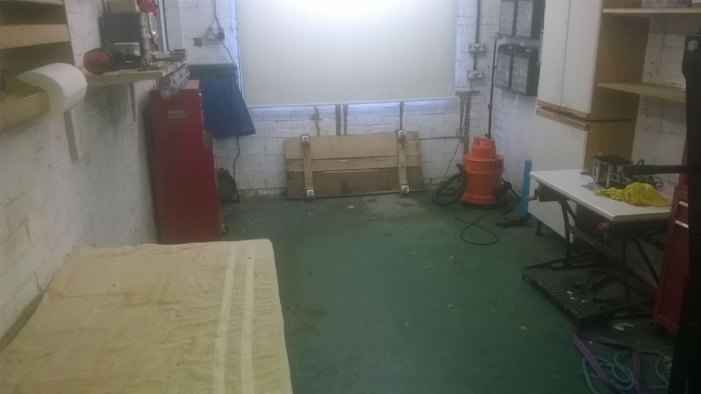

                                    After a successful bout of machine and accessory selling, I parted company with my lathe today. My goodness, the garage/workshop sure looks empty. I shan't be totally idle, though, I intend to concentrate my attention on CAD/CAM design and 3D printing the results.  I have a few ideas bouncing around inside my head. I only hope I can get them out.
                                    Another batch of goodies coming up for sale in the not-too-distant future.
                                    Just got to decide which side to place the 3D printer when it arrives.

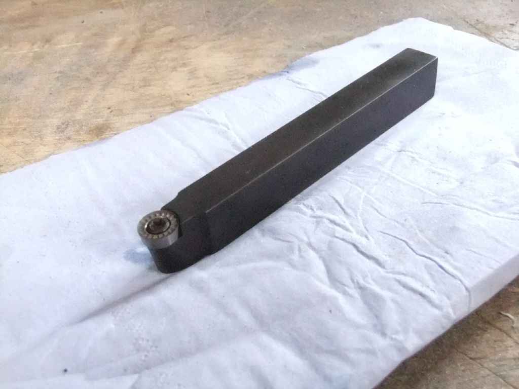

                                      Not much doing but did get a new tool made as I had a insert sitting doing nothing but no tool holder. Photo not too good but gives an idea

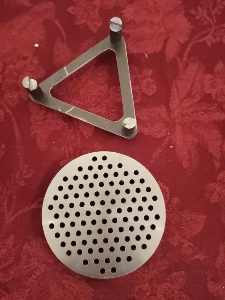

                                                  just to prove I occasionally make something, the grate for my test boiler, ands the trivet arrangement it sits on. I thought I'd give a pinhole/Rosebud grate a go
