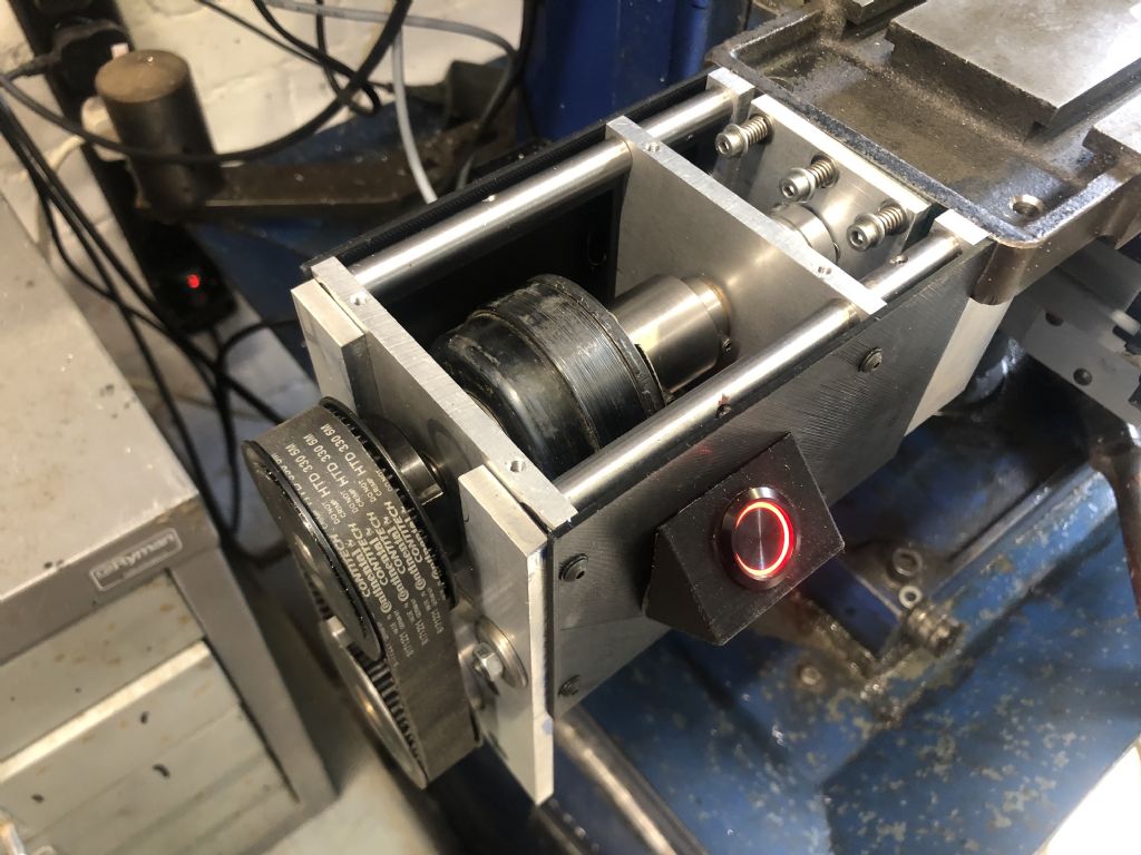

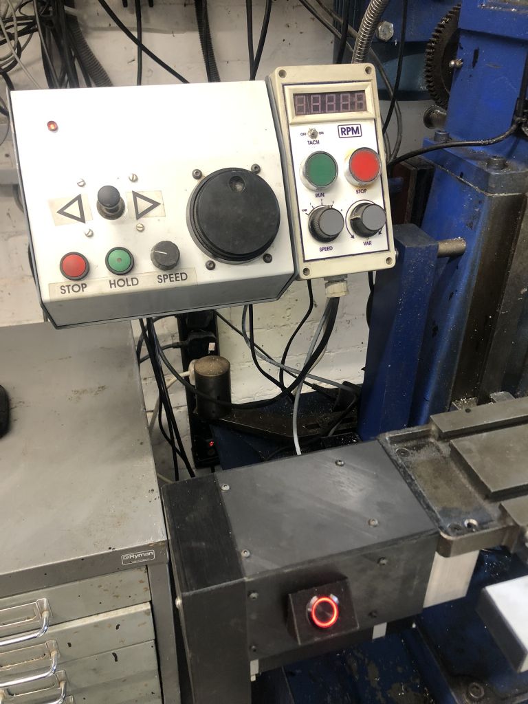

        ControlsAfter 25+ years of twiddling the x – axis handle on my Sharp mill, completed a project to build a power feed.
        Utilised a stepper motor and controller from an abandoned job and incorporated an electromagnetic clutch to allow manual feed.
        Covers are 3d printed.
        Controller is old school – made with discrete gates before Arduino appeared on the scene!
        Drive with cover removed

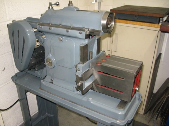

                Got my Acorntools shaper project running for the first time today and spent a happy half hour watching it swish back and forth as the feed ratchet clicked away. Mesmerising, and it makes a change from cleaning and painting, which is all I seem to have done for the past few weeks.img_0403.jpg

                  So you don't want to refurish mine too Dave?

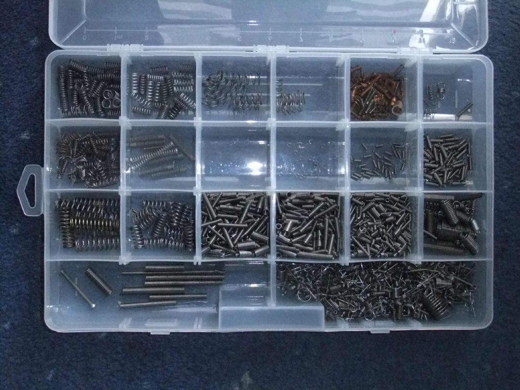

                    I went to a vintage weekend earlier in the year and brought a number of things like a pot of cap head bolts and a pot of odd springs. I had already done the cap head bolts and put them into plastic draw unit divided into their respected sizes.
                    The only thing I kept putting off was sorting the springs which cost me £2.00 for the tub, so todays job was to sit and do these and took most of the afternoon. This just so happened lead to clearing some draws which was very convenient as I al waiting for a order of quite a few BA nuts and bolts.
                    I had also purchased from the local charity shop two plastic containers one of which is pressed into use to store the springs.
                    Any bets the first time I will need a spring I will not have it.

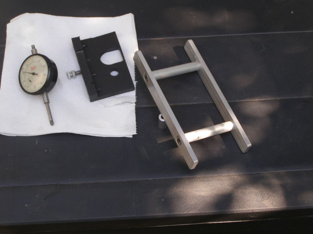

                                      The cumulation of several Days What I Did Things on…
                                      Photo 1:
                                      Left: Dial Gauge Holder, Top-slide, Myford ML7 and Harrison L5.
                                      Machined from an off-cut of some sort of engineering plastic (probably reinforced Nylon), it temporarily replaces the QCTP block. It places the gauge probe horizontally on the centre-height, used one way up on the Myford and the other way up on the Harrison.
                                      The appropriate hole fits loosely round the tool-post stud on its lathe. On the Myford, the shorter web is downwards and registers against the top-slide end.The Gauge is held by its mounting-lug screwed to the side by the appropriate of 5 tapped holes, and steadied by its body resting on the plastic.
                                      I machine the bulk on the manual Drummond shaper.:
                                      Right: One of the Reels, Cave-radio Ariel-Wire; made for Mendip Cave Rescue. Size approx. 180 X 95 mm outside. I greased the stainless-steel screws and the countersinks with "Vaseline" to give some protection from corrosion, bearing in mind that in use one pair of reels could be lying in a wet pasture and the other hauled through a wet cave! MCR wanted 16. I made "production spares" and ended up with 18 complete reels!

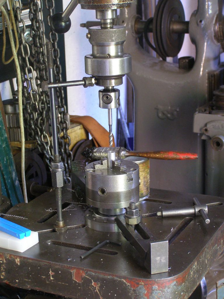

                                      Photo 2: Part of the batch-production line: using the tapping-head for the Ariel Reels' cross-bars. I spotted the tapping-holes on the lathe but drilled them to depth on the bench-drill. The 3-jaw chuck is on a Myford nose-piece registered and screwed into a plate with central spigot, made to be concentric with the BCA Jig-borer table.
                                      (When I make a jig or fixture I try to consider future possible uses.)

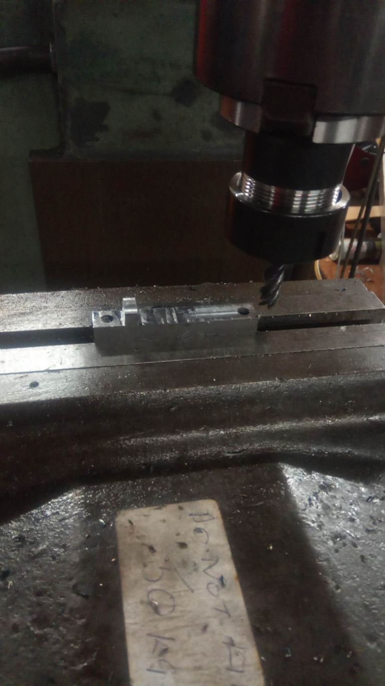

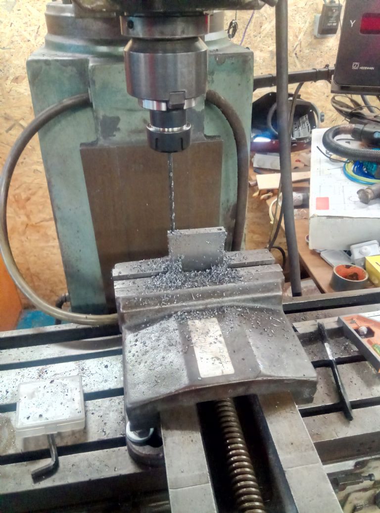

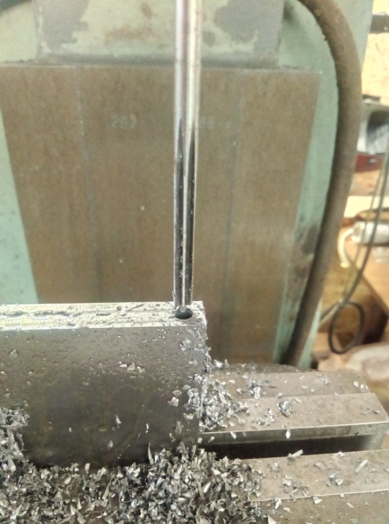

                                          Drilled two 5mm holes with a 25 L/D ratio in a piece of ground 100MnCrW4, then opened the top 80mm out to 5.9mm and reamed to 6mm…
                                          01-06-23 Deep Hole Drilling
                                          01-06-23 Ream to Size
                                          Only to immediately cut into pieces on the bandsaw, and mill matched flats onto the cut face.
                                          01-06-23 Matched Surfaces
                                          And start making some features…
                                          01-06-23 Initial Features

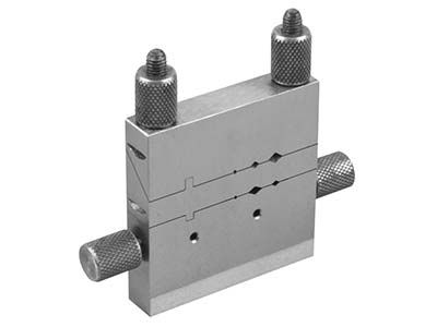

                                          All being well, tomorrow evening I will end up with something which looks a bit more like this, and can start worrying about hardening the components.
                                          01-06-23 Filing Jig
                                          I am wondering how best to make the angled face and features… Going to have to play about with work-holding to see what's most secure.
                                          Once that's done, I will need to bash out two more, which will hopefully be easy once the approach is all worked out.

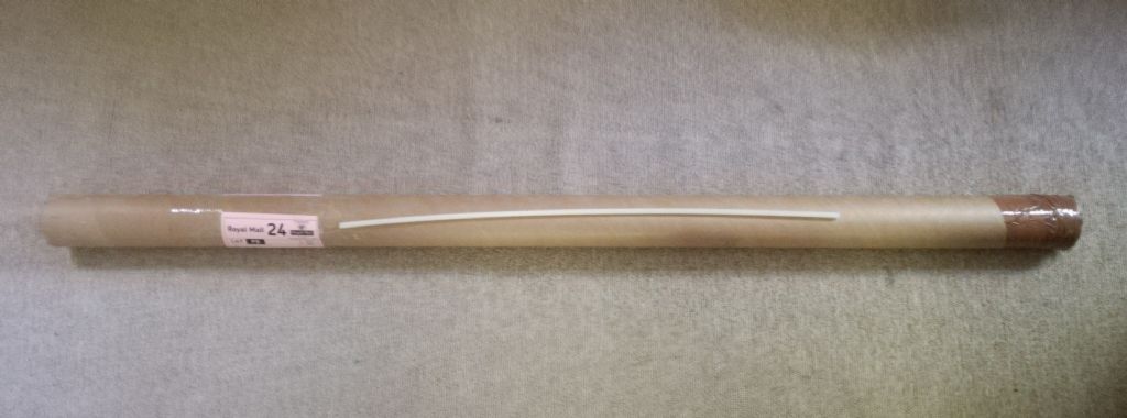

                                            Hi, not so much as what I did, but what I received in this mornings post. Photo shows a 500mm length of M6 Nylon threaded rod on the tube it came in, I guess the supplier didn't gamble on it going missing.

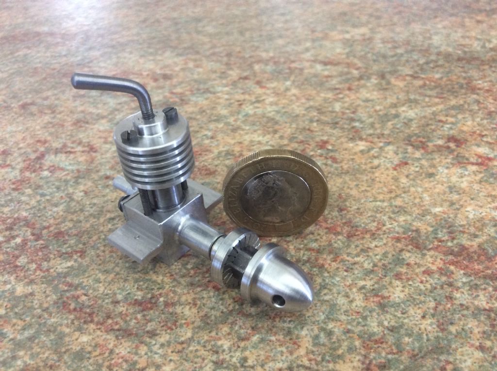

                                                      Modified Ohlsson and Rice .23
                                                      Over the last few weeks I've been using a 1940's O&R 23 sparkie to gain machining experience.
                                                      I've turned up a new prop driver (complete with inset magnet) to trigger an electronic ignition unit.
                                                      I've milled up some transverse bars to act as beam mounts.
                                                      There's a turned aluminium fuel tank to replace the leaking, plastic original.
                                                      At the back, I've fabbed up a simple sort of variable carb – connected to a throttle servo.
                                                      Hanging off the side is a milled exhaust stub that leads to an expansion chamber (complete with internal baffles)
                                                      Yup, it runs. Yup, it flies my Murg vintage model – just. Power is marginal, but that's not the point. It works.
                                                      Tim
