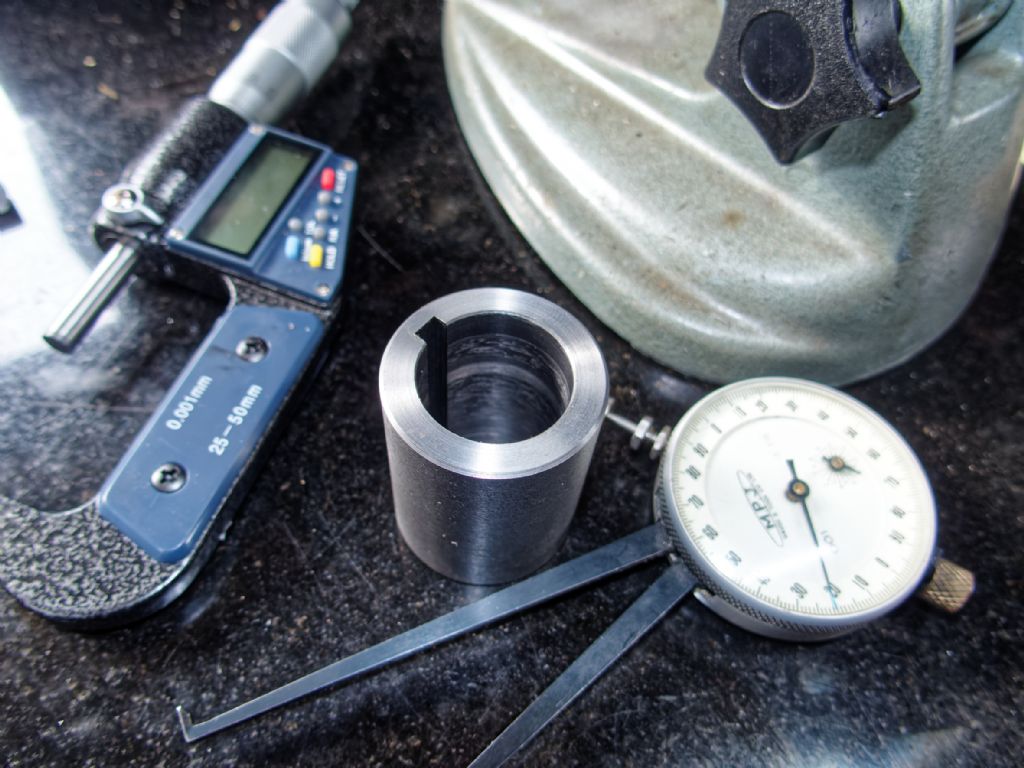

      Used my newly completed slotting attachment for the Boxford shaper on its first job.
      I found a replacement larger motor for my ratty old linisher, so needed to fit a new pulley to it.
      Slotting the spacer.
      Slotter Strutting its Stuff
      Setup for slotting the pulley itself
      Setup for slotting pulley
      Completed spacer, which will be sawn to length and used fix the offset for the pulley.
      Completed Spacer
      Bill

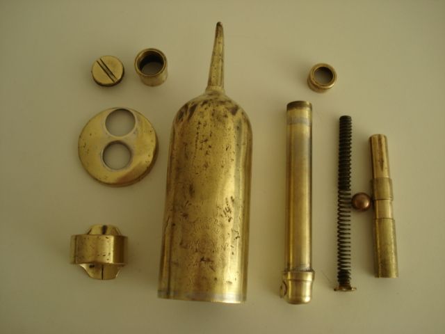

            Acquired an old oil gun last week. Bit of a state both iside and out-
            Required desoldering to reduce it to constituent parts to clean and repair. Found it to be another Lucas Oiler like the other one I have, but this is a Nbr 36 syringe type-
            Had to replace the pitted/worn steel ball for a new bronze one. Also needed to hard solder some internal joints to ensure all remained joined and sealed when 'closing up' the last 5 joints. Cut new leather seals/washers.
            Finished it this am with making new nozzle and cap. The nozzle fits into the grease type nipple holes on my machines. All now functoning perfectly without leaking at any angle. Not bad for a nearly 98 year old oil can-

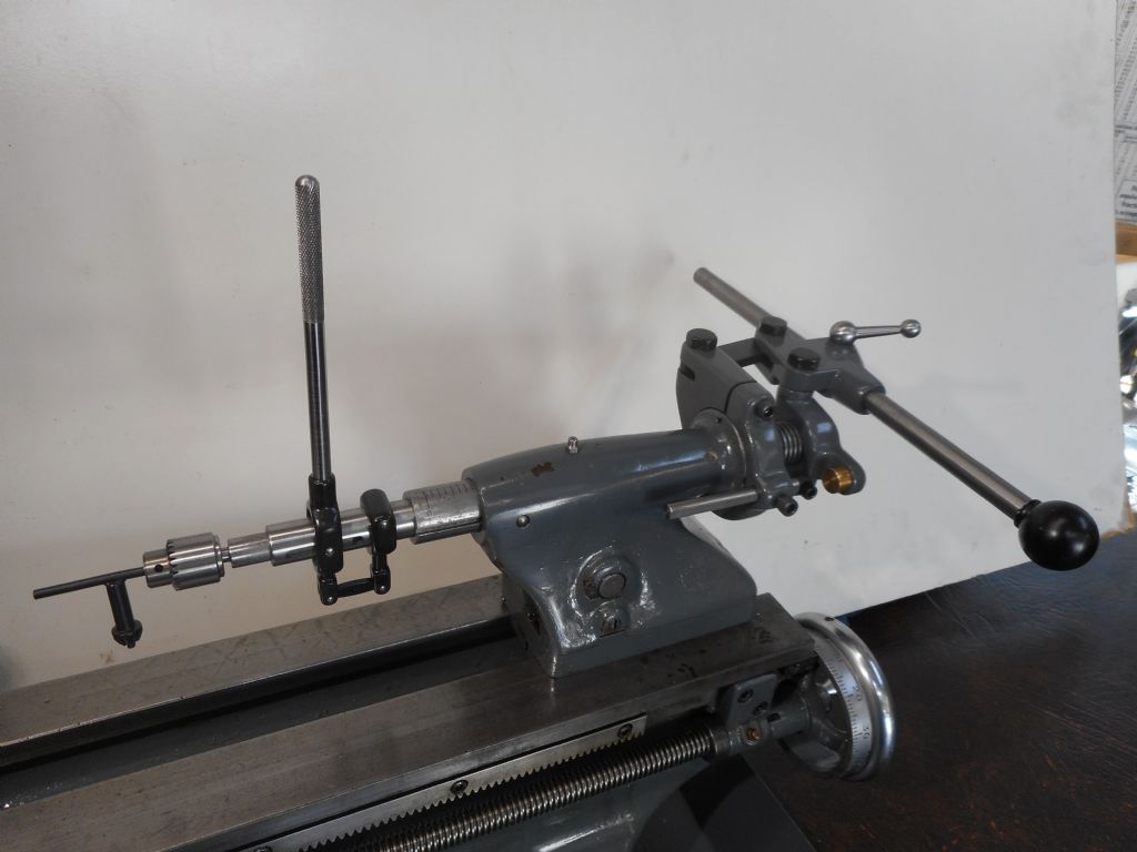

                        It's Lever Fever 'round here. If you leave them alone in the dark they start breeding little ones. Levers upon levers. A most enjoyable project from a 1929 ME article and drawings.

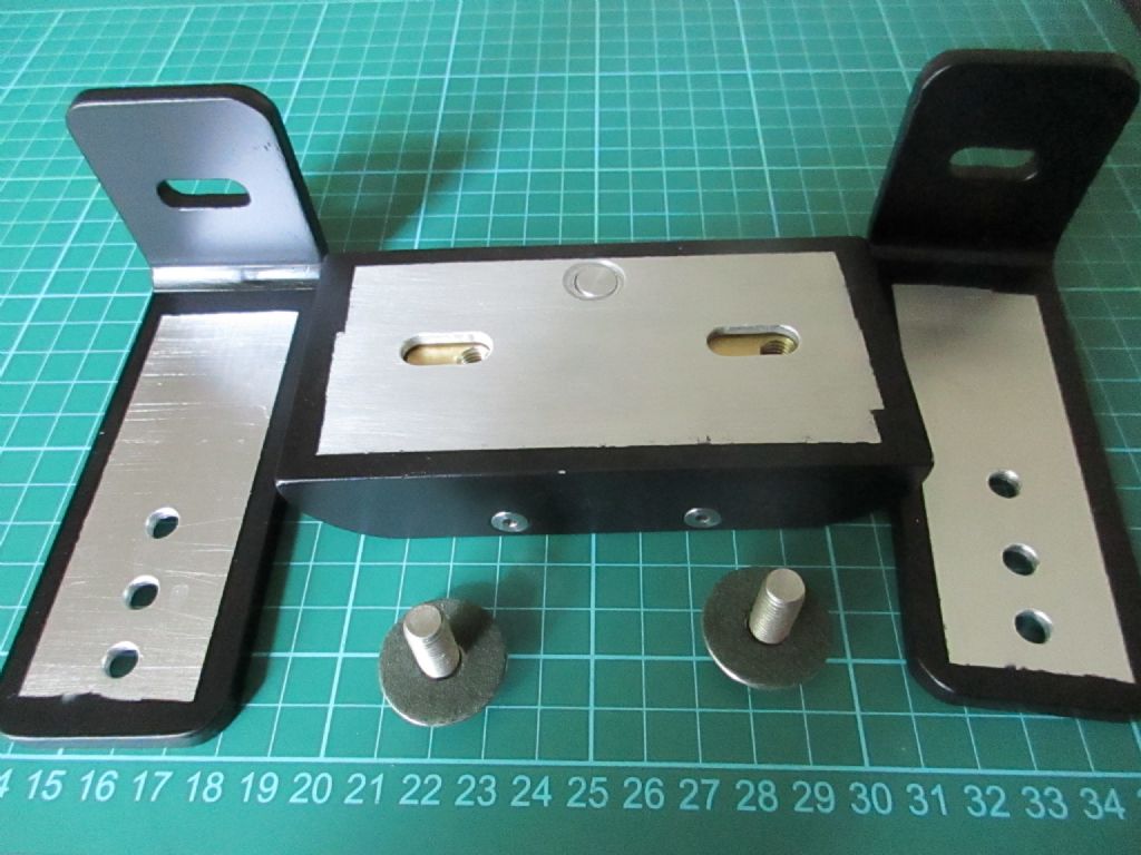

                            Hi, after cleaning and making some attachments to hold all the parts for my camera bracket for holding two cameras for taking stereo photo pairs and then masking the areas that I didn't want painting yesterday, today I spray painted then with etch primer from a rattle can and was quite pleased how nicely it was to use.
                            Hopefully if the weather is good tomorrow afternoon, I can give them a top coat.
                            Regards Nick.

                                          Posted by Hopper on 05/06/2022 08:17:54:
                                          Hopper,
                                          May I suggest a slight modification to your splendid lever-operated tailstock:
                                          Since the operating lever is simple to remove, I suggest that you might fit a brass contact 'button' (of the same diameter as the bar ) at the end opposite the knob. The operating lever could then do double duty as a 'bumper bar' to eject tools from the tailstock barrel.
                                          I may do the same to my Myford LOTS although I already have a 'bumper bar' – it stows in a pair of Terry tool clips on the wall behind the lathe. I made it, well actually I adapted it from something else, long before I acquired my LOTS.
                                          Do you remove the operating lever from the attachment when the ML7 is not in use – on my own attachment, the lever prevents the plastic lathe cover from properly fitting over the tailstock.
                                          Best regards,
                                          Swarf, Mostly!

                                                  Posted by Swarf, Mostly! on 15/06/2022 10:29:40:
                                                  Hopper,
                                                  Best regards,
                                                  Swarf, Mostly!
                                                  Swarf , if I had not put that piece of white melamine in the background to make the pic clearer, you would be able to see the "donger" I have hanging right behind the tailstock on the wall, used to knock things out of the tailstock taper with a weight on the handle end and brass button on t'other. I leave the tailstock lever handle in place at all times as when slid to about the halfway mark it does not stick out particularly. If slid right in it's way inboard, but not necessary. I'll see if I can dig out another pic showing the "donger" and handle retracted.
                                                  You can just see the "donger" in the background to the right of that yellow handled screw driver and brass bar end. It is quicker to grab than than finagle the tailstock lever back into the split brass cotter clamp in its bracket.

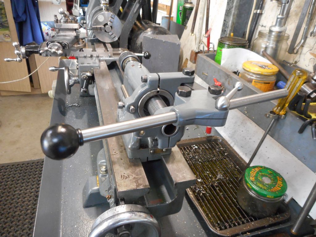

                                                    Swarf: Tucked in for speed. This is how I keep the lever when not in active use. Knob is inboard of the chip tray so well out of the way for my purposes. (I don't much use a cover and if I do it is an old bed sheet.)
                                                    I am very glad I went the extra yards and fitted the sliding handle and the little ball lever to lock it rather than a cap screw requiring a tool to operate it. This makes it quick and easy to move the lever in and out as required.
                                                    (Note: Those ball pein hammer marks on the front way are a legacy from the previous owner, not me!)

                                                      Hi, after priming my twin camera bracket a few days ago, I then put a top coat on and then assembled it all.
                                                      It was intended to put cork pads on the unpainted areas, but the self adhesive cork sheets that I ordered online for collection in store the next day, somehow got lost into the courier's dungeon, so after a telephone call on Tuesday last, a very helpful customer service person said he would get another one sent straight to my address and they promptly came yesterday and I was finally able to finish my bracket ready for use.
                                                      Regards Nick.
