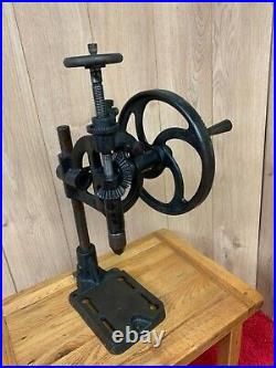

      I dropped in on our local auction house yesterday. Out-bid on what I went for, but I came home with a lovely little oscillator steam engine instead. It would have cost more to buy the brass to make one, so quite chuffed (no pun intended) with it.

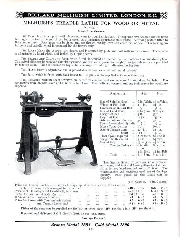

              Today I finished refurbishing and repainting my Reeves Trojan. This was my very first build, back in the 90's, built entirely by muscle-power on a treadle lathe and a hand-powered drill – a good way of learning the value of sharp tools. These tools were a hand-me-down from my wife's grandfather, and were my introduction to model engineering.

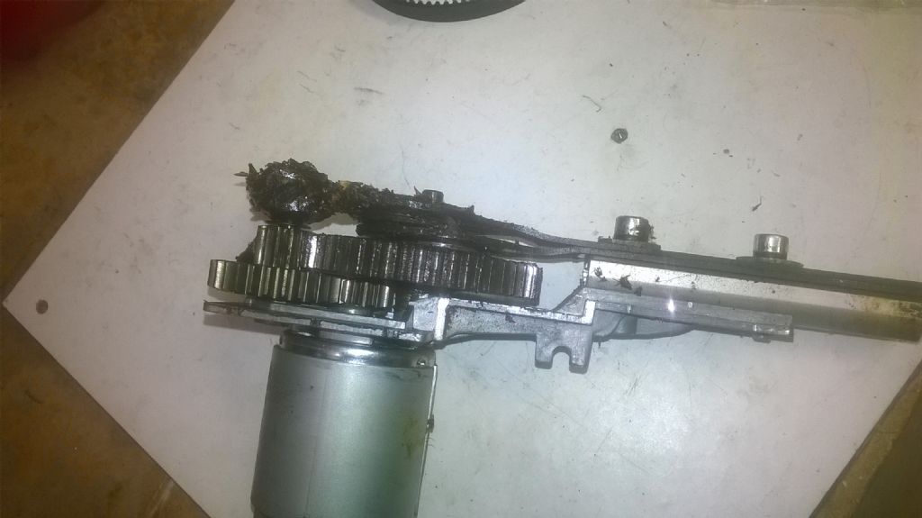

                Actually something I DID do today, although it refers to my earlier posts above, regarding the die filer ……
                I happened to have a new battery powered hedge trimmer which has "ceased to be". It also happens that I still have the old one (of different make) lying in the greenhouse. I decided to strip out the motor from the old one on the grounds that they are all pretty much of muchness when it comes to drivetrain – just in case the new one can't be replaced under warranty. I was delighted to discover that the oscillating mechanism would lend itself to driving a die filer and at the same time take up very little room with far less complication than my ram design.
                The drive is via sort of Wankel engine cams and the whole is driven through a series of reduction gears:
                geared drive
                And
                oscillating drive
                Sorry about the picture quality. The lighting is less than optimal.

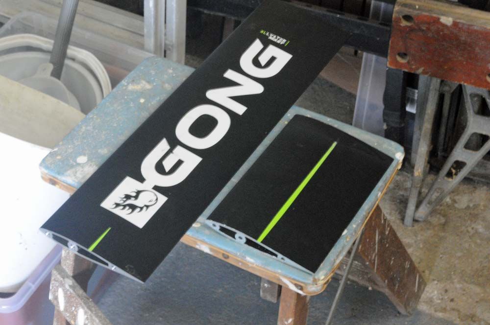

                        Wing foiling has got pretty popular around here:
                        The problem is that the water can be quite shallow, especially in Christchurch Harbour. The readily available masts ( the bit that holds the foil below the board) are too long for comfort. The masts are aluminium extrusions. After bandsawing to approximate length, the cut end was tidied up and squared off in the milling machine
                        The extrusion has M6 tapping size holes in the strengthening ribs so easily tapped with a M6 spiral flute tap held in a cordless drill
                        Job done
                        I've done a few of these now for friends
                        Rod

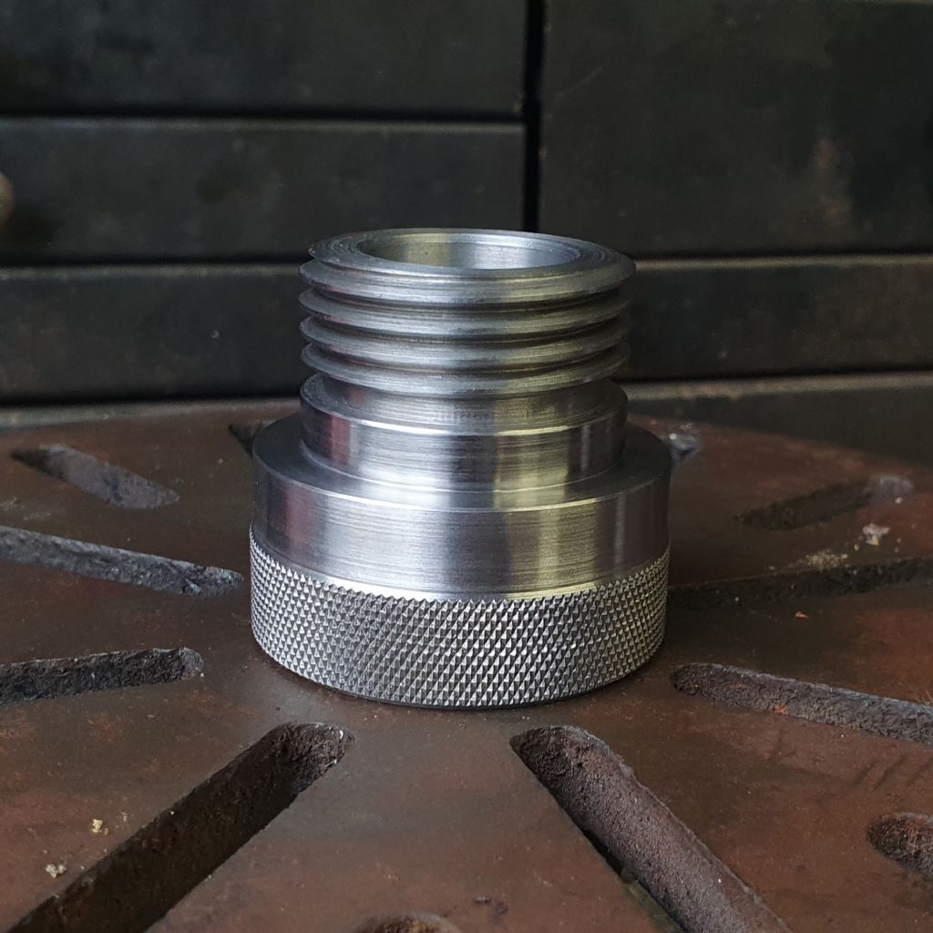

                                                  Made a spindle nose gauge for my Boxford. The thread is about a thou under measured over wires and the original faceplate and catch plate go on lovely. The register is a couple of tenths under 1.5". The actual thread on the nose of the lathe is a bit looser and the register is about half a thou under 1.5" so anything gauged with this should fit on the lathe nicely

                                                    That's a nice bit of toolmaking Craig
