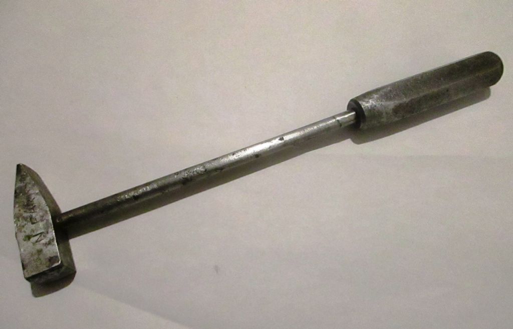

Oh, don't worry about using your hammer, Nick! Good to see you repaired it so it can snooze in peace again for years!

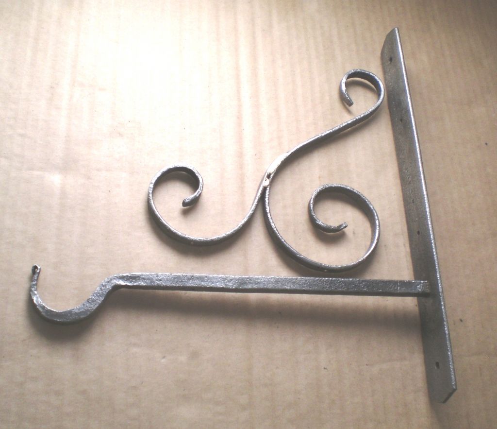

I've a few items I made in school metalwork classes, kept for nostalgia I suppose although family nostalgia has never been my strong point. (I wonder what I did with the birthday dates list my sister wrote for me…?)

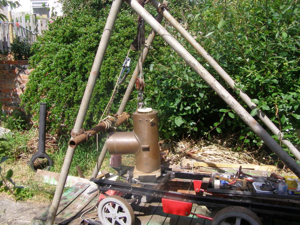

I took the photo two years ago, and it's not progressed much since because it's 3 steps in full forward gear then 2 to 4 back all the time. The woodwork under the boiler is part of its special lifting equipment. The vertical engine will live in the chassis just behind the boiler: the large red plate is nominally for the outer transmission-gear bearings. The black thing to the left is the smokebox and chimney, not a miniature one of those trendy garden oven thingummies!
