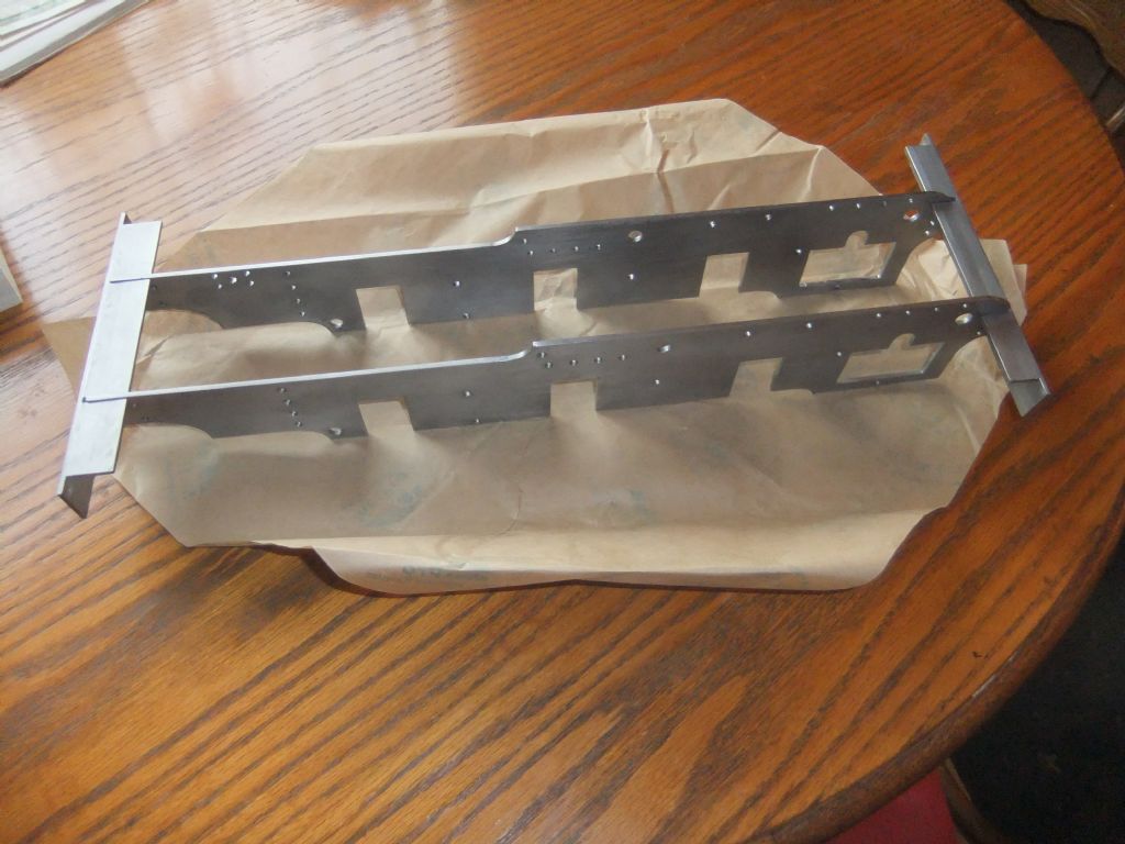

      Cut the two slots in each buffer beam for the main chassis frames to fit into using a 3/32nd" milling cutter very slow as did not want to have to wait if I broke it, there also was a little filing as the cutter left a half circle at the end so had to square that up so the frames fitted right into them. They fit very snug so a nice push fit into them. This is the first of many dry fits. I need to make some brackets so they can be riveted together but that will have to wait as other stuff need doing before they can be fixed in place.

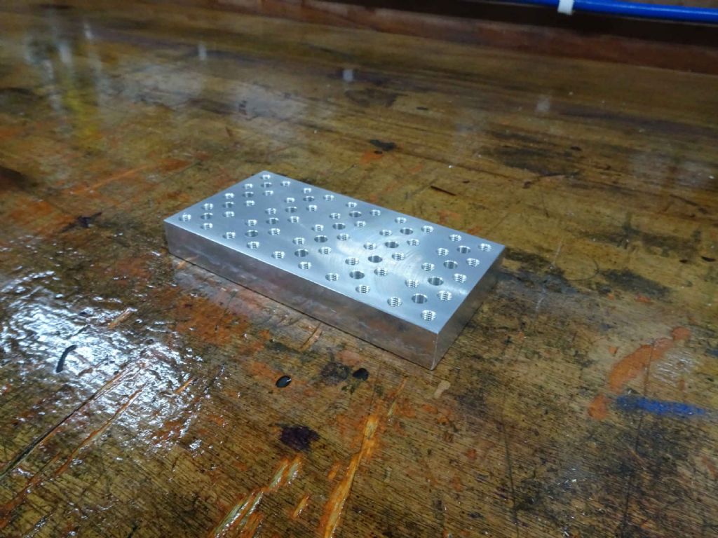

            Today (well yesterday) I made a 3×6 (or 75×150) fixture plate.
            I was delighted to have the benefit of a DRO otherwise this would have been both messy and even more boring that it was. Here's one situation where a CNC would have been very nice. Just watching it whilst I had a cuppa.
            The M6 tapped holes were all power tapped and that worked pleasingly well.
            Finally, this was my first successful fly cutting operation. I shall do more! (also showed I need to tram my mill sad)

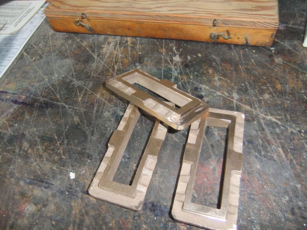

              Not just today anyway I have managed to do some clean up on the horn blocks just need to machine the insides and the backs before cutting in half
              Took a day off just to have a go at the buffers but as can be seen only one part complete when I realised that the carbide insert tip broke will try again tomorrow when I turn the insert to see if I can clean this up if not looks like a remake. Not sure how I managed to chip the insert as I can't remember hitting anything with it or going silly. I do like to know how it happened as I will have learnt not to do it again.

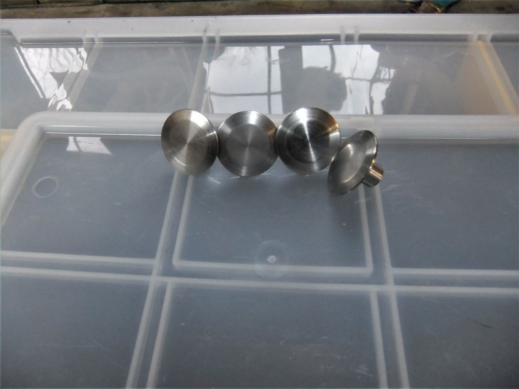

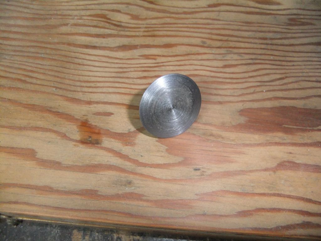

                  I scrapped the first buffer as I was not happy with the finish. So the last couple of days I set about making 4 of them. I know this is a little jump from the main chassis but there is a reason and that being I would rather get these wrong before working on the axles.
                  I would rather practice on a less important part and have to remake that, still learning a lot but that is what it is about.

                      Well done Derek, looks good. We never stop learning.

                        Thank you Jon.
                        Never too old to learn is my moto. My first thought if something goes wrong is what did I do or didn't do, select the wrong speed use the wrong cutter etc before saying this Bl**dy machine is rubbish.

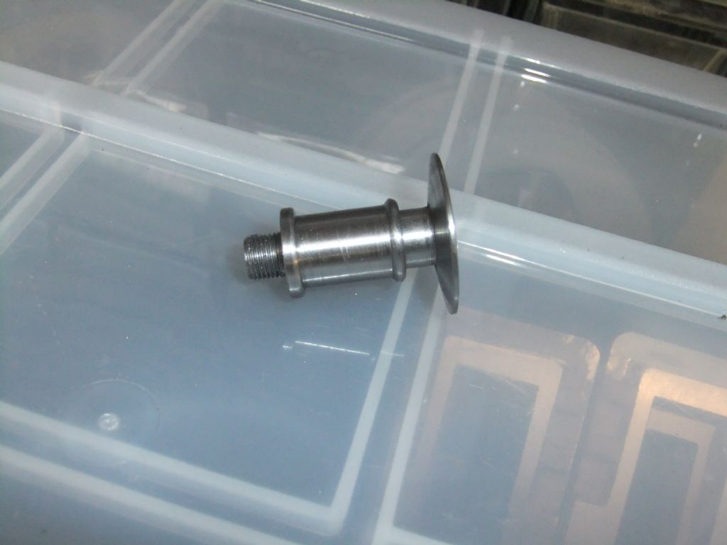

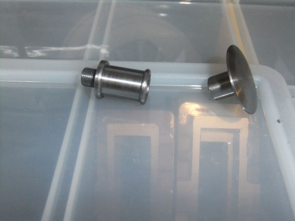

                            More work on the buffer assembly I managed to turn all the outside of the stocks and then reverse one of them and drilled a small through hole and opened up a section for the buffer to fit into. Still need to drill the other three.
                            The completed stock on the left with the buffer on the right
                            Rob Roy-dscf2226-jpg
                            Slide together I still need to make the springs the front and rear spring are different strengths as well as some nuts to hold them in place
                            Rob Roy-dscf2227-jpg

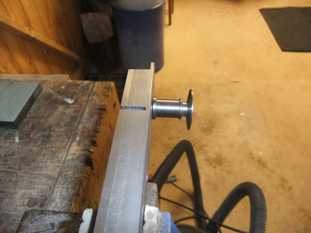

                            The buffer beam with the buffer assembly just pushed into place
                            Rob Roy-dscf2214-jpg

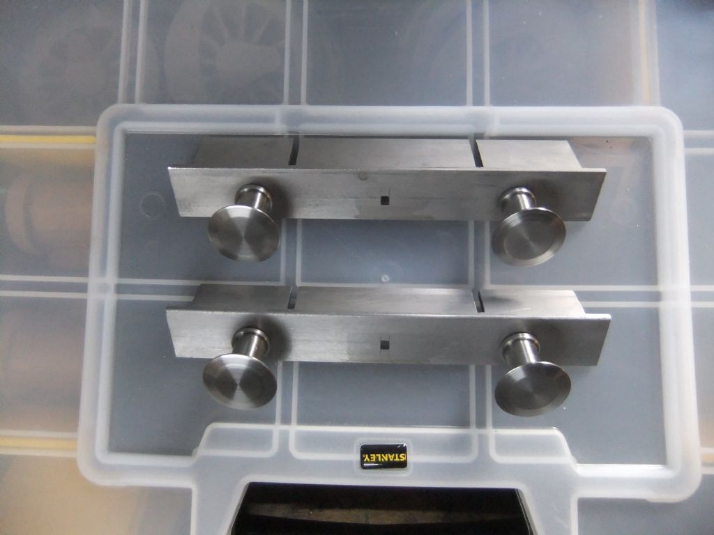

                                  Sorry guys here are the photos
                                  And todays update. All four of the buffer assemblies turned just need to wait for some spring wire and some 5BA nuts so I can fix the stocks to the buffer.

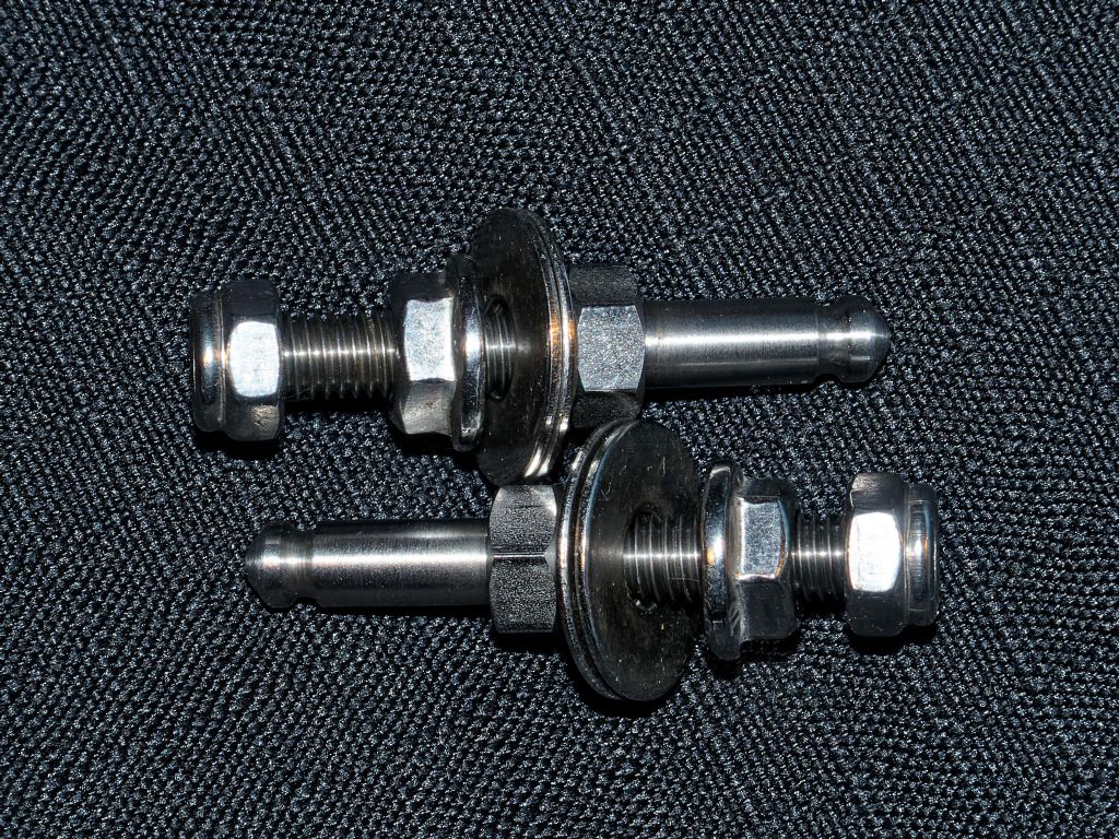

                                        Nothing wildly exciting, but made a couple of press stud fasteners for affixing a soft top on a club member's Marlin.

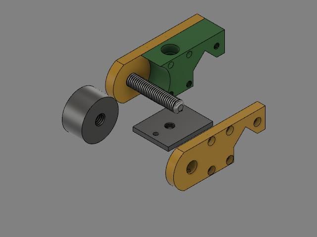

                                              I think we all have that tendency! Following on from the other thread about carriage stops, I made a start on redesigning my original one into an adjustable one. I got this far before sanity set in:
                                              That's three complex pieces, full of fussy features which will need a number of setups just to make the adjuster dial fit into the body. So I took the basic dimensions and this simplified version emerged:
                                              The body is now one piece, and the only 'complicated' feature is the notch to fit it onto the lathe bed; everything else is simple milling, note how the counter bore for the clamp bolt has gone so the hole can be drilled through from the bottom at the same time as the anti-rotation pins. The clamp bolt and pins are each shown as one piece, but the bolt will be made with the thread loctited in place and the brass pins will be simple rods retained with grub screws. Both of which are much easier to do, stronger and easier to replace if they wear.
                                              The hour I spent on the first one isn't wasted, because it means I now have a design that's actually worth making:
                                              In CAD, you would have created the jig by subtracting the part from whatever material you decided to use, and projected the fixing holes into the new piece. Then the program would have told you what the dimensions actually are, instead of you trying to work out what you think they could be. A huge time saver, let alone reducing the amount of wasted material. As we've said before, the learning curve is steep, but it pays back in many valuable ways.

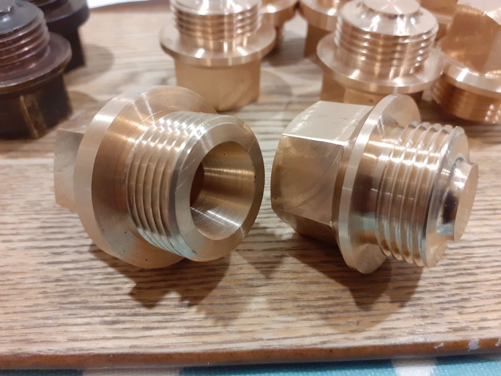

                                                      Some water-gauge end pieces for the S160s – 4-off of each.
                                                      Screw thread is 1.1/8" – 12. I didn't wanna add a speed-range change to the changewheel setup needed for 12 TPI, so I ran at 180 and depended on a sharp switch-off before the tool hit the flange face. It was LG2, so I used a straight plunge cut, to simplify the arithmetic which, since I had no gauge or nut, was all I had to get the depth right at .0534". About 2 – 4 thou per pass without disengaging the halfnut, 'cos it's a Metric Warco.
                                                      Mercifully I got away without collisions and first-off fitted nicely.
