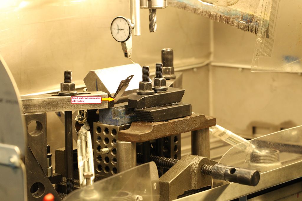

      Ok, so today I completed the 2nd shoulder of the train rail.
      To my surprise the 12mm carbide cutter run through the rail like butter compared to the facemill brazed carbide cutter. The brazed carbide cutter added toolpressure resulting in cutting without adjusting depth up tp 5 reversals before it stop cutting, like sparkout on a grinder.
      The 12mm cutter cut freely and no cutting on 1st reversal, that was a surprise.
      Due to the uneveness of the rail head underside I nswitch to a different holding method. I set up a 45 Degree "jig" with vive and everything you see in photo. I then add a chain pulling the rail towards this and in vice closed with a round HSS bar tool. The vice stay clamped to this the whole time.
      I tighten the two fasters pinned down to bed like a tent, and do the adjustment with feelers and checking it with a test dial indicator.
      So I think I can go further with this rail….
      See photo:
      2nd 45degree shoulder-diffholdingmethod.jpg.

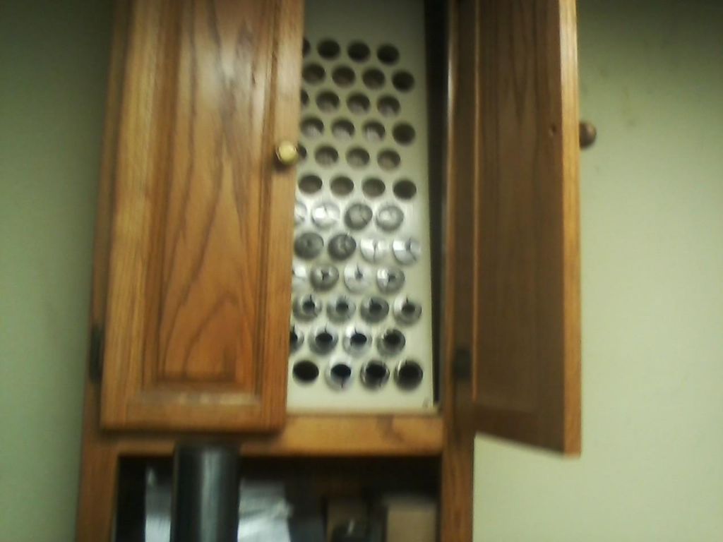

        Bought at a boot sale for $2. Triple epoxy coated paint.collet storage

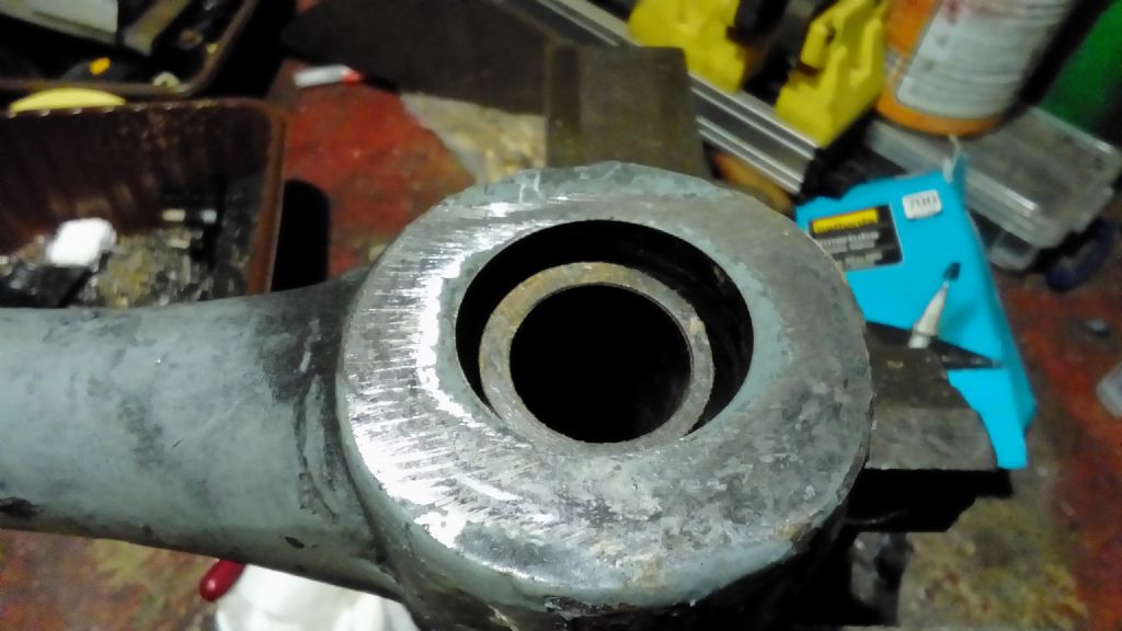

          The steeple-keeper at one of the towers where I ring mentioned he thought the clapper on the tenor was a bit loose after removing the muffles for Rememberance Sunday.
          On investigation, none of the fasteners were loose, but there was about 8mm of vertical play, so we dropped the clapper assembly out the bottom.
          After heating to break the loctite, I undid the M20 locknut and pin to reveal this unexpected result:
          That's a 1" diameter, 20mm bore tufnol sleeve, floating in a 33mm hole. Neither are damaged, in fact the original machining marks are still visible. There's about 1mm side clearance in the clevis, and no trace anywhere of missing material. So where is it, and how did it get there?
          I machined a connecting sleeve out of a chunk of delrin,
          and reassembled everything ready to refit before practice on Friday.
          except for the bell, all of these parts are about 16 years old and shouldn't be showing any signs of wear. We checked the other seven bells, and they're all fine. So I'm mystified: how did this happen?

              Very odd indeed!
              Is that the clapper itself or some other component? I'll read it as the former for this.
              I'm assuming the pin and nut generously overhang the Tufnol bush (only 2.7mm wall) so rule out the original liner sliding out over one end of that. Anyway, you'd probably have found that unless there are lots of places for things to hide in.
              The condition of the machined surfaces suggests they were not acting as accidental bearing surfaces on a loose sleeve until the machining marks "filed" it away.
              All I can think of is that the sleeve, whose wall is only 4mm thick, had somehow loosened over time, and suddenly broke into several relatively large pieces that dropped into nooks and crannies not obvious. If it had worn away we might expect patches of distinct dust and small fragments on various areas of the bell frame and surrounding floor.
              When though? During ringing? Wouldn't that give a sudden shock or lurch, or mistime the round as it happened?
              Or – tenor bell… heavy. So would the sheer mass of metal on the move tend to smooth out the collapse?
              What was the sleeve material?
              I'm thinking the sleeve eventually broke into pieces during ringing, perhaps over some time; and those left the scene gradually, "gently" letting the clapper come to rest on the bearing bush itself. It did not have far to fall, 8mm at most but probably in irregular steps.
              Or would that full 8mm radial play have given some very strange "big-end gone" clanks and clonks audible between the real chimes as the bell is raised? I am surprised it had not cracked the thin-walled Tufnol bush, even if that was one of the SRBF grades.
              Intriguing…..

                Although that's a terrible photo, it does show my confusion: there's no way big chunks could get out, and there are no traces anywhere on the clapper, or on the surrounding bell, frame or floor. Because of that, I have no idea what material was originally used. The play wasn't discernible when ringing the bell – I'd rung it down just before the fault was mentioned – although there is another room between the belfry and ringing chamber, which does damp out any extra noises. At <500kg, it's not a particularly heavy bell.
                My photo of the bushes is slightly staged, as they're barely longer than the clapper is wide. There's maybe 1.5mm of side clearance for the clapper in the clevis, which is pretty typical of new installations; these things hardly need tight tolerances as they used to be made by blacksmiths.
                The plan is to refit the clapper, ring through Christmas and inspect it a couple of times in the early new year. And I've got to clear up the big pile of swarf from making a 33mm diameter bush from a 75mm piece of stock.

                  I see what you mean: the joint resting on the vice.
                  Is this a system that swings the clapper against a stationary bell rather than overturning the bell?
                  The sleeve can only have worn down over the years to something like dust then, fine enough to pass through a tiny gap; and probably dispersed by draughts.
                  The original sleeve might have been hardwood, such as lignum vita; but is there a reason it used a thin-walled bearing bush and an extra sleeve also with a very thin wall? I'd have thought it would have had a single bush of 8.5mm wall, that fills the annulus.
                  That this particular sleeve wore away but the others have survived, suggests it may have been a very slightly loose fit, so it was not long before it tried to act as a bearing. Is the tenor bell used a lot more often than its companions, so extra wear-and-tear?

                    My guess is that a bush was never fitted in the first place, and it's taken 15 years for anyone to notice!
                    The number of times I've reassembled stuff only to find a few spare parts left over…

                      As a ringer myself, that looks like a standard clapper for 'full circle' English church bell ringing. The Tenor bell is not normally rung any more than the others in the tower. The church clock might use the Tenor bell, but if so, it would strike it with a separate hammer when the bell is 'down', i.e. hanging down safely, rather than being propped upside down as they are when ready for normal English ringing.
                      I suspect that this Tenor clapper joint was assembled by the apprentice, who forgot the sleeve. If the sleeve had broken up during ringing, you wouldn't have felt, or heard much difference while ringing. When ringing the bell up, the clapper might have sounded more 'loose' or might have double bounced on the lip of the bell, but only if you are near enough to the bell to hear it.

                        My thoughts are the same as SOD and John Doe 2, there should be a sleeve that was never fitted. Mistakes do happen, most engineers would regard bell hanging as a bit "agricultural" in nature, but this is a bit excessive!
                        You might like to check this website for a bit of information.
                        https://witneyandwoodstock.odg.org.uk/wordpress/wp-content/uploads/2021/09/tbc04_clapper_bush_wear.pdf
                        I think your Delrin is probably as good as should have been originally fitted to reduce the shock load. I think that if I was curious enough I would drop one of the other clappers just to see what that one looked like. You could of course contact the last firm that overhauled the bells and ask, what might be for them, an embarrassing question.
                        I think I would wait for the warmer weather before checking, it can get really cold up in the bell chamber and handling cold metal and laying under a bell frame that is too close to the floor is no fun what so ever, done it too many times.
                        Keep up the good work. To often for church members, it's up in the tower, it's out of sight and out of mind! Only the ringers know what goes on there.

                          Neil, thank you for the link as it gives me plenty of confidence in my that ought to be good enough and I can do it right now repair. There's nothing tricky about any of the engineering once you get past fitting the frame into the building.
                          Somebody forgetting to fit a needed bush would explain why there are no traces of it, and if this had been a very recent installation would be easier to accept. That would still imply require lousy quality control. But I find it hard to believe that there is no damage to either the tufnol bush, clapper hole, pin or clevis from probably 20kg of clapper clonking around on/in them for 16 years! The reported play would have been just as obvious every other time the muffles were used too.
                          If it were still possible to speak to the installers about this, we would even if that were to acquire the 'correct' part.
                          Having seen the results of neglect, wishful thinking or inadequate repairs means not spending 5 minutes checking this a couple of times over the next few months isn't acceptable. Now we know about it, we can't justify potentially damaging a 500 kg, 130year old bell. Access is good and there's room to at least kneel under the bell, and I've done far harder jobs in much worse conditions. Dismantling a good part just to have a look is something I'm much less comfortable with.
                          As the tenor of a light-to-medium eight, it's rung every time the bells are. There isn't a clock, and that would strike the outside of the bell with a hammer.

                            Tufnol is quite a resilient material, but as you say, 16 years of use without the outer sleeve should at least have shown some signs of wear or deformation. Perhaps there was one fitted originally and it has just completely disintegrated, we'll never know now.
                            At least it was caught and corrected before any real damage occurred.

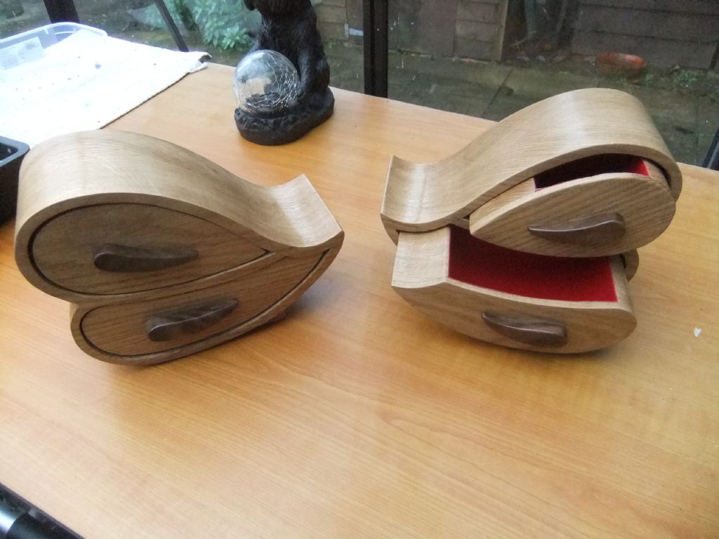

                                  Been making these for Christmas presents just one more wooden thing to make then I can get back to working on the Rob Roy.

                                    Beautiful workmanship were they steam bent.

                                      No they are made from solid Oak and cut using the bandsaw lots of cutting and re-gluing back together to keep all the grain running through them

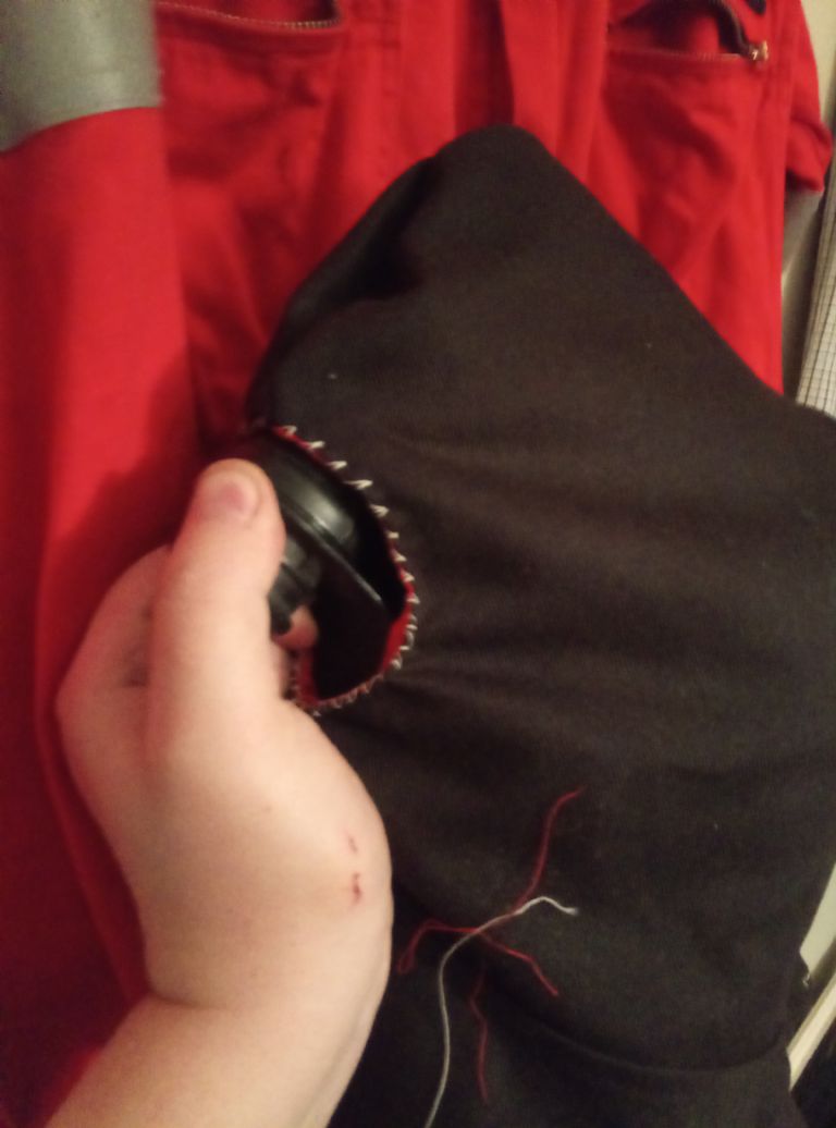

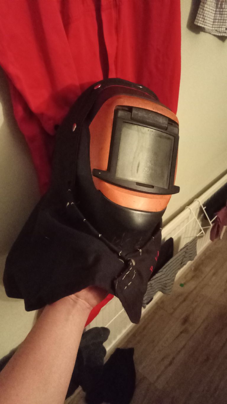

                                        Nomex Thread arrived in the post, so cracked on with a little bit of (Flame Retardant) sewing…
                                        01-12-22 Sewing Hood
                                        I dislike being backlit when welding, and a mating my shield with a hood solves that pretty well, whilst also giving good protection when in vertical and overhead positions.
                                        01-12-22 Sewing Hose Details
                                        3M used to sell one designed specifically to work with this unit, but it's now ancient and officially obsolescent, so I just made one from a cheap nomex hood and some press studs.
                                        Being PAPR, it's not actually hot or stuffy in there with the hood down, which is a nice touch.

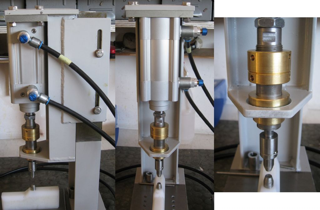

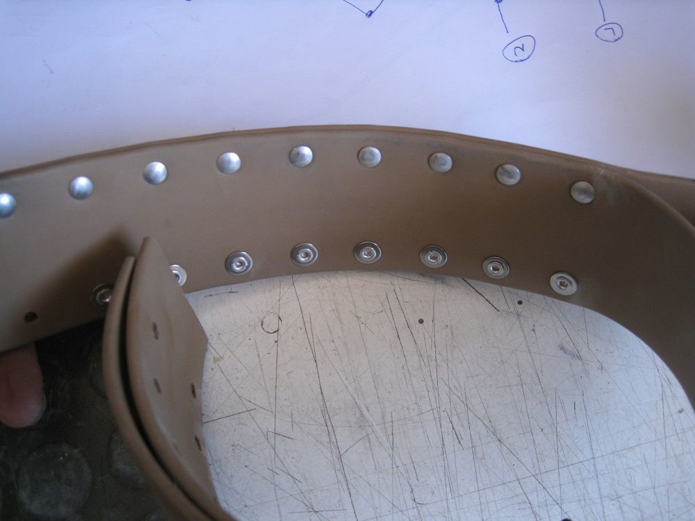

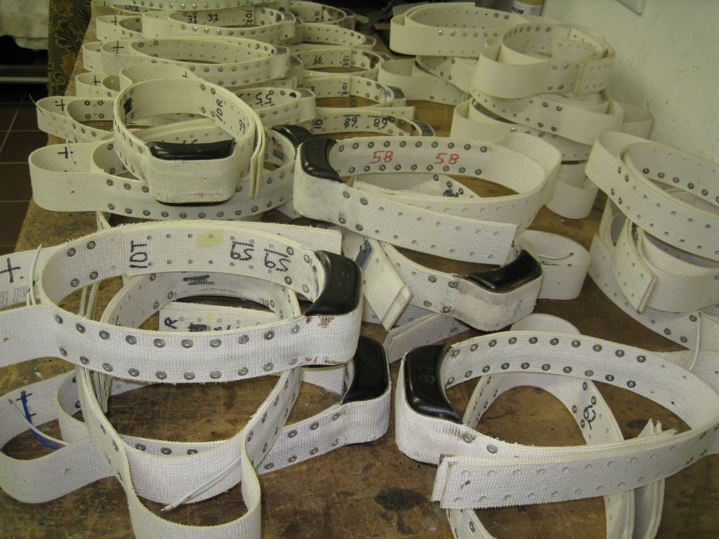

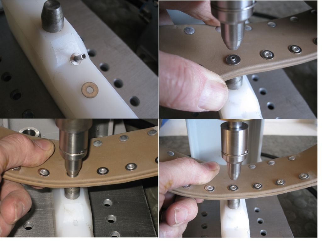

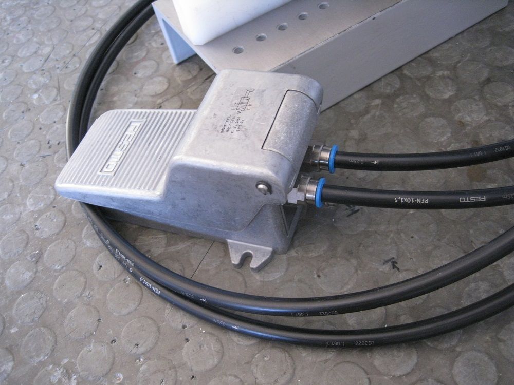

                                              Built a pneumatic rivet queezer – I use 3.2mm semi-tubular aluminium rivets in the mnfr of Lion tracking collars here in Namibia. I have so far manually squeezed about 8000 rivets in the past 4 or 5 years…I am also changing collar strap material to a much tougher material ( biothane) as the Lions keep biting through the collars..Which mean new molds for the epoxy encapsulation of the electronics, etc..So while busy with it all, I made a pneumatic riveter – used some Festo products – a double acting cylinder, 80mm diameter piston, so adjustable restrictor valve to slow everything down to my speed, and a foot pedal. It works like a charm…
                                              The two rings with rod holes allow exact setting of river squeeze length – photo below, right.
                                              The rivet snap is removable as well. Also, the snap head is spring loaded, about 10mm of spring depression before the rivet starts squeezing – giving me time to line the snap pip up with the rivet tubular inlet.
