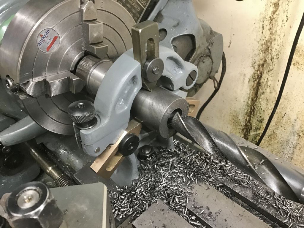

      Made a little knurled and threaded knob to secure the changewheel cover on my Boxford, and knurled for the first time ever, so inordinately pleased with myself.
      Learned not to apply cutting oil to knurls with a brush… blush

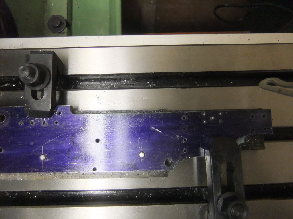

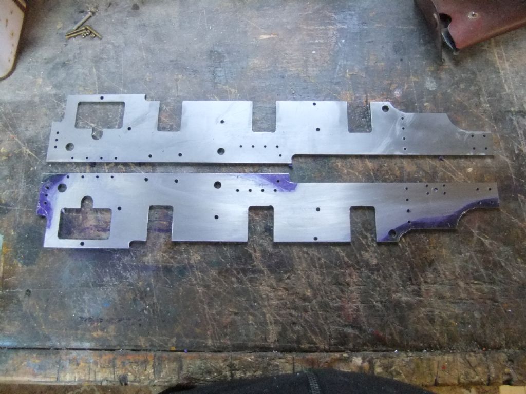

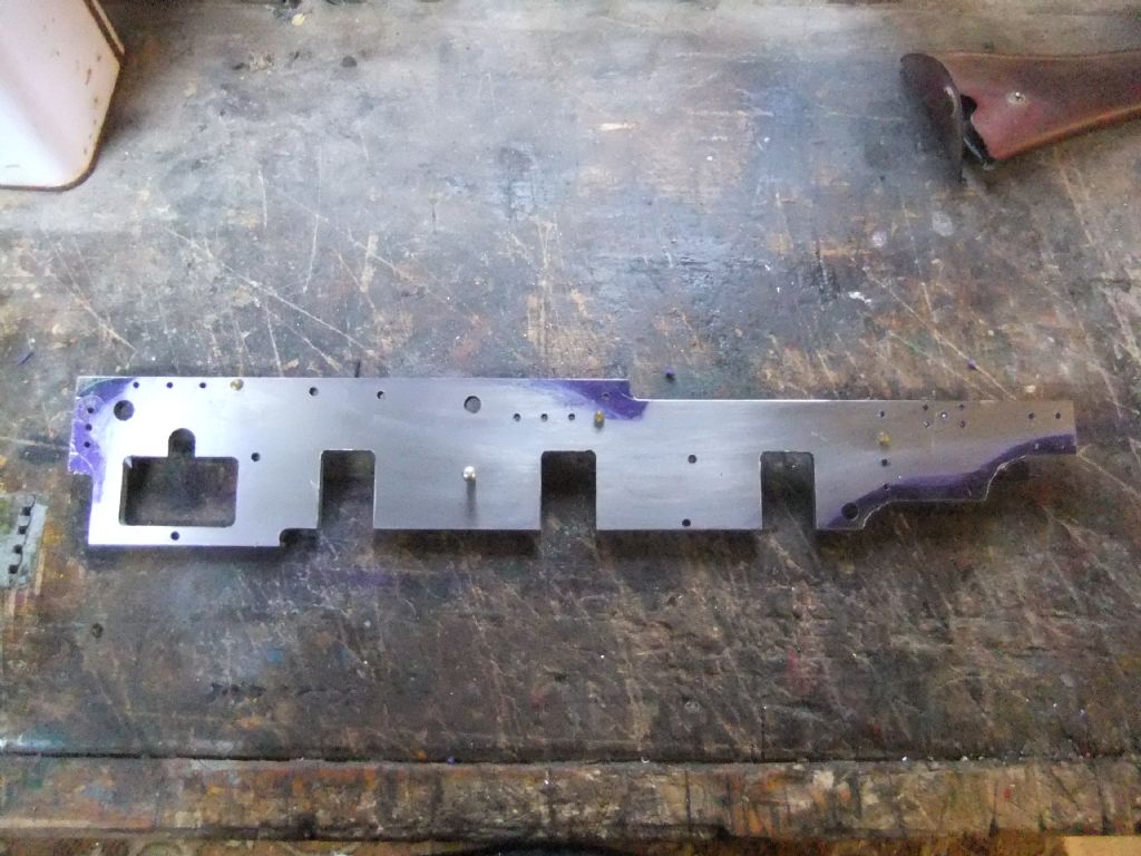

          Spent the last couple of days finishing getting the chassis frames to overall size and then cut out some of the pieces still need to do all the drilling as well as file the curves for the bits I have cut out. I have managed to take out most of the metal using the mill so reducing the filing I will need to do.
          I did have a small mishap where the part moved but was able to realign everything and set the DRO to the datum point I was working from no damage to the part luckily. It was not he machine but me that caused it lesson learnt for later
          Fully sized

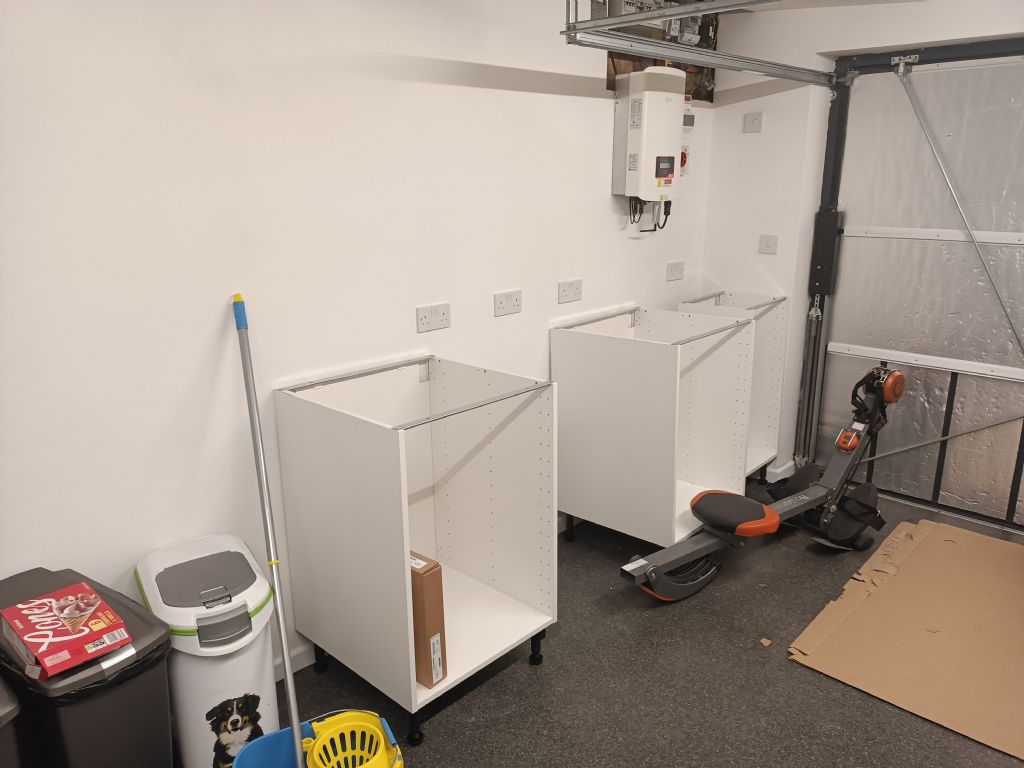

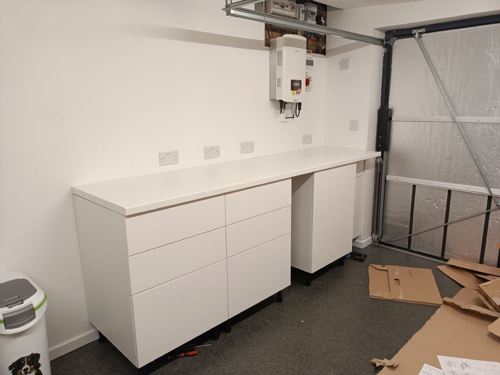

            The new workshop is progressing, the left side is almost done, one high larder cupboard will be added.
            The gap between cupboards will be used as a raw material storage. And I think also my vice will go there. We will see.

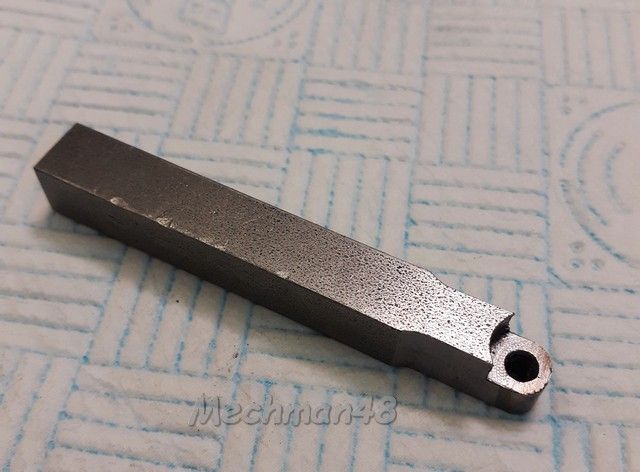

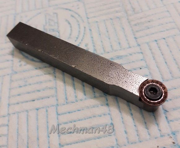

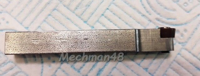

              Happy new year to all readers. I'd bought a pack of 10mm, round carbide insert tips to compliment my 6mm one. Had to make a holder to fit from 12mm sq.BDMS from my scrapbinium box…
              I dont have a flame torch system that would heat & hold temp for 'oil toughening' but I reckon BDMS is pretty tough to take the cutting forces, not that I would use this tool a lot anyway, just another 'nice to have'.

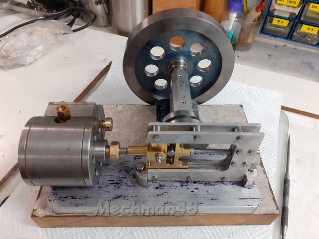

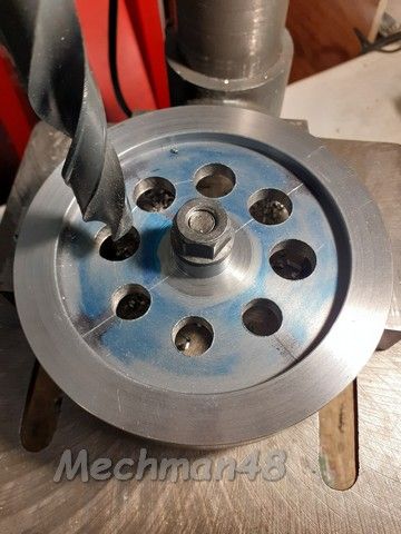

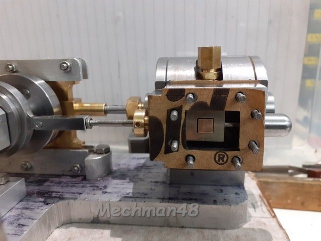

                Maged to catch up on my Scotch yoke engine latterly having been on the back burner since before Xmas…
                Flywheel ..
                Valve chest trial assembly..
                Trial assembly..
                Still lots to do, set timing, fix flywheel to crankshaft ( deviation from Dwg req'd ), trial run, strip, clean, check dim's, tweak as needed, paint, ( any advice on painting aluminium welcomed ) , I generally use etch primer to start with after de-greasing.

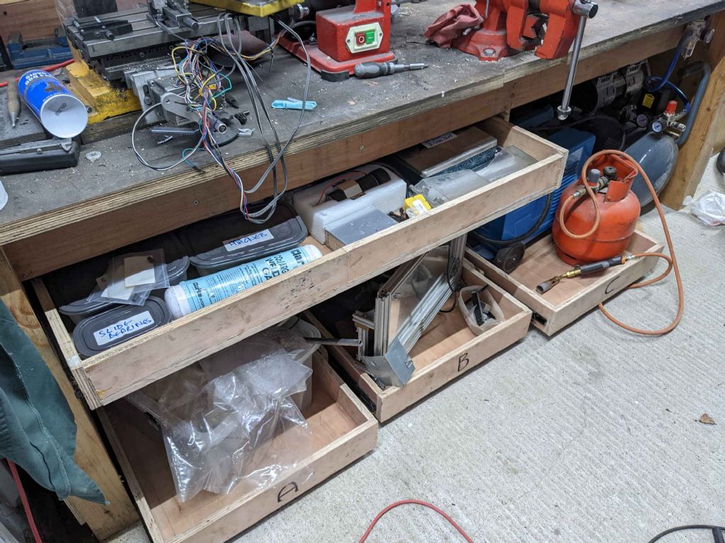

                  I'm almost embarrassed to Post this given the rather nice workshop image above, but one of my Xmas projects was to create some storage under my Bench.
                  10 years ago, I thought my shed was brim full and there was no way I could fit anything else in, but each time I buy something new, somehow (with quite some pain sometimes), I find room for it. This time the culprit was a scrollsaw.
                  Under my bench was a pile of stuff. Not very efficient and hard to get to. This was my response
                  Frankly, they are not as nice as they look.
                  I made (at least) two mistakes. Firstly, I should have let the timber merchant cut the pieces to size (and straight) rather than just to fit my car. I appear to be incapable of right angles with a circular saw. Secondly I should have built the drawers into a carcass rather trying to fit into the bench.
                  The drawers on the floor weren't too bad, but getting the drawer immediately under the bench aligned so it even vaguely worked was a bit of a nightmare. In the end it is hard to close and so has had stuff I rarely use relegated to it, rather that stuff I need all the time.
                  Still, its storage.

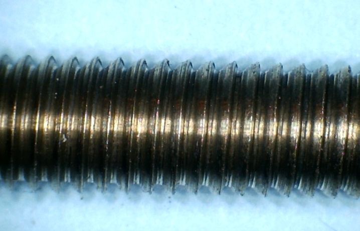

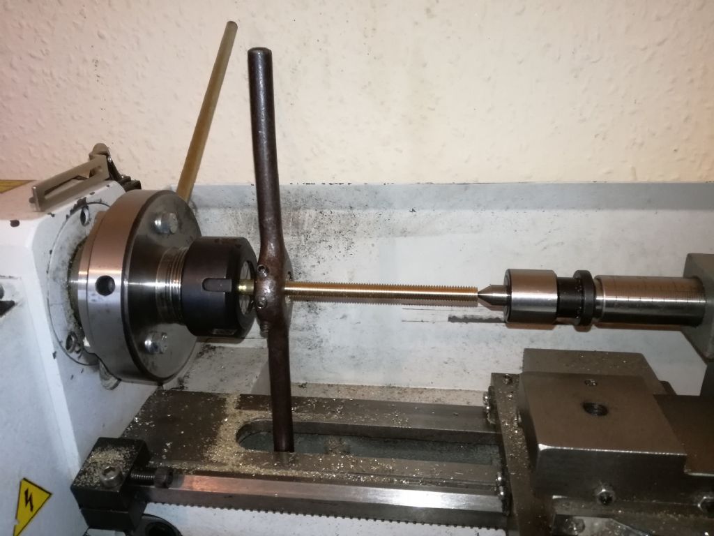

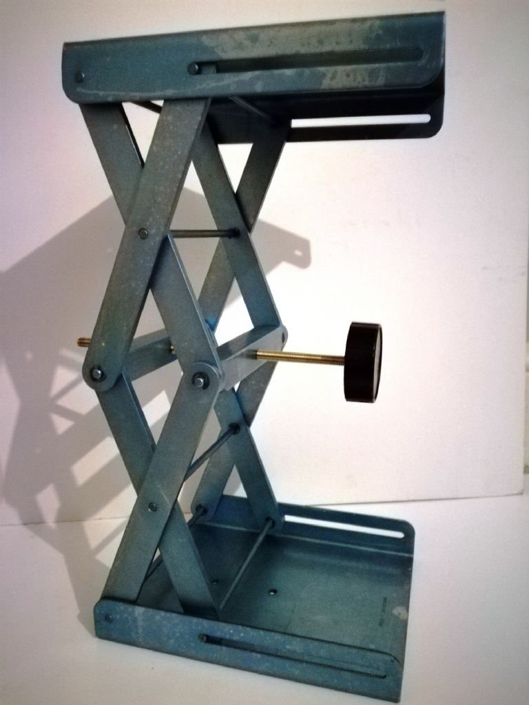

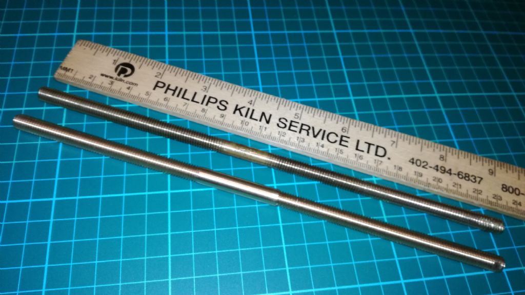

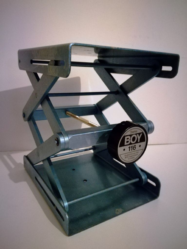

                        Hi, although my Swiss Boy 116 lab jack was working OK, it wouldn't lift anymore than about three quarters of its design height, this was because in its past life before I had it, it must have been used with too much weight on it because the left hand thread on the adjusting screw was distorted over the length that it would only lift too, as can be seen in the photo below.
                        So after buying a new left hand die and a couple of left hand taps, plus a new length of brass rod, I set about to make a new adjusting screw yesterday afternoon. I cut the left hand thread first, by holding the new rod in my collet chuck on my mini lathe, facing it off, putting a centre in the end and then threading the 20mm that was sticking out. I then moved the rod out of the chuck to get the length of thread required, while supporting the end with the centre.
                        The rod was reversed in the chuck and the same procedure was used the cut the right hand thread, you should notice that the two new threads are a little shorter than that of the old one, but as the extra would never get used at full height, I didn't see the need to put it on.
                        The left hand thread was also distorted in the ally bar, but using my new left hand taps, sorted that out OK. The new thread that I cut are about 0.3mm larger diameter than the original, which is about 0.35mm under size and both new threads fitted into their respective threaded hole nice and snugly without binding anywhere along the lengths of the new thread, so the lab jack was reassembled with the new adjusting screw and it lifts up nice and smooth.
                        It now goes to its full height.
                        Regards Nick.
                        Edited By Nicholas Farr on 18/01/2022 00:28:07

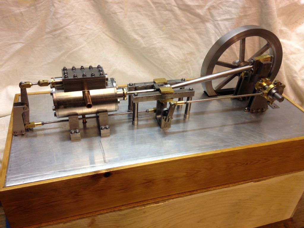

                          Finished my own design mill engine
                          #581003
                          geoff walker 1
                            @geoffwalker1
                            Different? I like it!
                            You could say the arrangement linking the eccentric to slide is unconventional , but nevertheless very interesting and well made.
                            Don't know your name but well done
                            Geoff

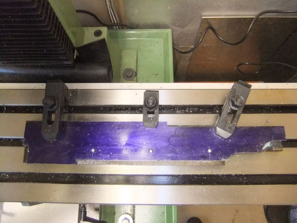

                                  Spent yet more time in the workshop on the chassis frames managed to get all the holes drill, there are 5 that I have only stared that will need drilling right through just one of the frames.
                                  Also the cylinder cut out done except for the corners which will need squaring up with a file once they are off the mill. I am trying to do as much as I can without disturbing the set up.

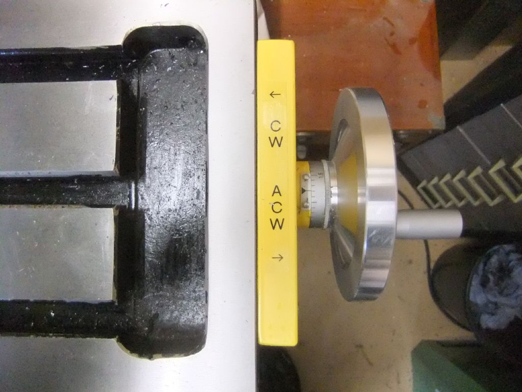

                                      Spent the day completing all the major work on the frames just nee to do some hand work to all the curved surfaces some of which can just be seen on the marking out blue, ( I do need to re-blue one and mark it as I wiped that off by mistake). I also still need to countersink some holes.
                                      When I did the first cut outs I kept forgetting which way to turn the wheels and nearly spoiled all the work that I had done. So a couple of stickers as a reminder printed off with a labeling machine I use in the garden.
                                      I am pretty pleased with the outcome so far considering this is my first time using a milling machine.
                                      Bolted back together ready for hand work.
                                      The quick and simple labels made things a lot easier

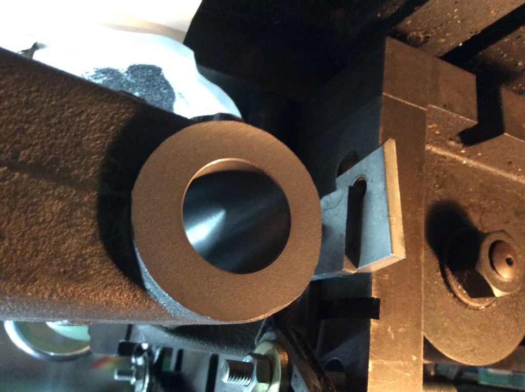

                                        Started the Wyvern cylinder liner. Drilled to 3/4” and now for boring.

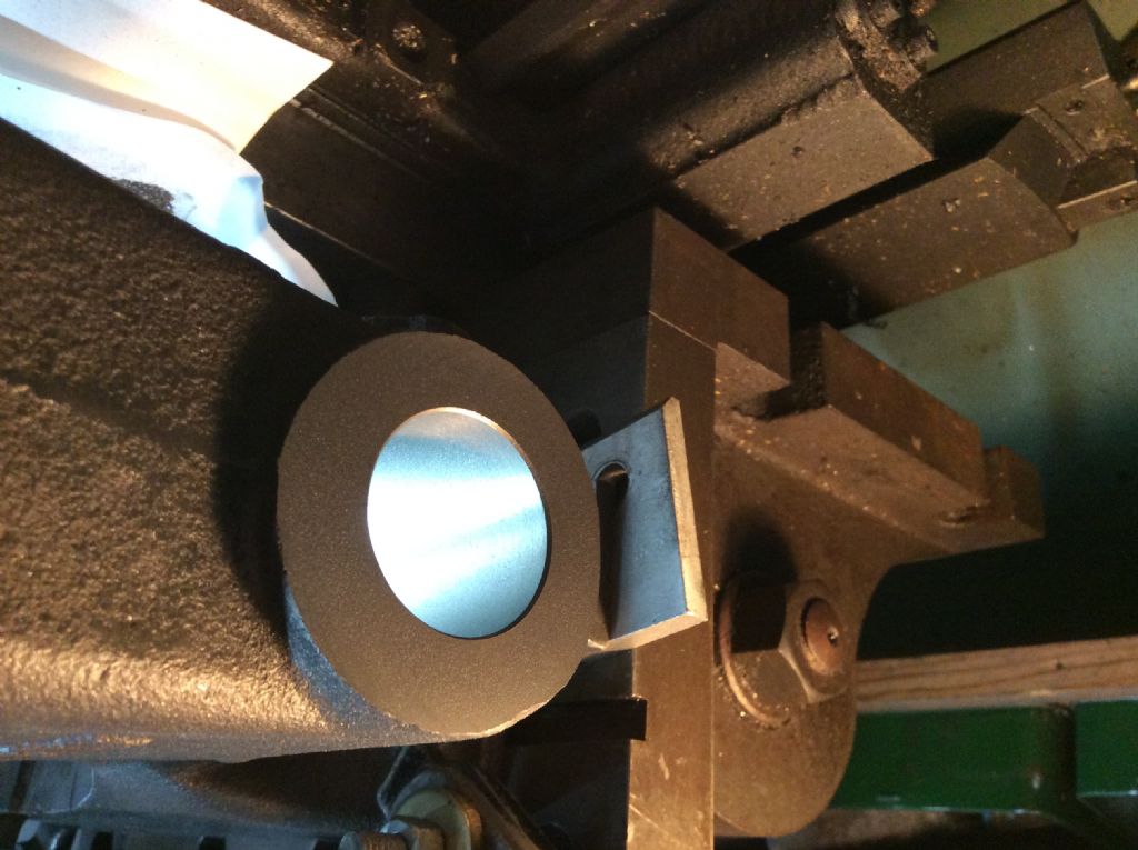

                                          66c021de-aab5-49c4-97eb-1676a722ecd1.jpegBored a redwing casting for someone who only has small machinery.aa7e0d36-4ed7-4286-b12a-2ba29c0832c2.jpeg

                                            My achievement today was the first welding I've done for a couple of years. It was TIG welding at arms length and some odd angles. Dipped the tungsten twice, but I think the bits are properly glued together again.
                                            #581261
                                              Looks a bit like the cylinder bore of a water cooled redwing to me and a nicely finished one at that.

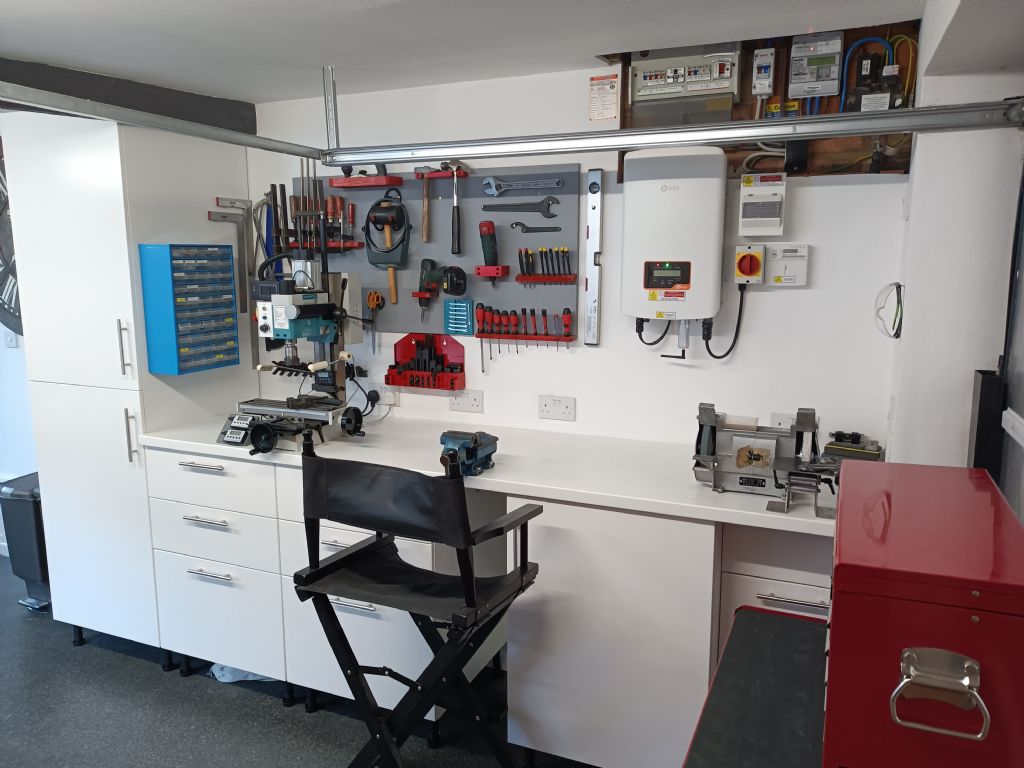

                                                      Hope I don't embarrass anyone smiley– one side of my new workshop is operational. For the other side (with the lathe) I have to wait for help of strong men (I cannot move the beast on my own…)
                                                      new workshop 5
                                                      new workshop 6
