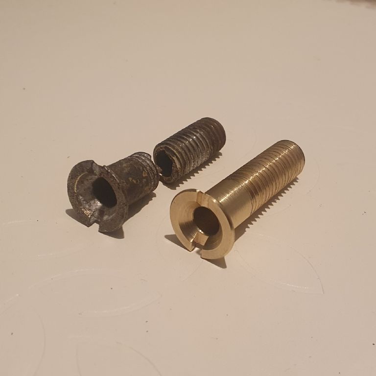

        Spent a couple of hours making a part you can buy for £1
        Am I seeing this wrong or did you just remake in brass a steel component that failed in tension?

          You could be forgiven for thinking it was a steel part, it was a brass item that had been plated. It fixes the plug strainer to the waste pipe on the sink. The plug slides in and out of the centre bore and it had seized in the old one and the screw snapped trying to remove it

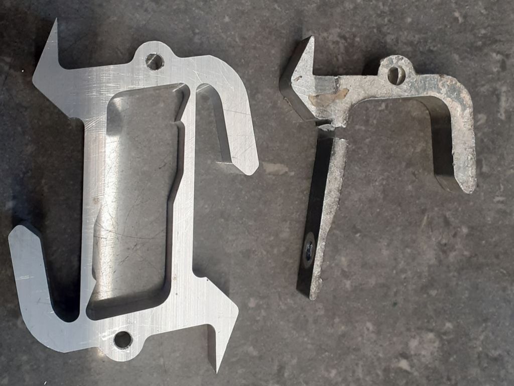

              I got a call from my brother to say one of the brackets on his extension ladder had broken and could I make him a new one.
              Rather than suggest he use JBWeld to fix it I said put it in the post and I'll see what I can do. When it arrived I took a photo and imported into Alibre and then just drew a few lines over the image, extruded those then added a few fillets to suit the cutter 4mm I intended to use
              Thought it best to make him a spare while I was at it so nested two together and then ran the CAM in F360 before cutting from 10mm 6082 on the KX-3 making use of the two holes to screw the plate to a piece of scrap. Just needs sawing apart and a bit of filing to square up a couple of internal corners.

                Ah. I saw tiny yellow glints in the top countersink and the thread flanks, but thought they might be a trick of the light, or streaks of some deposit…

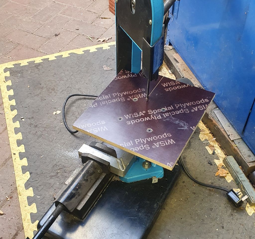

                    Finished off a table to use my rebadged Femi bandsaw in the vertical position. Thanks to member JohnF for pictures and drawings of his
                            Very good. With a 3d probe you could just capture the outline and export as a dxf!

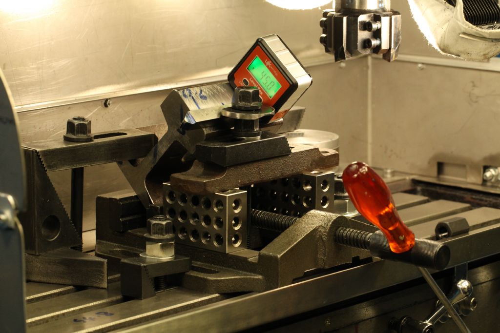

                              I started milling a piece of trainrail with the intention of making a V-Block higher up from mill bed to clamp smaller round parts to mill or drill at. After some battle I managed to mill al surfaces square to each other, battles with two sides with hardened spots in it. The rail is too small for an anvil. Used facemill with brazed carbide inserts so far, now to swich to 4x flute carbide 12mm endmill for this.
                              Today I managed to get it setup at 45 degrees. After some trail and error and eventually I came up with a concoction to hold it tight. Decided to use a dril lvice that came with mill, it wedge the bottom part of rail between jaws which was able to grip it. By turning the handle I can dial in the degrees up to 45, a bit of repetion as I tighten the chosen tight down spots.
                              -2x clamps holding vice.
                              -2x larger clamps pressing trainrain in jaws.
                              -123 blocks used to provide a fence for vice not moving.
                              -1x HSS tool bit to clamp top of trainrail down.
                              The whole setup seems sturdy…I am chewing on it today, will mill the corners if I decided to tomorrow with 12mm carbide endmill.
                              Edited By Chris Mate on 27/11/2022 09:17:29
                              #622811
                                Posted by Chris Mate on 27/11/2022 09:16:35:
                                I started milling a piece of trainrail …
                                Advanced work! Railway line is on my 'avoid' list because it's difficult to machine.
                                Rail is made of a manganese-steel alloy formulated to resist the very strenuous wear and tear applied by heavy trains running over it for about 20 years. It takes an extra serious hammering on bends, and is made to a tight specification because of the high cost of replacing it.
                                So, tough stuff, made by rolling red-hot metal, and cut with a grinder, not sawn. Apart from railways it's popular for making small anvils, the size needed by jewellers, because it takes a beating better than most other steels. Unfortunately it's toughness means it doesn't machine well; rail puts up a fight and cutting tools soon lose their edges.
                                There are no tough spots, it's all tough! I think what you're seeing is the cutter struggling.
                                Making V-blocks, it's considerably easier to work with a hardenable steel. It's machined in the soft state, then hardened, and further finished if necessary by grinding. Machining the steel before it's been hardened drastically increases cutter life, and the softer metal can be removed faster with less skill.
                                Worthwhile for the experience of machining a difficult metal, but it's an expensive way of making v-blocks.
                                Apparently in the fifties and sixties many model engineers had trouble with angle-iron from scrapped bed frames. The story goes that large quantities of scrap tram-line lifted before WW2 were re-rolled into angle-iron and used to make beds, an operation that didn't involve much machining. The trouble started when poor old Model Engineer tried to reuse it, little realising it was a manganese steel was from the same family as armour-plate!
                                      One of the projects I worked on in a former life was the supply of a large Butler planer converted into a CNC planer / shaper for a manufacturer of of points and crossings for railways.
                                      This machine was specifically modified for machining manganese steel castings and they were awful to machine, due to the propensity of the material to work harden while being machined. One of the design requirements of the new spindle assembly was it had to have 30KW at 100 rpm – slow rotation of a 16" inserted facemill to face the underside of the castings at low speed to try to avoid heat build-up that hardened the metal. If the inserts dulled, then hard spots developed that were then too hard for the remaining inserts to tolerate & the lot failed. The work hardened area had to be ground out below the surface to continue machining after re-tipping the cutter, or the fresh inserts would fail on contact with the hard spot. The milling head was deliberately set "out of tram" in the fore & aft direction to avoid back cutting – only the leading edge was in contact to avoid rubbing. One pass was prefrable, as the surface hardened during succesful cutting. Surface finish was not important, neither particularly were dimensions close tolerance – the manger said that "if the foundy could cast these to drawing, they wouldn't need machining on the base at all", it was just a case of making the base flat.
                                      But the same company also produced items from rolled rail section that were planed using normal brazed carbide tools & I don't recall there being anything special about machining them – just normal planer slow-ish table travel & nice chips peeled off. I have an offcut rail section in the garage awaiting turning into an anvil at some point & IIRC that was cut off with a bandsaw. This will most likely be a Boxford shaper project when I get a Round Tuit, but if milled I would be looking at sharp tools run slowly, well cooled & avoid rubbing should work OK – the same methods used by other customers on difficult to machine materials like Zeron stainless steel.

                                        I filed this rail before I started and it filed ok where I tested it. It milled ok enough, except a few areas(10% guessed) on one side where it was cut off.
                                        I watch some other video of a guy in funny way milling a rail, breaking his carbide cutters, now that one look hard. Maybe the latest rail tracks of say last 30 years with better equipment and knowledge is a different story, maybe this one was very old piece, I would say its not brutally hard. I can maybe examine the 4x brazed carbide bits and take macro photos of it, the chips did came off hot and some in hard areas red hot glowing. This is why I used this cutter and not my new Walter shoulder mill, inserts expensive. I took .2mm cuts.
                                        I am waiting for duplicate set of 4x flute carbide endmills, maybe Monday, then I want to use the previous 12mm endmill and see how it compares to this brazed carbide facemill ones, I used it a lot on aliminium and metal recently, I would like to know seeing the place contacted me with carbide specials on cutters, so its way cheaper. So far I was impressed with them, 4mm to 12mm set. If this endmill has no problem, I continiue, otherwise I call it some experience on clamping on this one. I did gained experience on clamping.
                                        Theres so much I must still buy, so I try to use what I got.

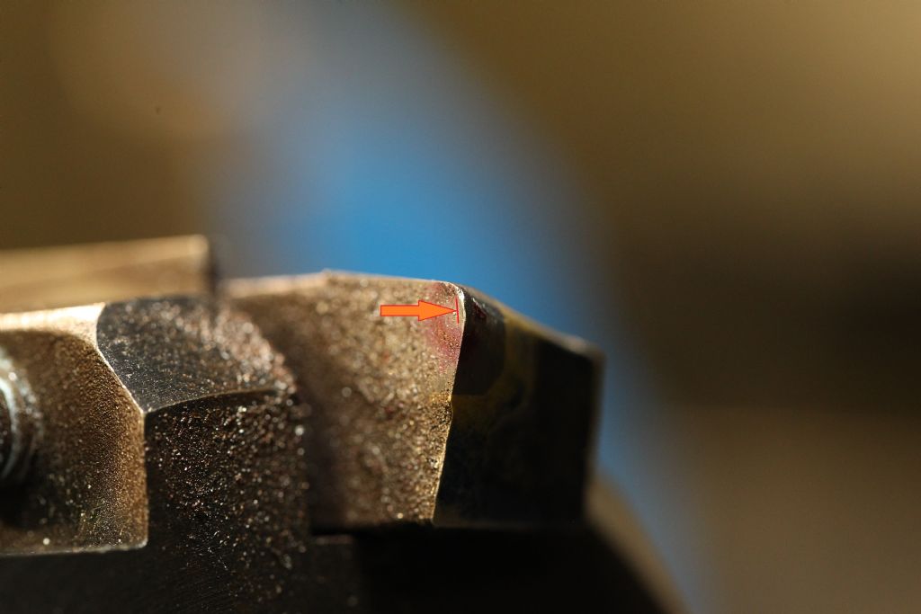

                                            The 80mm brazed carbide facemill cutter tips does show wear but not broken. I will need to redo them.

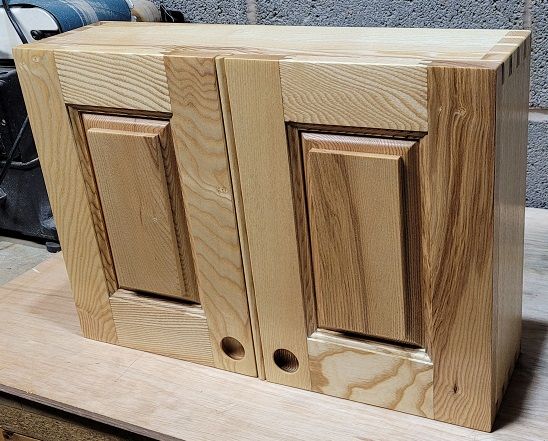

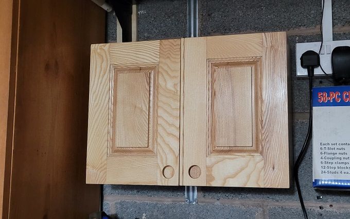

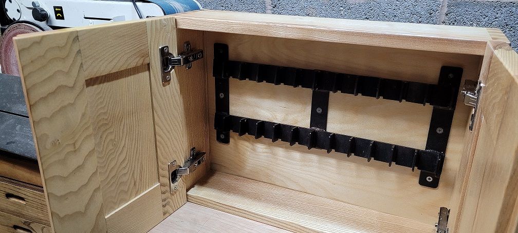

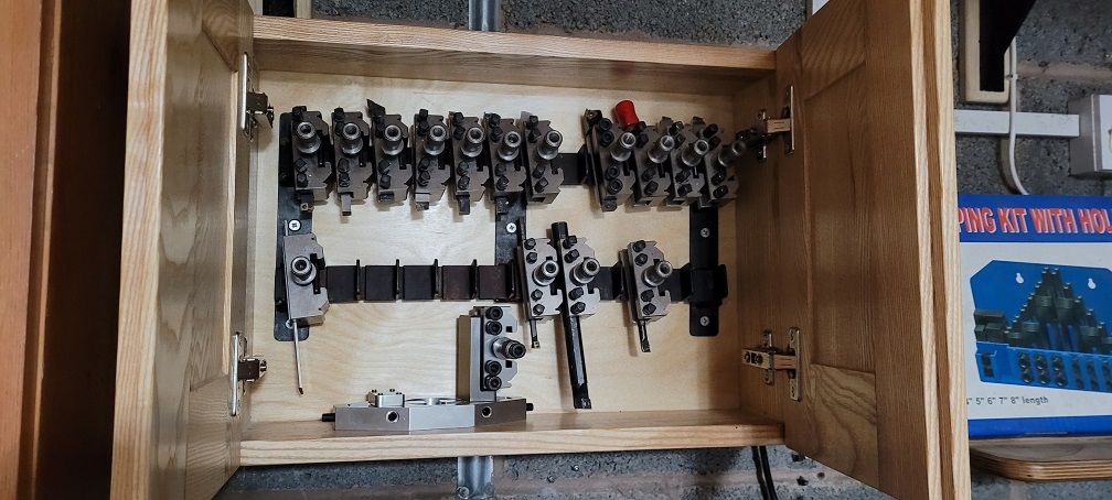

                                              2.jpg1.jpg3.jpgI finally finished a cabinet for lathe tools and got it up onto the wall.
                                              I thought I should take some pictures before it gets sprayed with oil:
                                              #622921
                                              Jim Nic
                                                @jimnic
                                                By eck, that's a grand looking tool cabinet. Is it all your own work?
                                                Jim
                                                #622946
                                                KWIL
                                                  @kwil
                                                  Not big enough, it only holds 20+ holders.
                                                  #622963
                                                  Craig Brown
                                                    @craigbrown60096
                                                    Posted by IRT on 27/11/2022 18:56:50:
                                                    Lovely piece of cabinet making!
                                                    #622985
                                                    Chris Mate
                                                      @chrismate31303
                                                      IRT a neat cabinet for lathe tools.
