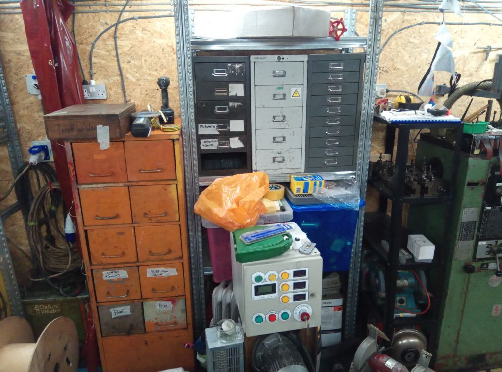

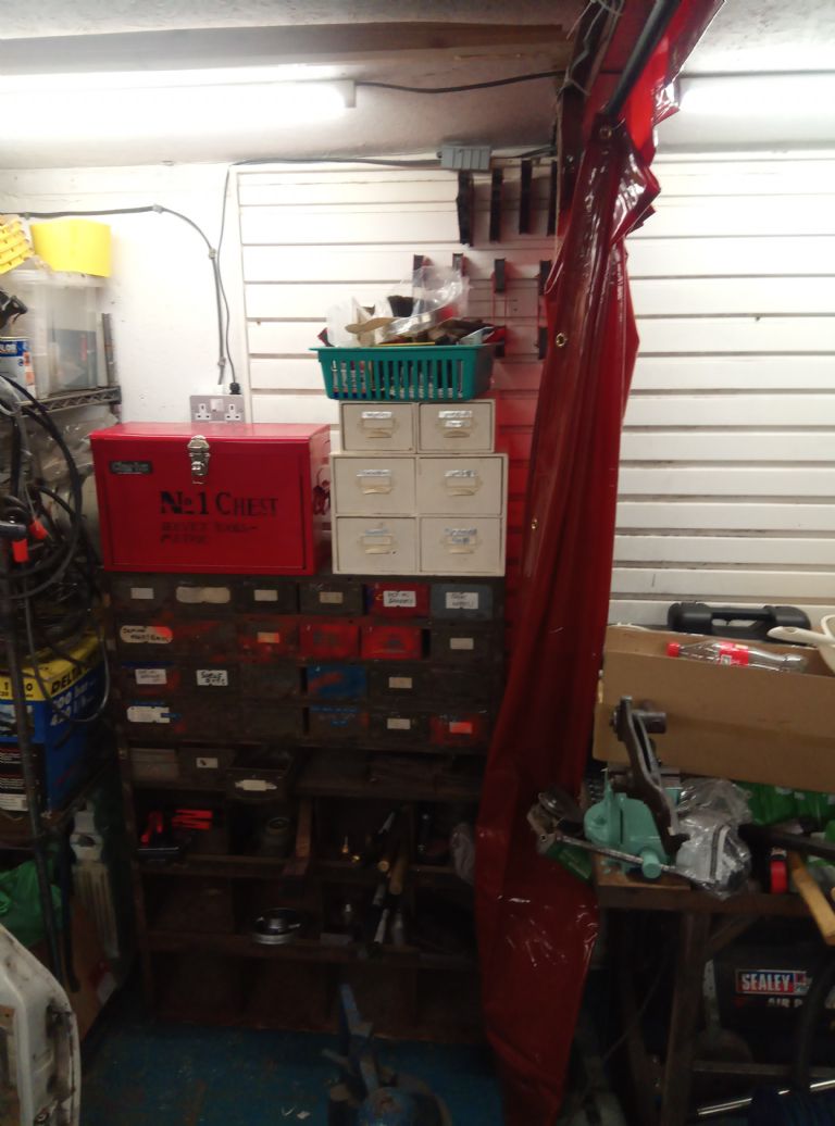

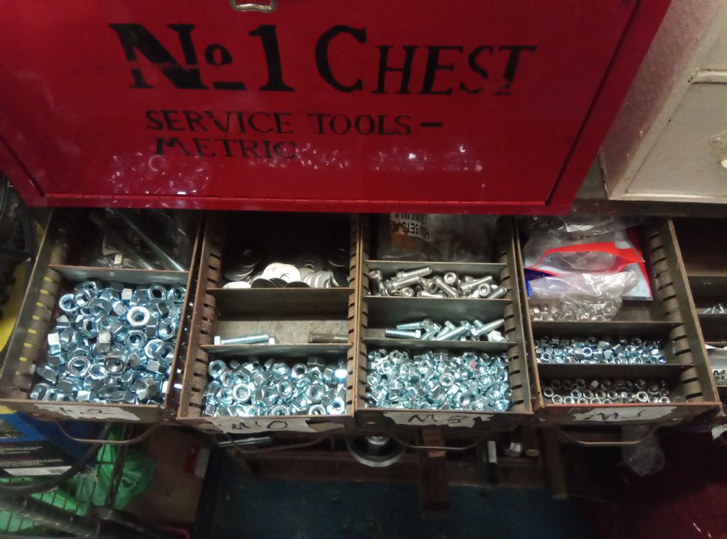

I bought a bunch of Bisley Cabinets from a company who turned out to have had a re-organisation of their factory and bought new storage solutions…
They're kinda tatty, but the ones I've already collected have allowed me to condense a lot of my storage whilst also increasing accessibility of stuff.
This re-organisation has of course, temporarily created a fantastic mess into the bargain, I'm due to pick up the last of the cabinets tomorrow and will hopefully get stuff squared away over the weekend.
Whilst I was at it I also took a bunch of broken motors to the scrappy, my local EMR yard was offering well above market price (£570 a tonne, over a market rate of £450) on motors, so the timing was right. weighing in 250kg of motors and transformers paid for all the cabinets, whilst clearing a bunch of useless, heavy and bulky stuff out; Win-Win!

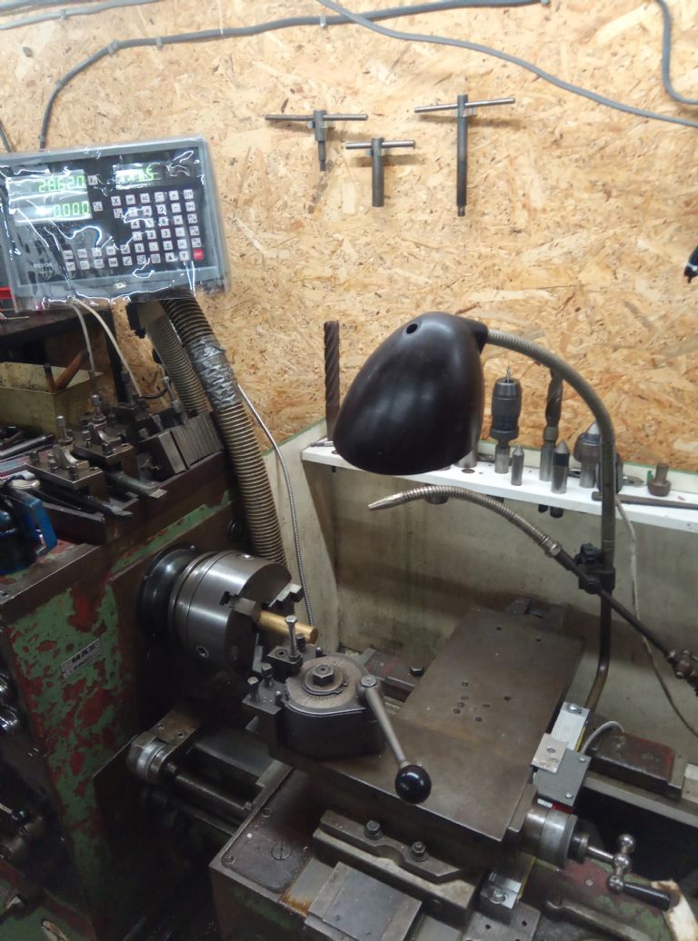

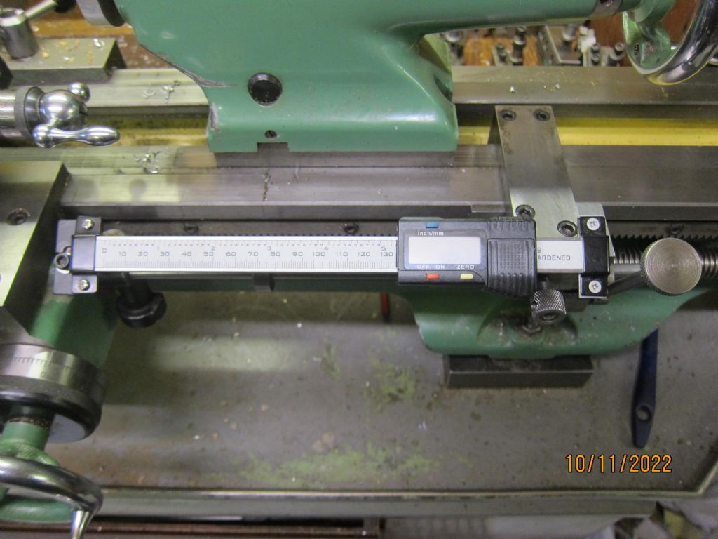

I finally procrastinated from finishing my re-organisation by fitting the X-Axis Scale for my Lathe DRO.
It's rather crude in the bracketry department again, but I was able to use the mounting holes for the X-axis adjustable stop assembly and avoid modifying the lathe at all.
I do have a better approach in mind to mount it more permanently using the casting on the saddle which carries the taper attachment and a welded bracket assembly to bolt on, and will probably do that using 1μm scale to replace that 5μm one in the fullness of time…
But for now, that's a significant improvement on no DRO, and whilst the X-Axis stop is very handy and it would be good to get it back, it's somewhat less useful once you have a DRO fitted.
