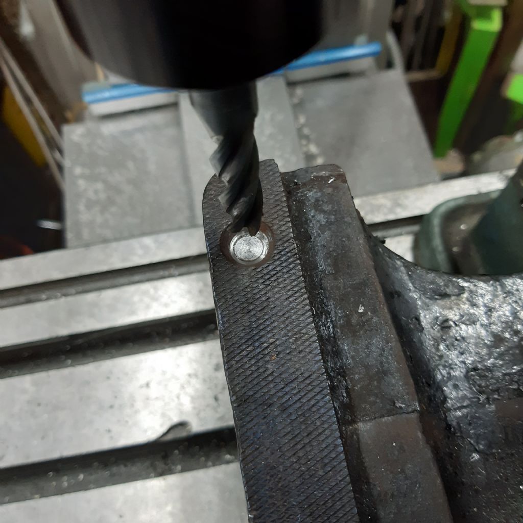

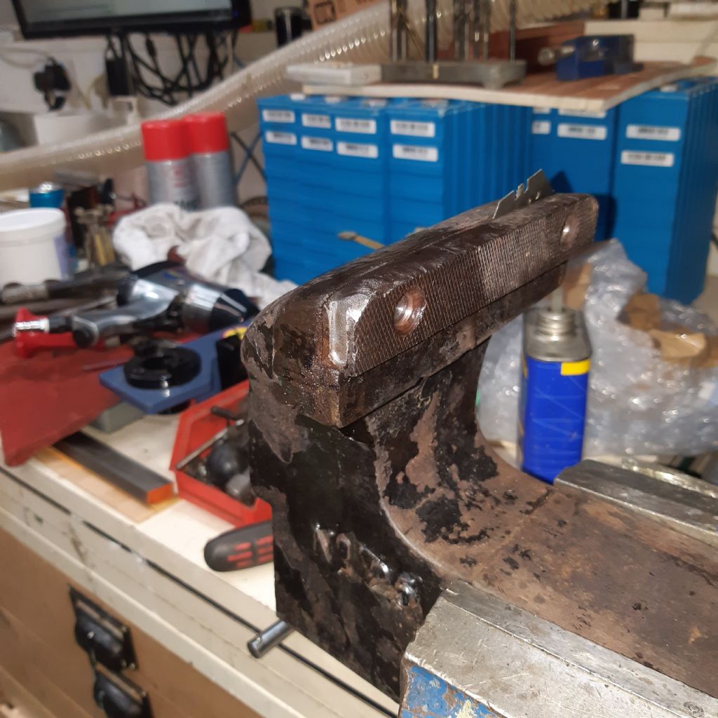

        Took delivery of a number of flat head impact bits and set the moving part of the vice up to have another go at undoing the screws. The hammer powered impact driver was having just as much success after cooking as before (none whatsoever). In a spirit of adventurousness I got the air powered impact wrench out and gave it a few blasts with that at increasing lefels of torque and differing directions. After three snapped 1/2" impact bits, I decided that the problem hadn't been Loctite…
        Milled the countersunk heads off the screws. Started with an HSS cutter, but that wasn't happy with the hardened jaw, so changed to a 10mm carbide one:-
        The jaw still wanted to stay where it was, so I milled a couple of 75 thou slots with a 6mm carbide cutter. Then used a 1" cold chisel and 3lb ball peen hammer to persuede it. Only took ten minutes of hammering and wedging:-
        Turns out that the jaw and screws were completely locked up with corrosion. Probably going to have to machine them out and helicoil the holes.

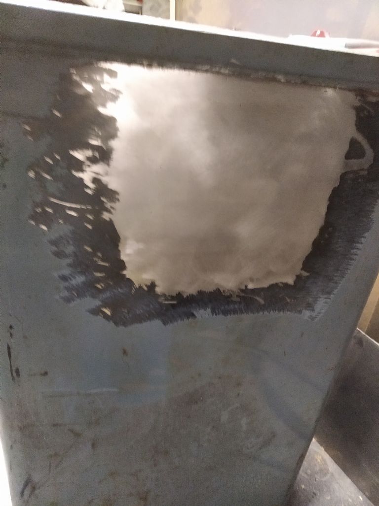

          After removing some electrical boxes from a small machine cabinet it left some cut outs in the sides, original thickness is 1/8", I had some 3mm plate so patched up one hole so far.

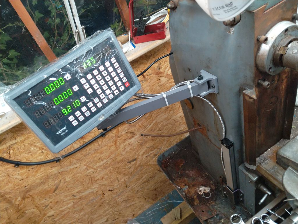

                                    Got the DRO install finished.
                                    23-09-2023 Finished
                                    (Forum software rotates from vertical format on upload???)
                                    Involved some more crude bracketry:

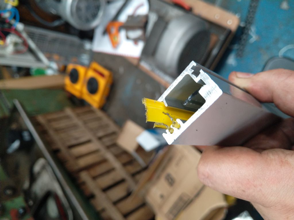

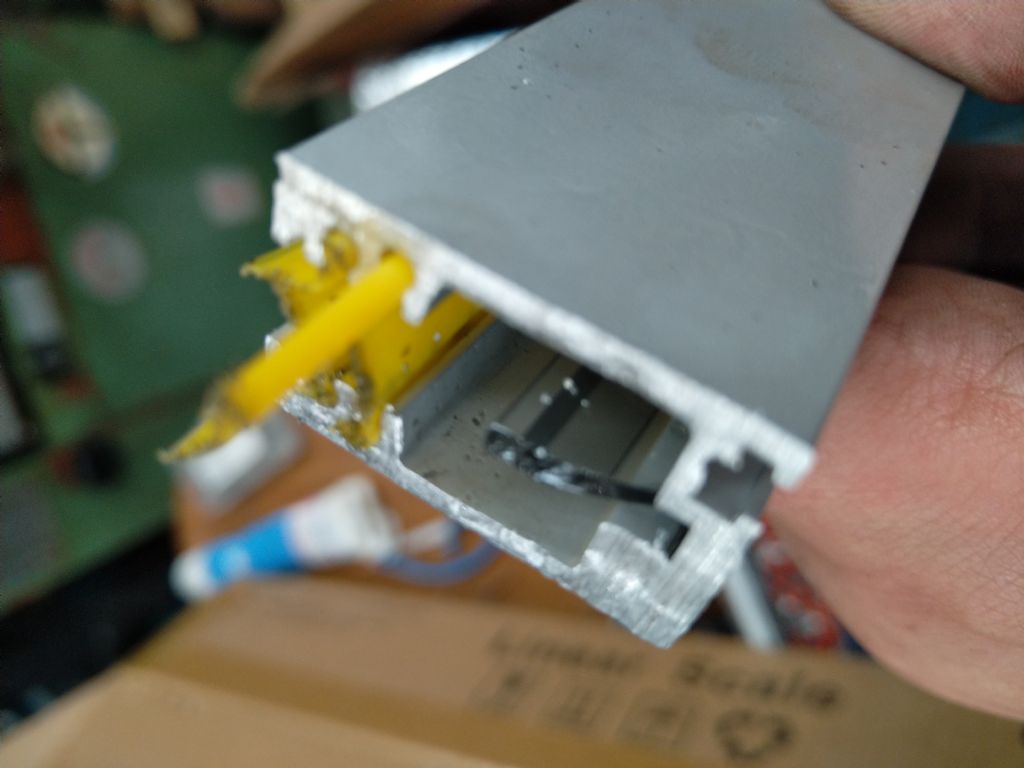

                                    And cutting a glass scale on the bandsaw, as per the suggested approach in this thread,, which worked remarkably well all things considered.
                                    The packing (I used cardboard rather than tissue but the process of getting it in real firmly round the glass is much the same) seems to constrain where the blade can put pressure on the glass, forcing it to fracture in there or thereabouts the correct place, definitely a brittle fracture though.
                                    23-09-2022 Scale Cutting 1
                                    23-09-2022 Scale Cutting 2
                                    Now just to move the mill into final position and run a new length of SWA between the rotary phase converter and the isolator to get it running in *its* new position (it's all change to ensure the layout remains ergonomic).
