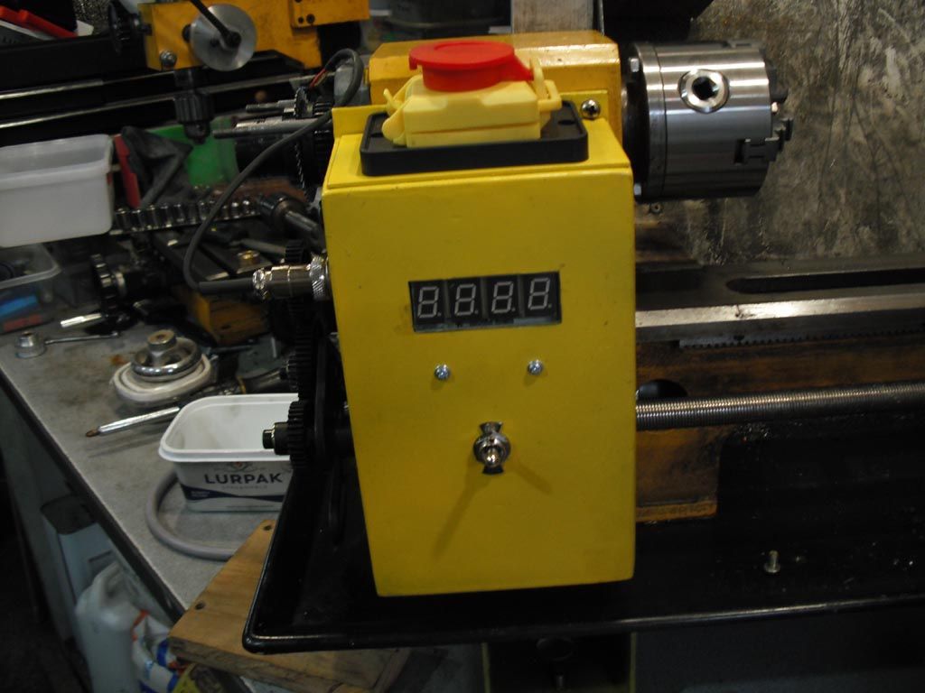

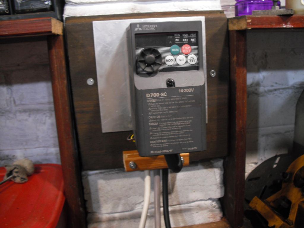

      Today I finally powered up the 3 phase conversion on my Clarke CL300 lathe. The lathe was originally supported on two lengths of 80mm square tube, which brought it up to comfortable working height for me and also enabled me to fit a coolant tank underneath the chip tray. As the new motor was considerably larger than the original one, it had to be mounted behind the lathe. A new longer length of 8omm square tube was fitted to carry the motor and the old motor housing was fitted with a new shaft to carry two pulleys and thus act as a countershaft.
      The inverter was mounted on the wall behind the lathe, with a combined NVR switch and emergency stop fitted in the modified control box fitted to the lathe. The switch is fitted in the mains supply going to the inverter. Normally the motor is controlled by the inverters pendant buttons.
      The box was also fitted with the RPM display and a switched supply for the coolant pump.
      The CL300 specifies spindle speeds of 100 to 2500 RPM. On test, my new arrangement gave me a maximum of 480rpm in low gear and 1060 high gear, with the inverter running at 58Hz. I had read the specification for the new motor, so this was not unexpected. I will try a larger pulley on the motor (40 teeth instead of the present 20). This should not be a problem for the half HP motor as the one it is replacing was only rated at 250 watts.

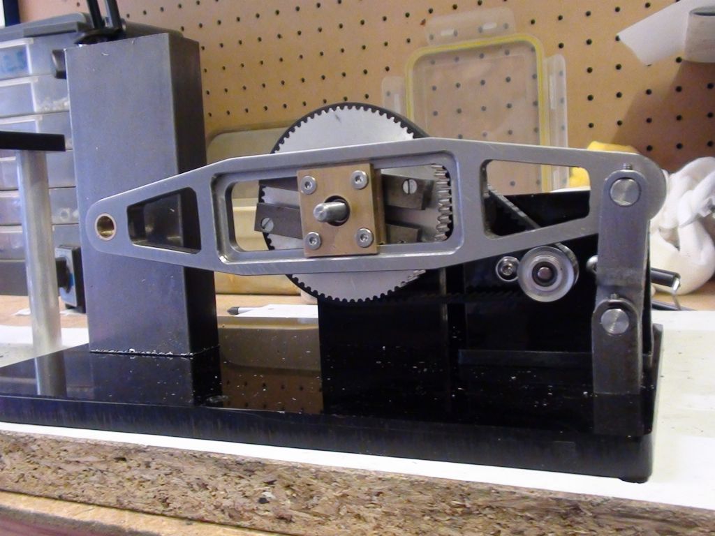

        Some actual visible progress today. I had a trial assembly of the motion section of the die filer that I;m constructing. The one I said that I wasn't going to make when I suggested a shaper-like drive, in response to a thread asking for ideas for the production of vertical motion for a die filer. Iain Down's thread
        The upshot looks remarkably similar to the CAD drawing I produced. Unfortunate choice of colour for the Perspex top and base plates (black) means it's difficult to make out some detail.
        trial assembly
        A few spacers to make now that I can physically measure the gaps and then to press on with the ram slide arrangement.
          Your inverter will operate at an output frequency of up to 400 Hz – why not just increase the maximum output frequency ?
          The Mitsubishi manual states that device is IP20 i.e. it should be mounted in an enclosure for protection.

            Hi mgnbuk. The motor and inverter came as a package, which according to the literature which came with it, just needed connecting up as it was all pre-programmed. I will have to check the manual (on a CD) which came with the product, regarding programming. Thanks for the advice.
            As for enclosure, I have been searching different component suppliers, trying to find one which is deep enough, but not too big width or height wise. Any suggestions would be appreciated.

              Anthony, I used an enclosure I found on ebay, cost about £25 if I remember, had to cut a few holes in it but I have the peace of mind that the inverter is safe from flying debris and moisture. I used a louvre plate top and bottom from Tool Station to aid ventilation as well as standing the whole thing away from the wall by about 25mm.

                Although I prefer to buy this sort of thing so I can get on with machining, in this case I'd probably make one. Commercial boxes are pricey and Sod's Law often makes it impossible to find one just the right size!
                Perhaps an expert will comment, but I don't think the outer enclosure has to be anything special. It's purpose is to keep people safely away from the electric terminals and to protect the electronics from accidental bumps and dirt, especially swarf and splashes. A simple wooden or sheet metal box would do unless it must be in a vulnerable location. Assuming the box is reasonably out-of-the-way the main problem is keeping the inside cool, which is usually done by providing a moderately roomy enclosure with vents or grills and perhaps a computer-type fan.
                Aluminium sheet is easily bent to shape with angle bars, or flat plates can be riveted, screwed, or bolted onto aluminium angle. I think Aluminium sheet is by far the best material for this job. Steel sheet is cheaper but has to be rust protected and is a few notches harder to work with. Wood and home-made plastic aren't ideal for various reasons, for example, there's a need to allow more ventilation because they're good heat insulators.
                If a metal box is used make sure the sides and lid are electrically bonded so that the whole thing can be earthed. Also fit cable holes with grommets and provide some form of strain relief inside. Nylon Zip Ties are often 'good enough'.

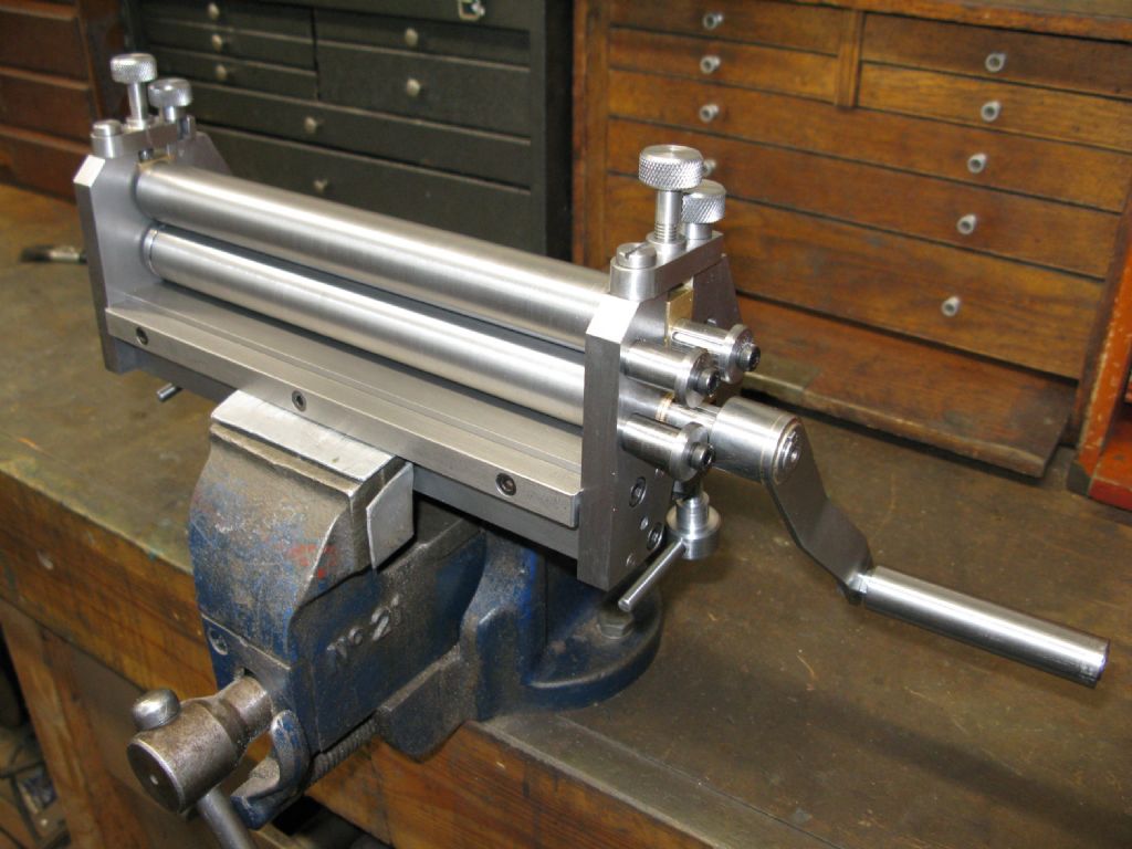

                          More like what I've been doing for the last eight days, almost finished Hemingway bending rolls, almost finished as the gears were missing from the kit and are on five week back order, a shame as I bought the kit to save time as I wanted to use them now! Never mind it all went together well and even ungeared it works well.img_0194.jpg

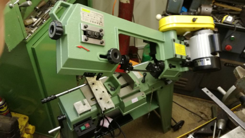

                            Hi, after taking delivery of a Warco 4-1/2" universal bandsaw at their current 30% discount price early yesterday afternoon and getting it into my garage, unpacking and checking all the parts were there and undamaged, reading through the user manual, I set about building the stand and fixing it to the saw. Today I completed the task of setting it up and giving it a try. Firstly, I had it in the vertical position with the table fixed in position, marked two lines from the end of a scrap piece of aluminium channel to a hole and cut a slot the width of the hole, which worked a treat.
                            I then put it in the horizontal mode and cut a short length off the same end, which also work a treat.
                            OK it's not in the same league as industrial bandsaws that I've used in my working years, but I believe it will serve well for my work in my garage.

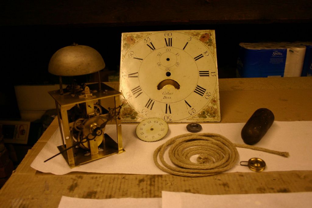

                              Finally got round to starting on an old clock movement I got from Ebay for a few pounds. It arrived in a box in pieces. I think the rope had broken and the owner had started the job then stopped when the clock fell apart, as birdcage movements are prone to do.
                              All cleaned and re-assembled. New rope acquired. Just need to remind myself how to splice it now.
                              Always better when the hands are busy.

                                    I've have a saw like yours Nick, mine says it's an Alpine and was supplied by Graham Engineeering long since disappeared, had it for about 25/30 years, really useful tool. There was an article either on ME or MEW on making a larger table, which when you a have suitable blade you can with the aid of an assistant rip down wood. I made an attachment using a piece of 12mm X 90 X 170 (approximately) steel with a series of drilled and tapped hole, the holes have the same thread as my mill clamping kit. I can clamp small pieces of steel and cut very thin pieces. Another useful attachment is a similar piece of steel with two angle cut pieces again with hole as before, welded to the plate, so that I can cut short round bits. I found when cutting round bar it tries to revolve, but not with the jig. I also made a blade repair jig so that when a blade breaks I can silver solder it together again. Non of the above are my original ideas, picked upon the way. .John
