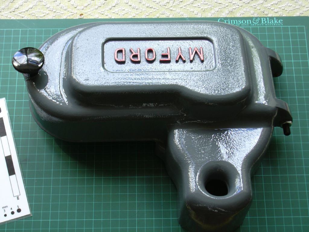

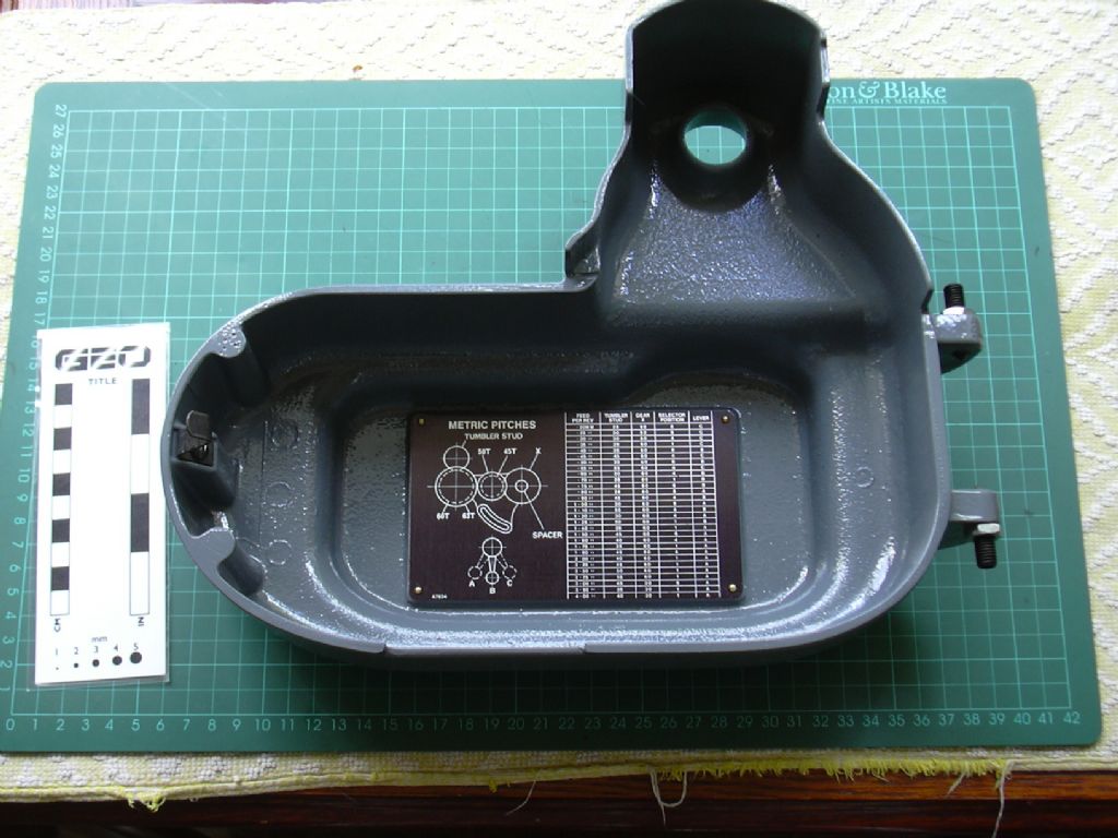

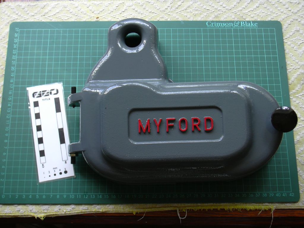

        I don't think I've ever posted on this thread before. My activities today are small but the culmination of a project I've been anxious to complete successfully.

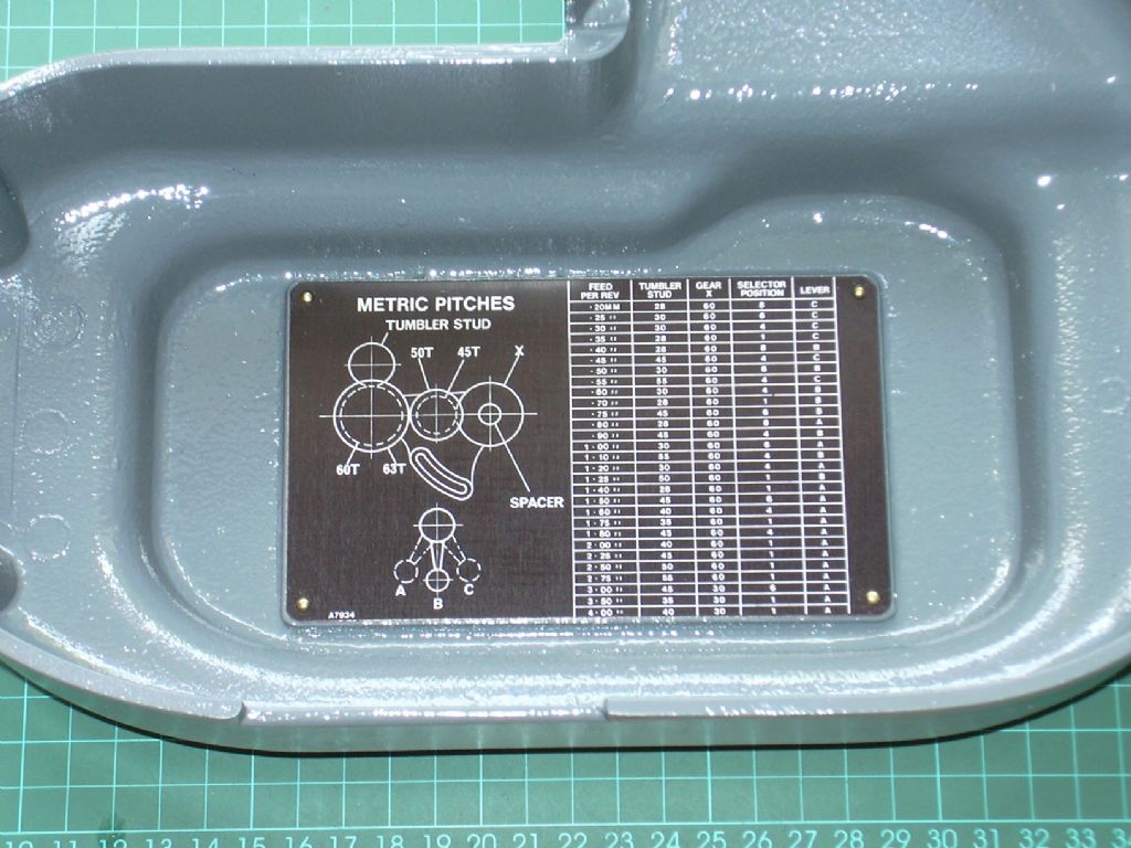

        First of all, a bit of background: some time ago I fitted a quick-change gear-box to my Myford ML7 lathe. I bought this particular gear-box second-hand – it had previously been fitted to a Super Seven. I was advised that the change gear backplate that came with the gear-box would fit the ML7 but that I would need a new change gear cover. (Is it OK to refer to them as 'change gears' when all they do is connect the tumbler gear to the input shaft of the gear-box? ) I was further advised that Mytholmroyd Myford were offering the correct cover but only as a raw casting, no holes drilled or tapped and no paint-job. Before yesterday, I had fettled the casting, drilled and tapped most of the holes and a kind neighbour had spray-painted the casting for me. All that remained was the fitting of the label within the cover.
        Here's the first picture:
        This morning, I fitted the label using the four 'brassed' drive screws. I had drilled the holes in the casting yesterday after taking some time deciding what depth they should be.
        The photo shows that the label is fitted on the top of an 'island' in the casting of the gear cover. It's obviously desirable to avoid drilling the holes too deep and breaking out on the exterior surface of the cover. I had thought of posting this as a new thread entitled 'Using the drill-press as a depth gauge'; that's just what I had to do to discover how much meat there was in the casting.
        Because of the depth of the cover casting, the thickness of the 'island' can't be measured with a micrometer or a vernier caliper. I have seen calipers with curved legs and that have a built-in dial gauge but I don't have one of those. The method I employed was as follows:
        I mounted the drill in the chuck of the drill press and lowered it until it contacted the machine table gently but firmly. I then locked the drill quill and wound down the twin nuts of the depth gauge until they contacted the head-stock lug. I then released the quill and wangled the gear cover under the drill and lowered the quill again until the drill contacted the surface of the casting within the label mounting area. The space between the twin nuts and the headstock lug was now equal to the thickness of the casting. My vernier caliper wouldn't fit there because the tail of the caliper fouled various features of the drill-press headstock so I used a stack of feeler gauge blades to fill the gap and measured their total thickness using the caliper. By comparison of the length of the drive screws with the thickness of the label and the measurement previously described I decided I needed to limit the depth of my drilling to 200 thou. I reset the drill-press twin nuts accordingly, held my breath and drilled the four holes. I had actually performed the measurement process several times, using various probes in the drill press and had also considered several other procedures.
        Lateral position of the holes was dictated by the four dimples that Beeston Myford considerately provided in the surface of the label 'island'. I checked the position of the drilled holes by laying the label in position and inserting four half-toothpicks through the label into the holes in the casting. That gave me the confidence to fit the four drive screws after which I emitted a big sigh of relief! The depth of the cover casting prevents the use of just a hammer – I used a punch. That necessitated assistance from SWMBO to hold the casting steady.
        Regarding the painting part of the project: I bought half a litre of Myford Grey enamel, some thinners and some etch primer from Paragon Paints. I was amazed that my neighbour's spray painting used only a couple of eggcup-fulls of the enamel!
        I admit that I was scared that I might drill too deep and break out on the exterior surface of the cover casting so I did try securing the label with double-sided adhesive tape. This didn't work because the tape and the painted surface of the 'island' weren't compatible. I think it would have worked if we'd masked -off the 'island'.
        All you gurus are probably thinking 'this is trivial stuff, why is he making so much of it?'. Well, I'm jolly pleased with the result so here are some more photos:
        Best regards,
        Swarf, Mostly!

        #608502
        Nicholas Farr
          @nicholasfarr14254
          Hi Swarf Mostly, looks good to me.
          Regards Nick.

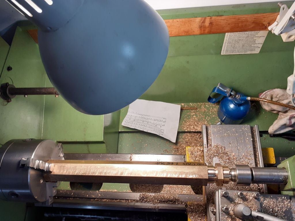

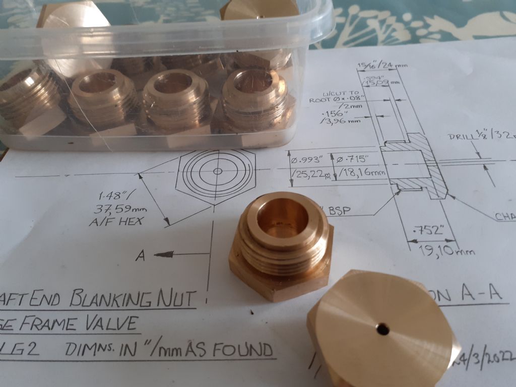

            More parts for the railway – spindle end caps for the S160 gauge frame valves:-
            These were a bit of a bu993r – I'd slabbed down a long stick of LG2 hex from round bar on the Bridgy clone, only to find at 15/16" OAL per part, I'd only just got enough provided I didn't scrap any. I didn't wanna saw it into blanks because each would be a bit short to give a good grip in a 3-jaw, there were 4mm interrupted cuts to do, and I'd be starting each screw cutting pass dead close to the chuck; so I took the line suggested in t'other thread about "keeping it on the stock" and loaded the whole stick, which still had an end-centre from the milling op. That let me use the live centre to do the end turning on one end, including the 1.309" thread O/D (1" BSP). Then I could support that in a 3-point steady, and drill and flat-bottom the .715" bore (actually 23/32", but the hole was clagged-up in the sample which was why I'd drawn it as .715" ).
            Then back to tailstock support into the 'ole so I could screwcut the thread – about 20 passes in reverse away from the hex bit.
            …plus turn the O/D for the next thread so I could swap back again to 3-point steady to part off.
            Repeat 11 times.
            I found I could only do about 3 a day without getting excessively fed up.
            But they're done now, I checked each thread into a sample valve body and I think they're OK…

              Fine work, but re your comment about all those interrupted cut. If I may make a suggestion, where possible I turn the initial parts of the cylindrical features, and initial parting grooves, first to a touch below the A/F size, then machine the flats before resuming the round bits. This avoids the interrupted cutting.

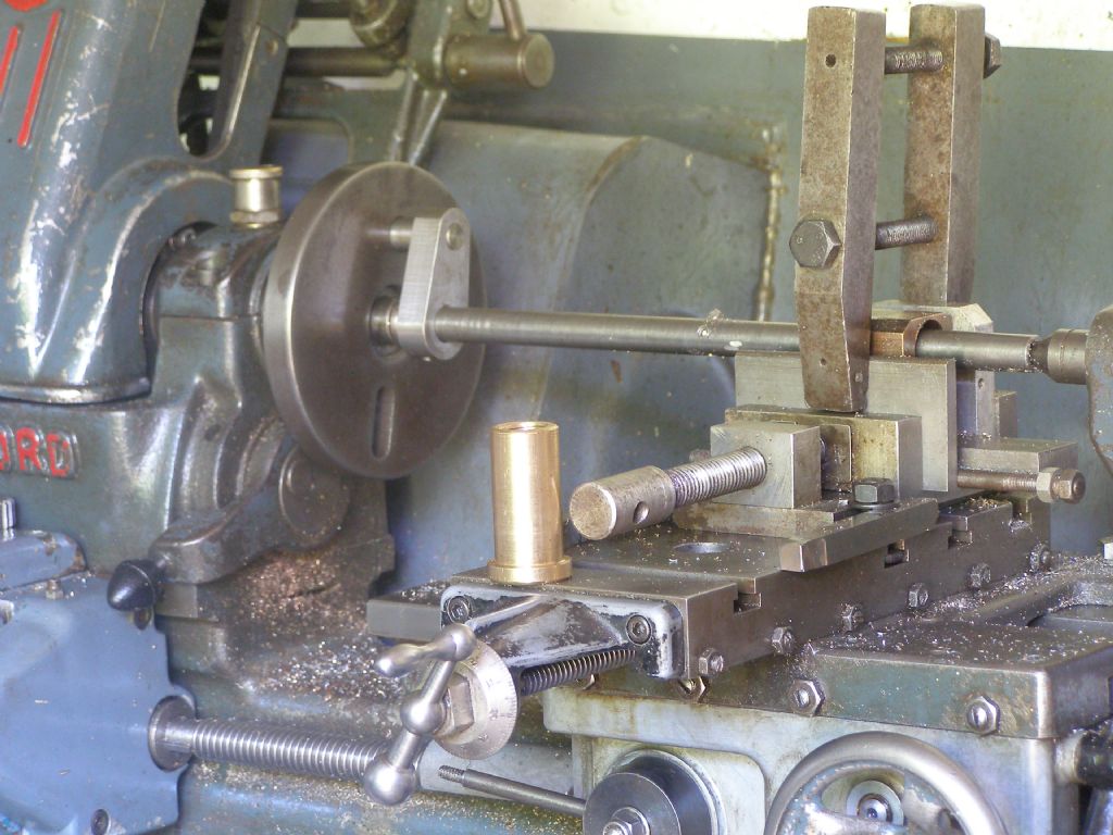

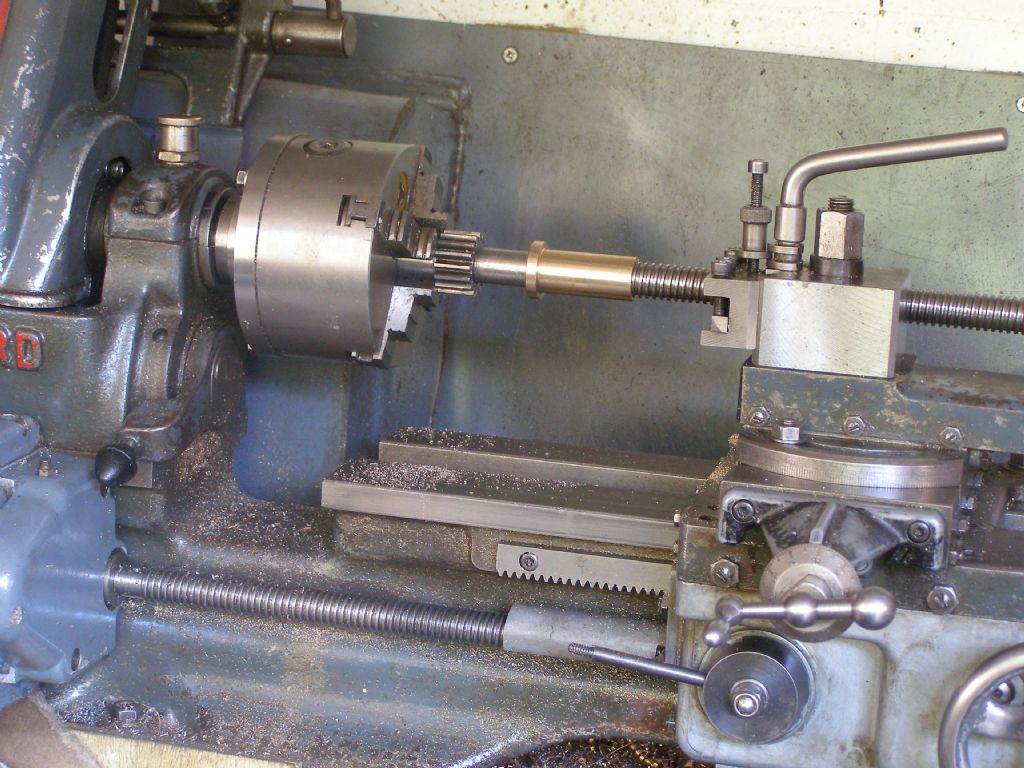

                Completed repairing the Harrison L5 cross-feed nut:
                Boring out the old one.
                Centred by threading the nut onto the full-thread portion of the tap and clamping that by its own centre-holes between centres. Then gently aligning the vice and clamps to match.
                I made the vice very many years ago to fit the vertical slide of my EW lathe, and by sheer chance it matches the Myford's T-slots!
                The boring bar is one of a Hemingway Kit set I made a few years ago, and this was its first use! I had to drill the extra hole in the Myford catch-plate to take its carrier, wider diameter than the slot width.
                Truing the new threaded sleeve (leaded gun-metal) to the leadscrew. Lacking an outer-end centre I needed centre it in the independent 4-jaw chuck. The left-hand thread enforced a left-hand tool set upside down, and running the lathe in reverse…. very carefully, modest speed, fine feed, 0.005" cut.
                Finally, I sweated the sleeve into the nut block, and re-assembled the lathe.
                Oddly, the tightest part of the thread, which I am sure is ACME after all, is not at its far end as expected but a little way back.

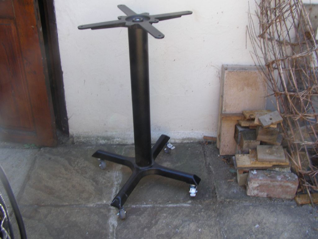

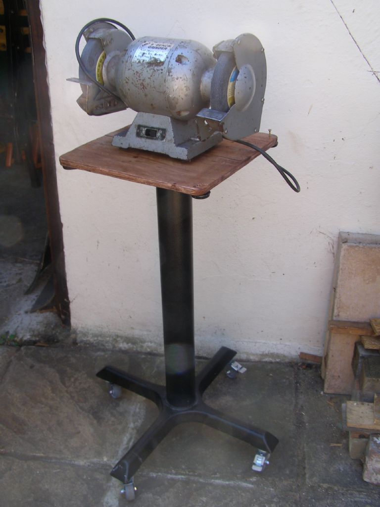

                A chance skip find: a hefty leg apparently from a broken-up table, consisting of two 4-limbed cast-iron "spiders" joined by a tubular steel column about 70mm diameter.
                The use was obvious immediately: a mobile stand for the bench-grinder in my increasingly cramped workshop.
                Add a piece of ex-pallet 12mm plywood, 4 castors, a few fasteners and some exterior-grade dark wood varnish found in the kitchen cupboard, and there we are. Just sufficient room to add a drill-grinding jig, too!
                By serendipity, the PCD of the inner holes in the arms even matches the centre-distance of the 2 in the grinder's base, nearly enough for M8 bolts helped by slightly enlarging the cast-in arm holes a little.

                  Please may we have a photo of your skip find? Either 'as found' or 'as developed' or both?

                    Certainly!
                    Sorry about the rather ropey picture quality _ hand-held and in the shade. Also I found the only immediately available photo-faffer on my PC is very limited, allowing me to stand the image up but not to crop the side stuff.
                    The stand as found but with the castors (it had simple screwed-on feet originally); and assembled loose – before I added a second varnish coat to the plywood.
                    You know the old thing about measure twice and cut once.
                    I measured the arm-span, measured the stock, re-measured; placed the arm casting on the wood, marked the outline and spotted the screw holes, cut the wood…. then realised this gave me the diagonal not span, square! Luckily it is still large enough for the machine.
                    The willow frame to the right, given me by my neighbour, was intended for pea-plants, but they did not even germinate in a tray indoors!

                      Thank you for posting the pictures. That looks good, though you might need to keep your foot on one arm of the base to prevent a tip-over!

                        I did consider stability, and two of the castors have brakes which will help that, as would pushing the stand against a bench or something. I think it will be more of a problem when moving it about than using it.
                        I don't know the make of my drill-grinding jig. It's not marked on it. I have read that mention on here, and gleaned enough information to gain the basic idea of how to set them.
                        I have never tried using it because the grinder was just standing loose on the back of a bench, among a lot of clutter, but I put a drill in it yesterday and held the jig by the wheel to see how it moves. So I can probably work it out by using a good drill without it touching the stationary wheel.

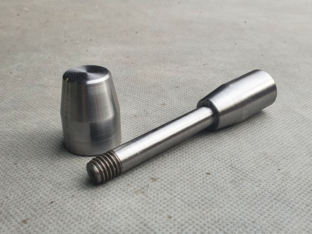

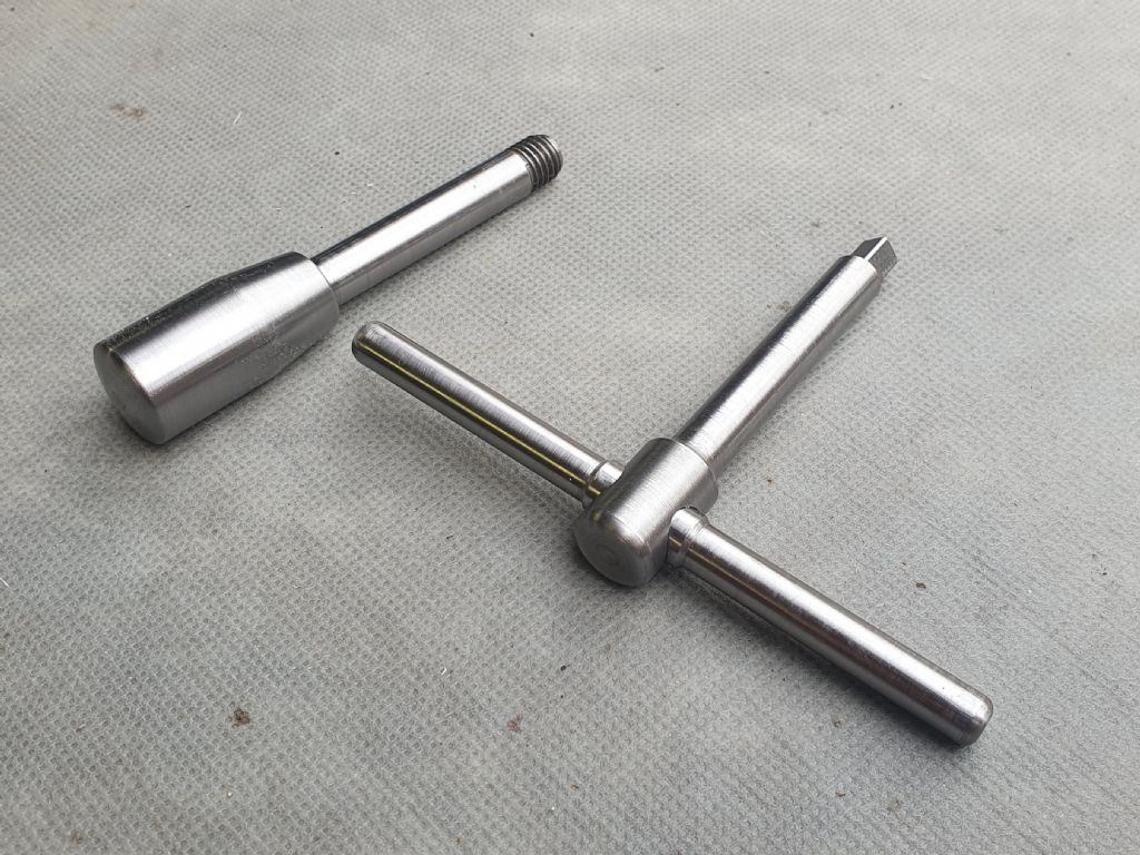

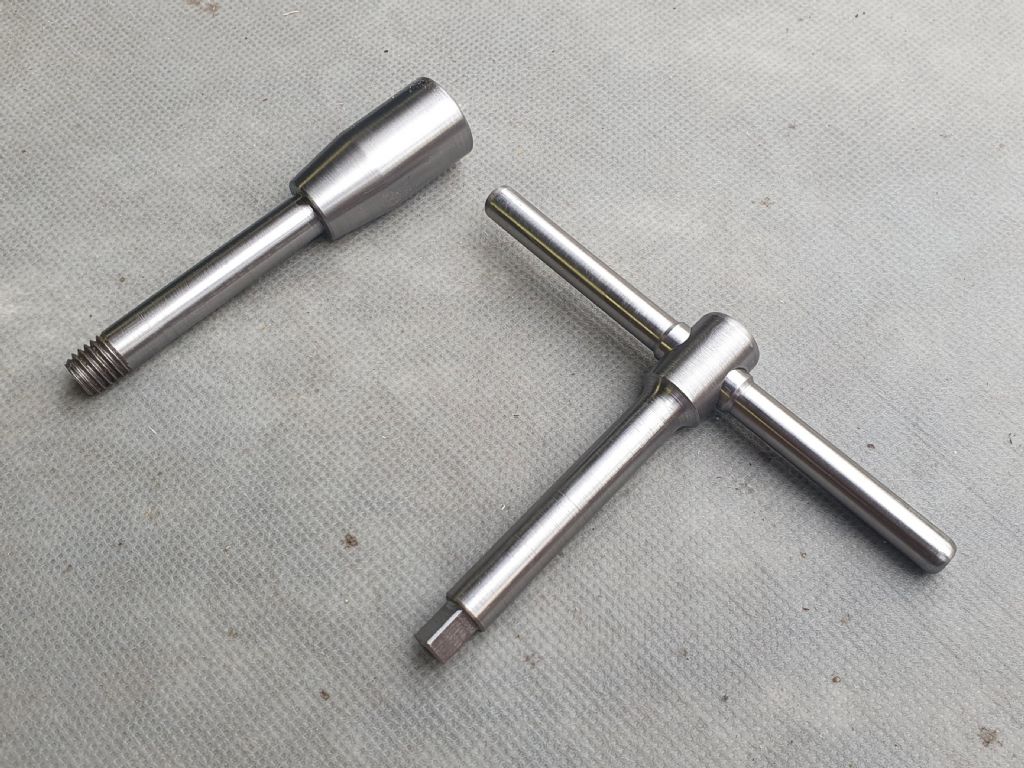

                                                Having recently acquiring a new to me lathe it was missing a chuck key for the 3 jaw and a 10mm square drive spanner for the tool post. So today I made a chuck key and made a start on the handle
                                                #611551
                                                Craig Brown
                                                  @craigbrown60096

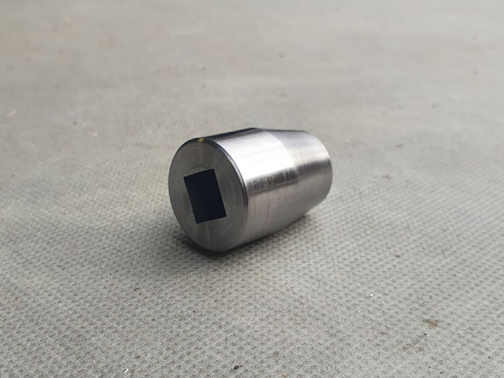

                                                  Turned a piece of 25mm down to 24mm, added a 10° taper and sunk a 10mm square drill into the end for the spanner. Just got to poke an M10 thread in the side to attach the 2 pieces and it's ready for service
