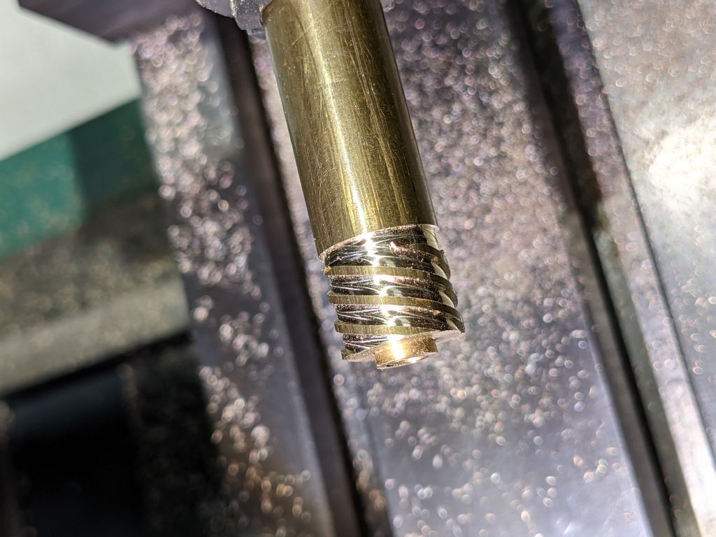

          First attempt at helical milling, very slow but successful.

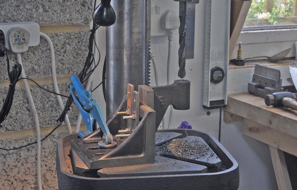

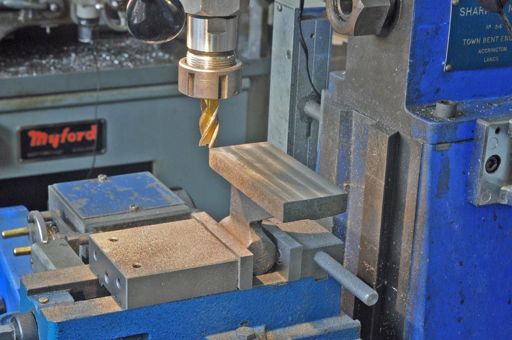

              I've spent the last couple of afternoons making this Instrument Vice. The base casting is a CES product that has been hanging around (like the Level I recently made) for decades
              There were a couple of hairy set ups but no excitement ensued

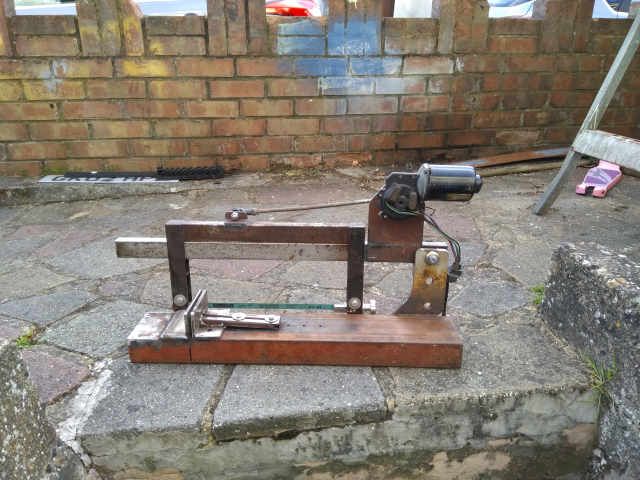

                                        Late last year, as part of a clean up I found this tucked behind a cupboard:
                                        That's the frame and swinging arm for a powered hacksaw as featured in MEW 111, which I made about 12 years ago. The photo is after I cleaned and checked it the frame still slid along the arm.
                                        After scrounging a wiper motor and linkage(from an MGF I helped a friend break), then making the missing parts from scrap I had lying about, I ended up with this:
                                        I still need to wire it properly with a switch and fuse, but when connected to a battery charger it gently saws through steel bar which was what I wanted it for. I'll be clamping it to the workmate to use it, and will paint it when I've finished the wheeling machine I started at about the same time.

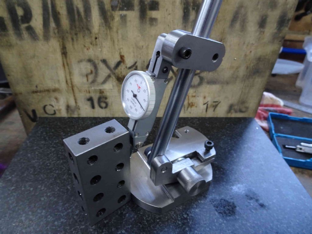

                                            Not today and not even this month, but I finally got round to finishing my surface gauge made mainly with a mystery metal.
                                            I still have a bit of tuning to do -the first photo shows the cap screws (in the second photo) replaced with knurled finger screws, but the dovetail clamp is still a little tight so I plan to enlarge the hole a little.
                                            The indicator in the lower picture is a micron (well 2 micron) indicated for Bangood which cost me £18 and appears to measure microns. (and yes, to all the professionals out there, microns are considerably beyond my and my tools capacity, but it's nice to dream!).
                                            However, the M5 screw is a little too course to be able to zero the indicator and I may think some fine adjustment nearer the indicator.

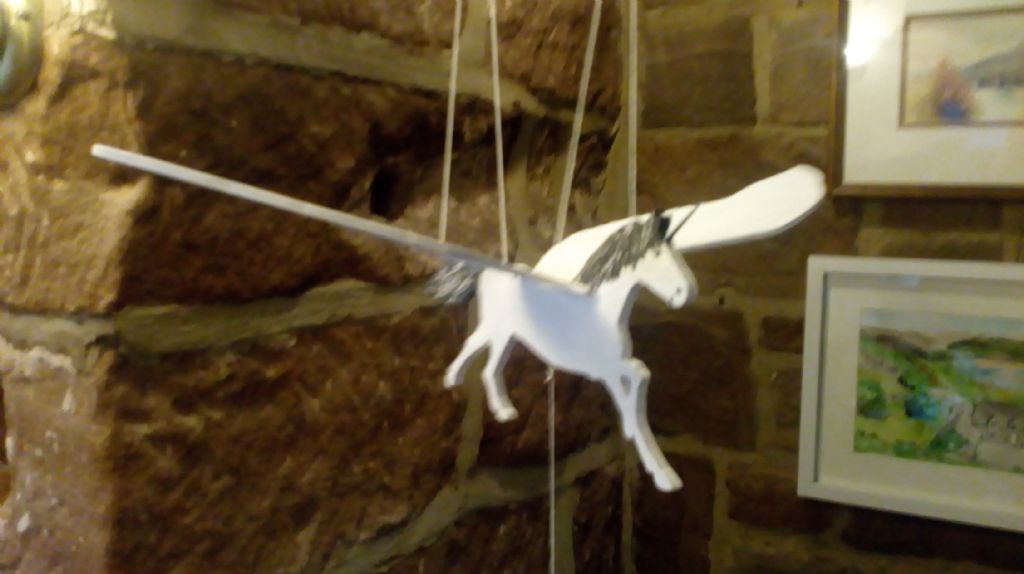

                                              A few days ago, I finished a plywood flapping Alicorn (unicorn with wings) for a granddaughter's ninth birthday. With a lump of brass on the bottom cord, it flaps several times at one pull.
                                              She's decorated it nicely since.

                                                  I like that Alicorn, Mick!
                                                    Looks neat, Iain
                                                    … You could probably replace that M5 with a ‘differential screw’ arrangement, as famously used on the Norris woodworking planes.
                                                    Wikipedia mentions a very suitable mix of threads:
                                                    For example, an M5x0.80 thread paired with an M4x0.70 thread will produce a differential motion of 0.1 mm, or 100 microns per revolution.
                                                    Ref. https://en.wikipedia.org/wiki/Differential_screw

                                                      Thanks for this, Michael!
                                                      That's very interesting. I spent a bit of time thinking about how to apply this on the gauge. The most likely implementation would be like this clamp (referenced from the wikipedia article).
                                                      There are two challenges that I see (well three, but we'll leave my technical ability out of it). The first is the one mentioned in the article, which is that the torque required to shift the differential screw may be significant. I don't think that would be an issue with the gauge, but I would need to build it to find out.
                                                      The one which concerns me more is that the centre threaded rod must remain static with respect to the outside holder. If there is any movement (as the differential screw is turned), then that will overwhelm changes from the differential.
                                                      Before I saw this diagram I was lying awake trying to think of ways to hold the nut (in the other model) rotationally rigid and was somewhat daunted by the size of the apparatus that would be required and the level of precision engineering. I'd imagined the nut running in some splines on the outer body – or something.
                                                      So am M4 / M3 combination seems to come with quite a few design / construction challenges which I've not quite got resolved. The idea above seems easier in this context if it works in practice.
                                                      I may well have a go at this at some point, but it will have to find it's place in my queue of half started projects.
                                                      Many thanks again!
