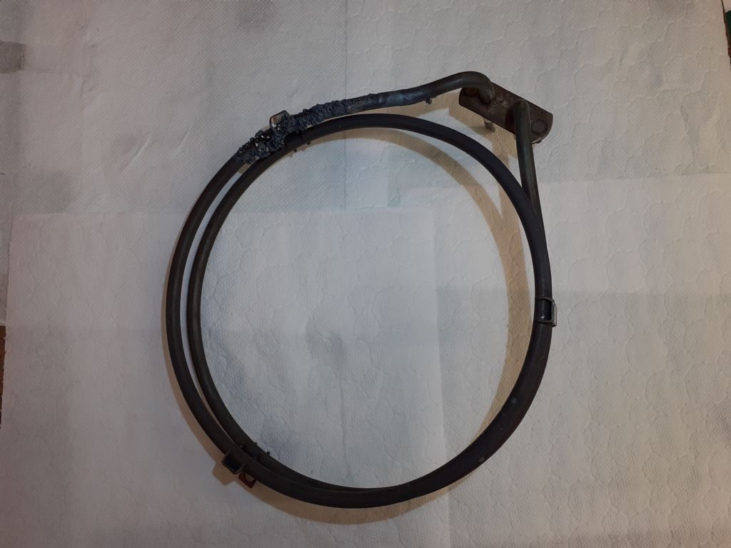

        Spent this morning changing out shorted oven element …
        Damage at top left don't ask what caused it… no power cut, it didn't trip any breakers, just stopped working, Oven not heating, but fan still worked & thermostat light on so that's working, I deduced that the element had gone, ordered new one from espares ( Usual disclaimer ) yesterday, arrived today… Fitted working fine, job done. the only downer was I now have an aching back, set off my spinal arthritis, bummer!.

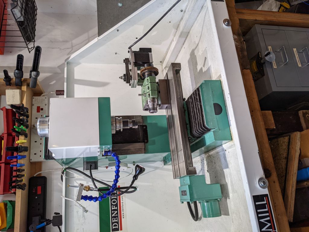

                              Finally connected up the 4th axis drive on my Novamill so I can experiment with some helical milling.

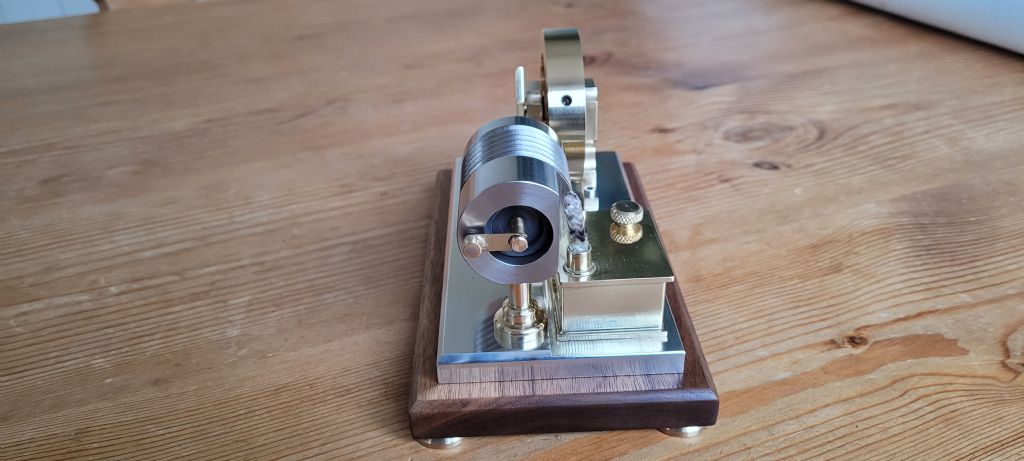

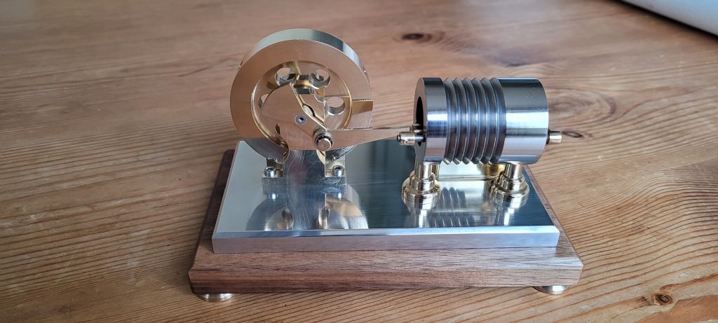

                                  I finished my flame licker today. My second engine, to a design by Jan Ridders.20210410_174951[1].jpg
                                  It does run, but exhibits a strange problem. It appears to stall after it has picked up speed. It then changes direction. I have uploaded a video showing this: https://youtu.be/BBFbckSVNSM.
                                  Edited By IRT on 10/04/2021 22:45:00
                                  #539122
                                  IRT
                                    @irt
                                    After thinking about it some more, the only way I could imagine that could happen was if the valve was being sucked in as the piston moved forward. I have extended the thread and screwed the valve back about 0.5mm more, and now the problem seems to have been resolved.
                                    I have uploaded a video of it running in the same direction:
                                    https://youtu.be/OlW9-4f602o

                                            Posted by John Haine on 10/04/2021 13:02:58:
                                            That method of drive coupled with the stepper holding power should resist any movement under cutting forces without clamping the D/H spindle.
                                            That machine looks new still !!!
