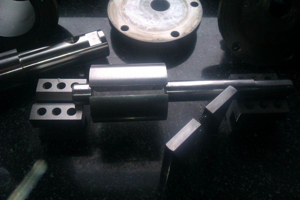

Commissioned my Worden Tool & Cutter grinder. At last!
As advised in Hemingway's instructions, I took it outside into the sunshine for the Wheel Dressing Ceremony, followed by putting a shine back into the edges of a slot-drill and an end-mill, and truing an off-hand ground single-point threading tool.
Though I made and fitted the optional feed-screw mechanism, and used for the wheel-dressing, in practice I found it easier to manipulate the slide directly by hand, resting both my hands on the machine's sides so as to give plenty of control.
Another user had queried why the lathe-tool holder seems too high, but I had worked out, and proved to myself, that it isn't. It holds a lathe-tool across the cutter slide axis so you can grind its flanks without swinging the slide right round to odd angles.
The cam-shaft that sets the table slope is very stiff but I think that's me not quite getting the last one or two "thous" off somewhere. I've also not calibrated the angle-indicator as on the drawings. I think using an adjustable-square or simple templates, would be easier, for the few and not super-critical tilt angles likely to be needed.
The red rings are ordinary fibre-washers – my addition, for better friction-locking with less paint-stripping.
One thing I'd not realised I'd missed until picking out a couple of cutters for my little practice session, was making a holder for 12mm dia shank cutters. The drawings (or the edition I bought anyway) are for an Imperial set but I chose to make a metric set in parallel, indicating those with a marker groove as on Clarkson 'Autolock' collets. Evidently I missed the 12mm one.
Otherwise… I now have much less excuse for my machining errors being inaccurate and poorly-finished!
The paint-work by the way is just ordinary gloss from Wilko's finished with a rub down and couple of sprays of gloss-white acrylic car paint. The black-ish finish is Birchwood Casey 'Gun Blue', followed by spray-on furniture-polish as these chemical-colour treatments are not rust-preventatives.
The photograph shows it with the lathe-tool holder mounted, though not clearly. The extra brass thumb-screw protruding from the side of the cutter-holder base, is part of a slitting-saw sharpening attachment that still needs one or two details finishing.
Then found an area of kitchen work-top where it can live, reasonably far from any cooking activities.
