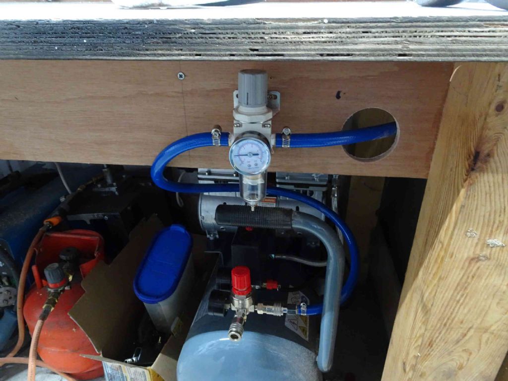

Today, I finally finished off the air plumbing for my compressor.
I've really struggled trying to understand the various incompatible standards, sizes and options – and that despite helpful feedback from forum members in another post.
IN the end, my project approach was one I call, 'muddling through. I started off by buying a cheap 5m air hose. Turns out it had a 10mm diameter, so I started buying small number of bits and bobs to see how they fitted together.
Here's what I've ended up with:-
From the compressor to a pressure valve, water remover
I should be able to pull out the compressor to drain water from time to time and I still have access to the second outlet at the front.

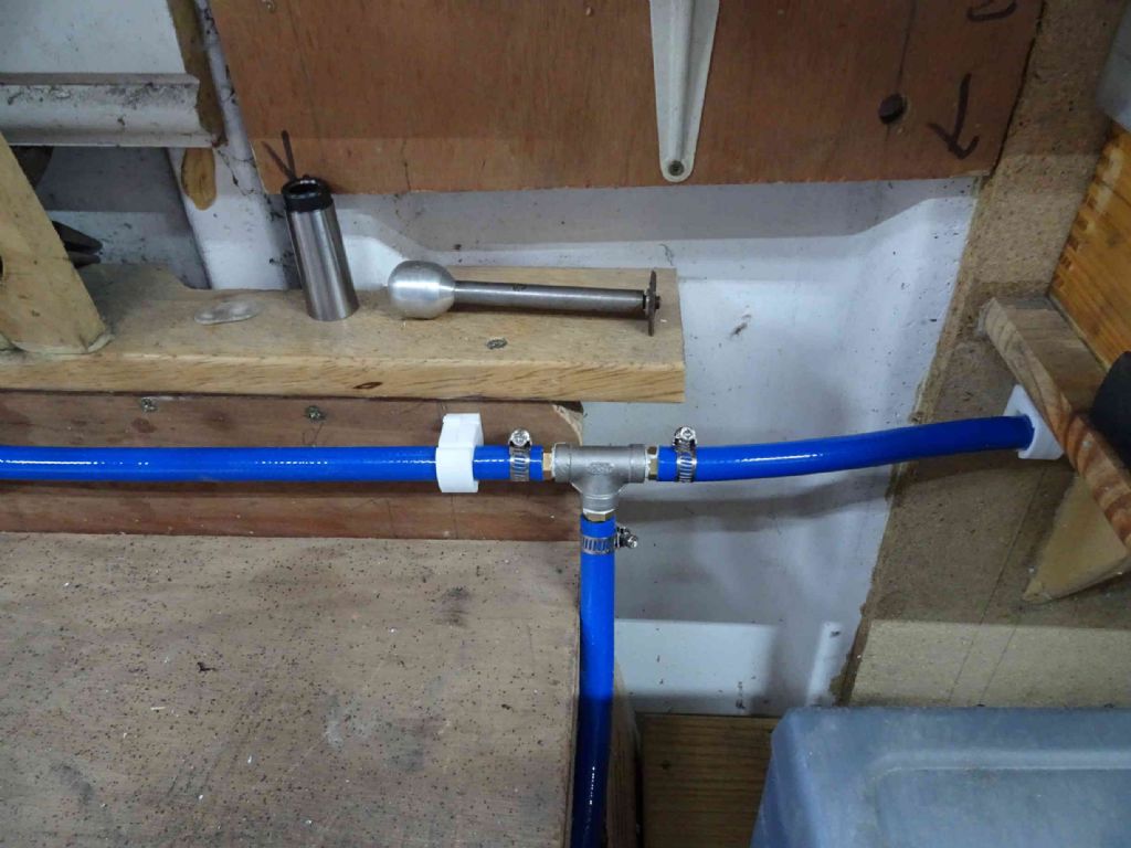

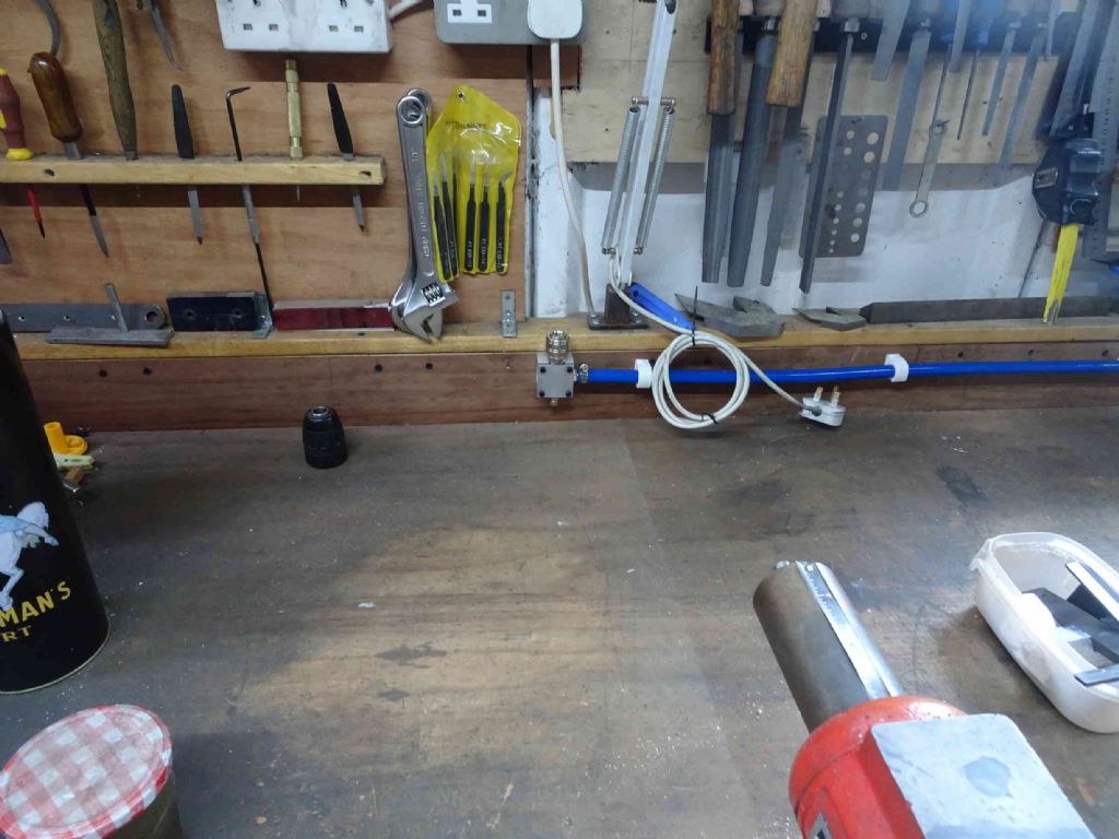

This feeds a Tee
Whose left spur goes to a point on my bench, near my old and tiny CMD10 (just out of the shot on the left).

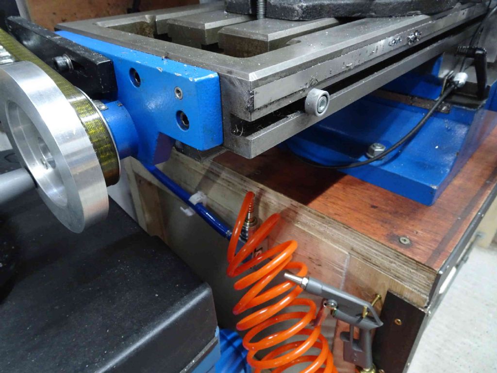

To the right, it first pauses by my rather bigger mill.
Sorry about the picture – it's hard to get a good angle on it.

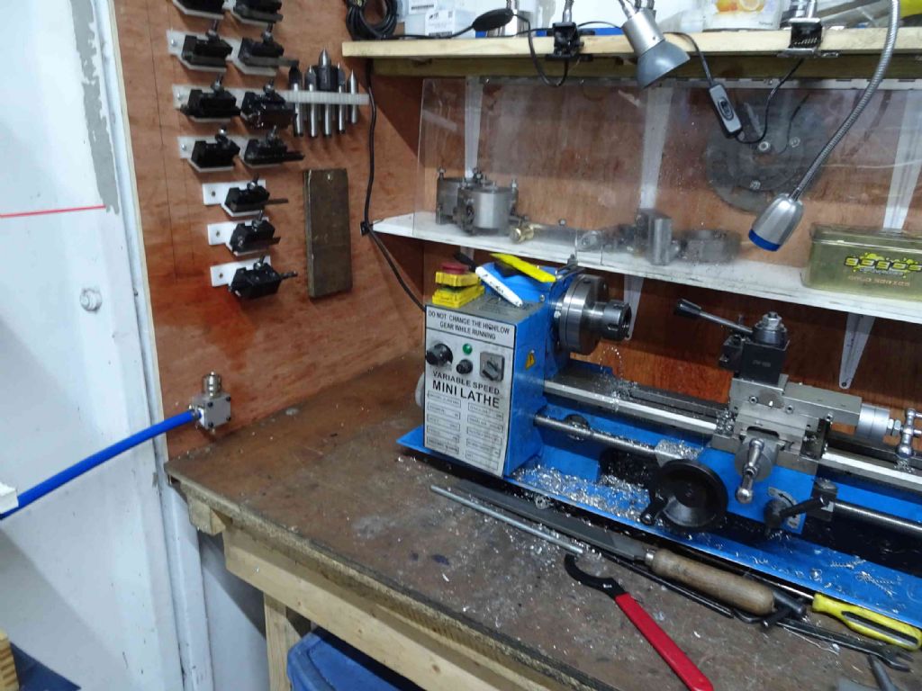

Before pottering round the back of the mill and then the back of the shed where it ends up at a point for the lathe.
Almost as much effort was tidying up the shed so I didn't look like a complete mess. Sadly, but the time I got to the lathe, my tidying hormones had completely ran out, so the lathe is in it's normal swarfy state.
One of the biggest challenges was working out how to hold the quick release points. A kind member suggested I mount each point with a drain valve to clear any excess water. I have done so, though in hindsight I wonder how much value that has with my rather sparse usage. Still, sometimes I like to do things 'right'.
I tried 1/4 BSP T connectors, but couldn't work out how I would mount the (without quite complex machining), so ended up using 4 way connectors (cross shaped) which I set into some milled ally pieces with a plate on top (said plates sliced out of a block with the slitting saw mentioned a few posts back)..
There's no apparent leakage and all points work. Unusual that something works more or less first time!
