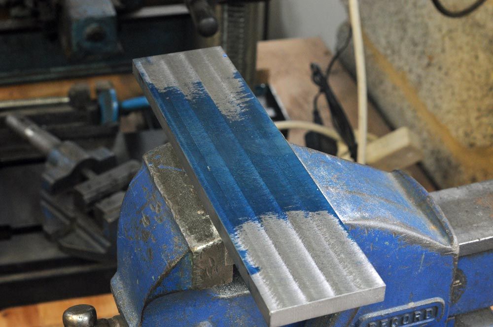

        I've put the wood away and, to get myself back into the swing of machining metal, I thought I'd spend a couple of days making the precision level whose base casting has been hanging around in the workshop for the last thirty years. The only recent purchase was the vial from Amazon.
        Has a slight hump in the middle after milling which I don't really understand.
        An hour or so scraping has left it flat enough
        Stay well,
        Rod
        #519839
        Nigel Graham 2
          @nigelgraham2
          Slightly convex… Lengthways or across? Or both?
          A stress-relieving effect?
          Slight wear dropping the table in mid-travel so that on long traverses, it follows a very slightly concave path (so very slightly less metal removed from the centre)?
          I've noticed similar faults and not really been able to pin them down, but my mill may have a harder life than yours.
          #519850
          Roderick Jenkins
            @roderickjenkins93242
            Nigel,
            I think that's a good analysis. The casting is pretty much at the limit of the travel on my X axis and is stiff at both ends.
            Cheers,
            Rod
            #519861
            Howard Lewis
              @howardlewis46836
              If anything, I would have expected the casting to deflect at the ends (Being slightly less stiff because of the taper at the end of the central rib )
              In which case the ends would spring back UP to leave a depression in the middle.
              But the "bent" condition has already been corrected .
              It is going to be a far neater and better job than mine.
              Howard

                #519887
                Roderick Jenkins
                  Posted by Howard Lewis on 14/01/2021 20:05:25:
                  Those were certainly my thoughts.  I should have made it clear that it is the travel on my X axis that is stiff at the ends.
                  The info that you sent me shows a lot of superfluous machining on the casting but, being from College Engineering Supplies, I guess it was originally intended more as a machining exercise for a student. I'll be going my own way surprise
                  Rod

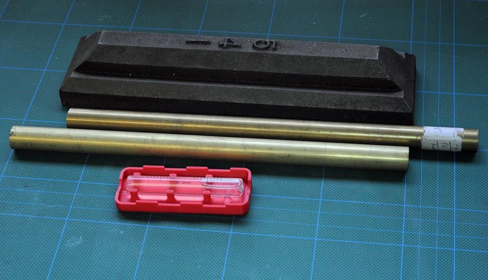

                        I finished the level today:
                        I was fortune to have in my collection a thin brass tube that was a nice snug fit over the thicker tube into which the vial is mounted with the traditional plaster of paris.
                        Not sure what I'll do with it now – probably put it in a drawer and forget about it.

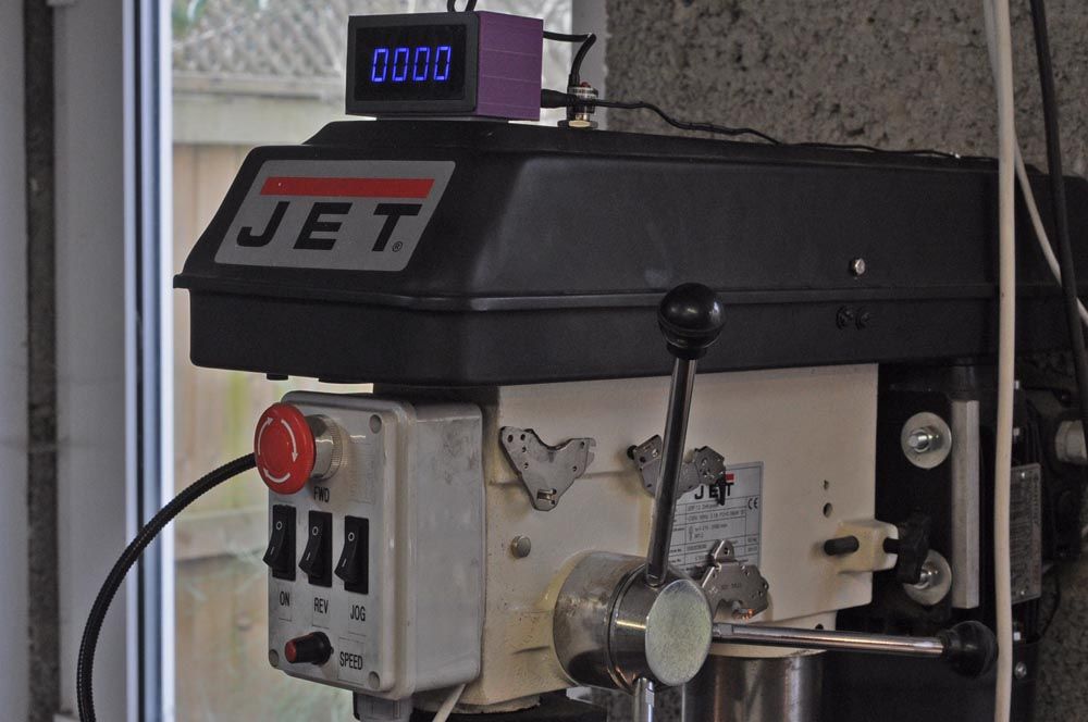

                          Fitted tachos to the lathe and drill, both of which have VFD motors.
                          One thing that I frustratingly learnt was that these devices seem to need rather more than a 12V power supply before they will work consistently angry
                          Of course, I've managed for years without them but I'm the sort of guy who needs data.

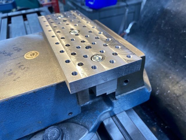

                                          Almost finished a small fixture plate. My mill is Bridgeport sized and has a large vice and I have found trying to hold small stuff a bit awkward. Particularly at the moment as I am trying to resurrect a Stuart 10V which I bought on Ebay a few years ago.
                                          I wanted the plate to be able to just be dropped in the vice and for it then to be level and square. Cut a 7" length of BMS 25mmx30mm section and squared it up on the mill then drilled/tapped three M8 holes down the X -axis centre line.
                                          I had bought a 200mmx80mmx15mm for this job. Set it level in lathe and brought the two ends close to size and then used face-mill to clean up what was to become the bottom. Turned it over and then drilled and counterbored three M8 holes along the center to match previously machined bar. Bolted the two pieces firmly together and then back into the vice to drill and ream two dowel holes. With dowels made and fitted I then squared up the ends and sides and ran face-mill over the top face. Hopefully all is now square and solid and flat.
                                          Then proceeded to layout a hole pattern for M6 tapped holes (two rows of 9 and two rows of 8), these were then centred, piloted, drilled, lightly c'sunk then tapped M6.
                                          Followed this up with 3 rows of 5.8mm holes (8, 4 and 8), ready to ream at 6mm for location dowels. These were again centered, piloted, drilled and very lightly c'sunk. These dowels will allow me to set stuff up parallel to the X or Y axis very easily.
                                          Part way through all this I then found I did not have a M6 machine reamer, but luckily my mate down the road has spares and am collecting an MT1 and chucking reamer tomorrow.
                                          The first job it will be used for is getting the Stuart 10v sole plate flat. The original builder had filed it but the mounts for the stand (particularly) and the bearing mounts are not perfectly flat and luckily are not at the required dimension so I have scope to correct it.
                                          Colin

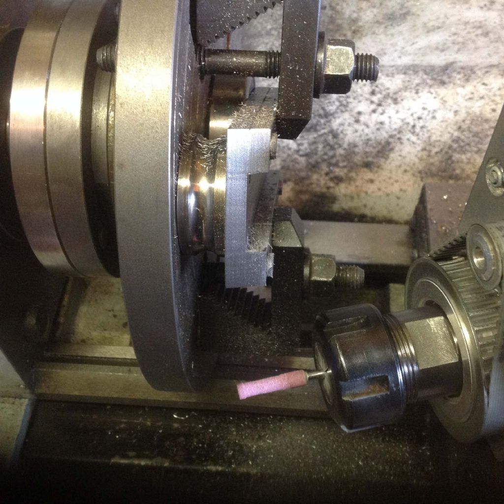

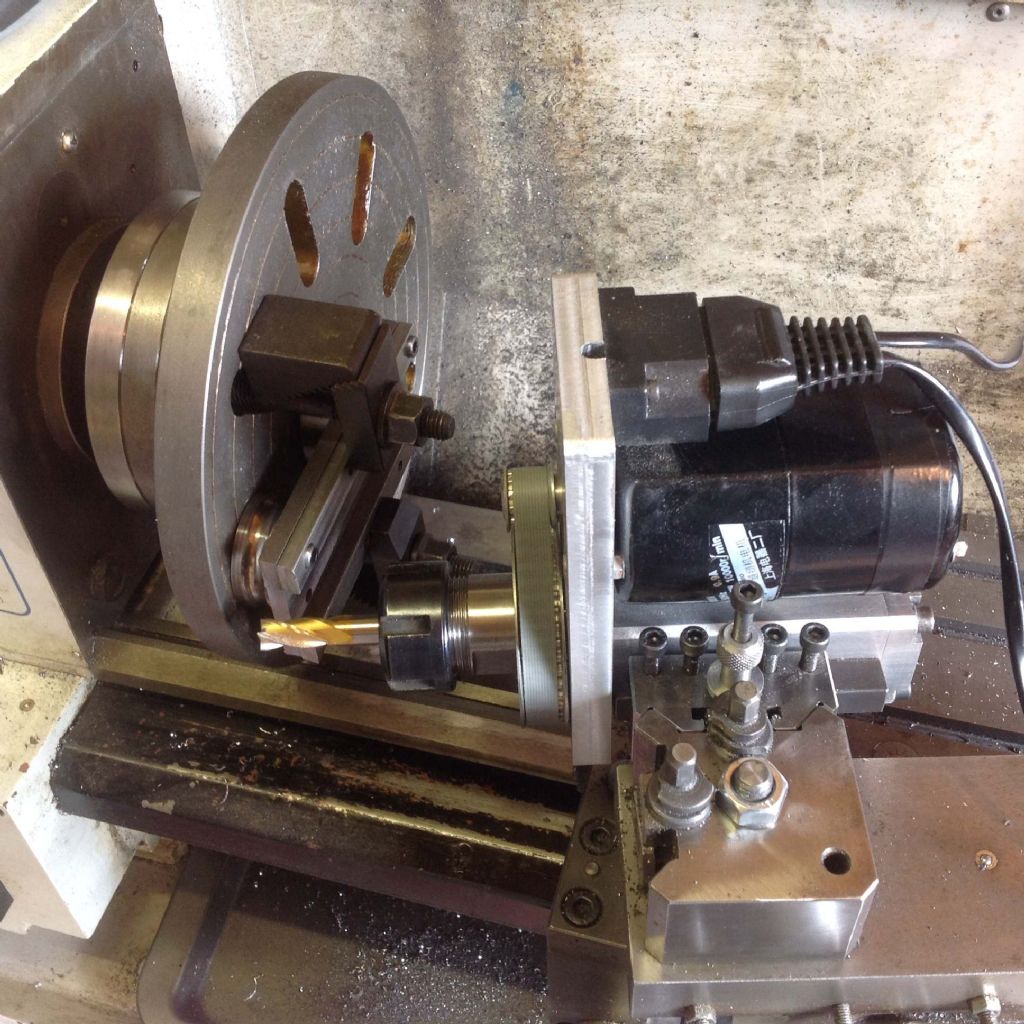

                                                  Flushed with success at making a tricky little slotted part for my Worden T&C Grinder yesterday, I started machining the radius on the end of the plate that holds the tool-holder and swings round a protractor plate.
                                                  It consists of a rectangular steel plate with a bar screwed along each side, and if the bevel is cylindrical it would be a relatively simple rotary-table milling operation. Only it ain't. It's a conical surface I've no straightforward way to mill..
                                                  The construction notes show how to turn it, clamped to a faceplate.
                                                  After about an hour of very gentle cuts at minimum revs gave only lots of nerve-wracking noises from the headstock for a little rounding-off of corners, I decided this was most unfair on a poor little Myford ML7 manufactured at about the same time as me.
                                                  So that's tomorrow's work – but on the Harrison L5 whose much beefier construction and high inertia ought take the strain (still very light cuts at low speed of course), while the bigger faceplate would allow much better support and easier setting-up.
                                                  I can't identify Mr. Hemingway's lathe in the kit's handbook, but it does not look like an ML7!
                                                  #522943
                                                  John Hinkley
                                                    @johnhinkley26699
                                                    Nigel,
                                                    When I built my Worden, I obviously came up against the same problem. My way around it was to mount the tool holder on the faceplate and use a milling cutter in a tool post mounted spindle, turning the faceplate by hand, thus:
                                                    Bevelling the tool slide Tool slide end ground
                                                    The spindle was a cobbled-together first effort which didn't give a smooth enough result, so I finished off with a grindstone as shown in the second photo.
                                                    Not much use to you, though, if you haven't got a tool post spindle!
