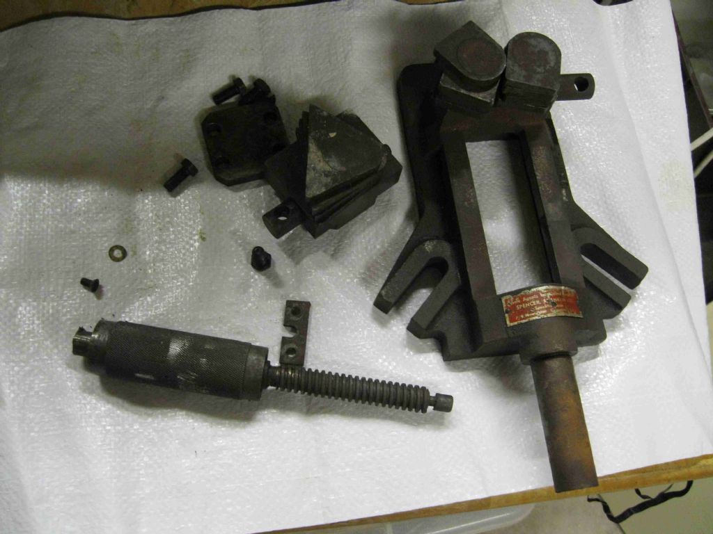

          Posted by Cornish Jack on 25/09/2021 17:18:08:

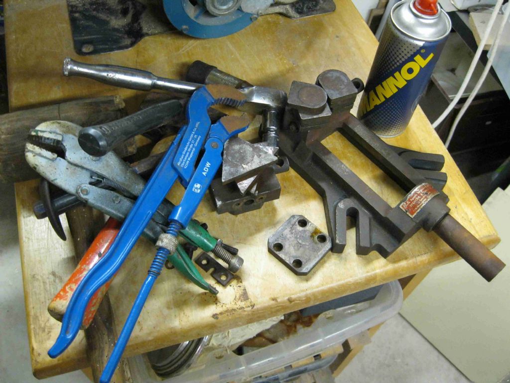

          Not today, but over the last 4 days, worked on the bits below, plus sweat, blood and expletives deleted !!
          and more elbow grease and the silicone variety … ended up with this

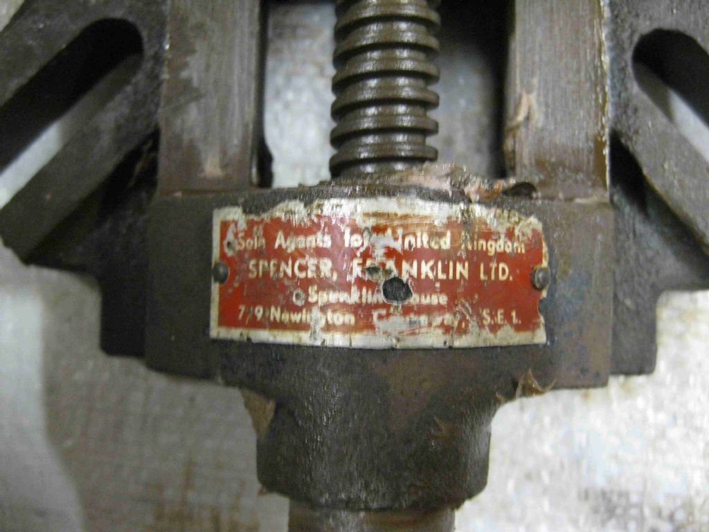

          An unusual design and manufacturer. the shaped work holders rotate individually and accurately match for height – 4 total approx 1/4" thick. Very substantial (heavy) and good for mill or drill.
          Anyone else come across this type ?
          rgds
          Bill;

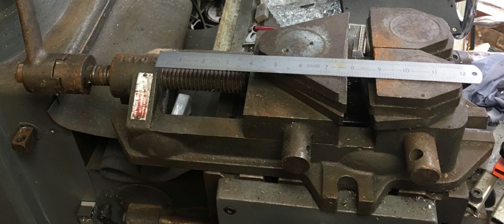

          Yes, I have a pair of vices of a very similar design, mine are branded SEVO 2, bloody heavy but very useful at times, especially as an identical pair. This is one of them,

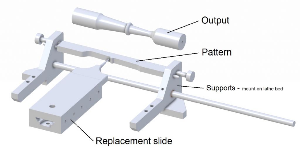

                      Not just today, but most of the weekend, I have been drawing up a design for a copy/taper-turning attachment for my lathe. Access to the rear of the lathe is restricted, so I wanted to be able to clamp it to the bed. See below:
                      3D CAD mock-up of the assembly
                      The topslide is replaced by the replacement slide, which carries a stylus at the business end and is held in contact with the pattern by a couple of springs (not shown in the mock-up). The supports are clamped to the lathe bed , the left hand one being fixed near the headstock and the right hand one is free to slide on a steady bar until the pattern is in place, when it's also clamped to the bed. The pattern is made from flat material and is held in place by two thumbscrews. A couple of pointed hex socket grub screws prevent rotation of the pattern. The stylus rides on the pattern along its centreline.
                      I intend making a mock-up from MDF (because I've got quite a bit), before committing it to metal and I want to play a bit more with my cnc router.
                      Right angle corners will present a problem, I realise, should I encounter them, but careful use of the clasp nuts may help there.
                      The replacement slide takes the existing QCTP and is sized to ensure the the cutting tool will be on the lathe centreline.
                      If nothing else, it's kept my occupied for a while and will continue so to do, I expect.

                        I have something very similar on one of my Peatol and use it with live tooling, it works very well and of course repeatable which is what you are after.

                          That's very reassuring, Bernard. Thanks.

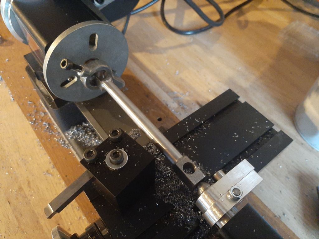

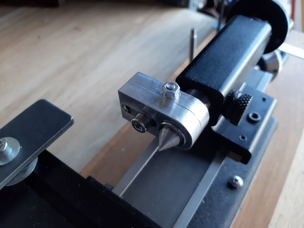

                                I'm slowly getting used to the Sherline lathe. Have to say so far entirely happy with this machine it has yet to disappoint me.
                                Today some taper turning on the con rod for the beam engine.
                                No offset facility on the tailstock so I made the attachment shown in the photograph. Got the idea from Mike's workshop. Mike's design has more detail but mine incorporates a small thrust bearing.
                                Whoever set this machine up at the factory did a great job

                                  That looks a handy piece of kit Geoff, I’ve made one for the Myford so looks like I’ll have to make one for the Peatol.

                                    Hi Bernard,
                                    Thanks for your reply
                                    Yes definitely a handy piece of kit, made for the job in hand but I've no doubt I'll use it again.

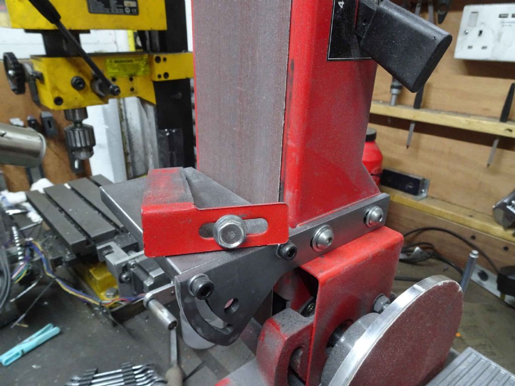

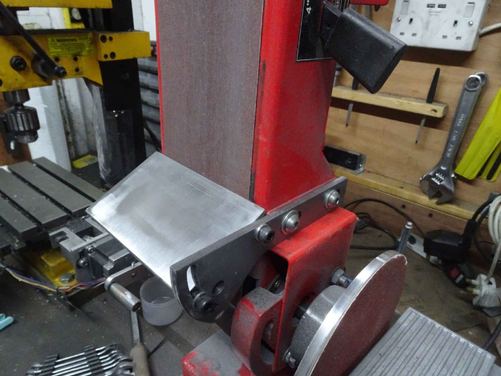

                                        In a quest to (perhaps) work out how to get nice finishes on the junk I machine, I bought a cheap linsher. I think it cost me around 70 quid new from eBay.
                                        I wasn't terribly happy with it and decided it needed some attention. The first thing I found was I couldn't get the sanding belt off very easily. A bit of fiddling got it off and I ordered a set of various grits. I immediately found that the reason for for the belt as supplied not coming of is that it is just a little shorter than the machine is designed for (100×915). Now I can swap belts with the greatest of ease. Though where to store them in my overcrowded shed is another issue.
                                        I'm operating the machine in the vertical mode and the shelf thing which should support the work is just rubbish, so I replaced it.
                                        The bits which are not painted are mine. The nasty red thing sitting on it is the original which would bounce up and down with great excitement with the least load.

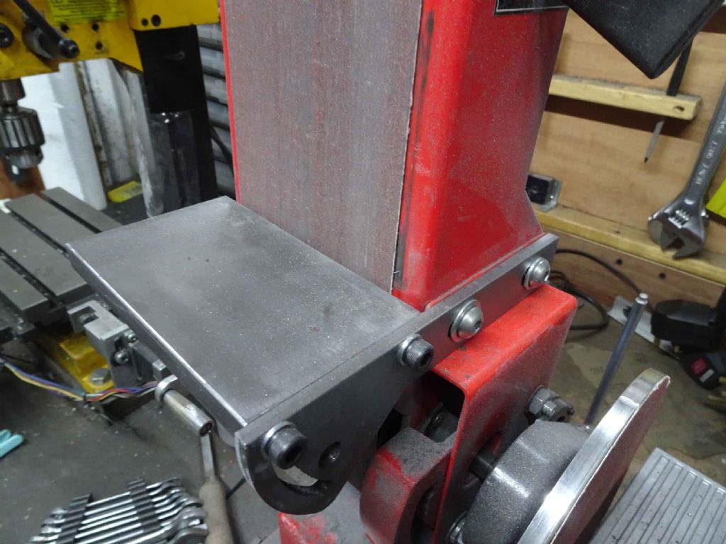

                                        Here's a close up.
                                        And I decided to make it a bit more versatile and tilty as the tilting platform supplied with the disc sander is of equal quality to the rest…
                                        I've still not quite got the hang of nice finishes, though, but I'm getting there.

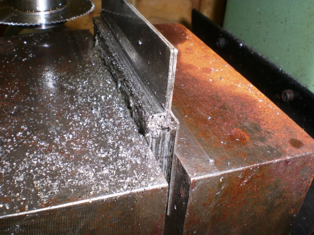

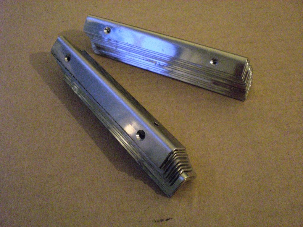

                                            Hi, yesterday I finished making 24 angle brackets.

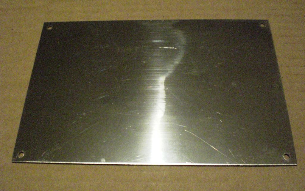

                                            These were made from six scrapped stainless steel hire plates that the company I worked for years ago never used and I acquired about 100 of these 4" x 6" by 3 / 64" thick plates, all nicely wrapped in brown paper in stacks of 20, they were packed with two plates with the plain side toward each other and the brown paper was folded over each pair on the engraved side, each plate had consecutive numbers stamped on them from 0001 and were probably made in the late 60's / early 70's, no idea why they were never used but were scrapped during the stores reassessment of what was needed to be held.
                                            First of all, the two holes at one side were cut off and then they were cut to length and then they were stacked and clamped into my milling vice, with enough protruding for cutting off with a slitting saw, into 24mm wide strips, then lifted for the next six strips and repeated until all six plates were cut into 24 strips.
                                            Each strip was then deburred and the corners were rounded off with a file, one strip was marked and drilled, which was used the spot through onto the rest of the strips.

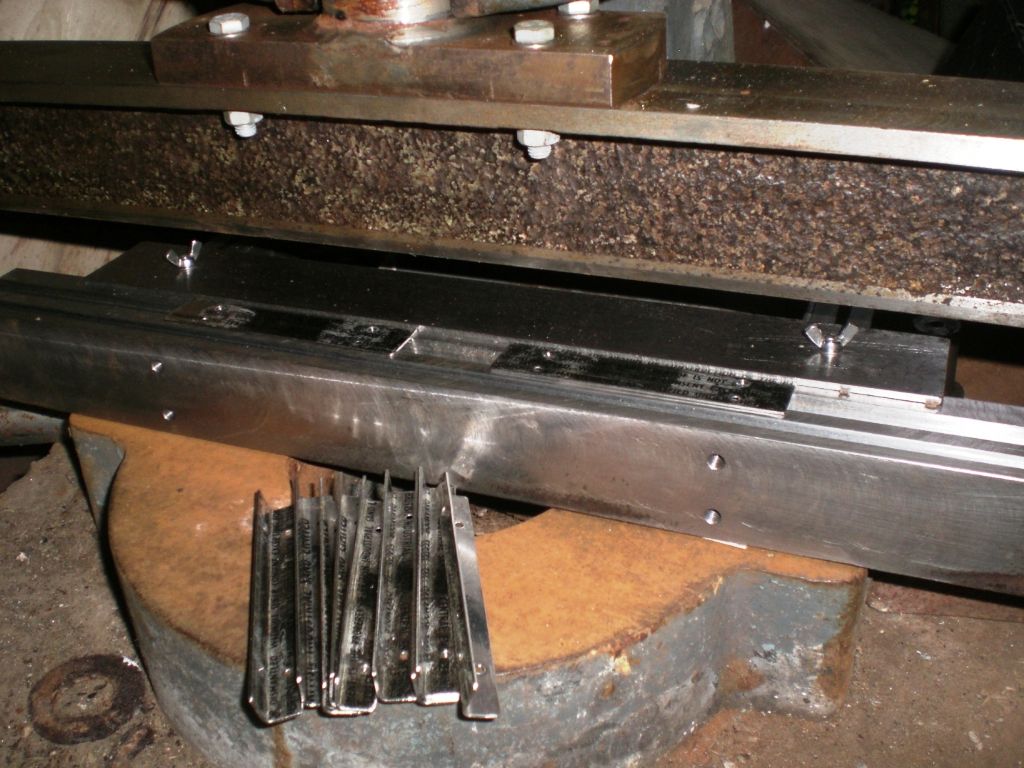

                                            When they were all drilled, two holes were countersunk on one side and the other two holes were countersunk on the other side.
                                            These were then pressed in pairs to form 90 degree angle brackets, using my Flypress and my sheet metal "V" block and blade Sheet Metal Bending Block
                                            These will be used for holding shelves in this CD storage unit which was given to me, however, I found it awkward to use as is and I don't really like the flimsy plastic slots that only hold a small portion of the cases, so I'm converting it to shelves which will increase its capacity from 160 to 192.

                                              Just curious, Nick …
                                              What is the full text on your salvaged plates ?
                                              Tell us now, and it will save future Archaeologists a lot of time angel
                                              #567495
                                              Nicholas Farr
                                                @nicholasfarr14254
                                                Hi MichaelG, it was hard to photograph it well, due to its reflectiveness, but with a bit of help with Microsoft Office Picture Manager, I think you should be able to read it OK.
                                                Contract Plate
