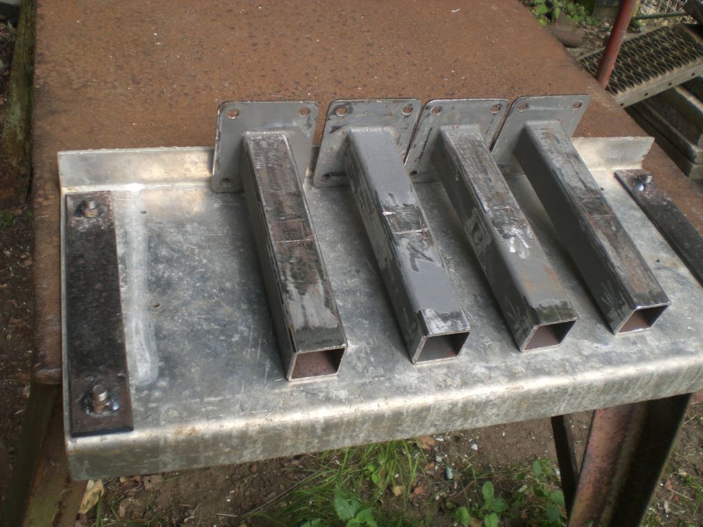

            Hi, yesterday afternoon I set about up-cycling some scrap pieces of metal to make a step-up, which is about 230mm high, the tread is a chequered aluminium stair tread, which I made a couple of flat pieces of 40 x 6mm flat black bar and drilled a couple of holes in each end to match the holes that originally fix the tread into place and 10mm nuts were welded onto one side of these plates where the holes were drilled. Four legs are from some tables that had castors attached, of which I had to shorten down in my last day job and these where much to useful to bung in the scrape bin, so I acquired consent to take them home. (I think there were about eight tables that I had to alter, giving me 32 of these legs some of which I've used for a couple of other jobs)
            Two legs were set-up at one end of each of the plates and piece of 20 x 20 x 2mm SHS was cut to fit between the two as a tie-bar and was also set-up. These were then all tack-welded into place.
            The other two legs and another piece of SHS were then set-up in the same manner and tack-welded into place and then two shorter pieces of SHS were cut and set-up and tack-welded into place between front and back legs. All four of these legs were picked from the selection that I have, so that my tie-bars could be weld in the same place as the tie-bars were on the original tables.
            Hoping the weather is OK tomorrow, I can then weld all the joints up and then look to see if I can reverse the up-turn of the tread to a down-turn to match the one which can be seen at the front in the above photo.
            Regards Nick.

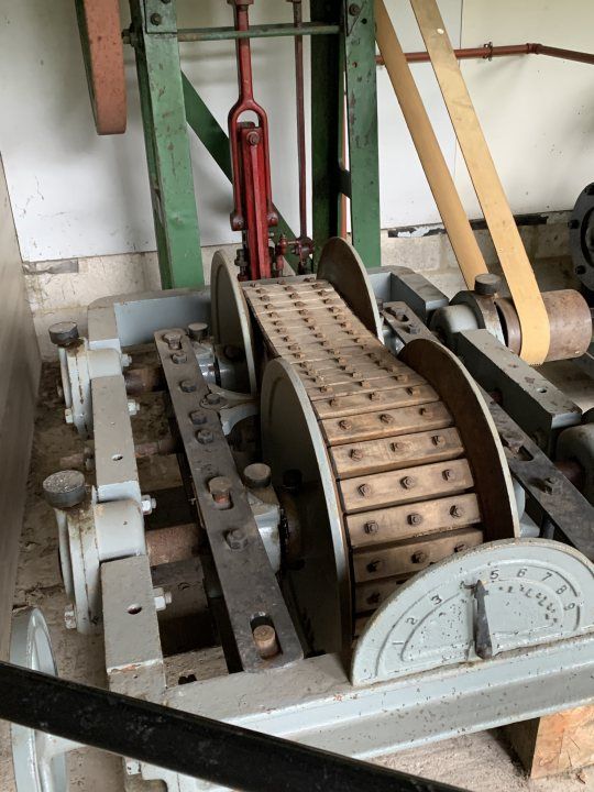

              I can’t find a specific forum for this, but today I visited Wortley Top Forge, just north of Sheffield. It’s only a 15 minute drive for us. I went many many years ago, but it never really registered in my memory as a child. However, a work colleague went recently, and told me it was good.
              I went with the kids (11 and 13), and it was great. Loads of what I’d describe as small to medium sized steam and internal combustion engines, workshops with belt driven machines, a forge, water wheels, small steam railway, etc etc. The amazing thing is that most of it works (steam engines mostly on compressed air), and how accessible everything is. On arrival we immediately got befriended by a volunteer, who began to show us various engines, gave us a demonstration of ‘barring’ a steam engine, before passing us on to someone else who gave us a full tour of the rest of the place. The water wheels work, and drive a trip hammer and a crank driven furnace blower. There was also a tour of a typical 19th century worker’s cottage. We will definitely go back when we have more time, hopefully when there’s an en event in where they have live steam exhibits.
              Entry was £3 for adults, 50p for kids. Quite an amazing place all in all. I wish I’d gone again before now.
              Here are some random images:
              Loads more than in the photos. Proper museum with proper volunteers; we learned stuff about social history, metallurgy and engineering. We all thought it was brilliant.

                    Hi, welded and cleaned up my step-up frame ready for painting.
                    Regards Nick.

                            The first thing which intrigued me in Dr_G's post was the first photo of what appears to be a variable speed drive. The same principle was used (and still is) for speed control of mechanical equipment.
                            I remember using "Reeves" Vari-speed drives in the early 1970's. Some of the latest small cars use a CVT gearbox (constantly variable transmission).
                            The speed of the output shaf depends on the diameters of the pulleys. The flanges of the pulleys are tapered and the belt does not run on the bottom of the pulley but on the sides of the taper. The distance between the flanges is variable and because of the taper, the diameter of the pully where the belt is driven changes in diameter, altering the ratio between the 2 pulleys.  I presume the red lever alters the width of the controlling pulley. The flanges of the second pulley are spring loaded and automatically compensates.  Speed adjustments are only done when the drive is running.
                            vari speed drive.jpg,
                            Edited By Paul Lousick on 14/09/2021 00:56:22

                              Hi Paul, that's what I presumed it is, there was one that drove a 6M filter table where I used to work years ago, but it wasn't as heavy as the one shown, it had a 50 x 16mm belt, which looked a bit like a very wide flat "V" belt. I can't remember exactly how the belt was changed, but I think it had to have the driving pulley partly dismantled and I only changed it a couple of times in the 36 years I worked there, but it would last quite a few years between changes. It was quite a tough belt but it would lose its shape, which meant it was hard to keep a constant speed on the table.
                              Regards Nick.

                                The modern industrial vari-speed belts are like you have said, a wide vee belt, made from a similar, reinforced rubber material. A bit different to the one in the photo with wooden links attached to a flat belt. And different to the belts in the new car CVT drives which are made of thousands of metal parts.
                                A friend wanted to buy a new car with one of the new transmissions and I did a bit of research and discovered that the belts push to transmit power and not pull like traditional belts. They are very compact compared to a tradition gearbox and although the makers claimed that they were reliable and good for 100,000 plus kms, found that they had a few problems, especially if driven hard and rccommended not to buy one.

                                    That was one of the first things I saw. I was intrigued as well, and asked if it was some kind of CVT. To my amazement I was told it was – I though they were a mid-20th century invention (DAF Variomatic was one I think?). Perhaps they’ll have it running at the next open day.

                                      DAF Variomatic – correct (unkindley often referred to as ' the one with the rubber-band drive' ) I also used a Raglan lathe for many years having a similar system – was very good to use.
                                      What constantly surprises me with this sort of thing is that there always seems to be someone who's thought of it before! .

                                        Robert Boby Seed Cleaning Machines made in Bury St Edmunds until the 1960s had a variable speed on the drive for the winnowing fan that looked identical to the one shown . When you turned the adjusting wheel the bar shown connecting the two pulleys pivoted and moved one pulley disc out simultaneously moving the other in thereby varying the speed.

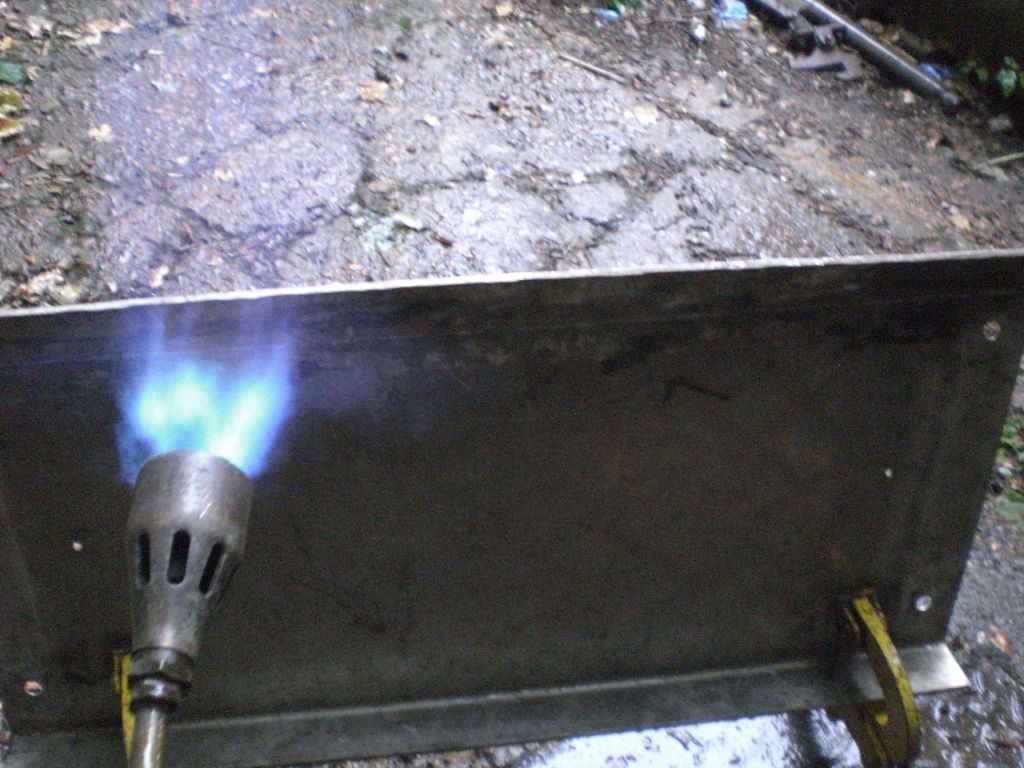

                                          @nicholasfarr14254
                                          Hi, today I managed to flatten the up-turn of the tread of my step-up and fold the downward, but I had to anneal it four times in all, three times to flatten it and one to complete the fold.
                                          It took about eight minutes to get it to about 700 C with my big propane torch each time.
                                          It was then cleaned and fitted and is now ready for use.
                                          Regards Nick.

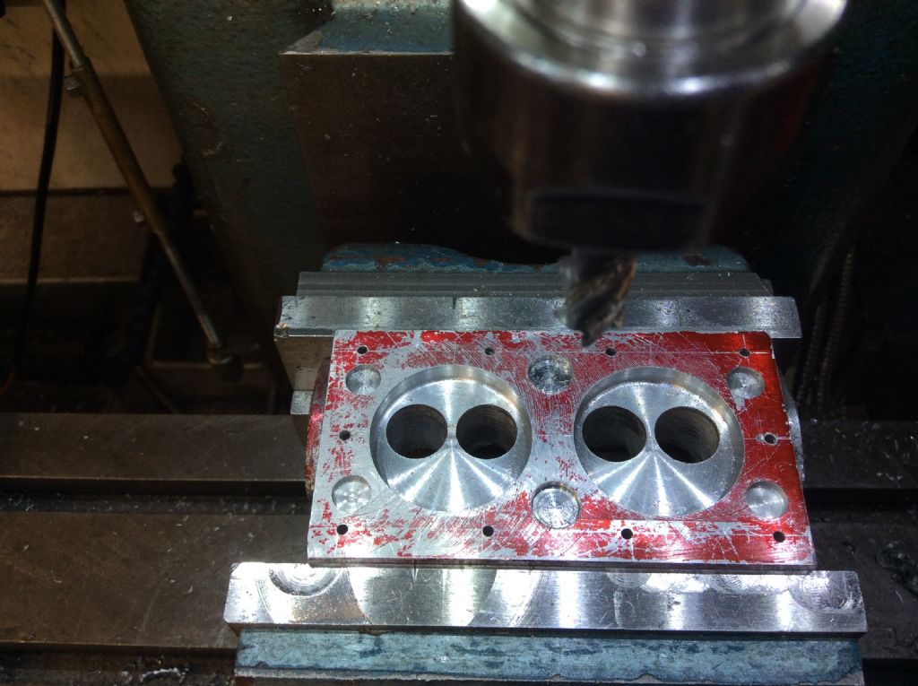

                                            85ee93f8-c769-4b78-8152-363fa1f0c46d.jpegNow student is up and running done a bit on the wallaby cyl23b62aba-8ed9-418e-8bfc-1e8f7c0f1115.jpeg head today

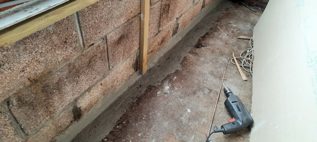

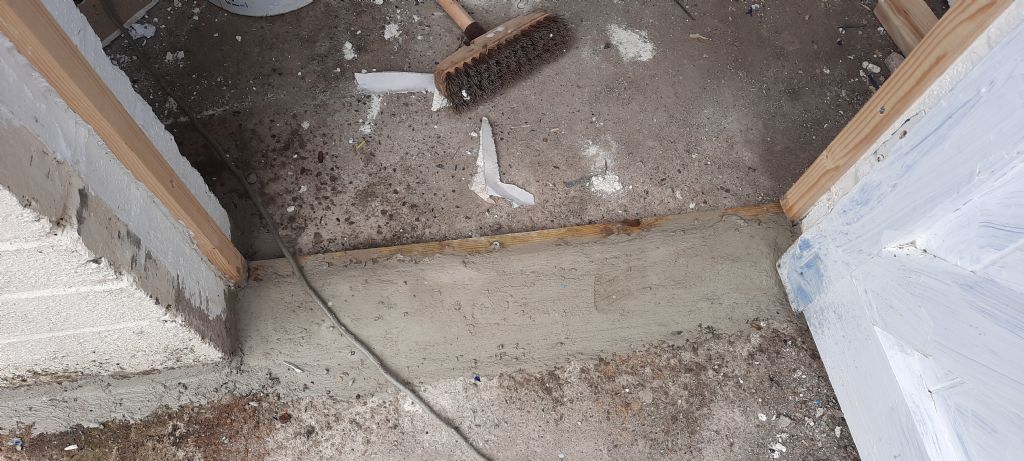

                                                    #563337
                                                      Hi Nick, these photos may be of interest.
                                                      The new sill:
                                                      Waterproofing – a sort of cement resin mixture – add water and mix to a thick creamy consistency. You need to mist it a few times as it sets. Really just belt and braces, I'm fairly confident the base of this wall doesn't really leak, but hard to go back once insulation, plasterboard, skirting (and possibly floor) are in place.
                                                      The trusty B&D Hammer drill was rescued from a skip, clogged with gypsum dust, it has done sterling service for donkeys years. Unlike battery drills that seem to have a puny and rapidly wearing out hammer action, the hammer on is as good as new, just as well when drilling 1" holes through walls, even of breeze block.
