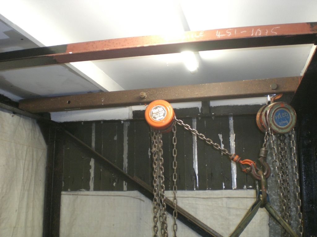

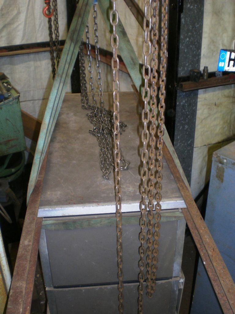

Hi, it was on Thursday afternoon last when I made this lifting beam with three separate points for attaching chain blocks directly to it, to get the maximum lifting height possible. It has been made specifically for the side section of my garage, which I'm nearing completion of partitioning off from the main part of the garage, and can be move along the length of it, with exception of where there are two cross angles of the garage structure and it can be turned round to put the two outer fixing positions on the opposite sides.

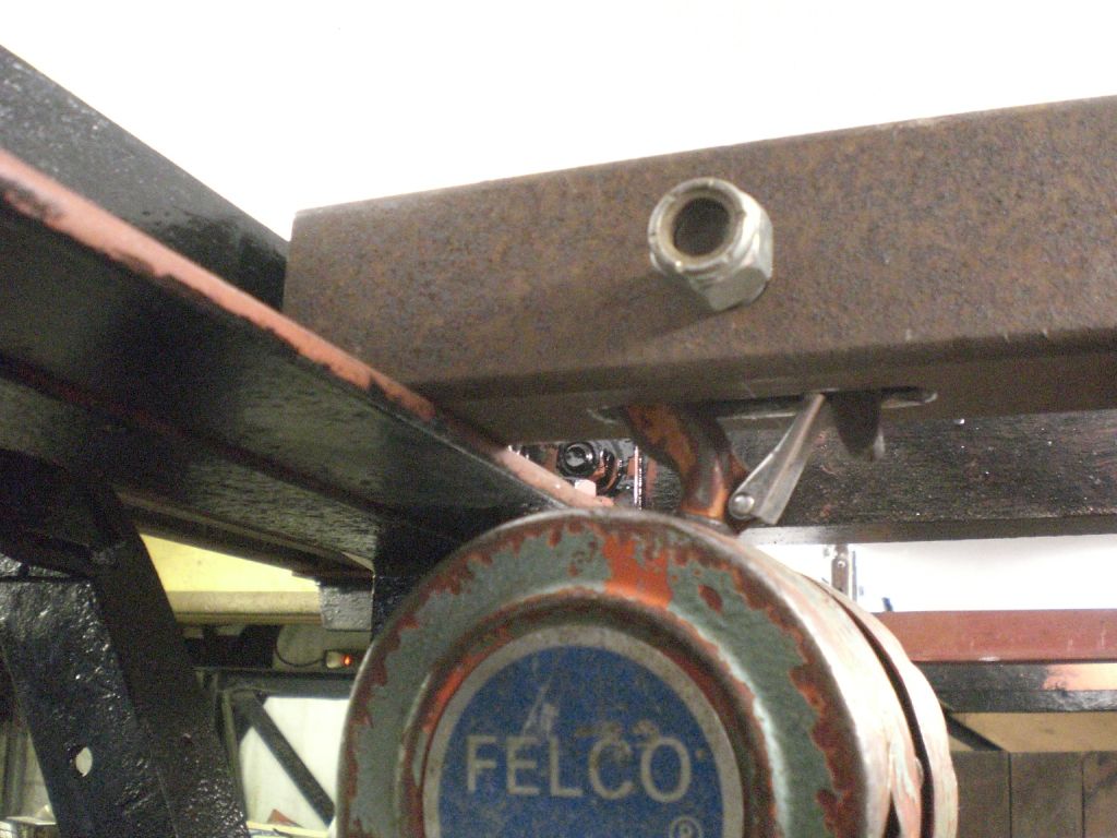

It will be used for lifting my old Chester milling machine and my Myford M type lathe into place as well as any other thing that can't be manhandled, but yesterday afternoon, I used it to move a heavy cabinet out and into the main part of the garage, using the hook transfer method on this beam and then onto one on my overhead traveling beam in the main part of the garage, this will allow me to finish this end of the side section, but this cabinet won't be going back in.
Of course the beam will need to be cleaned and painted in due course.
