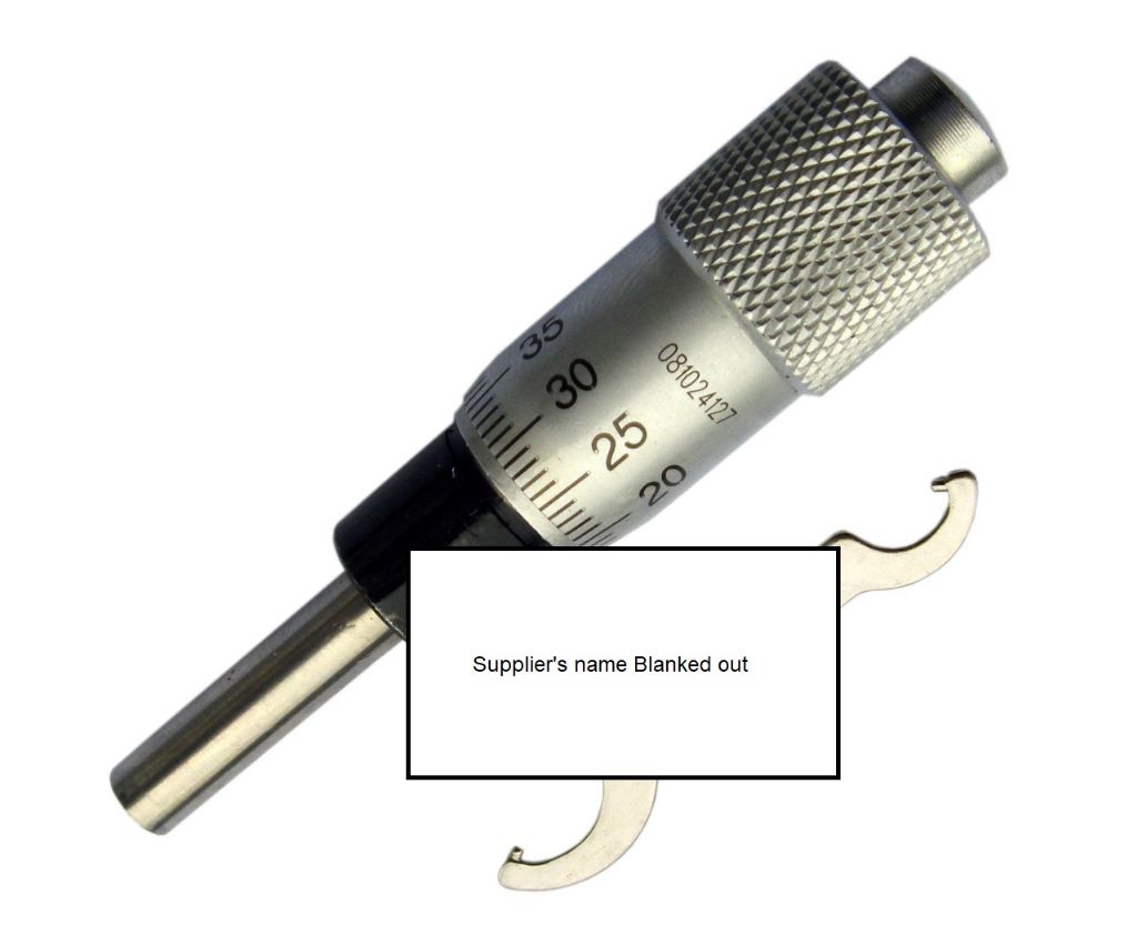

      Iain,
      Unless I've mis-identified the 5mm screw in question, it looks like you may have room to use one of these for ultra-fine adjustment:
      I've blanked out the supplier's name that I lifted the image from but they are quoting a gnat's over £10 each (plus P&P). Looks like it's from China, judging by the delivery lead time but it's the principle rather than the specific article I'm suggesting. The anvil is square, so, if I were to use it, I'd have it pushing onto a ball bearing or similar arrangement to take up angular changes.

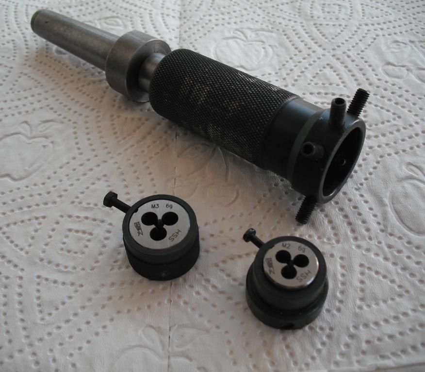

                                      Today I made two adapters for my tailstock die holder to use smaller dies. I should now be able to thread the 2mm studs for the steam chest on the beam engine I am building.die holders.jpg

                                        Neat – I like the finishing touch, the blacking to match the rest of the set.

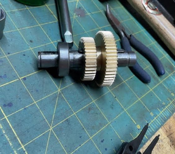

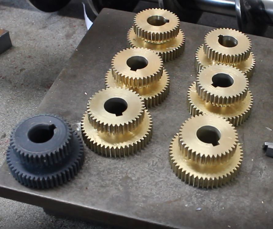

                                              After crunching his plastic speed change gear in his WM12 mill, a fellow model engineer asked if I could make a replacement for him. Not to waste set up time I made a few just in case I was asked again. Thankfully he reported back that the gear fitted perfectly with little noticeable increase in gear noise, that was a relief.

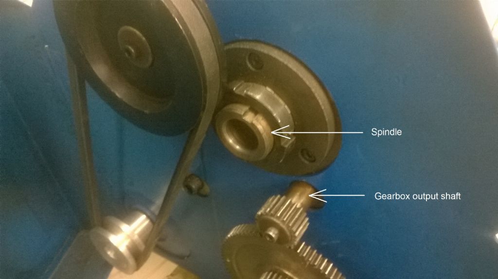

                                                  I've been wrestling with the idea of fitting my lathe with an electronic leadscrew. Spurred on by the discussion on this hallowed forum and the series of videos by James Clough on YouTube, I have today decided to go ahead and to that end have ordered the major parts. Due to the long delivery times, I don't expect to make rapid progress but have made a start by designing the drive for the spindle enclosure.
                                                  My lathe doesn't have a gear on the spindle and the gearbox output doesn't run at he same speed as the spindle, so I've had to develop a system to obtain a 1:1 drive from the spindle to the encoder. This is what I've come up with:
                                                  The spindle end as it is now:
                                                  spindle end

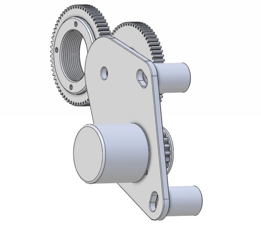

                                                  The proposed encoder drive train:
                                                  Spindle encoder drivetrain
                                                  And sneaking around the back:encoder rear view

                                                    Looks like a clever workaround John. Looking forward to more progress on this.
