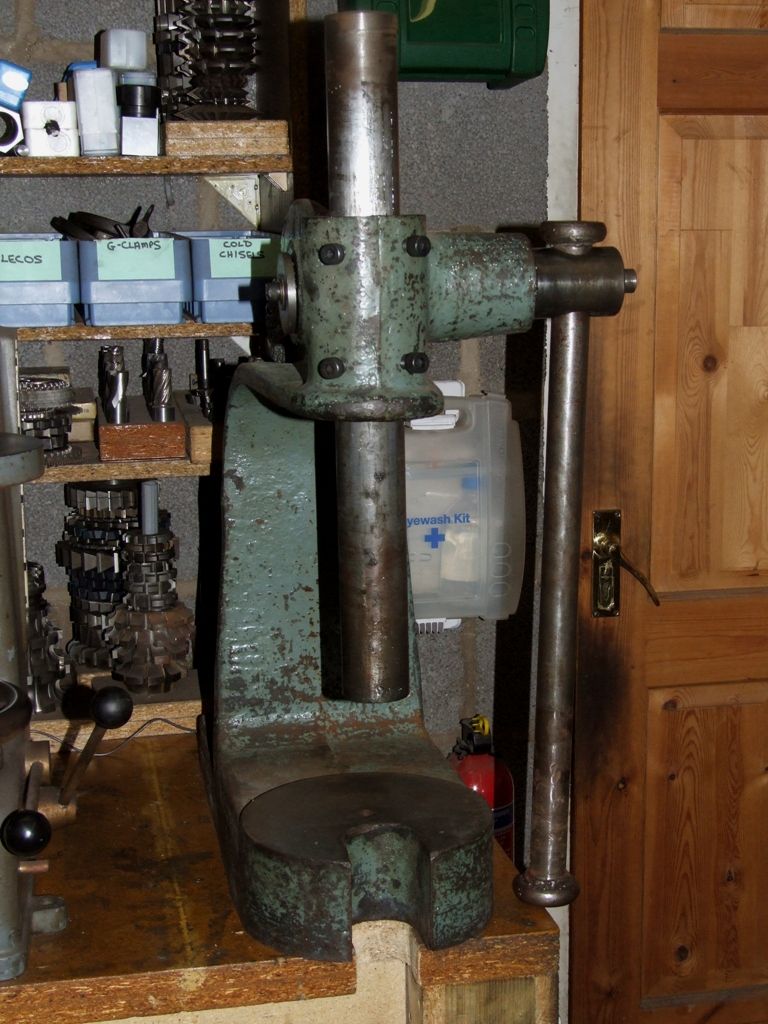

Today was spent largely in the garden hacking back the blackberries. However, this afternoon I got my neighbour to help me lift the arbor press on to the bench. Took about 5 minutes and no trips to A&E needed; a win-win situation. I knocked out a few large washers and bolted the press to the bench with some stainless steel M12 bolts and nylocs from the spares bin. The ram and lever were cleaned, greased and replaced:

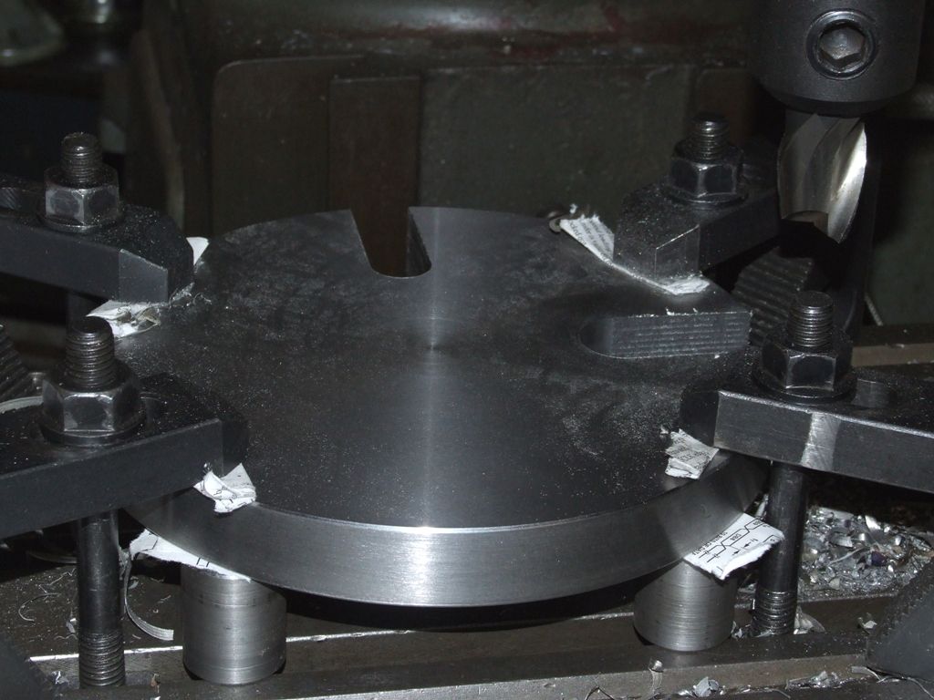

Later this evening I started machining the slotted plate that will go on the arbor press. The 3/4" and 1" slots were drilled and then finished with slot drills:
For the 1-1/2" and 2" slots I'll chain drill out the waste and machine a circle with the boring head. Then I'll chain drill the waste for the slot and finish with an endmill.
