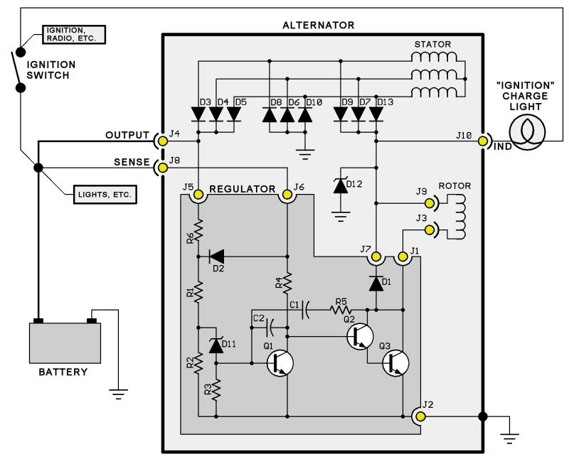

            must of been in the 1970's the Lucas alternator on my dads Vauxhall viva stopped charging
            the ignition light went out when the engine was started but came back on soon after
            luckily the thick film regulator was encapsulated in silicon rubber that made it easy to remove and test the various components
            half an hour later , after replacing a faulty transistor with a ZTX107 the alternator worked on the bench
            had to wait for a tube of electronic grade silicon sealant to arrive from Radio Spares (RS Components) – not the common DIY sealant that gives off acidic fumes !
            the last time I checked an alternator (Bosh) the regulator was combined with the brush holder – easy to replace
            not sure how cost effective
            PS if I remember correctly it was Q1 that I replaced

                                  JohnSwift 1, its a shame they did not put a 100 ohm resistor inside the unit between the sense and the output wires, if the sense wire becomes detached the charge goes to max and boils the battery. If Q3 goes short circuit, the voltage rises and blows every bulb in the car and the computer. . . ..

                                    I understand they made 2 versions of the alternator
                                    one with the sense wire measuring the voltage at the positive battery terminal and another internally linked to the alternator positive output
                                    if the sense wire is disconnected you have no positive supply to R4 which supplies the bias to switch on transistors Q2 and Q3
                                    I guess if Q3 goes short circuit , the alternator will be so hard to turn at speed the belt will start to slip and screech
                                    unless your answer to any  new noise is to turn up the radio a bit louder
                                    you should find the fault before the battery is boiled dry
                                    Edited By john swift 1 on 20/01/2016 20:26:51
