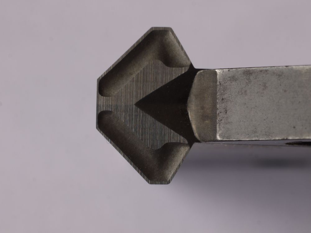

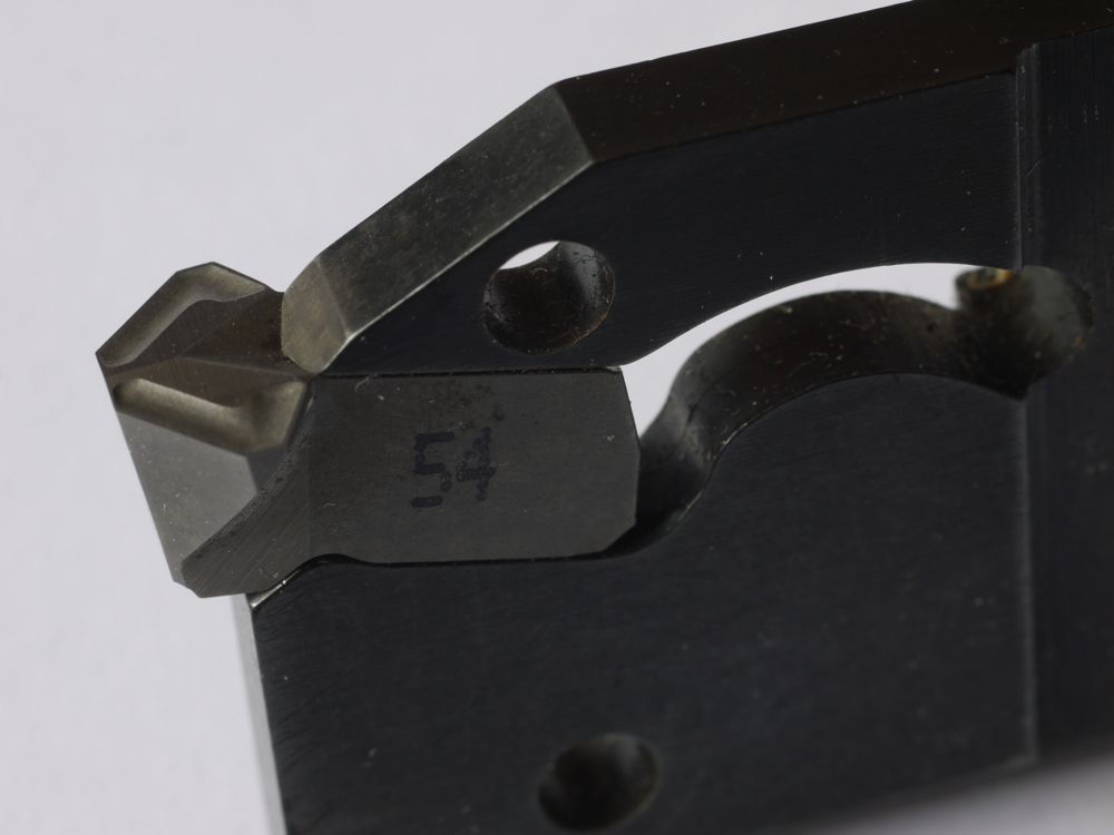

                            Today, I bought a rather interesting lathe tool, which I hope to adapt to the Myford.
                            REIKA WERK GmbH
                            GHB – 76 – 1509DG/1RE
                            (also carries the number 90847 on the holder, and 54 on the insert)
                            The holder is like a modern 'indexable' parting tool, but the insert has left and right chamfering edges.
                            So far as I can determine; REIKA specialises in Tube processing, so I presume this is just a very exotic deburring tool for use in a cut-off lathe.
                            If anyone has links to a catalogue, or can advise, I would be grateful.
                            … if not, I will post photos tomorrow.

                                Pop up a photo Michael, from what I could see it may be off one of their multi head machines that rotate around the pipe to cut it off and the chamfer is more likely for weld prep rather than simple deburing but would depend on the size of your insert.

                                  Photos of Chamfering insert, as mentioned yesterday:
                                  Flat at front is approx. 3mm wide.

                                      Neat, that will do internal and external corners as I'm sure you have already worked out.
                                      I got a square insert with similarly clipped corners from JB tools yesterday, mjounted on a simple shank it should do a similar job.
                                      #227461
                                        You may find small internal chamfers a problem as it looks to only have about 7deg of front clearance so will start to rub on small dia holes but should be fine if you need any external ones. Same will apply to yours Neilsad
