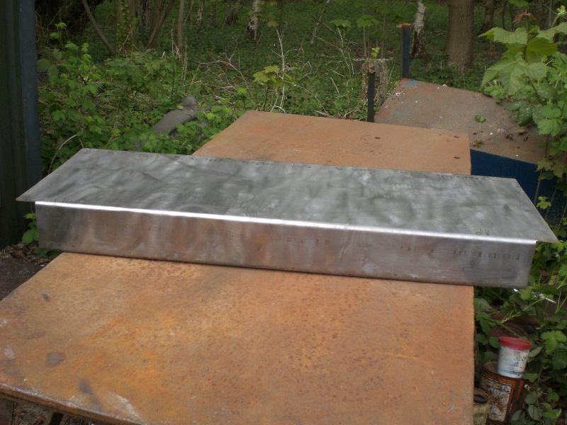

                      Hi, I actually started this lathe stand project at the beginning of last week. First task was to find some used material which I have been hoarding forever. Found an old door from a large industrial electrical panel, which after a couple of evenings stripping the old paint off and marking and cutting to size, I took it to work next day and folded it into a channel shape on the sheet metal folder.

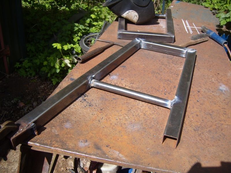

                      Today I got as far as welding the legs and cutting them to the correct length.

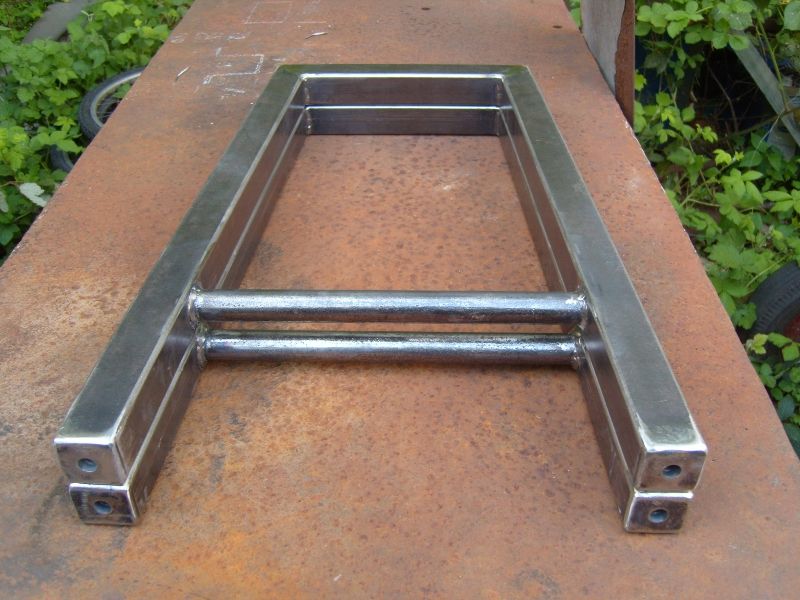

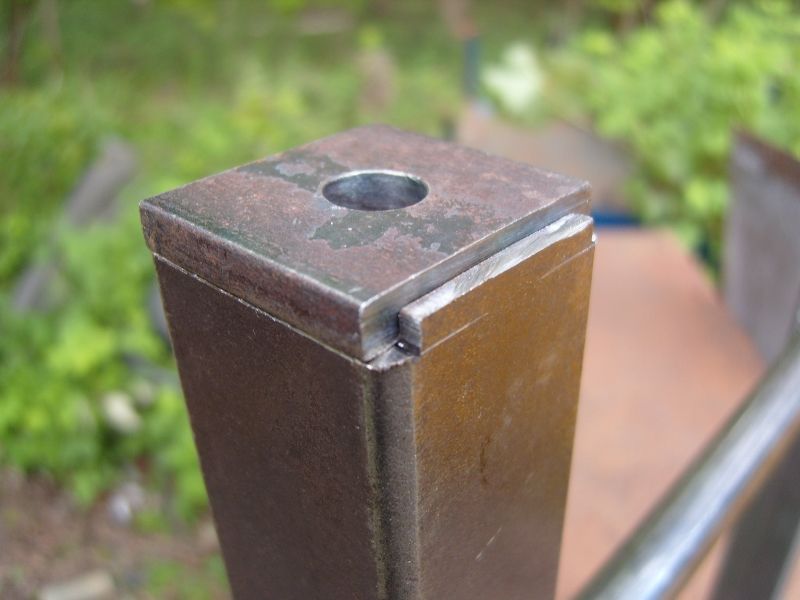

                                Nicholas Farr
                                  @nicholasfarr14254

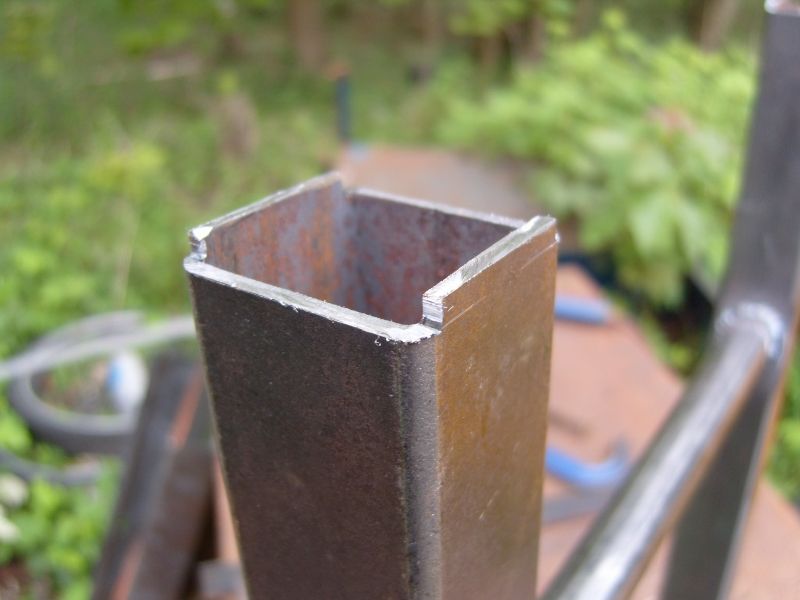

                                  Hi, today I did a little bit more to my lathe stand, Firstly the bottom of each leg was cut as shown in the photo below.

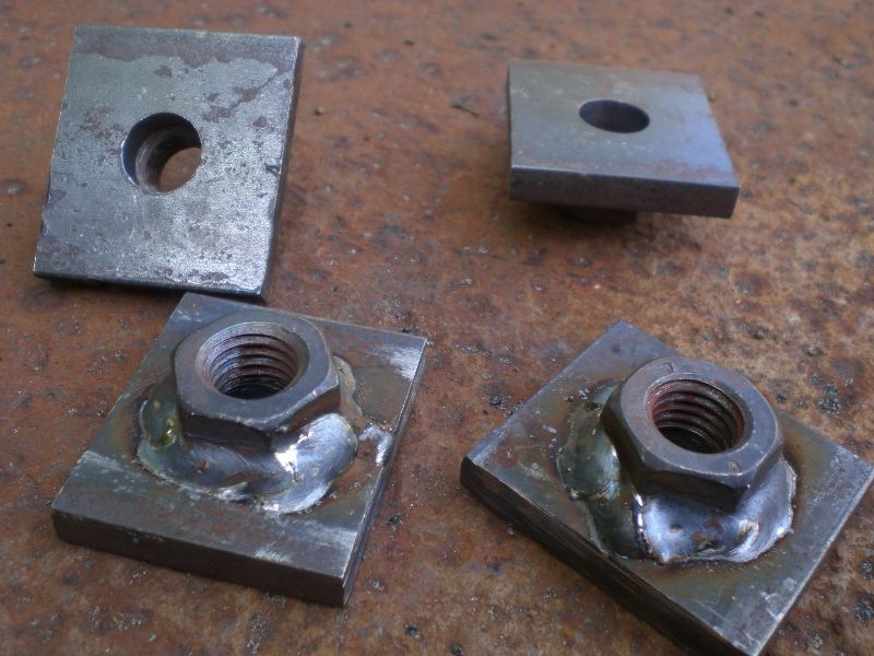

                                  Then 12mm nuts were welded to four pieces of 40mm x 6mm flat bar which were 35mm long, with a hole in the middle.

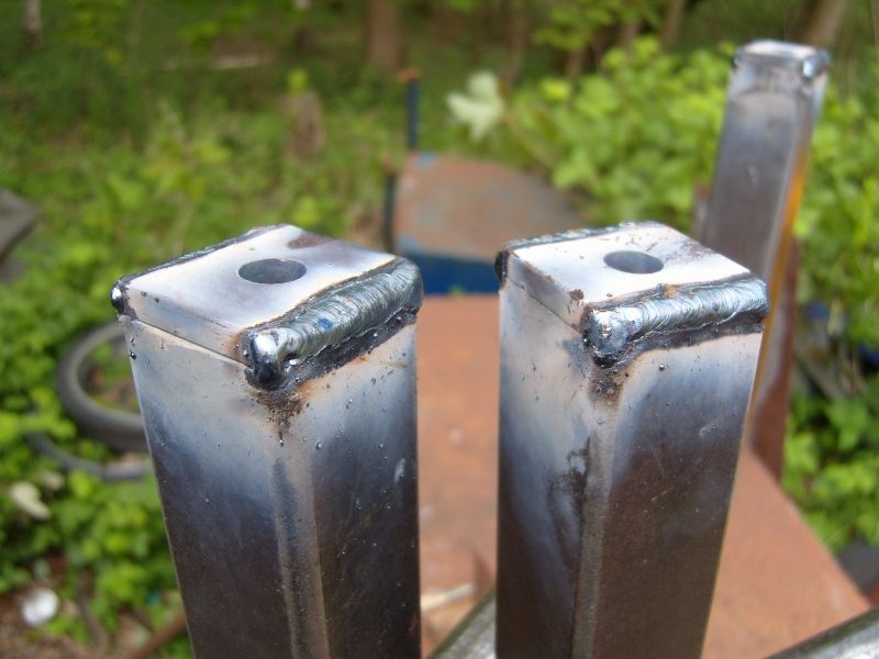

                                  These were then fitted into then bottom of the legs with the nut inside and were then welded into position.
                                  The welds were then flushed off both pairs of legs ready for welding to the top.
                                  Regards Nick.

                                        At least some welding by a real mortal – still makes my welds look like bird-poo though
