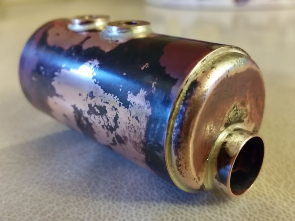

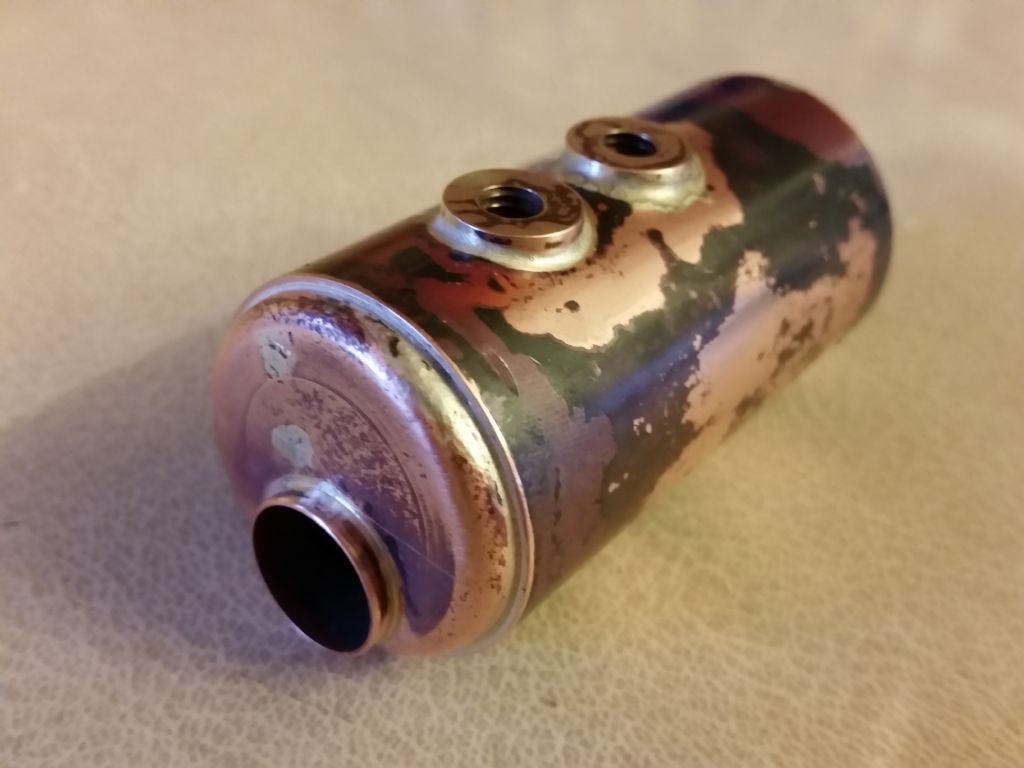

      Gave the silver soldering another go. These are the results after some cool-down time, 20 minutes in citric acid pickle, and a wash with hot water and a brillo pad.
      Much happier with the process and outcome. Extra heat made a world of difference and now I know what it 'feels' like when it happens I think I'll be able to do the next one without adding the weight of the boiler again in solder!
      Not yet tested, no way of doing that as of yet.

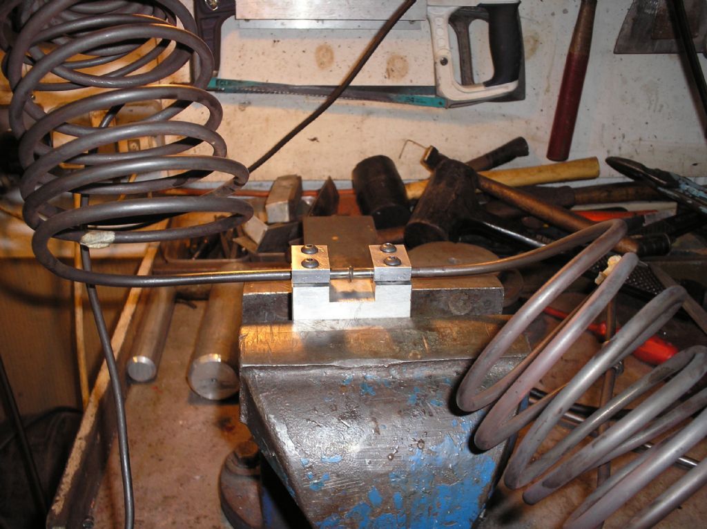

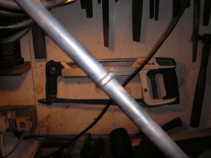

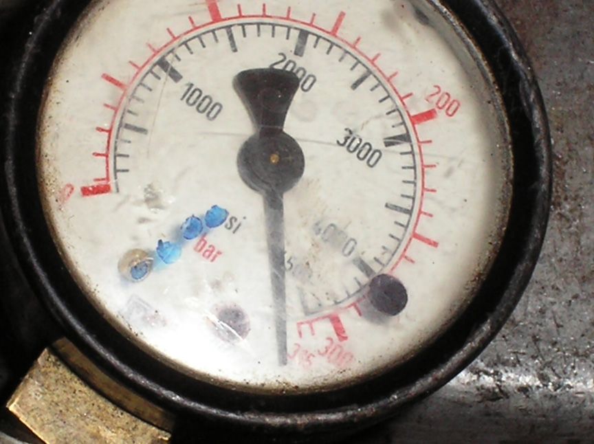

                        Today I'm rebuilding all my damaged steam generators that because of overheating and bursts made them too short for efficient steam production.
                        Now having a Tig Welder decided to try to reclaim them as the stainless 321 tube is getting expensive.
                        The proof of the pudding will be when they are under competition conditions with heat and pressure.
                        Sorry some of the pictures not that clear.
                        Jig set up before starting to Tig weld
                        Tig jointPressure testGauge reading
                        Edited By Windy on 16/04/2015 21:40:24

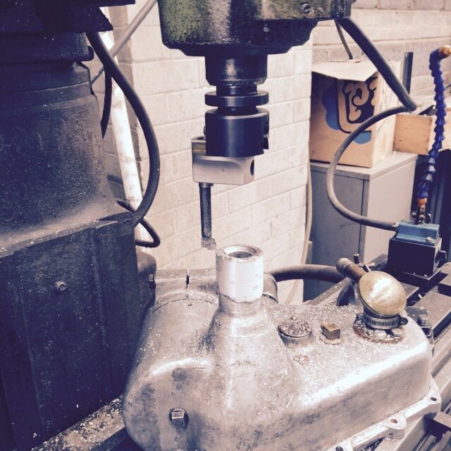

                                          My first attempt at using a boring head to turn an outside diameter. The spigot on the timing case cover acts as a front engine mount and after 90 years showed 40mm of eccentric wear which, on installation in the chassis, was by observation evidently too much😒!
                                          After a visit to our local welding genius the weld build up had to be machined. The obvious method of sticking it on the face plate of the lathe was thwarted by not having enough swing so on to the mill it went. Not having the requisite left hand boring bar I had to run the mill in reverse taking the precaution of winding the boring head onto the stub arbour with a big adjustable spanner. I got away with it unscrewing by taking light cuts.
                                          Now it is machined the blow holes in the added aluminium show what a tricky job it is building up 90 year old aluminium castings with weld. Timing case spigot.jpg

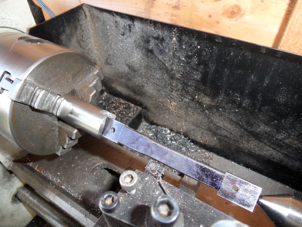

                                                    Made a drive dog to turn between centres in a three jaw chuck.
                                                    take a short piece of bar 8mm turn a 60 deg.point on the end and file or mill a flat along its length to locate a securing screw. Another piece of bar drill and ream 8mm , mill a 3/8" wide slot in the end and drill and tap a hole somewhere along its length to take a securing screw. slide centre into 8mm hole tighten securing screw et voila.
