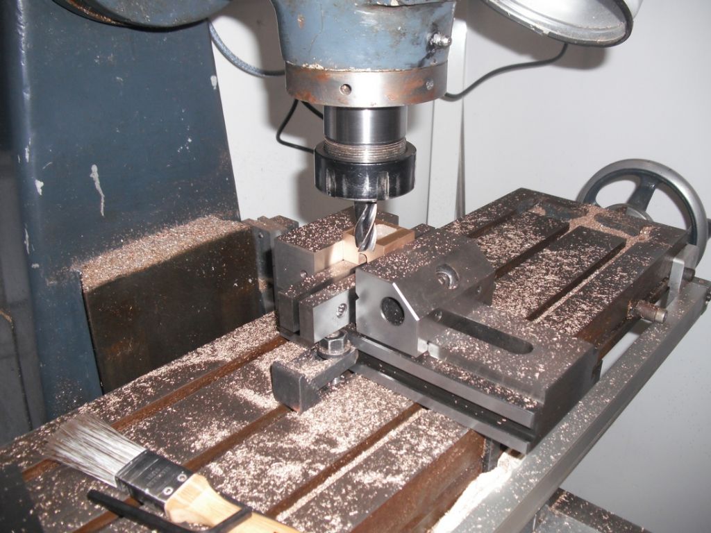

                    Decided to check out what was so great about tangential/diamond tool holders and made a couple…
                    So far pretty pleased with 'em. Certainly easy to sharpen and leave a pretty reasonable finish.

                      Hi Jon
                      They look pretty good. Do you have any drawings? Maybe an article in ME would be in order!

                                Hi Bruce,
                                I hadn't any drawings but have put this together if it's any use to you or anyone else.
                                Most of it was cut on the horizontal bandsaw from 12mm BMS flat using two 6mm holes at the corners and then filed/sanded to size.
                                To square the corners of the groove I used the honed end of the 6mm toolbit as a poor man's broach.
                                For the round toolbit I drilled and reamed a 6mm hole at 12 degrees back and to the side between centres with a punched reference at the tailstock end for the initial drill if that makes sense and then did the shaping around the hole afterwards.

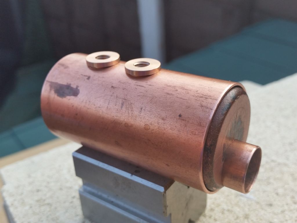

                                    Eeny Weeny Cracker Boiler assembly version 2 (after i fluffed soldering the last one…)20150409_182002.jpg
                                    On reflection, I'm much happier with the bushes anyway, the thread in them has cut far better this time; Soldering can wait a few days, I'm off to Lytham St annes for a few days with the family tomorrow…

                                          Awesome – Thanks Jon – I see my next project is in formation – Just got to get some 12mm steel

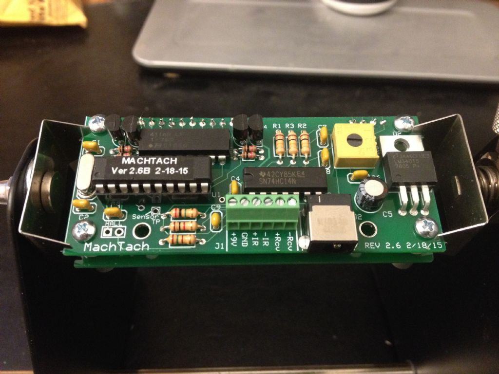

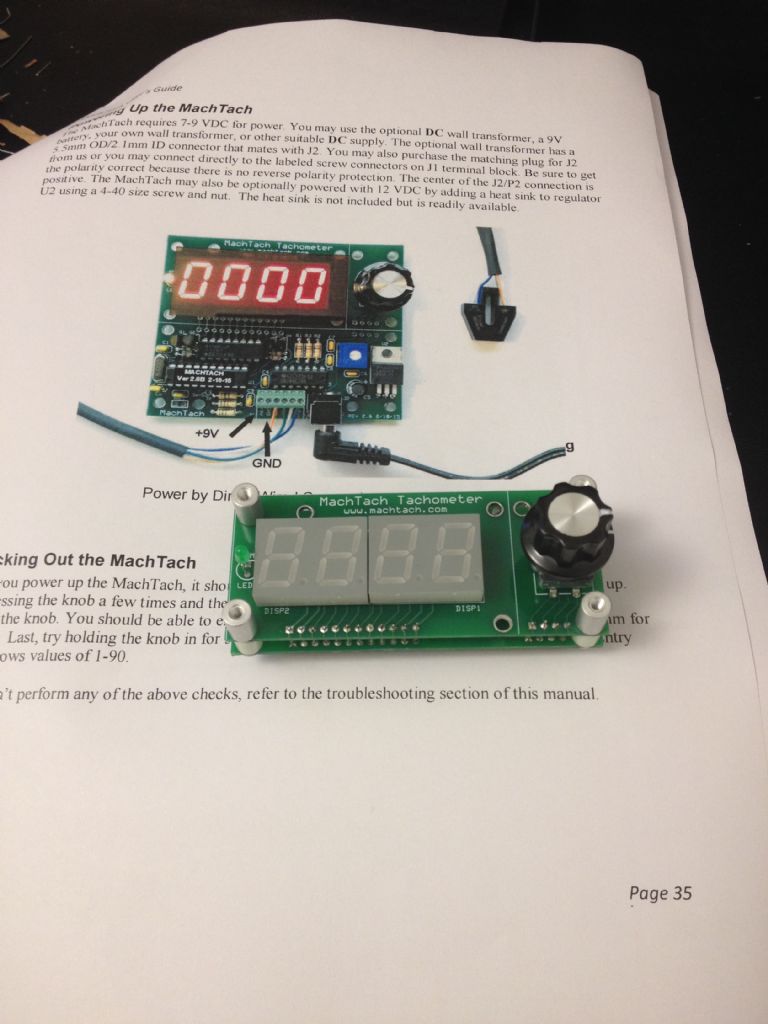

                                                Received a couple of kits for the Machtach (machine tachometer) recently, so finally dragged my backside out of the armchair and built one up this evening. These use a speed sensor (IR or Hall effect for instance) and a PIC to display the speed (RPM) of a machine spindle. You can configure it to handle a variety of pulses per rev, depending on what’s convenient, so on a lathe you may find a handy gear on the spindle that could be used to generate a signal – or fit some reflective patches (provided in the std kit, along with an IR sensor). It also has a surface speed function which can be set in metric (m/min) or imperial (fpm), so you can set the spindle speed to give the correct cutting speed for a given diameter of tool (milling) or workpiece (lathe). That’s handy.
                                                The cost was about £40 each including shipping (it actually cost less than it said on the website, so the guy refunded me the difference). I also bought a PCB holder from Farnell for £20 (with free, next day delivery) which made the assembly task a lot easier than wrestling with it on the desktop.
                                                Took me about 2 hours from start to finish, including the assembly of the PCB holder. I’m pleased to say that it worked when I powered it up after dinner tonight. I can’t comment on how it operates with a real rotating spindle in front of it due to the current “armchair” status of my workshop activities currently. However, it seems to be functional and wasn’t very challenging to make it up. I’ll build the other one up ready for the momentous day when real activities recommence.
                                                Finished building
                                                Some more pictures in my album if you are interested. All in all very happy with the experience so far.
                                                Back view

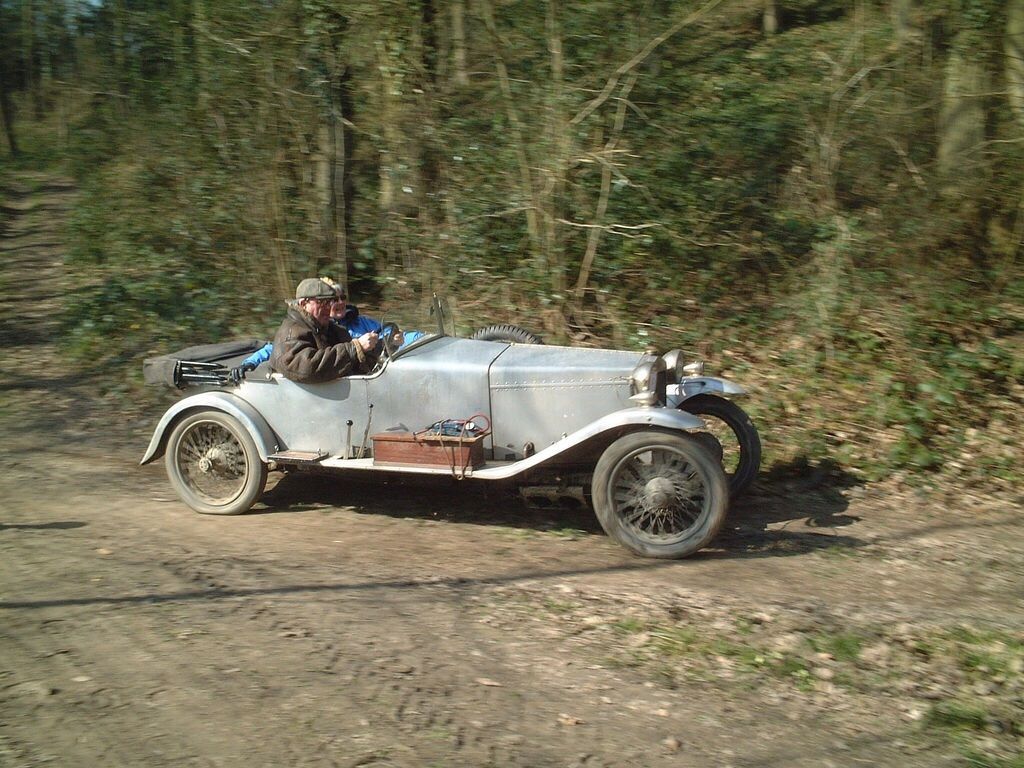

                                                  The engine is from my 1925 Frazer Nash.
