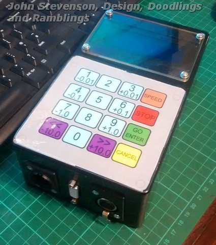

                Finished my Steve Ward Rotary Indexer off that I started on Thursday, Came out quite well.
                Made a couple of alterations.
                Most builders cut a hole in the cover and poke the screen through but I have one bit of kit here with a similar screen that has been hit by a hot chip, still works but it's marked the screen. So this one has longer stand off's fitted and clear Lexan screen fitted that can be changed.
                Also fitted a 9 pin D plug a la Division Master so it can 'talk' to larger driver boxes for more powerful equipment.
                Power in is on a 3 pin XLR as I had the silly 2.1mm push in power cable pull out on a Division Master part way thru a move which cost time getting back to zero and starting again, the Division Master is also now on 3 pin XLR so both these units can sare same power supplies which in two cases are supplied by the machine.

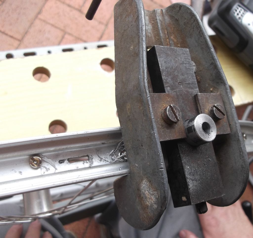

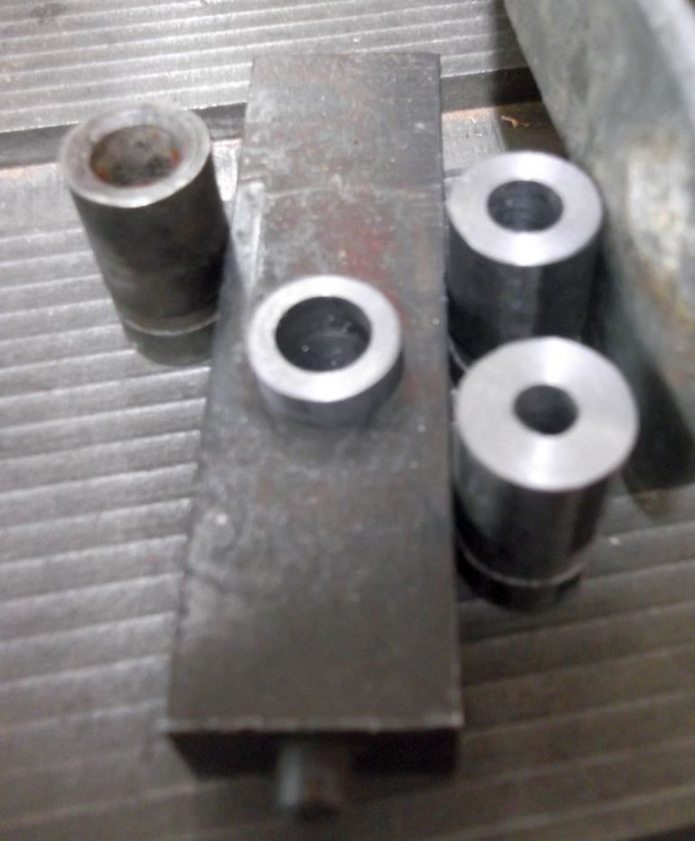

                    First is "Not today" but a week or so ago had to make up some Dowel jig drill guides in metric for the jig I have which was dad's and only had 1/4" guide. I used the 6mm to line up and drill holes in the wheelchair rims for the hand grips I was fitting. dscf8406.jpg
                    That being done just some new tyres and I have a spare set ready to go.

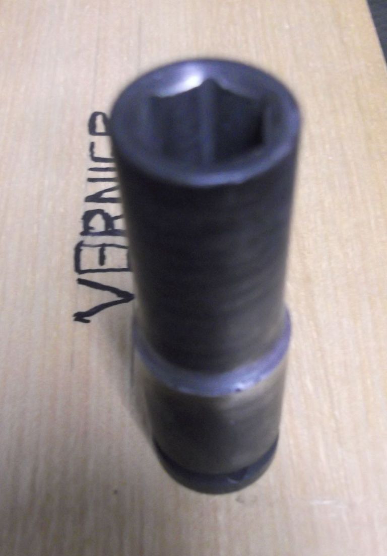

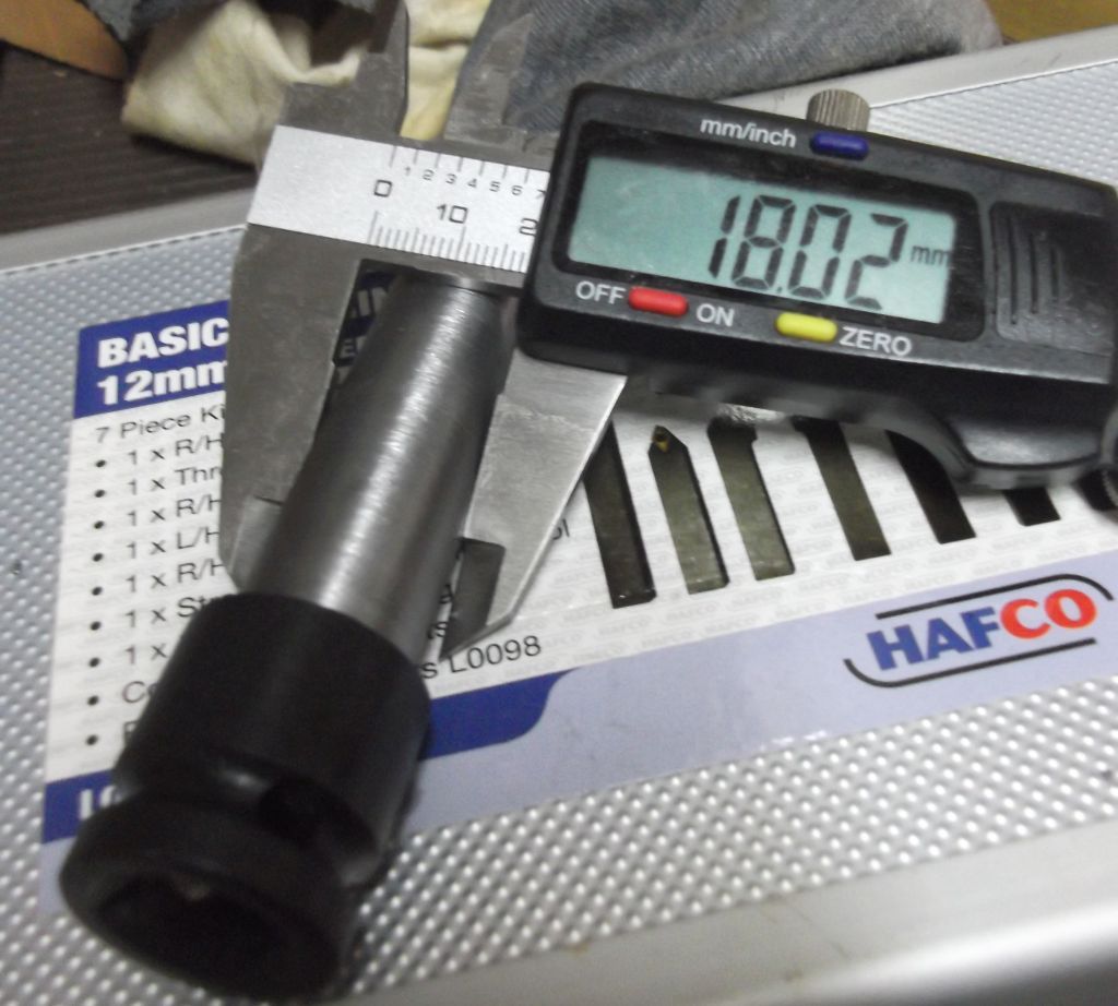

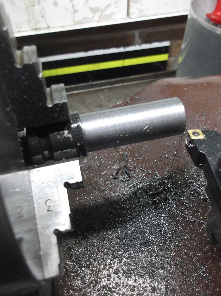

                    Today was reduce an impact socket for oldest son for use at work. It had an OD of 20.87mm he needed it reduced to 18mm and the step length or depth reach longer.
                    HSS cutter wouldn't so out came the Carbide.

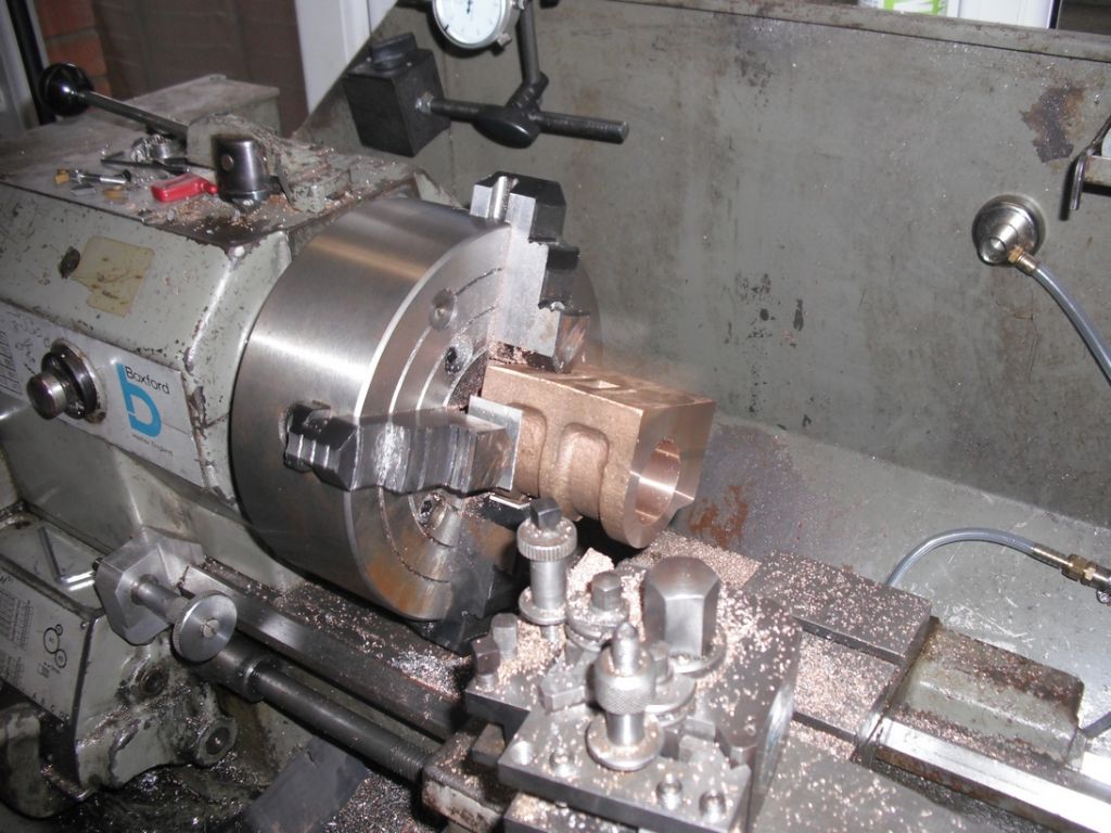

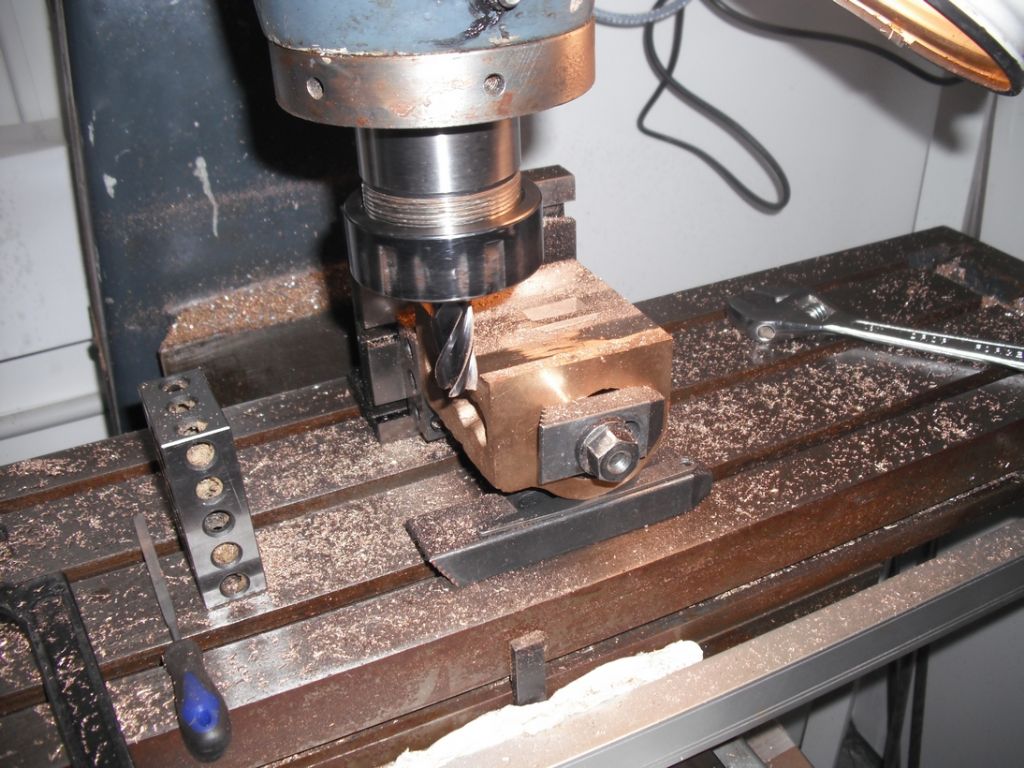

                                  Made a start on machining the cylinders for Nigel Gresley, set up a bit tricky and used a mandrel in the tail stock to get the core parallel. I decided to use the rather large 4 jaw I have as it gives better support to the casting not sure doing them this way would have been possible on a smaller lathe. Could have used a boring bar and the work piece on the cross slide but this way meant I could gat one face square to the bore.
                                  Setting the cylinder up in the milling machine did cause a little bit of head scratching to ensure the face was parallel to the bore. seemed to be close enough as it left a bit in the middle of the casting as a 0.3mm first cut was run over the part. Will be finish cutting with a fly cutter as it leaves a better finish with so many tool marks.

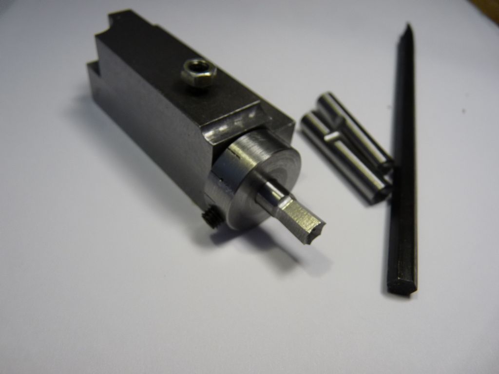

                                    Following the Square Hole discussion some weeks ago, I completed a rotary broaching tool and cut a very successful hexagonal hole – thanks Mike Cox. **LINK**
                                    The block is held in a QTCH and pushed through using the tail-stock. The cut-out you can see at the rear is for setting the height.
                                    I made a couple of spare blanks whilst I was set up. I changed from Mike's description of cutting the broach, using the side of a carbide end-mill and got a very clean finish with no burrs and IMO less chance of the cutter moving whilst being formed. Soft soap on the cutter during heating for hardening stopped any scale very well. I just need to fit a bigger brass/bronze screw to aid extraction.

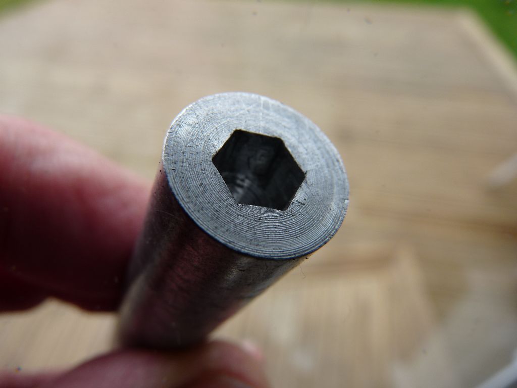

                                    Here is the result of my first test – very satisfied.

                                            Wow, that looks really nifty. I can see that I'm going to have to make a rotary broach – Andrew

                                              Hi Andrew,
                                              I would have thought that you already have extensive broaching capability in your workshop, based on the projects you seem to have on the go.
                                              The direct link to the type I made is actually here **LINK**.
                                              Such a simple tool can produce workable results. I've thought of some improvements for version 2 based on the experience so far.

                                                I'm afraid not! I have made a simple 'push' hexagonal broach in the past in order to make a spanner for battery packs, where a dropped nut or spanner could result in 1500+ amps flowing in the wrong place. But that was for plastic, so not a problem just pushing.
                                                I have also just bought some straight push broaches for small keyways but haven't had time to use them yet. Rotary broaches are one of those things that are on the list to get, but never quite high enough to actually go and do it. In the past I've looked at the offerings from LittleMachineShop, but they now seem to only do the broaches and not the holder. Which is not very helpful. sad

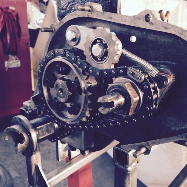

                                                    image.jpgFinished the magneto timing chain tensioner for the Anzani. Got there in the end after several "measure once cut twice moments" when wil I ever learn?😁 still not really happy about the spring angle of attack but I think it will work.
