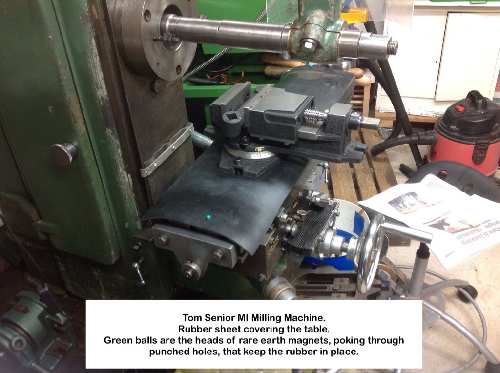

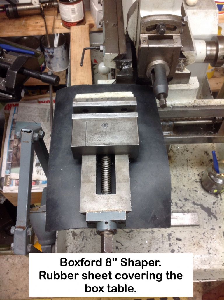

        The oil hole in the Tom Senior Overarm bearing I recently made was way to big so soldered it up and drilled a No.70 hole. Too small so went to enlarge it and the solder plug promptly fell out and disappeared down that black hole every Workshop has.
        OK I need to use 'proper' solder so got the spool of Fry's, cleaned the hole, heated and plugged it up.
        Filed inside and out smooth and drilled No.65 but still no oil getting onto the Spindle spacers so opened it out No.60 and oil getting through.
        Has anyone done any experiments to determine the hole size to feed oil to shafts?
        Photos of the rubber sheeting covering the tables on the TS & Boxford;
        Boxford 8 Shaper
        Tom Senior M1 Milling Machine
        Geoff – Mill keyways in vices tomorrow.

                Murray,
                EPDM sheet offered on eBay, various thicknesses and sizes.
                For the mill and shaper I used some of the 3mm thick sheet I have.
                I will try 1mm on the Marlow and see how that works, as the magnetic bases don't work through 3mm.
