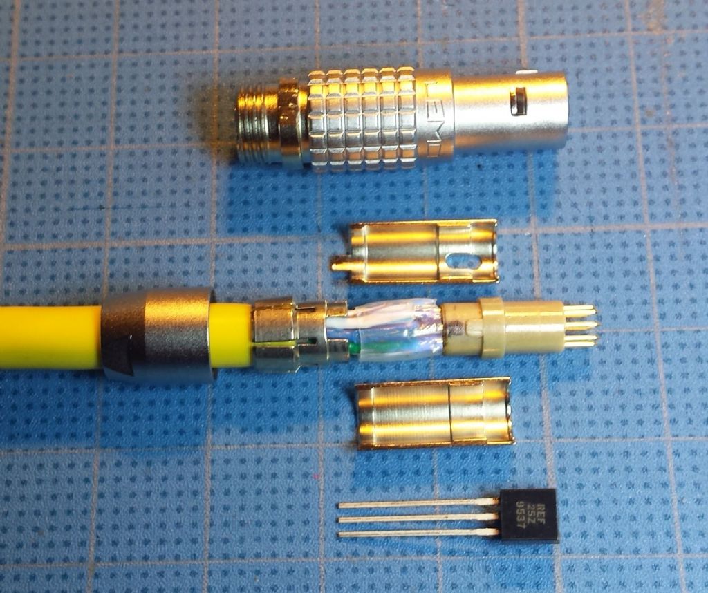

              Not actually done today (it was yesterday) is a 9 pin Lemo connector that I found quite a challenge.
              The holes in the solder cups are 0.5mm diameter which is smaller than the seven dead straight strands of the wire cores so I had to open them up slightly with a dental burr. The cross section of the bundle of the eight wires cable is almost the same dimensions as the pins on the face of the connector.
              The connector body where the pins are is 4.5mm diameter, the TO92 device is shown for scale.
              I did four of these in several sessions over the coarse of a day as even with a magnifying desk lamp its quite a strain.

                  Ian,
                  How the heck did you manage to do the soldering?
                  I need to do something very similar, but am completely stumped as to the how.

                    I work with LEMO plugs and sockets all the time and the best way is the crimp type.When having to recover damaged Lemos I do solder and if the wire diameter is too much for the solder bucket in the pin then trim off a few strands. Yes, it is fiddly work.I also solder in situ with the pins in place using a very fine point soldering tip. I also ensure that the cable is cut and trimmed by measurement to ensure nothing gets stretched when assembles. Users seem to very rough with them and not realize they have a lock/slide release and try and pull them out. Another damage is treading on the Lemo as it trails on the floor. They are expensive and need great care to not get them dirty in mud and the like. Do you have the special spanners for tightening up the Lemo?

                      Clive
                      The 9 pin version of the OB connector is only available with solder buckets, the data sheet shows they have 0.45mm holes so cutting off wire strands (which I never do) wont really help as even only two strands side by side hardly fit in that hole diameter. Biggest problem with this cable is that the 4 twisted pair wires are in a different sequence to the pin layout and are also a loose fit in the cable jacket so the collet does not grip well.
                      I made a very thin wall metal sleeve that I slid between the wires and the outer jacket so the collet had something solid to close down on. I was able to organise the wires into the right sequence before they pass through the sleeve and then pushed a short length of thicker wire in the middle of the bundle to force them into a circular pattern trapped inside the sleeve.
                      I dont have the a genuine Lemo spanner so I made a thin 8mm AF one for the purpose.
                      You are right about the vulnerability to abuse. fortunately the audio/video users seem to be used to working with delicate equipment.
                      Geoff
                      What is it you need to solder? maybe I can offer some advice?
