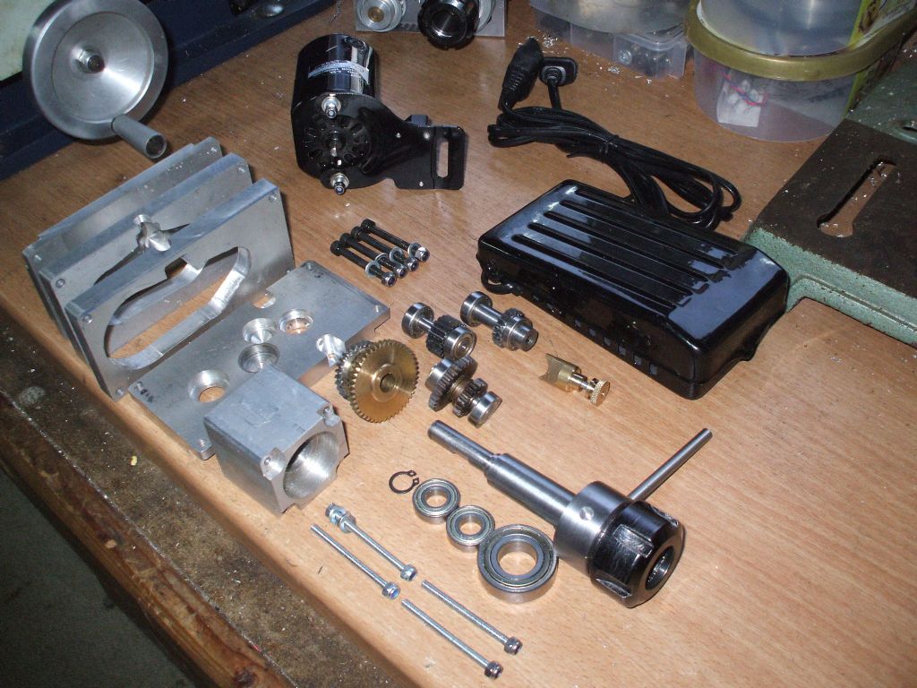

      Finished all the machining and bits-gathering for the toolpost spindle (Mk2). Unfortunately I won't be able to get back in the workshop until Tuesday to screw it all together for a trial assembly as we have visitors over from the UK arriving tomorrow 'til then.
      All parts awaiting trial assembly.
      I can't decide how to lubricate the innards – probably whack some grease in and hope for the best! It won't be running for extended periods after all.
      P.S. Already started CAD design of next project – an automatic boring and facing attachment. Such fun!

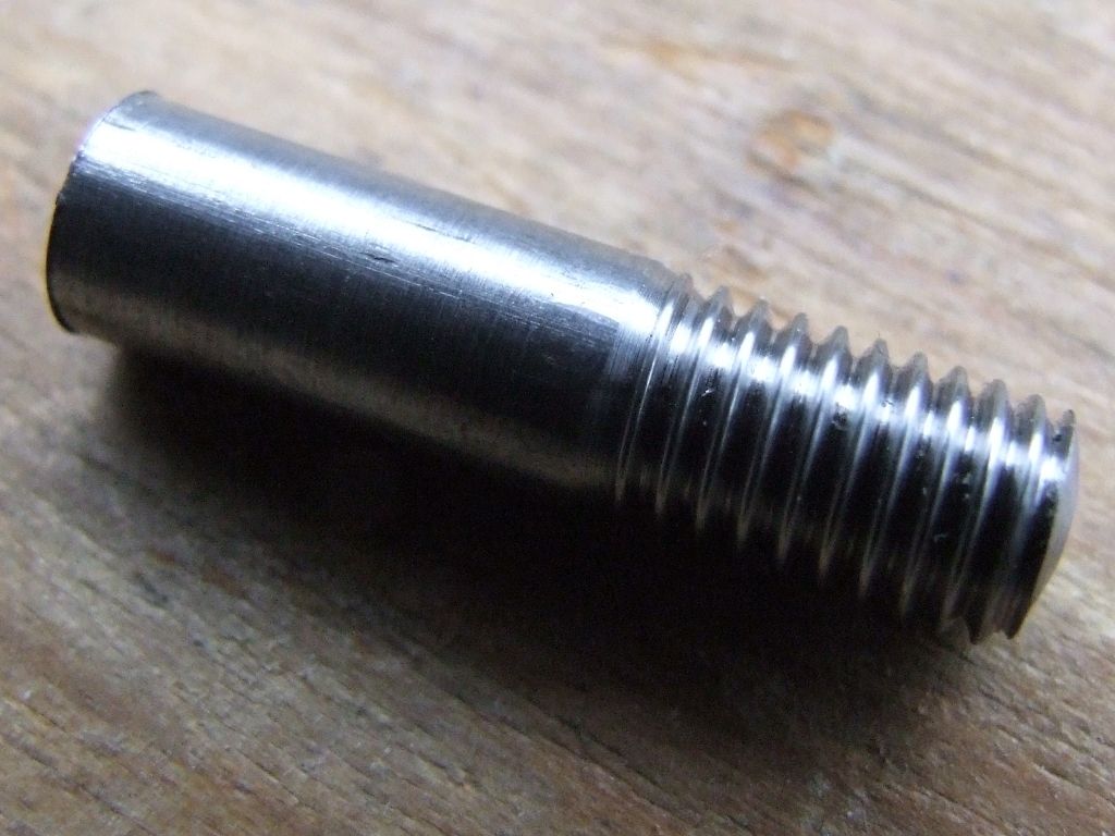

                    Here's the prototype 1/4" BSF stud, after grinding tools and setting up the Britan:
                    Of course I need to thread t'other end, but I'll do that after I've done the 1st op on all the studs I need. For scale this stud is 31/32" long. Note the rounded end to the stud, the radius is all correct and proper at 1.25 times the nominal thread diameter. The stud lengths have been calculated assuming the old standard for thickness of BSW/BSF nuts, 1/4" in this case. However, I am not sticking to the old standard for the AF of the nuts. Instead I am between old and new at 11mm. That's because I happen to have an 11mm hex collet for the Britan. That should cause the rivet counters to choke on their tea and biscuits! wink 2

                      John H – looks like a fine kit of parts. Your design and what CAD environment did you use? What is the parentage of the various gears – did you make them yourself or modify std parts?
                      I'd love to see how this goes together so you must post further pictures. Is this going to be fairly noisy – I expect it's a high speed spindle if it's a toolpost attachment?
                      Murray
                      PS – I see you have an album showing progress to date. Looking forward to watching progress!

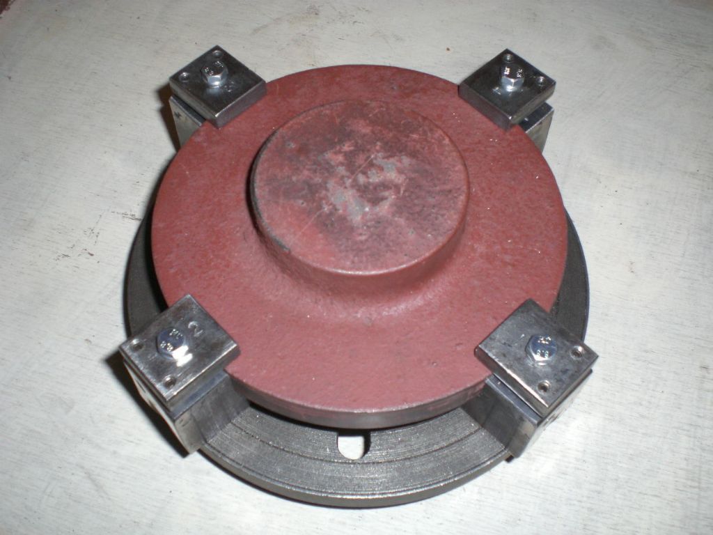

                          Hi, John S greedy jaws remind me of four I fitted to my Boxford faceplate a couple of years ago, to hold a couple of blank backplates for boring and screw cutting. The jaws enable the backplate to be set off the faceplate so not to run into it with the drill and boring bar.
                          It worked extremely well.
                          A few more photos can be viewed in this **LINK** for anyone who is interested.

                                      Muzzer,
                                      The gears are all homemade. They are my first attempt at gear-cutting using involute cutters from CTC Tools. Incidentally, also the first time I've used a rotary table! The whole lot was designed in QCAD. The first version was also two-speed, but used a toothed belt drive, speed changes acheived by swapping two of the pulleys. It was made on-the-fly, then drawn up in CAD afterwards. Consequently, when used on the lathe, it didn't have the versatility that I'd hoped for but works adequately for my needs (e.g. grinding the collet taper). The more compact version 2, has the spindle coming out the other side. In order to get the spindle direction reversed, I needed to use the gear train. It uses a 90watt sewing machine motor with primitive variable speed control. Max quoted rpm is 10,000, so yes, it will probably be very noisy, if not terminally explosive! More pictures to come as assembly and testing takes place.

                                        John, your toolpost spindle parts look really nicely made but did you really use gears just to reverse the rotation. Its a bit sledgehammer to crack a nut compared to fitting a reversing switch.

                                            Ian
                                            If the motor that John used came from a supplier in mid Wales then it most probably is like the one I've got – offset brushes so it won't run very well in reverse if at all, and the internal connections can't be got at easily. They are designed and sold as clockwise or anticlockwise rotation, as sewing machines don't really need to reverse electrically, normally done mechanically as it's usually only the material feed that reverses not the needle action.

                                              Ian/Keith,
                                              The motor was purchased on an internet auction site and came from deepest, darkest China (post free). Following a plea on this forum for a means to reverse the rotation, I tried a tip from Les Jones, but that didn't work – at least I couldn't make it work – so I resolved to do it the mechanical way. It was also an exercise in a different realm of machining for me to try. All grist to the mill (pun intended).

                                                John/ Ian
                                                I suspect mine came from China as well – but stopped off in mid Wales for a holiday!
                                                Mine is branded YDK – that seems to be the most common make of replacement sewing machine motor available, and most of the sewing machine sales and repair places use them. They seem a pretty good product for the price.
                                                I used a standard 70 watt (from memory) motor to drive a cross-slide milling spindle and was quite impressed with what it achieved powering a 12mm diameter cutter through high density polythene quite happily and afterwards showing a great deal of promise when offered a bit of steel to chew at. The motor I've got here is the replacement for that as I fancied a bit more power – this one is rated at 120 watt so I'm expecting about twice the useful power of the previous motor.
                                                They are definitely designed as one way machines though so if your planning a machining set up you need to think about the motor mounting to make sure that you get the rotation correct or use a crossed belt. Fortunately you can easliy get the standard round rubber sewing machine belts and the motor axis can be slightly skewed with respect to the spindle axis to avoid the belt rubbing on itself.
